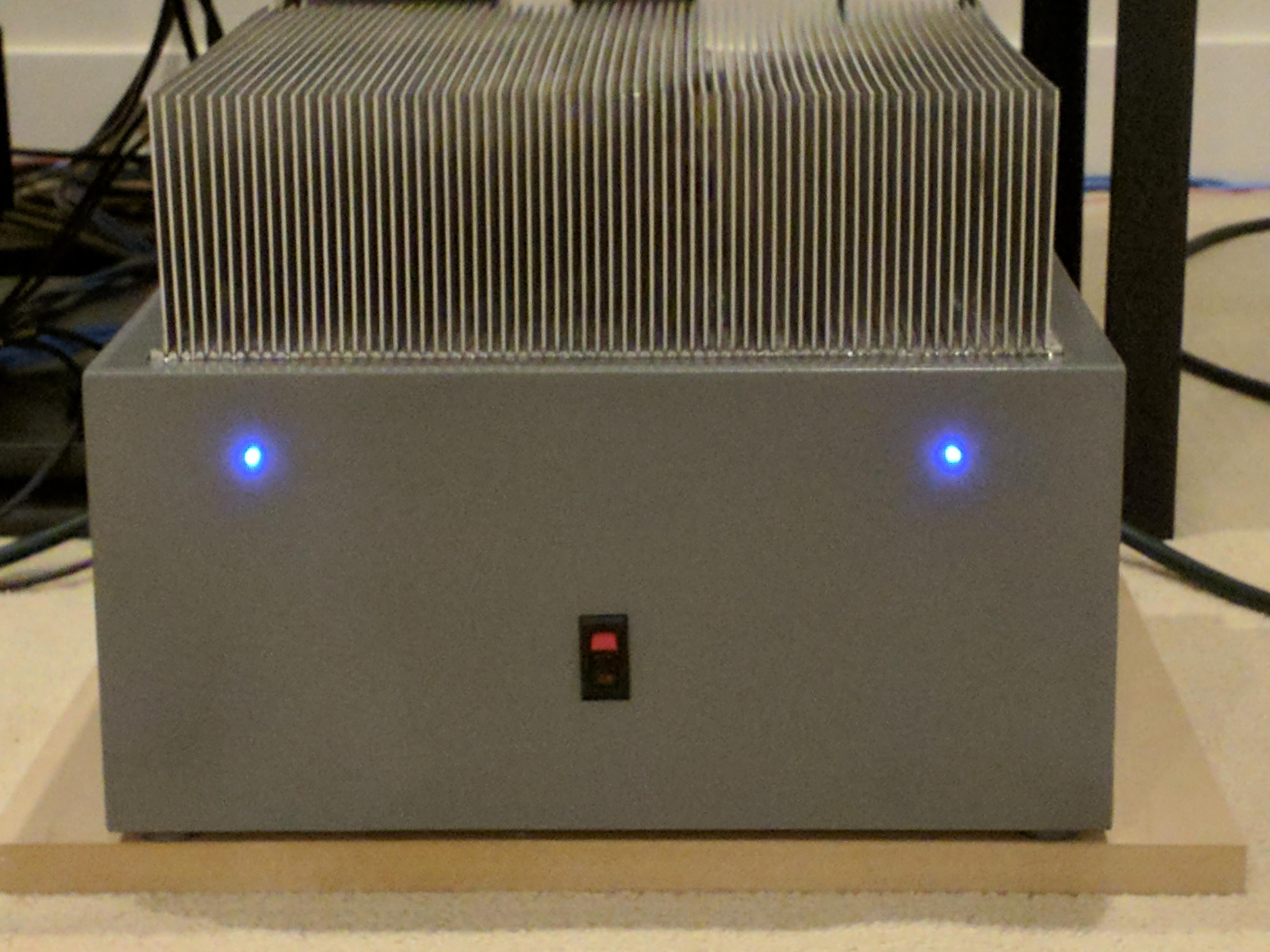

My F4 has been on for 16 hrs since last night. The temperature seems very stable @50c on MOSFET, 52c on heatsink at 200mV. Offset is within range.

I build this one for friend. I finished mine some ten years ago. All my speakers are over 90db so I don't need anything bigger than this. I presume you like your impasse pre, do you have tried other preamp to drive your F4? I have been using the Convergent SL1 signature and the MFA . Both are good but I like the MFA better with more power to drive my F4.

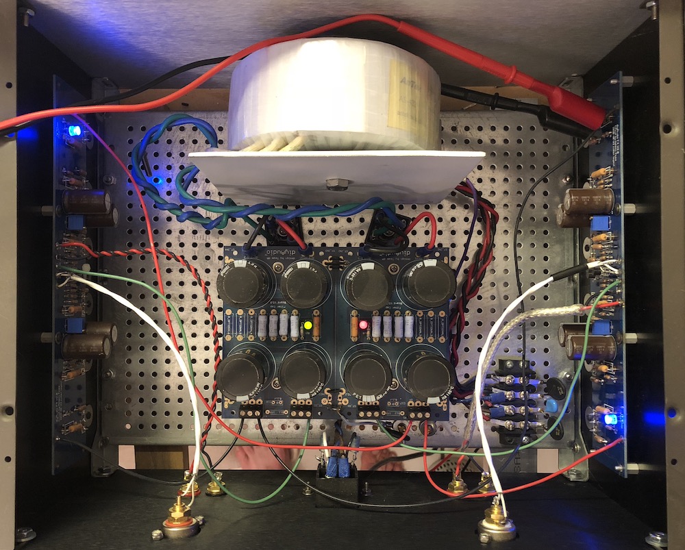

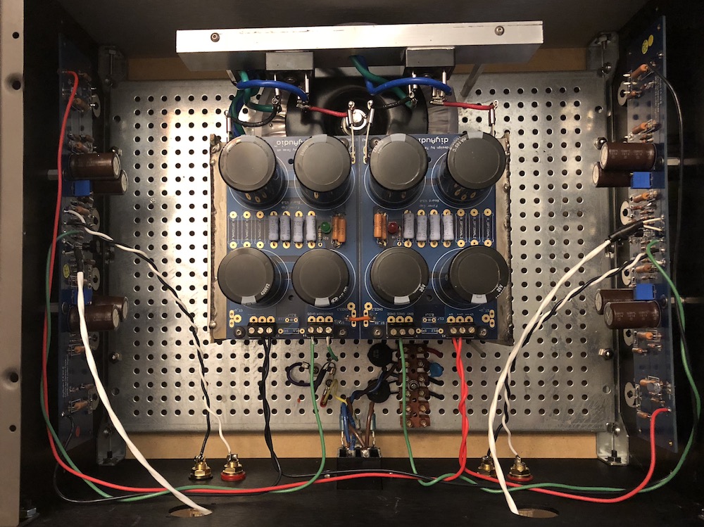

Finished second F4, how to parallel?
First of all, thank you to everyone who has helped and tolerated my questions over the years.
I basically finished the second F4 last night.
Photo's of first vs second build attached.
The second one biased up just as it was supposed to.
Yes, one F4 in stereo provides a high enough sound level for almost any sane listening.
Without getting into politics, I don't exactly feel sane these days.
My preamp for the F4's is using 6SL7's in the gain stage, just measured the output and it is hovering around 31-32 volt range. That's a couple of volts higher than expected. This week I built a passive pre with a 50k attenuator but I bypassed it for the test.
Speakers are... well, the data sheets found around the web are not consistent. The earliest versions I found said 88dB and "4 ohm nominal". I've recently found another version of the data sheet which states "4 to 8 ohm". When listening I sit 3 meters in front of the speakers which are just under 1 meter from the wall and there are about 6 meters behind me before the rear wall. The room is not set up ideally by any stretch of the imagination.
If I may ask one, two part question: how do I wire the input and output to turn these into parallel monoblocks - and can I use jumper wire to connect input / outputs if required? I'm down to less than two feet of wire suitable for output, still have plenty for input. Easy to order more, but if not required all the better.

I haven't installed the RCA jacks on the second one, that's how it looks on my coffee table.

for out-box paralleling of inputs , you need just Y RCA cable , or - if you installed input XLR (pin 1 GND , pin 2 Rch input , pin 3 Lch input) just put shortie in 2 and 3 holes of XLR then route RCA cable to any RCA jack on amp
for output paralleling - just put shorts between two hots , no need to short neg. outputs , considering that you're using common PSU for both channels
