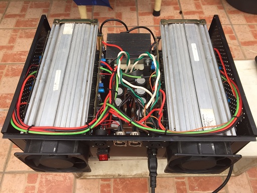

Zenmod,
Thats a 1.5" center leg traffo also diy that fit the limited space. I had built 4 channel Leach superamp and I had serious trouble lifting it🙂
