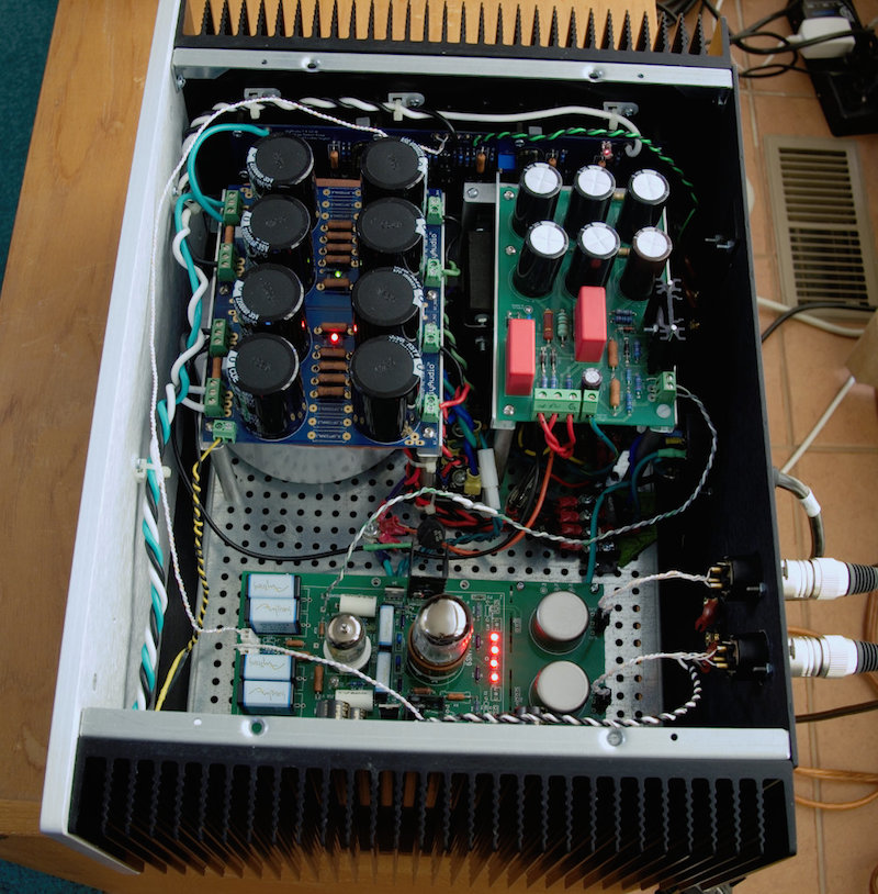

I finished my Impasse + F4 build. That's a lot of stuff to squeeze into a 4U case. In this case, I am running the Impasse as a voltage gain stage for the F4.
I had been worried about putting a 350 transformer "in the box" and the potential for noise issues, but this hasn't been a problem. No hum at all. Just a very faint white noise that is probably from one of the tubes. Twisting wires is a good thing.

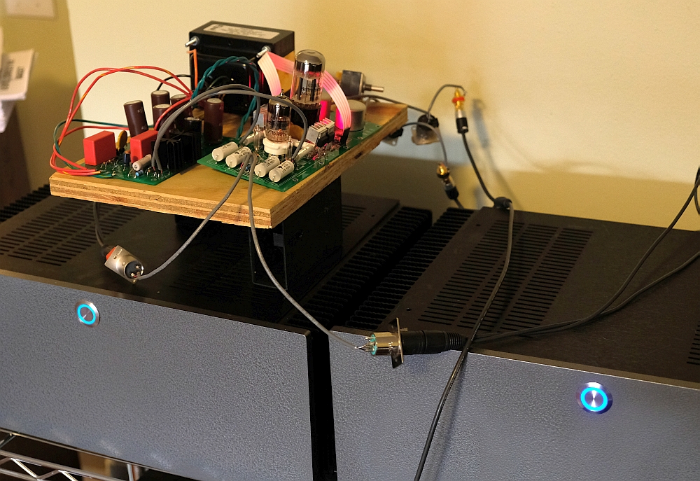

Impressive! What are you using for volume control and source selection I see XLR inputs but it appears to be a "regular" stereo F4.
Thanks. I enjoyed the build.
I have a Relaixed2 pre that I like for volume control and source selection. In case you aren't familiar, the Relaixed 2 uses a relay controlled step attenuator for volume control.
My system is mostly balanced with XLRs. One of the advantages of the Impasse is that it is designed to be balanced input and your choice of single ended or balanced output, so I am picking off the single ended signal for the F4. If I ever decide I want more power, I can add a second F4 using the balanced output.
