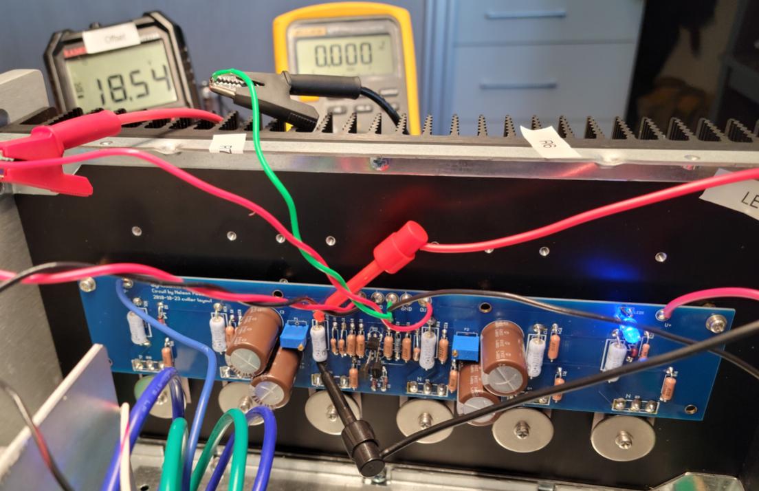

I put in new JFets N [Idss 7.03] and P [Idss 6.93]
Double checked all resistors.
PSU measures 24.30 +/- V [This suggests no current going to board]
Trim pots are set in middle range [12 turns from end]
Currently get no reading on P1 and -18.57 V on P2
Turning the pots doesn't get any change.
I suspect something is blocking current from entering the circuit board? Enough current is getting to board to fire up LED.

Can you take a measurement and tell me what the voltage is from pin 1 on an N channel MOSFET to pin 1 on a P channel MOSFET? If this looks like a TL431 problem, I have a couple (known good) I could throw in an envelope and send to you if there's a chance it might get you going.

Would you mind double-checking the Mosfets without the washers just to verify if you installed the correct type in each spot?
Also, what is the voltage across C3 and C4? Does it change if you move P2 to each extremes?

The Mosfets are in the correct positions.
How do i measure voltage across C3/C4?
Pin 1 is the gate? If so, my reading is 0.005V
I have a supply of TL431 to run through. thanks
Did you measure the voltage between the gate of an N-channel mosfet and
a P-channel mosfet as william2001 suggested?
Can you also measure the voltages across R8, R9 and P1?
The Mosfet gate to gate measures 0.005V
R8 = -3.37V
R9 = -1.523V
Which resistor do I use to measure p1?

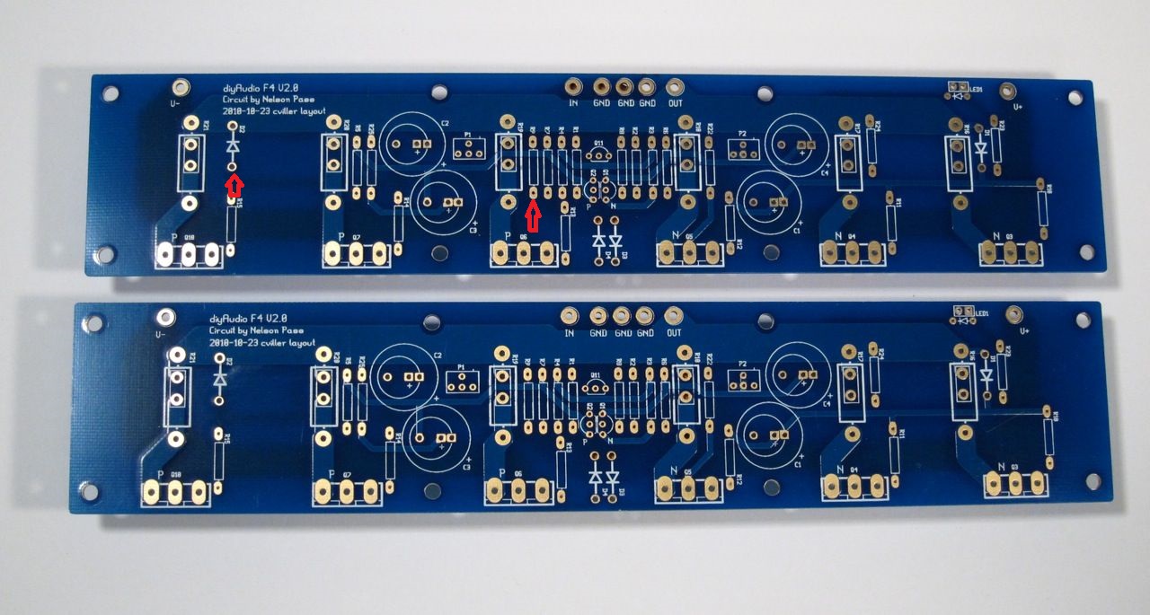

Measure Vref of the TL431. See attached image of board. One meter probe at D2 and other probe at R9. If the TL431 is functioning properly it should read 2.5Vdc.
To measure voltage at MOSFET gate, probe at Ground and probe at R10 for N channel and at R13 for P channel. Should read around 4.4Vdc or so.

Chip,
D2/R9 reading = -2.127Vdc VS. 2.5Vdc
R10 = -15.3 Vdc vs. 4.4 Vdc
R13 = -20.79 Vdc vs. 4.4 Vdc
So Mosfet gate measures are bonkers.
