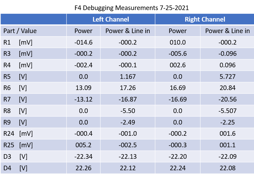

And I came up with new measurements for both channels, with power on and with power and signal in from Pre-amp [I've tested the Pre-amp many times and it delivers a signal to the left channel].
Looking at the numbers - the left R5 has a lower value than the right with the signal in on 1.167 vs. 5.727, but not sure what that might indicate?

It indicates less current than through the right channel equivalent resistor. You need help from bigger Boyz, but as far as I can tell it might affect / be caused by what’s happening at the drain of Q2. An obvious and possibly unnescessary question is: sure that R5 is 1k and R22 750R? And is the voltage at the negative input of the PCB the same as at the negative rail of the PSU?

Andy,
The R5 and R22 are correct resistors.
The negative input is the same as the PSU 21.62 all around.
New system goes in tomorrow. Old system hasn't crapped out yet.....

R9 might have been changed to 8.5k in order to be able to bias the Mosfets properly. It should not affect the front end so I see no need to change it if your Mosfets biased properly.

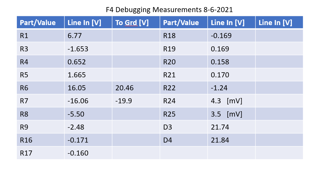

Looking at your voltages in your post #2788, I see that voltages with preamp connected and without the preamp connected are different. That is strange. I don't believe that should happen. Do you have another preamp or source that you can try?
Also when you provide voltages at resistors, please specify whether they are voltage drops across the resistor or at resistor referenced to ground. And if it is at a resistor referenced to ground, please show at which end of the resistor (mark on schematic). As shown, it is difficult to figure out what the voltages represent.
At this point it seems that one or both JFETs are not working.
I would like to bring up a previous comment of mine. You had bench tested the left channel and measured voltages that seemed correct, and then when you connected your preamp the JFETs seemed to stop working. You then replaced the JFETs, benched tested and measured correct voltages, connected your preamp, and again the JFETs seemed to stop working. So again, something about your preamp or your input wiring may be causing this.

I've attached new measurements, but as puzzled as ever.
