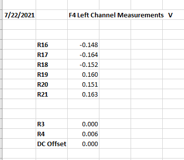

7/22 measurements
see attached chart
Also checked wires from RCA jack to board and speaker connections to board. Look good.
switched input signal left to right, no change.
Still feels like some simple issue, but I can't find it.

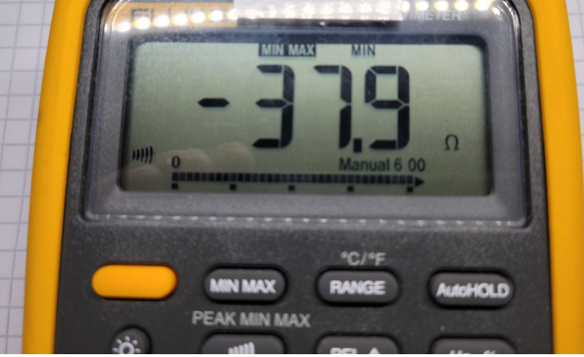

Right channel:
RCA input -37.9
RCA output -37.9
Quite different measures vs. left channel
Checking both RCA input/RCA output for left channel both beep and I get a -7.3 ohms reading.

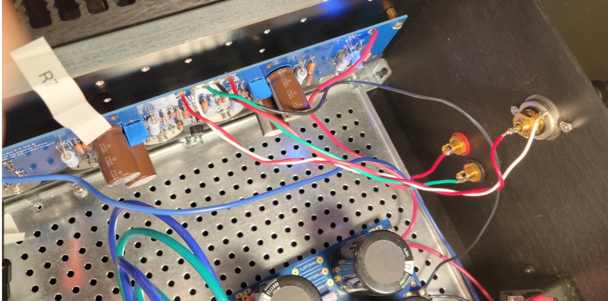

see photos

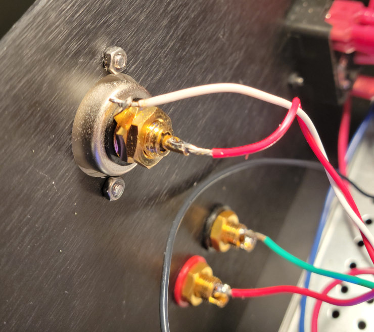

Are you sure that you haven't burn the input rca applying very hot airon for a long time?

Sorry, but please confirm you read in Ohms and not KiloOhms?
To check this you could for example cut both signal and return at the PCB end, isolate/leave hanging in the air, whatever works, and then measure resistance between the two input solder pads. R should be infite (many, many K). But if I remember correctly, you have allready tried swapping wires from side to side, so that excludes the input RCA, no?
Ohms
see photo
