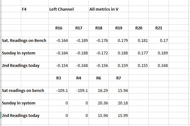

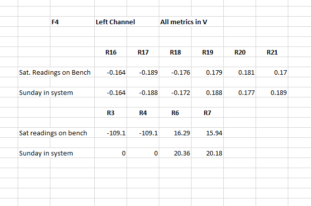

Sunday Update
Yesterday I put everything back together on F4 left channel. New bias.
And took readings on my bench.
Everything looked good.
Today I put the F4 in my system.
Still no sound out of the left channel.
And no readings from R3 & R4
See attached chart.
Not sure next steps.

Unless the new R6 and R7 values are in error, they suggest additional current draw
missing in the "Sunday in system" measurements. I would think the front end is
the natural place where that's coming from that is inconsistent with the reported
R3 and R4 voltages of zero.

Voltages at R6 and R6 are different in your latest chart so there is a change.
Or are they errors?
You are correct. Those are new readings.
I was more focused on NC in R3 & R4
I have a feeling this is some simple thing I've mucked up....
Those voltages are low considering that you measured no voltage drop across R3 and R4. The low voltages at R6 and R7 point to current flowing somewhere, but no voltage across R3 and R4 says that the current is not flowing through the JFETs. So where is it going?

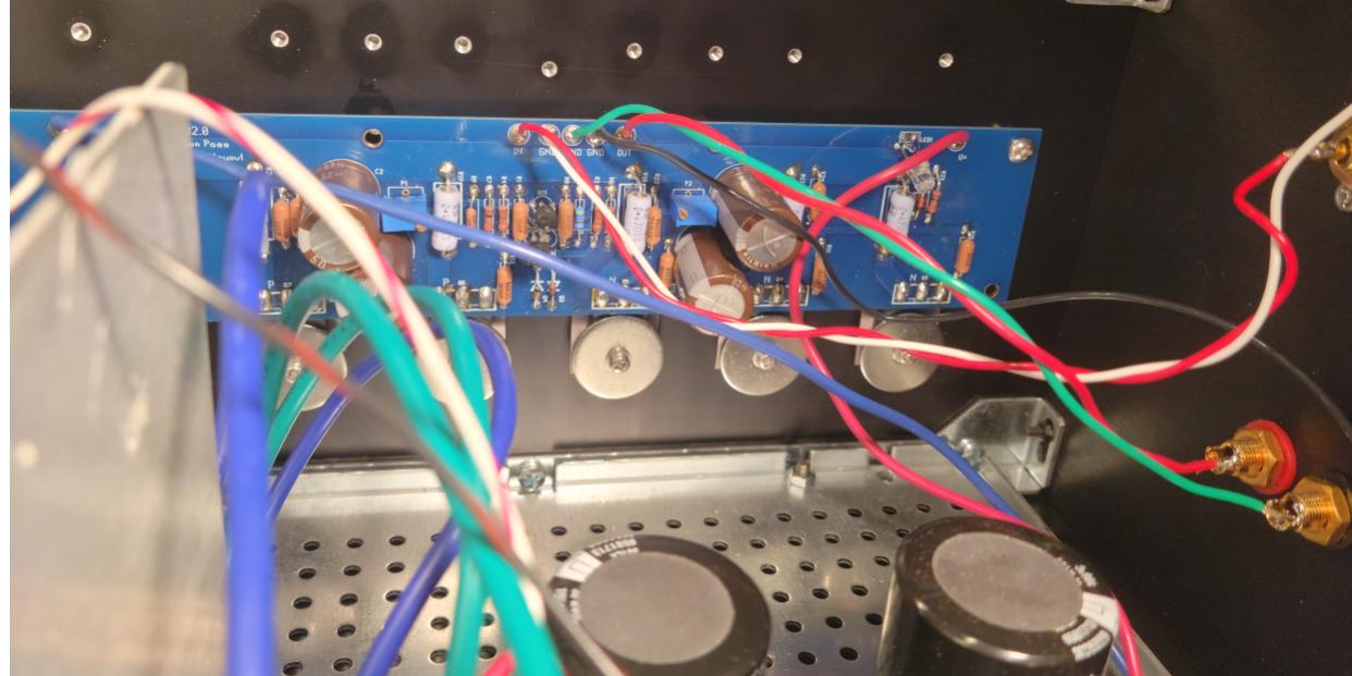

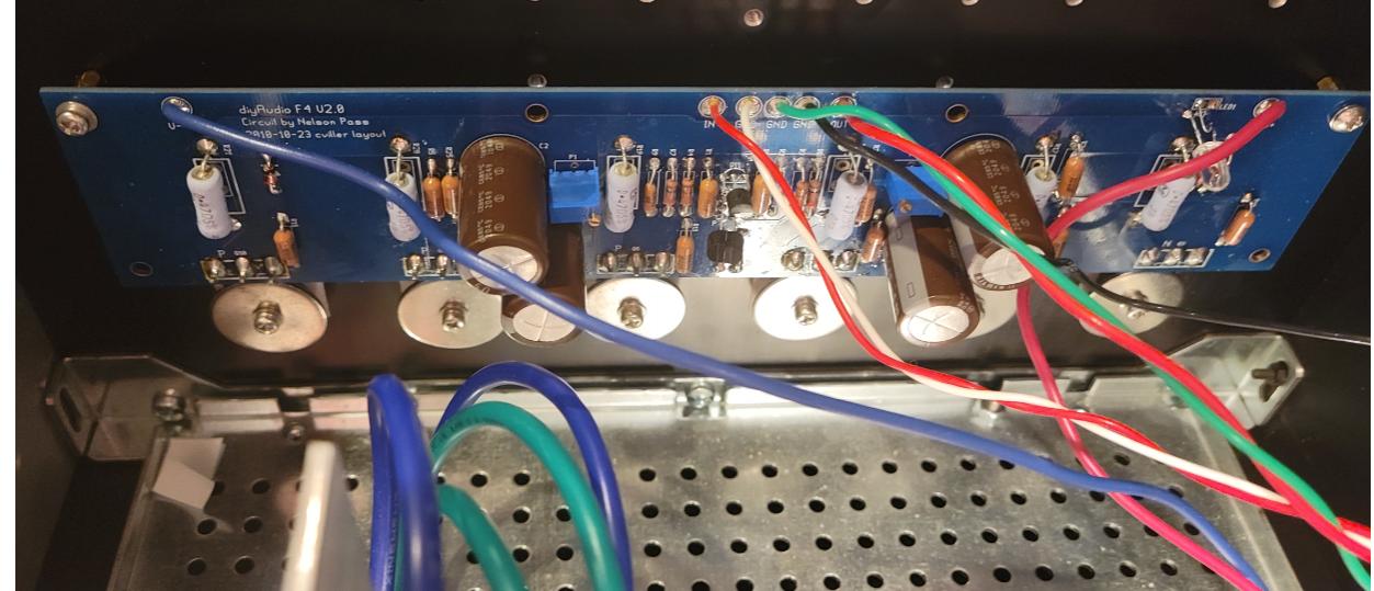

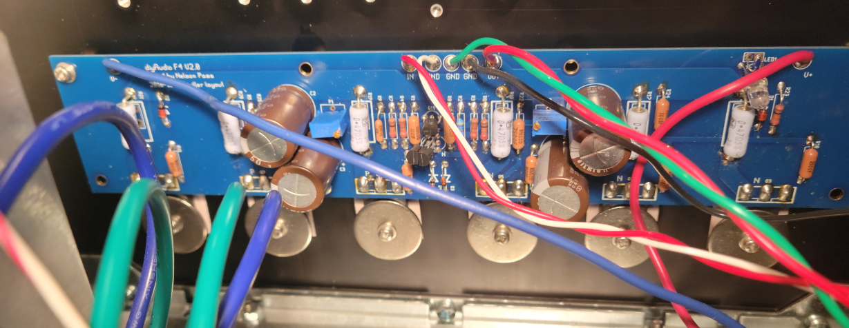

Also some focused and detailed pictures of the board and amplifier please. At least one good picture of the overall layout showing input jack and whole board too.

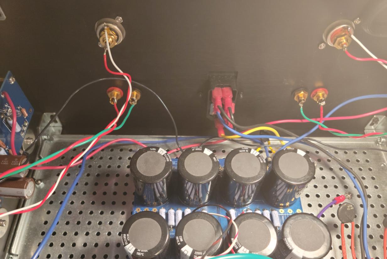

Ok. I will get to work. In the mean time, here are some photos. For some reason I couldn't get them to upload yesterday.
And thanks for the help.
Chip
Chip

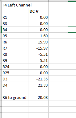

See attached chart for values
Chip,
Previously when you gave the voltage at R6 and R7, were they relative to Ground as I had asked in post #2707 (A guide to building the Pass F4 amplifier.)?
When I ask for voltage "at" a location, that would be relative to Ground. When I ask for voltage "across" a component, that would be at the component with one probe at each end of the component.
Please measure the voltage at R7 relative to Ground (as shown in post #2707). I had a typo in my previous post and asked for R6 and R6 when I intended R6 and R7.
The voltage drops across R5, R6, and R7 indicate approximately 1.6mA of current in consumed by the front end circuit. That is consistent with the front end current draw with the JFETs not turning on and not working.
Looking at the latest measurements, the voltages across D3 and D4 look low. That voltage should be equal to the power supply voltage. Please measure the V+ and V- voltages relative to Ground, and the voltages at both sides of R1 relative to Ground.
If your power supply voltages measure +/-21.4V, then the voltages across D3 and D4 are equal to the power supply voltages as they should be, and if the voltages at R1 relative to ground is zero, then the voltages to the JFETs are good. The bad is that the JFETs are not turning on even though they are provided with the proper voltages.
The bad news would be that the JFETs don't appear to be working even though you had tested them when they were off the board and that they seemed to be working when you bench tested the channel after reassembly.
So then the possible reason is bad solder joints or bad JFETs.
