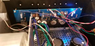

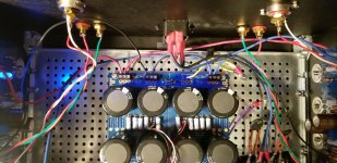

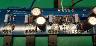

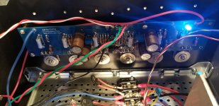

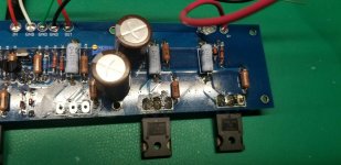

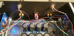

I'm missing something. Photos attached.
Appreciate another set of eyes on this.

I'm getting 22 DC V from both channels of the PSU.
I unplugged the right channel and turned the left all the way up. I can hear music very softly and it is distorting.
That's not good.
That's not good.
When you had the board out of the chassis did you disconnect the input and output wires? Have you checked those connections for continuity?
Set your multimeter to the lowest resistance setting and place one probe on the RCA positive (inner ring) and the other probe on the signal input positive of the board. Also check signal ground from RCA to board, speaker positive to board, and speaker negative to board.
If you measure very low or no resistance, you have continuity. If you measure resistance then there is a problem.
Yes I did.
And no I did not check for continuity.,
How do I do that?
What about your input buffer on the left chan? your left channel JFETs and associated resistors: All good joints and clean of flux? Correct JFET in correct position? Do the left channel JFETs measure the same as the right ones?
Ben, thanks for the help. I checked all the connections and they are good.
how can I check the TL431 short of removing it?
I checked all the resistors. Did not check the JFETS
Yep
Yep
How do I measure the JFETS?
