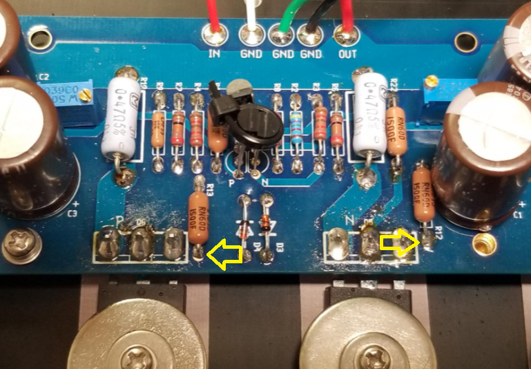

Ok. New Problem. My left channel won't bias. I've turned P1 all the way in each direction, but no heat. P2 works.
From research it could be one of many things:
1. TL431 [post 2144 & 2161]
2. Polarity of Mosfets [post 1200]
3. Soldering of source resistors [post 1200]
4. Shorts under keratherm [post 1200]
5. try 6.8K or 5.6K at R9 instead of 10K [post 1507]
6. Try 47.5k at R8 instead of 47.5K [post 1523]
I tested the Tl431 before installing. I"m using either TL431BQLPR or TL431AIZT
I started with the Variac to test for shorts, none seen
I checked the left board against the right circuit board which biased just fine.
I checked for shorts on the Mosfets, nada
I guess I'll swap out the TL431 first, then make resistor change at R9.
Any other thoughts? Thanks

Not saying it's the problem, but if you want the same TL431's that I use (ON Semi, 40 uA minimum cathode current), send me a PM and I can mail you some. But, assuming properly installed parts, adequate soldering, isolated mosfets, etc. You need ~4 volts from G to S to get these output devices woke up. I built my boards with a 5K at R9.
from cold you ought to have same resistor values in both channels
what is voltage between N and P mosfet gates (that's A-K of TL431, convenient place for probes, take care of probes slippage) and is it varying, if you fiddle with P1?
Zen Mod, I don't get the reference to A-K if TL341. Where do the probes go?
All Good
I started today by measuring between N - P voltage, 2.3 V still no heat.
I swiped out R9 for a 5K resistor. Still no heat.
I swapped out the TL431.
This time plenty of heat, but I couldn't control the biasing, P1 was all the way out.
So I replaced the R9 with a 10K.
This time everything worked.
I've held at 190 mV for two hours.
I'm not sure what was the issue. I did use a TL431BQLPR TL431 instead of the TL431AIZT.
So it goes.

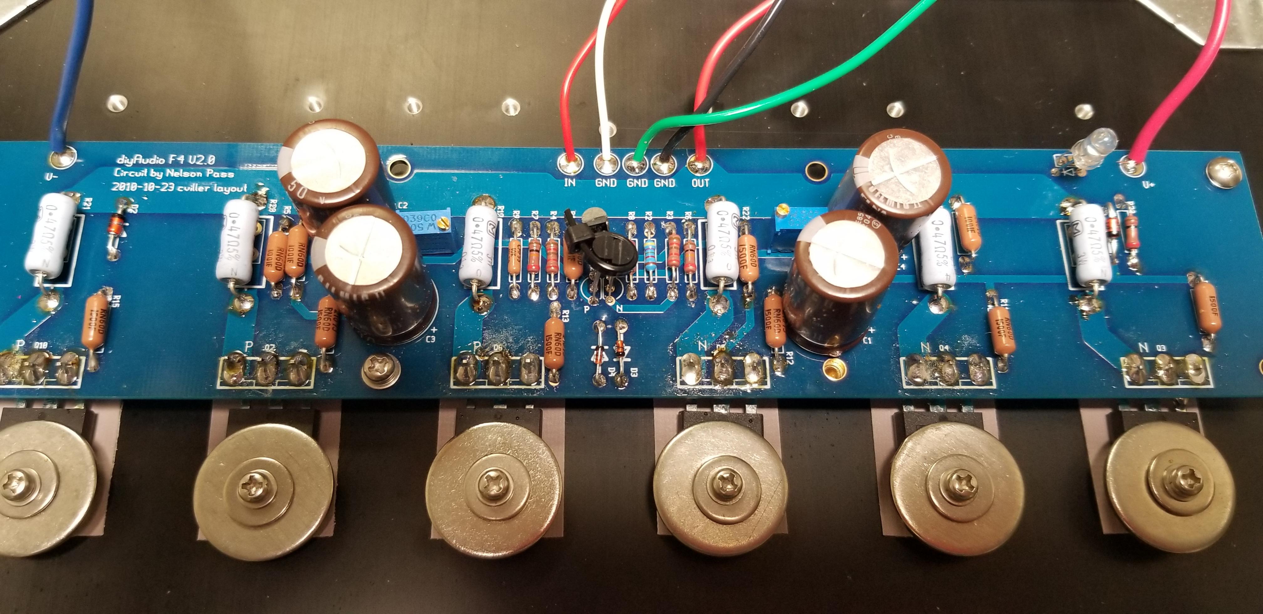

After several days listening [sounds sublime] and the amp running 8 hours a day, today I noticed the right channel was louder and the balance was way off, favoring the right side - really annoying.
My measurements:
Bias Offset heatsink temp
Left 190 0 42 C
Right 190 0 52C
I lowered the right bias to 160 and the temp only lowered to 49C.
Something seems amiss - one of the Mosfets not working properly?

check for uniformity:
-torque of mosfet screws
-voltage at/across all source resistors
re-check all solder joints
F4 is damn follower, if you have lower output - it's either problem with pre (swap channels test) or trivial problem with interconnects/contacts or ......... Gremlins
temperature issue - hope it'll be clearer when you check all source resistors
