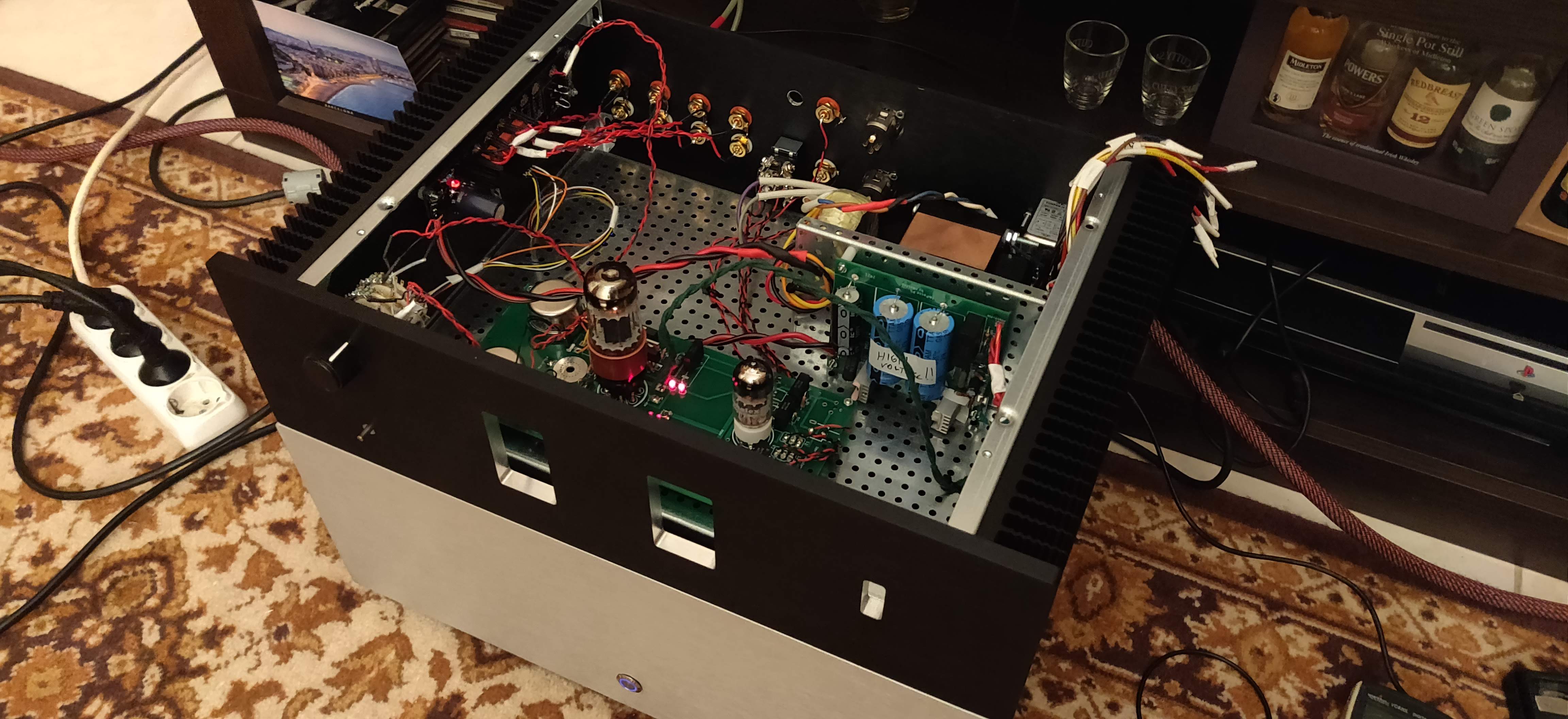

And here my ImPasse (in progress) with a salas input selector on top of my F4, great combination!
I am going for a second F4 soon!

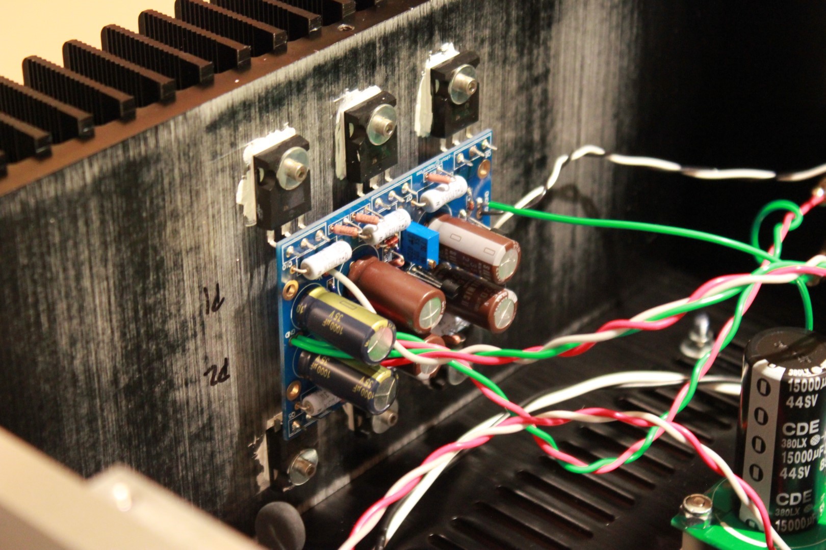

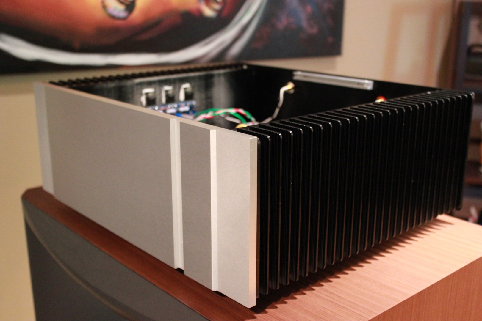

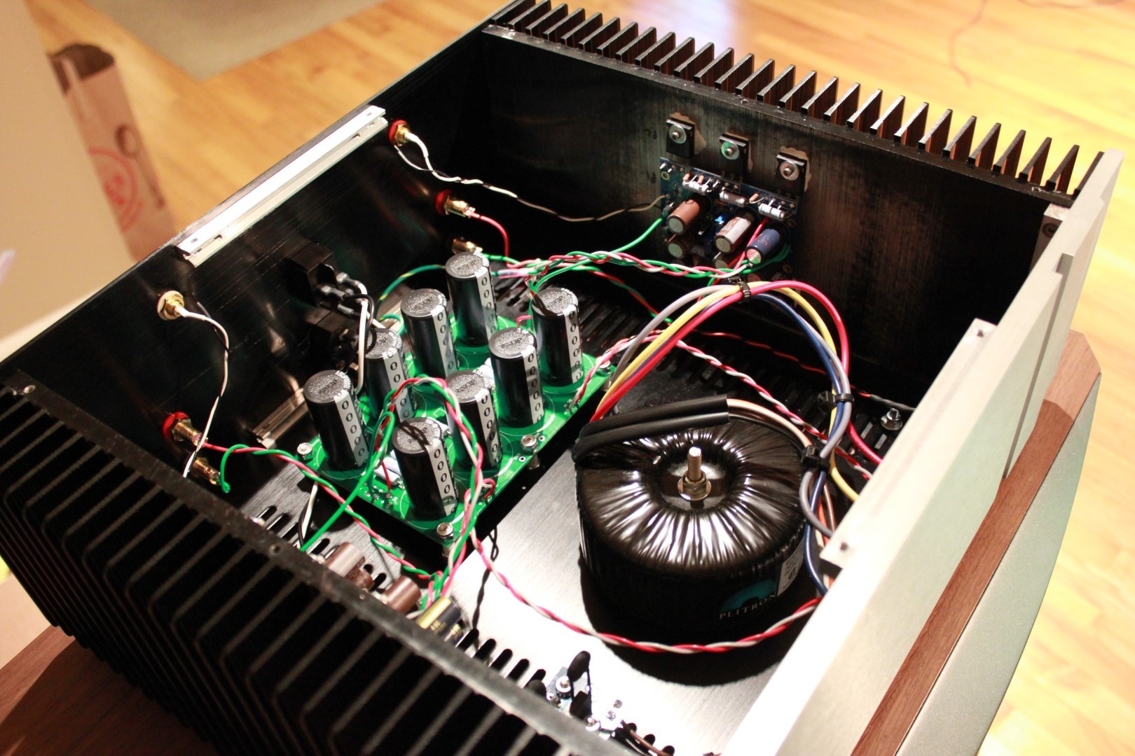

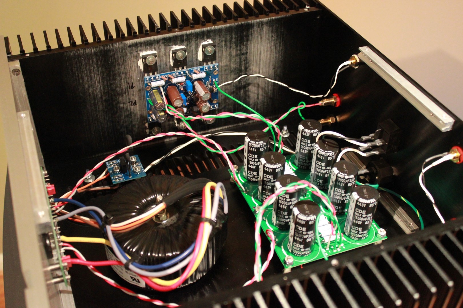

Another successful F4 build, again using some parts that have been sitting on the shelves for 10+ years. These are the Peter Daniel boards with Plitron xfmr. Few building tips:
1 - Don't install capacitors backwards, they blow up!
2 - Peter's boards have a separate ground pad for the input that has to be tied back to PS ground, missed that for a few days and could not figure out why it was so noisy on both channels. After grounding, dead silent. Amazing concept!
3 - Ended up at ~6.9k on R9
Thanks again for these great amps.
