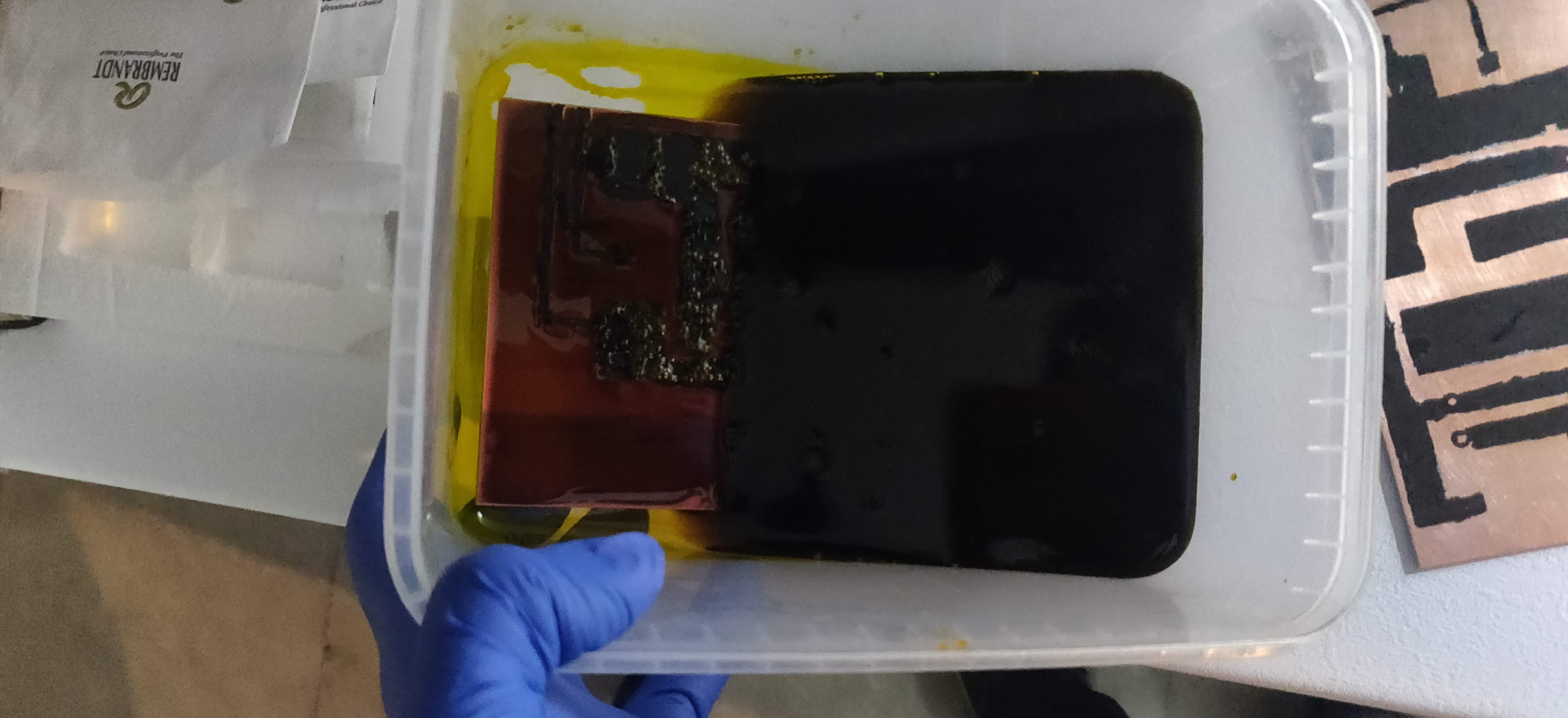

^ I have been making more boards like that lately. It is pretty simple to do, just a little care with the Dremel tool or Xacto knife is needed.

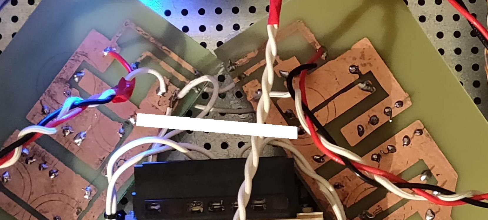

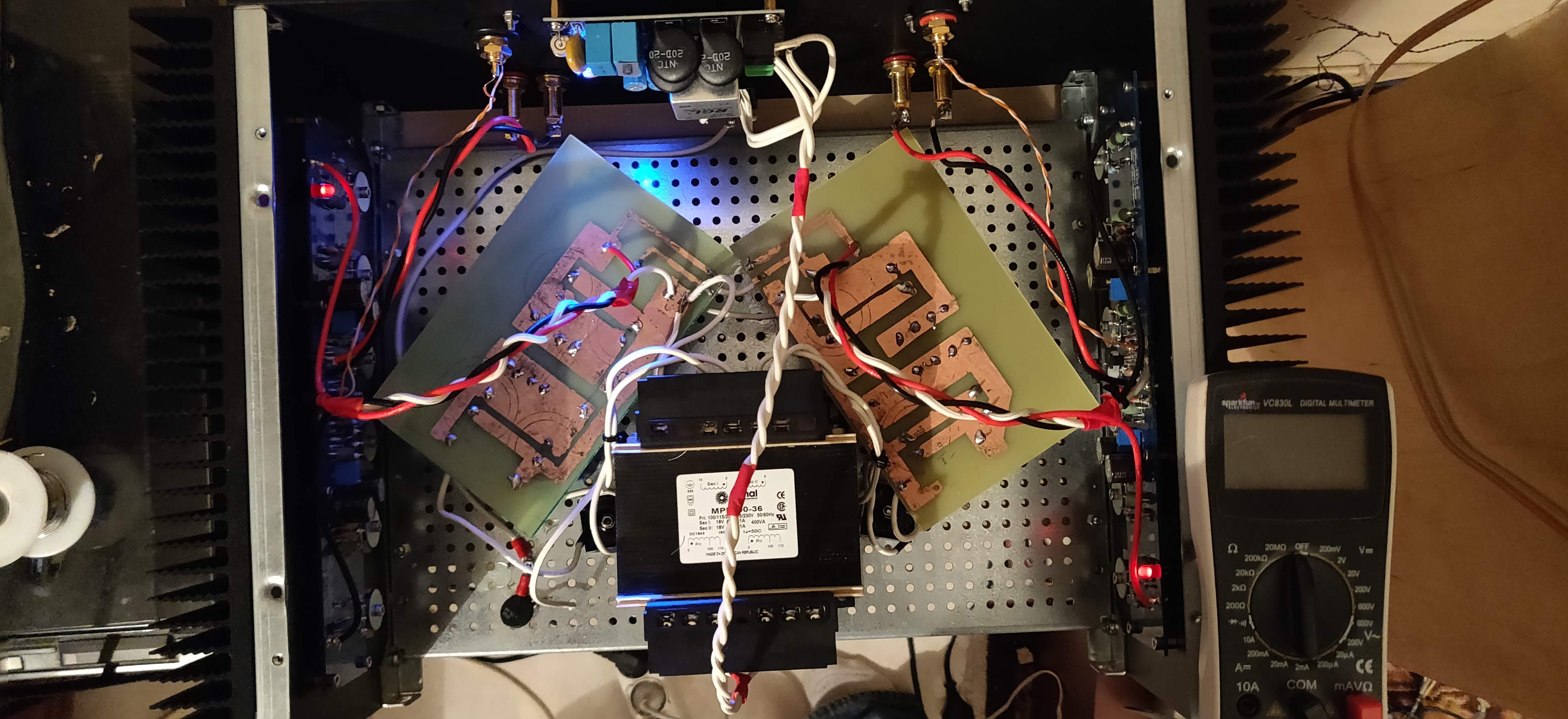

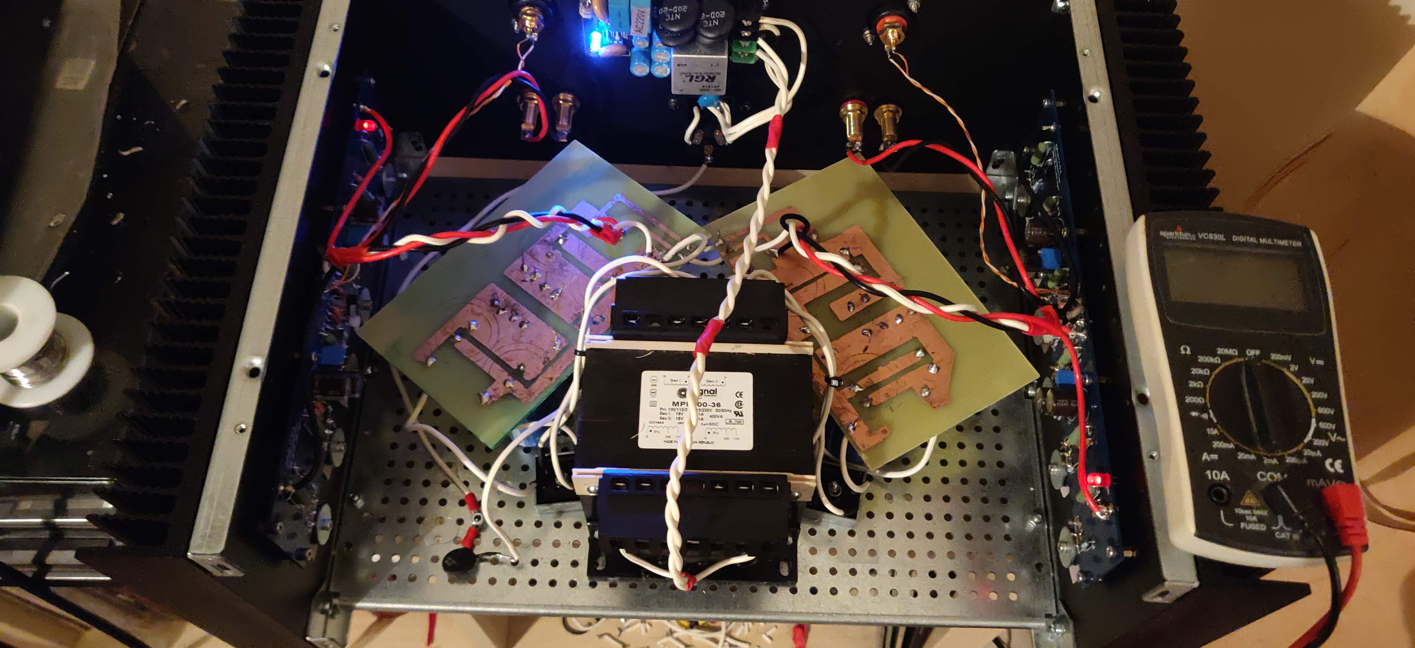

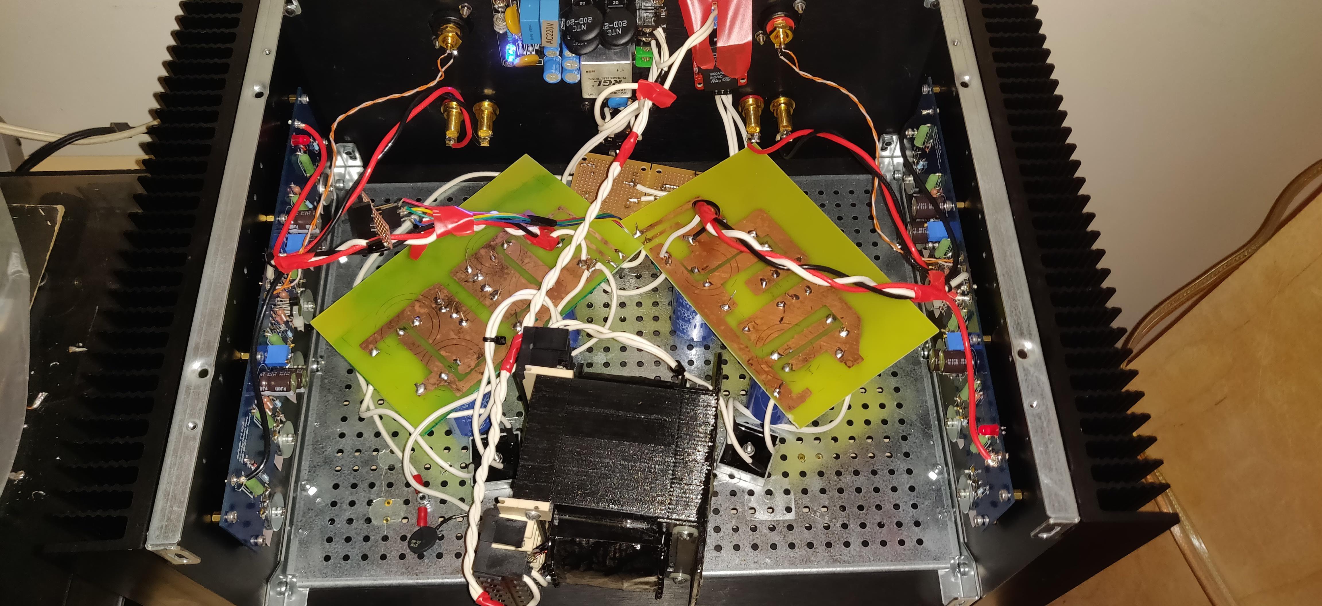

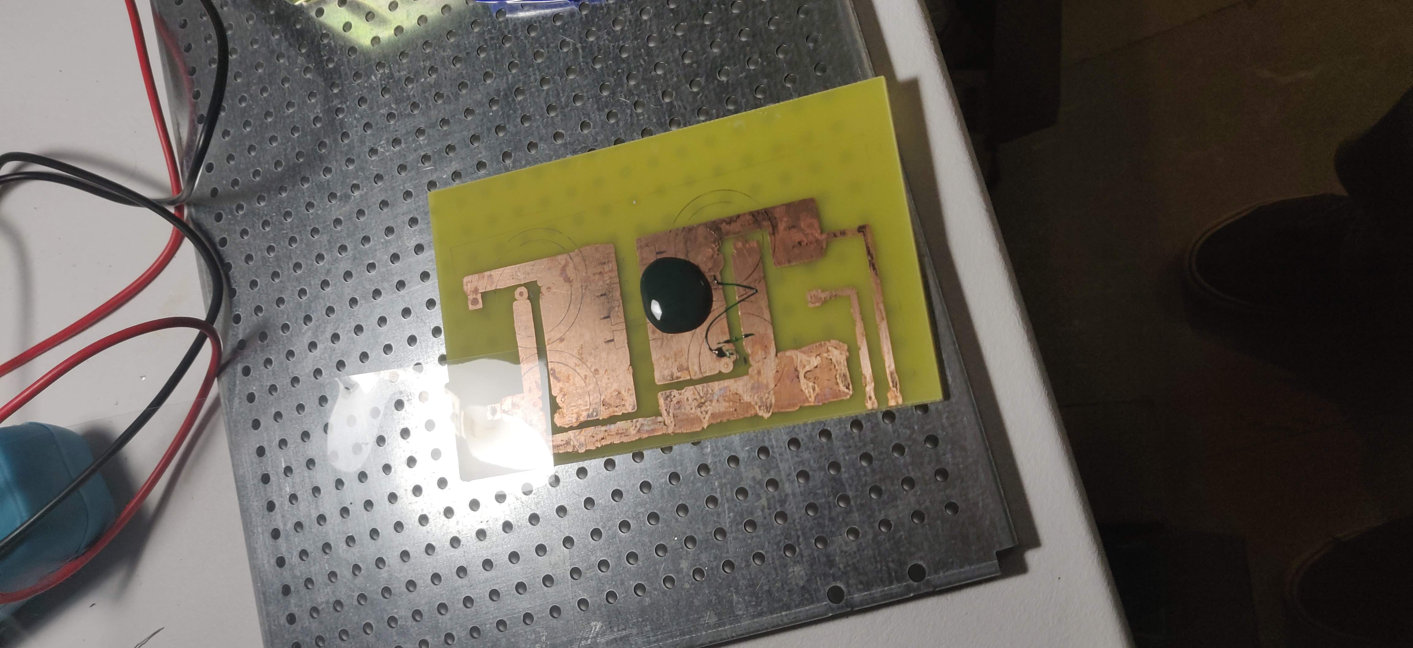

I made two boards the old school and rearrange the setup. Not finished yet.
I cannot believe that I cannot fit everything in such a huge case!😛
So what I did:
1) Two pcbs with the power supplies connected with a small cable on the end for the Grounds
2) Twist cables 220v and 24volts
3) Moved transformer to the front
Have not yet done twisting the bridges wires.
The hum (50hz) is still there. It is much less audible but it is there. The speakers are 96db. It is a difference off course.
It happens only when someting is connected to the amplifier.
I will continue the rearrangement but some suggestions would be great!

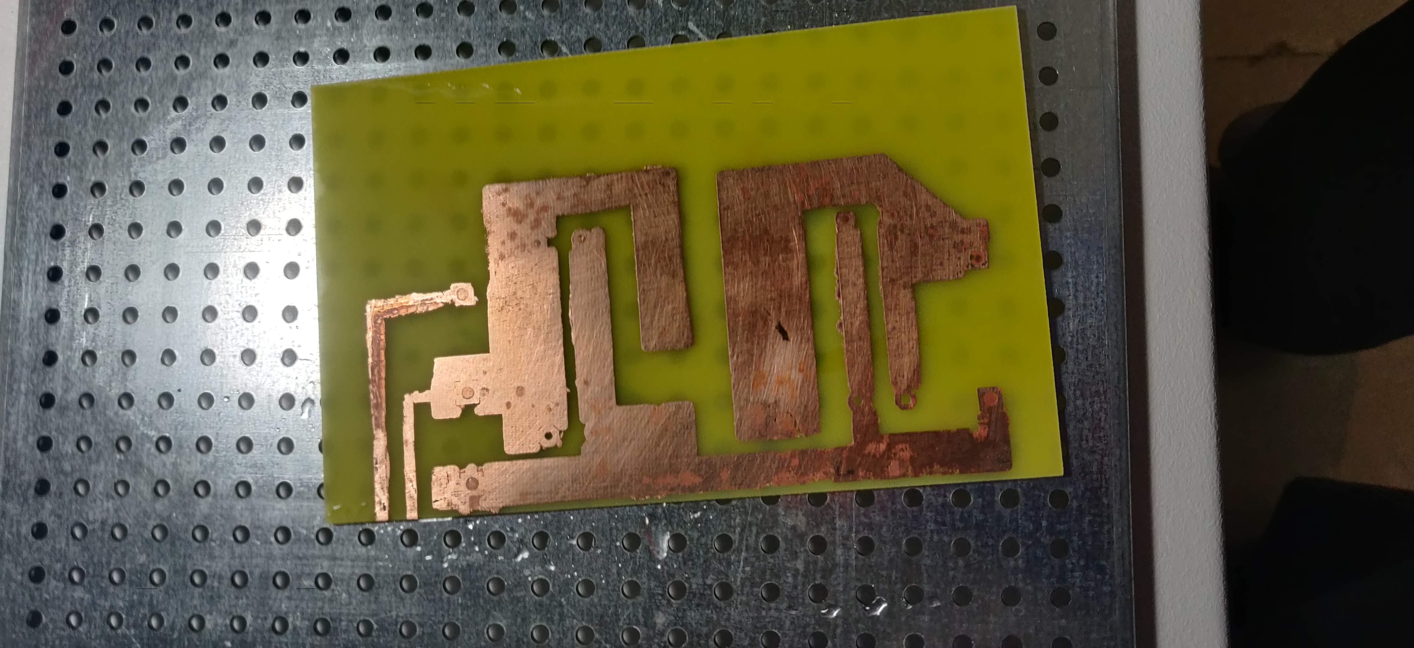

I have etched many a board that way. I make a template on graph paper, tape it to the bottom of the board, drill the holes part way. I then pull the template off the board, take an artist brush with Testors model paint and connect the dots. I then bake it in the oven for a short period of time. After etching I remove the paint and finish drilling the holes. By not drilling the holes all the way through, the board will float face down during the etching process. Heating the ferric chloride speeds up the process. Great for one of a kind boards in a hurry.
This still hums with both inputs shorted together with no other equipment connected? Not saying it will fix anything but remember that there are huge nasty current pulses in those rectifier wires. That puts those high on my twist list. Is your transformer interwind shield connected to the chassis ground point? I personally like that chassis tie point a few inches from the AC inlet ground at the back. I've been getting more interested in these SMPS solutions lately and might start going in that direction in the future. Quality seems to be much better than 10 or 15 years ago.
Looking at your latest changes... if someone handed me this amplifier I would add a run (or two) of fat ground wire (because of the long distance here), as indicated on this picture. And don't connect anything else to this added wire. We don't want any of our other grounds "between" those two points directly between those capacitors as you have it now. We need a little distance there where we branch off our "sensitive" grounds to the rest of our circuit. There is current traveling directly between the capacitors we want to stay away from. Not saying this will solve everything, just good practice in general, and something I would do at the start before looking into other potential problems.

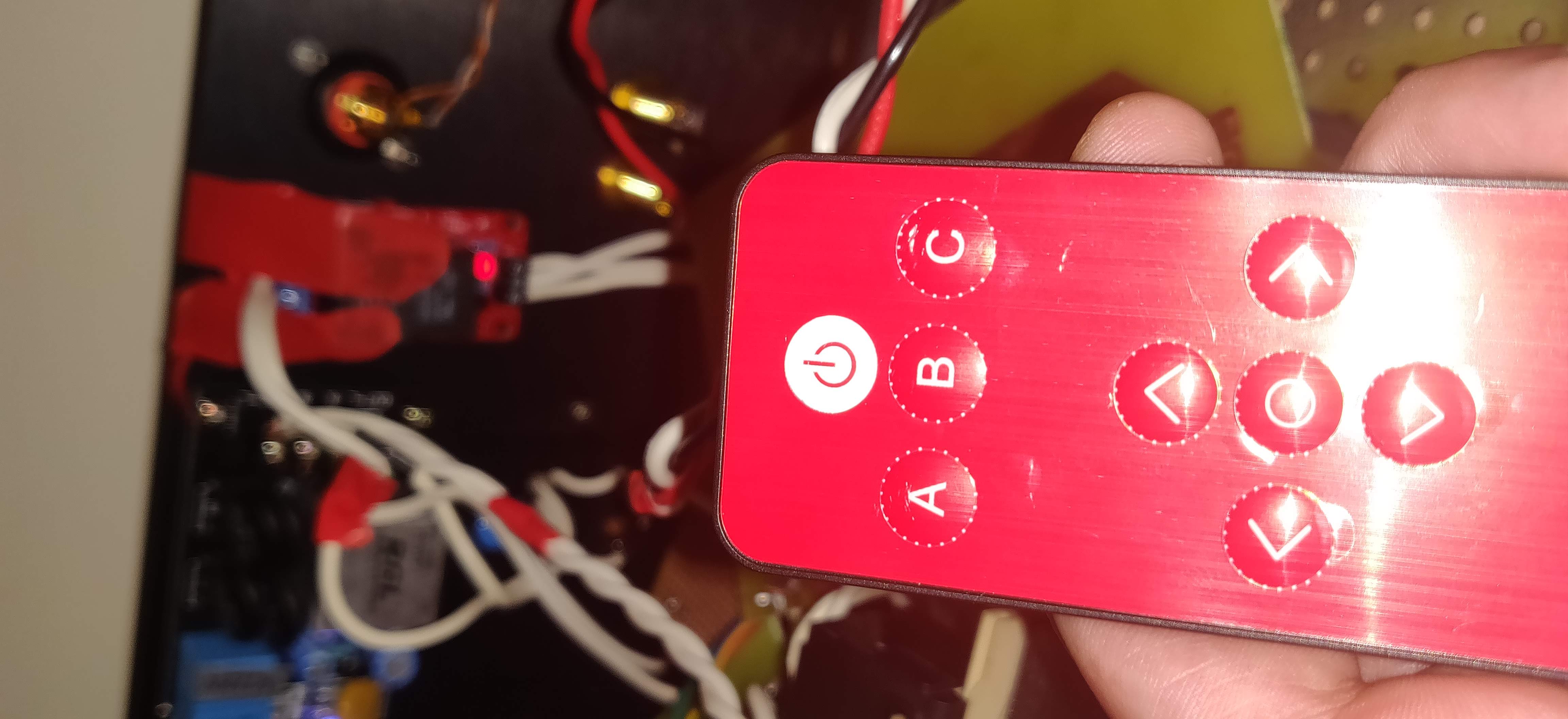

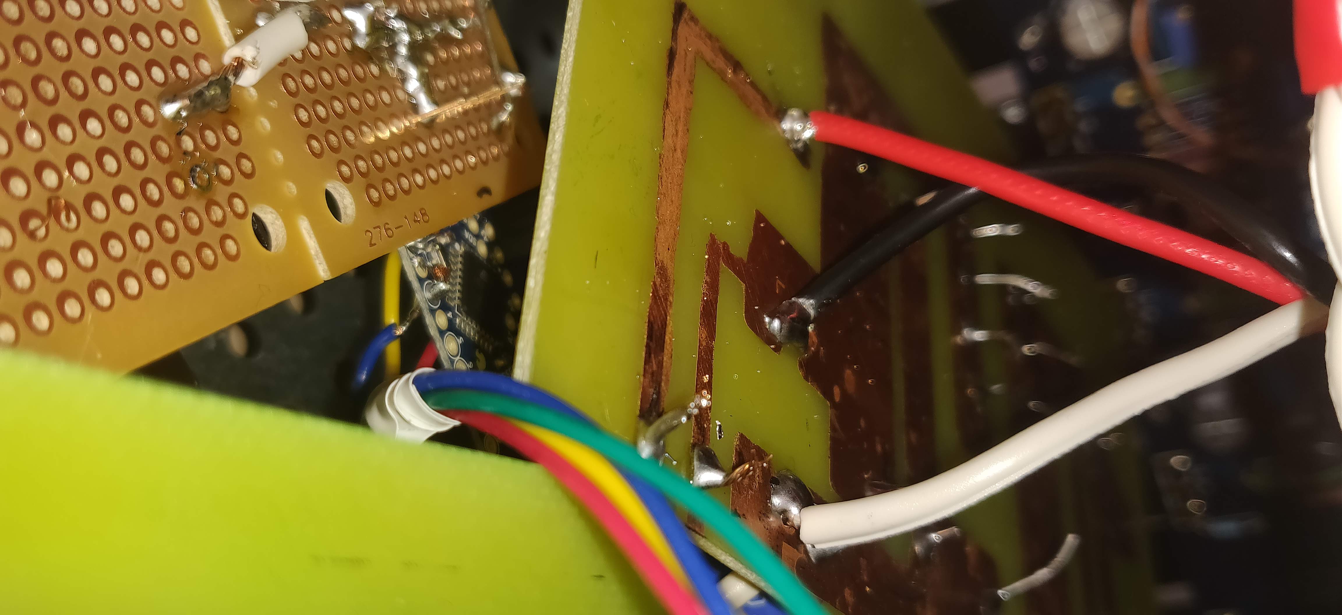

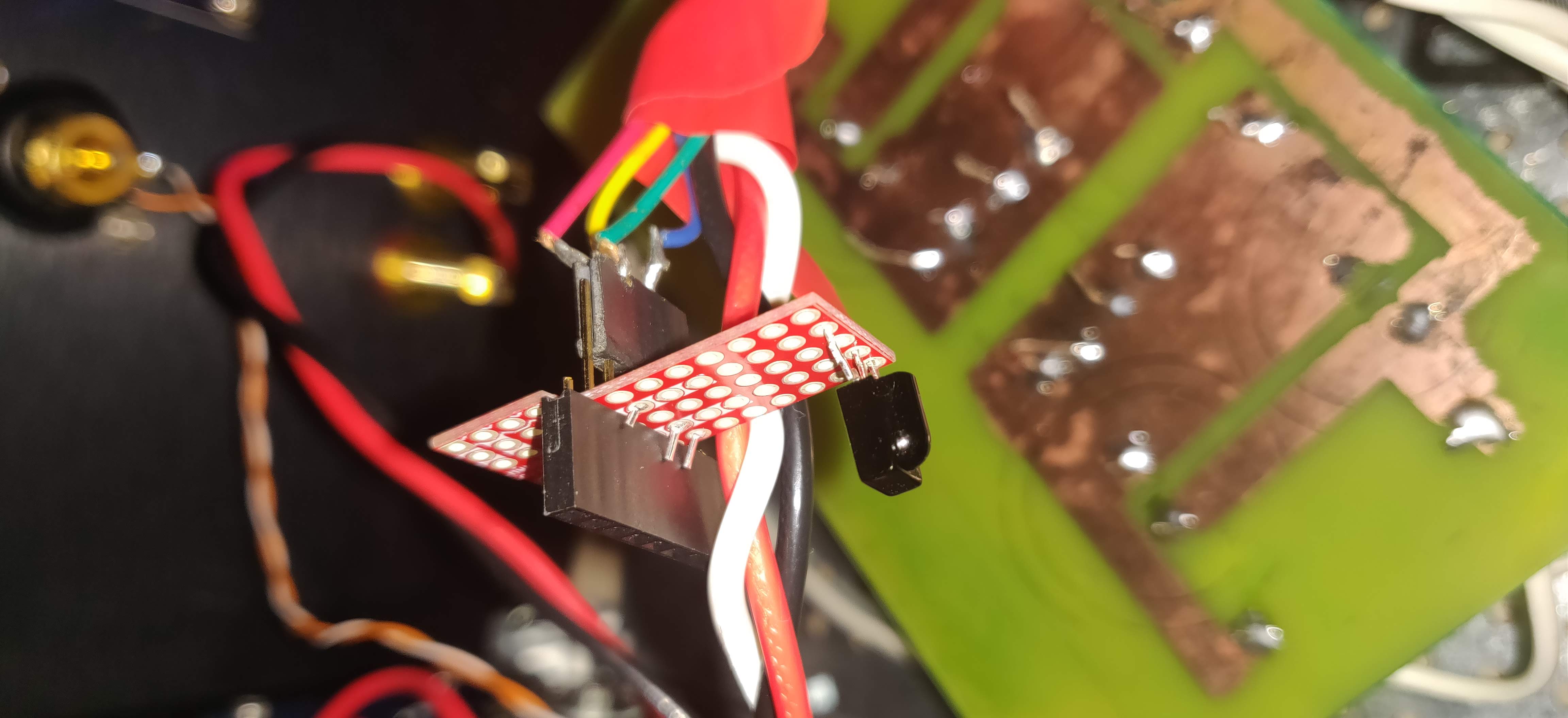

Today I was a little bored on working with the power supply, so I started working on a simple remote control to power on and off the F4, I will extend it to support my preamp and dac (from the same remote).
Is not properly connected just testing. Some photos here and also If anyone is interested I started a thread here Arduino Based Remote Control
I have opensourced the code and I will add more features in the future (I hope!)
I have added sleep mode so the amplifier is always on standby but it consumes less than a milliamp ( sustainable🙂 )
It is fun to be able to open and close the amp from the couch!

Hello
I finally found a way to completely stop the hum....
I drop the transformer on one side and if it is 90 degrees on the side no hum at all...
what does this mean?😕
I am starting to clean the mesh and finalize the inner setup and apply the other comments that you told me!

Hey, nice work. I was wondering if it was the transformer but hadn't thought of flipping it like that. Here is something that Nelson had posted awhile back about the toroid's in these amps... found with the search function.
"Originally Posted by Nelson Pass View Post
Something I have always done on FW amps is to rotate the toroid +/-60 deg
in operation, as one position will give minimum noise. Usually there is a
lobe of radiation, and pointing it at (or away) from the right spot is a big help."
