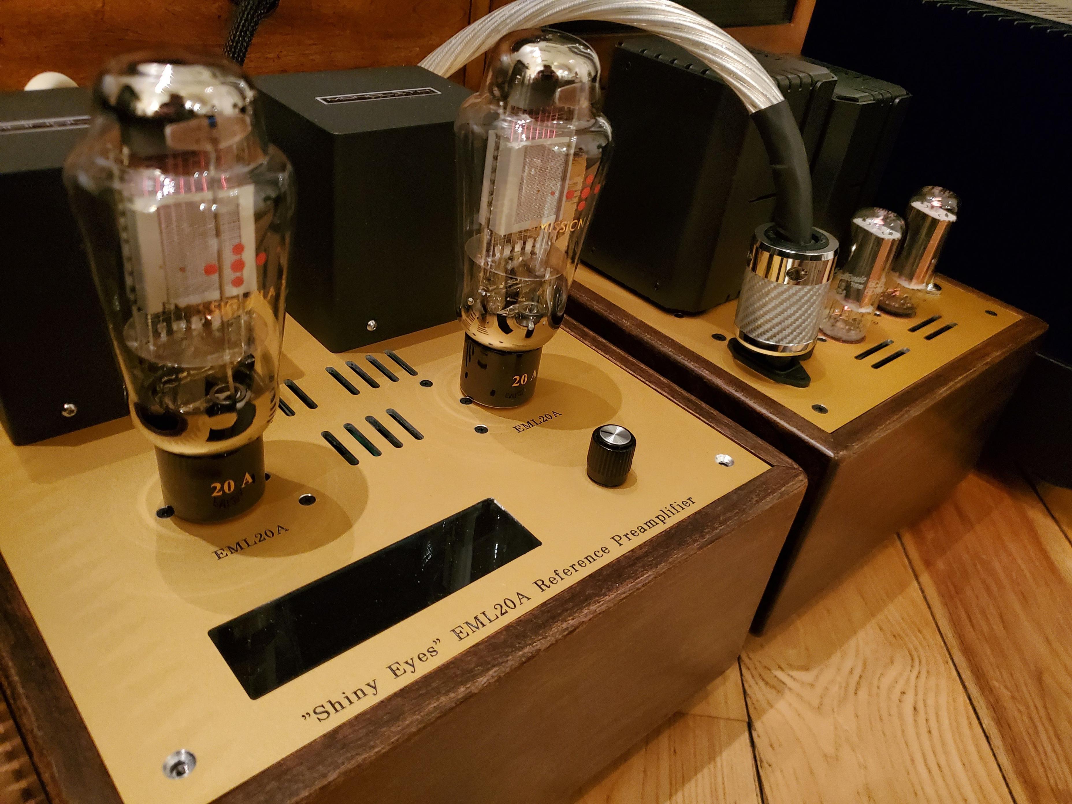

3rd. I use a Shiny Eyes DHT pre built by Radu Tarta that's based on the EML20A tube (for maximum gain from a single stage design). It outclasses my previous 6sn7 based pre in every way. Amazing really.
Not only does your pre use a EML tube, but those output transformers are not for the faint of the heart! Those are Monolithic Magnetics from Belgium! Expensive but high quality.

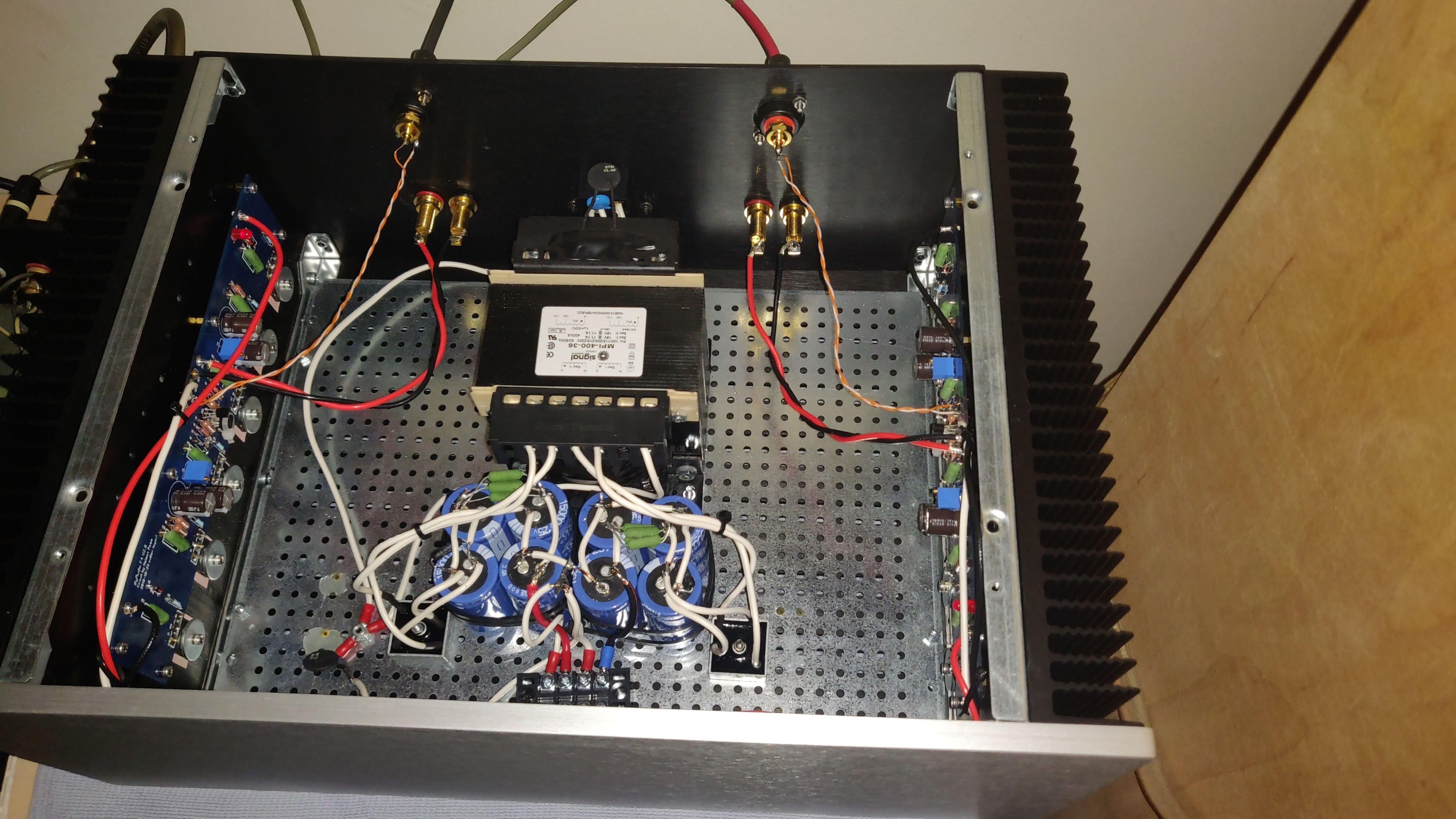

Hello,
I have build the F4 before some weeks and is a great sounding amplifier.
I have an issue that many members have helped me here.
I have o 50hz (I am in europe) hum when the amplifier is connected with other equipment or when I connect both inputs together. When both inputs are open there is no hum.
So I am thinking of a ground loop right?
When the amplifier is connected to other equipment and I am sorting the right input to ground the hum continues. When I sort the left input to ground it is less audible but audible indeed.
I am thinking of changes on the power supply:
1) Change transformer (does it make any sense)
2) Align the capacitors in a straight line instead of quads (I believe this was ZenMod indirect suggestion?)
3) Change the T bar of the ground with something with less resistance(now it is from thick wire maybe a copper bar)
What do you think about this? Do you think that maybe there is a problem with the channels (I have used the diyaudio store boards)
I am certain it is not RF EMI because I have made a lot of experiments by moving the components, adding shields etc
For everyone who'd like to help I am attaching a photo of the inside!
