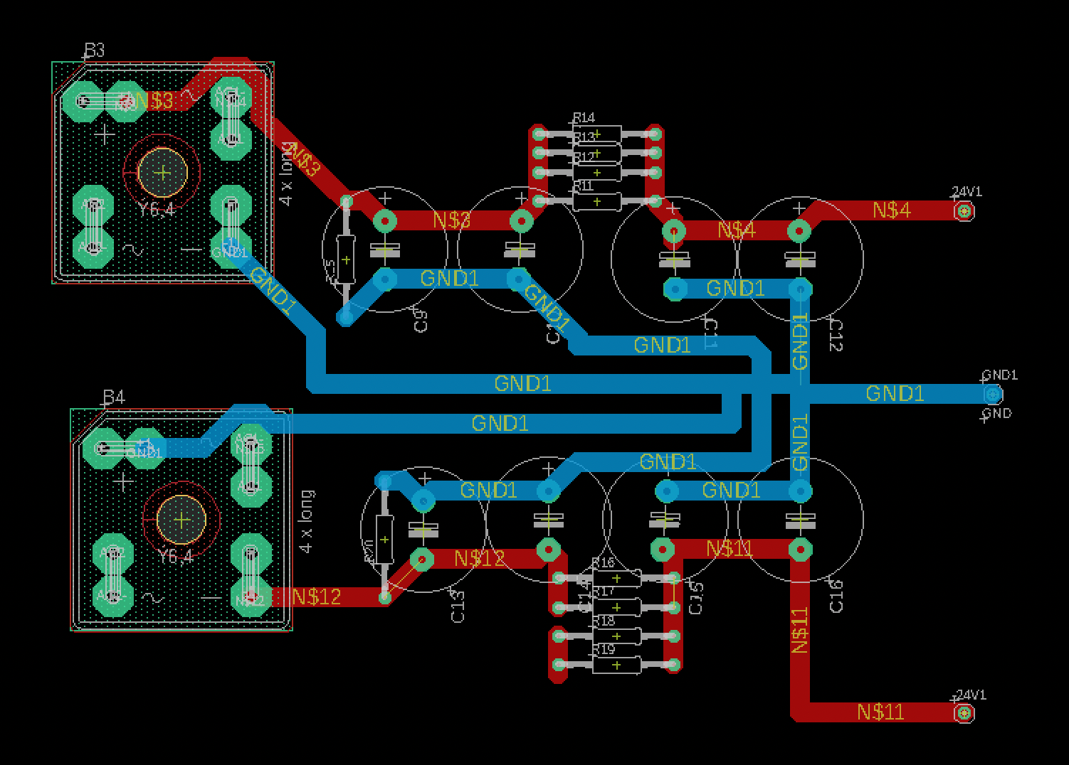

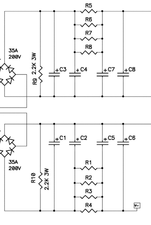

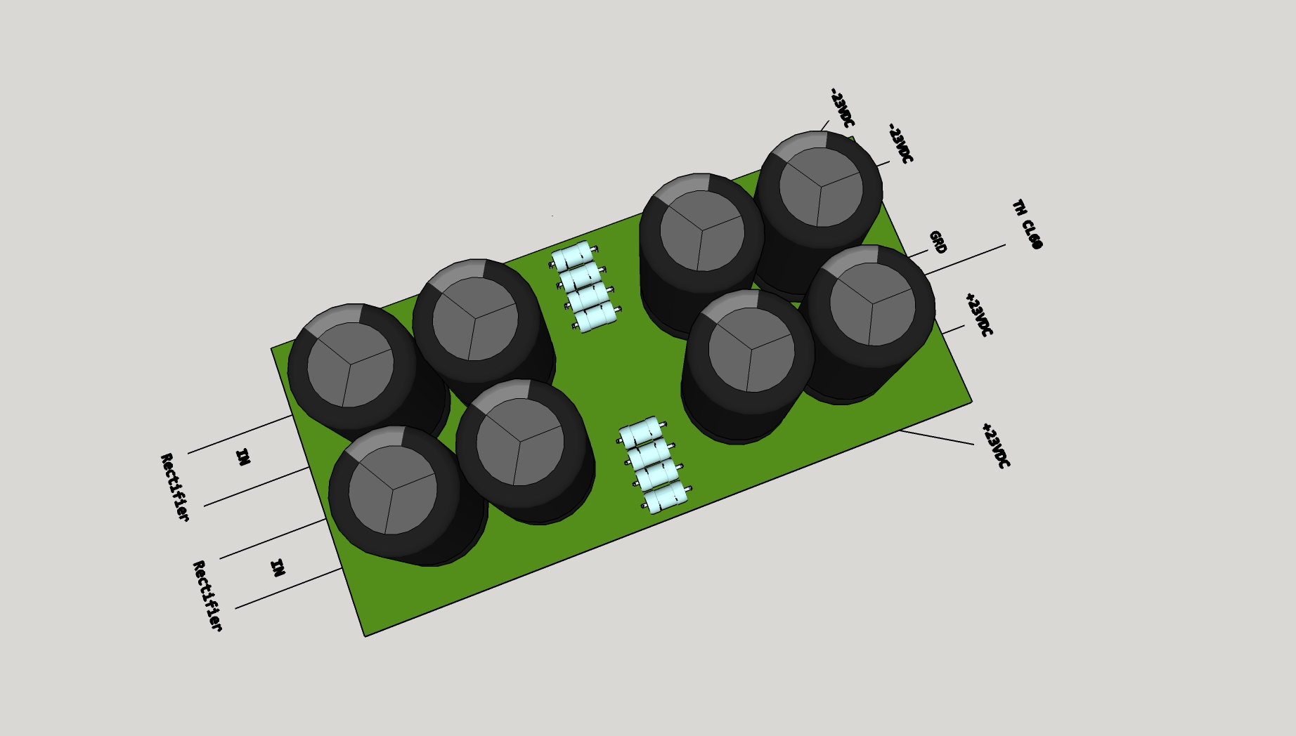

Hello I am trying to recreate it but i see that on the minus supply the R is on the PLUS of the capacitors not on the MINUS as Nelson schematic. Is It right?
of course, blame on me
was sorta in hurry and simply forgot few finishing steps when I copied upper to lower half
but you're getting what's important
if needed, say and I'll upload proper (edited) sketch

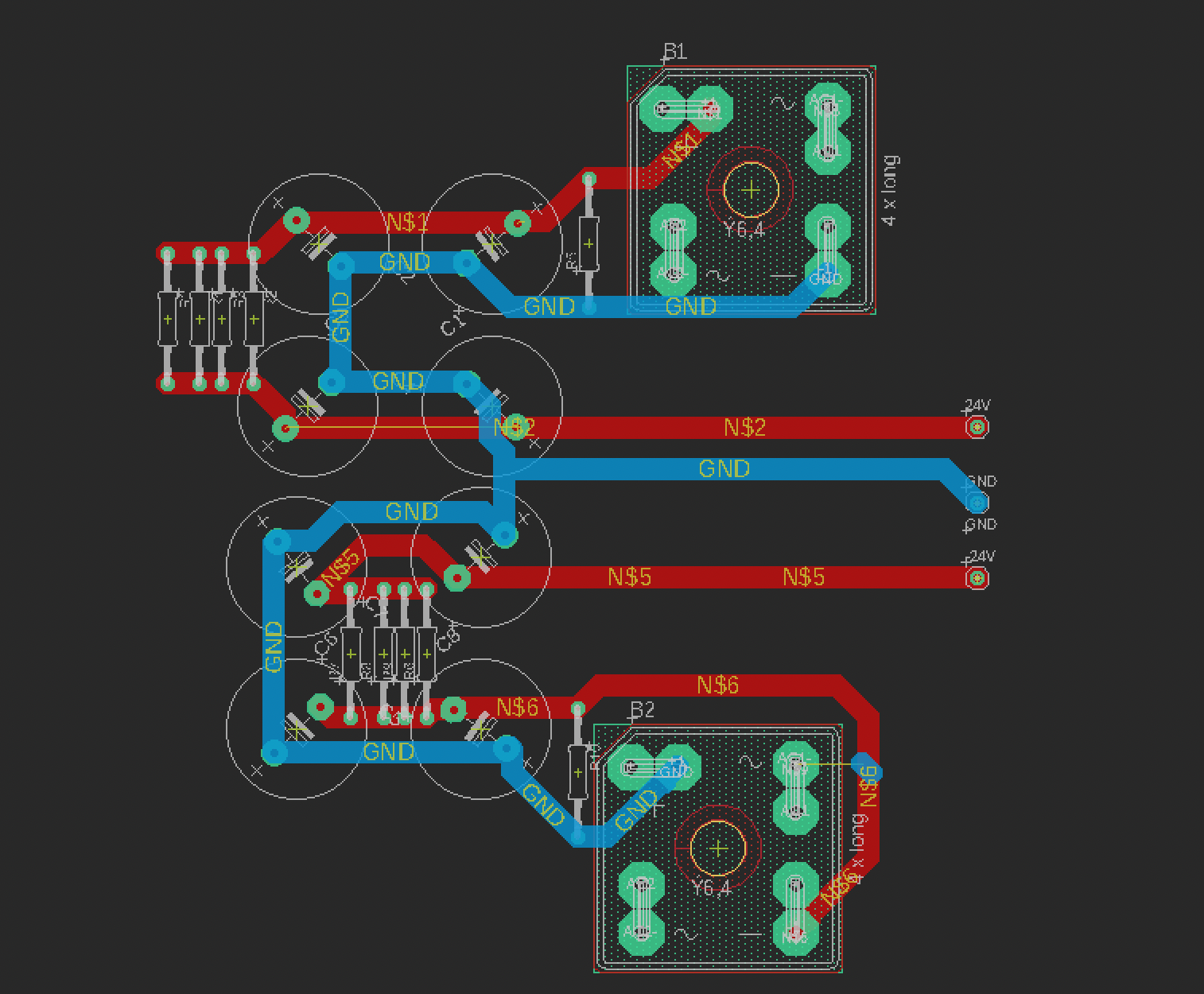

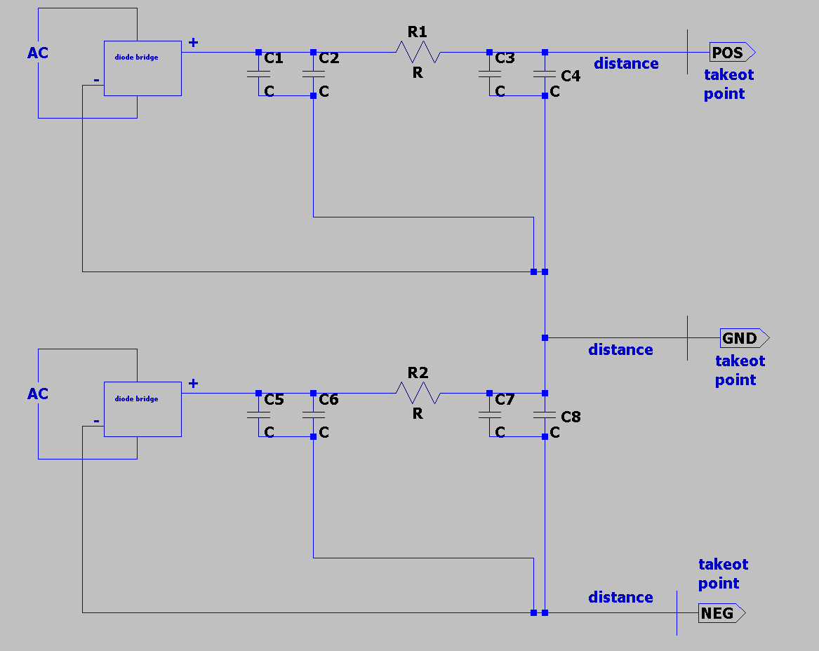

So i am attaching a drawing of the old and new physical design.
The distances are the real ones.
I tried to rotate it as you suggest.
My questions are:
1) Is this what you mean? 🙂
2) You believe it is better to connect the grounds with different wires than on a straight line?
3) You believe that my worst problem on the original design is the T-shape ground that I is too small, I need more distance?
And finally! the case doesn't fit four capacitors in a row! Should i try to fit them in a row?
I try to plan before changing the circuit so excuse me for all this questions!
My questions are:
yes for that right pic
organize caps in shape as you can, but wire them according to right picture

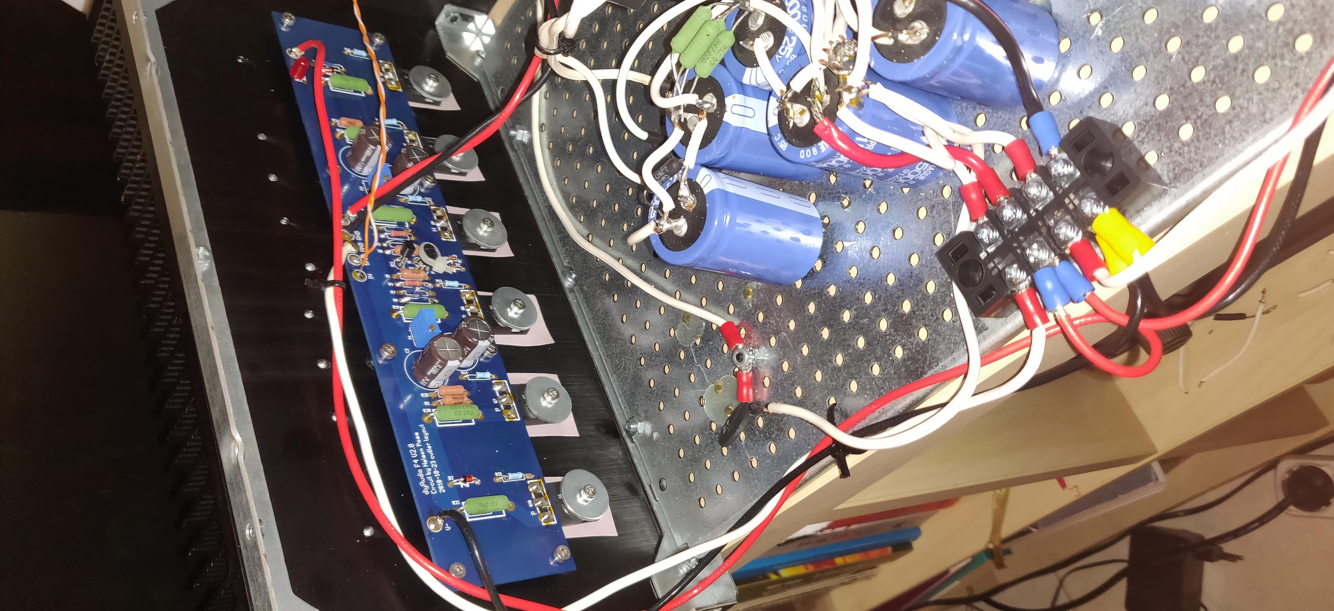

I know, but it works 😱though, things not exactly proper that way

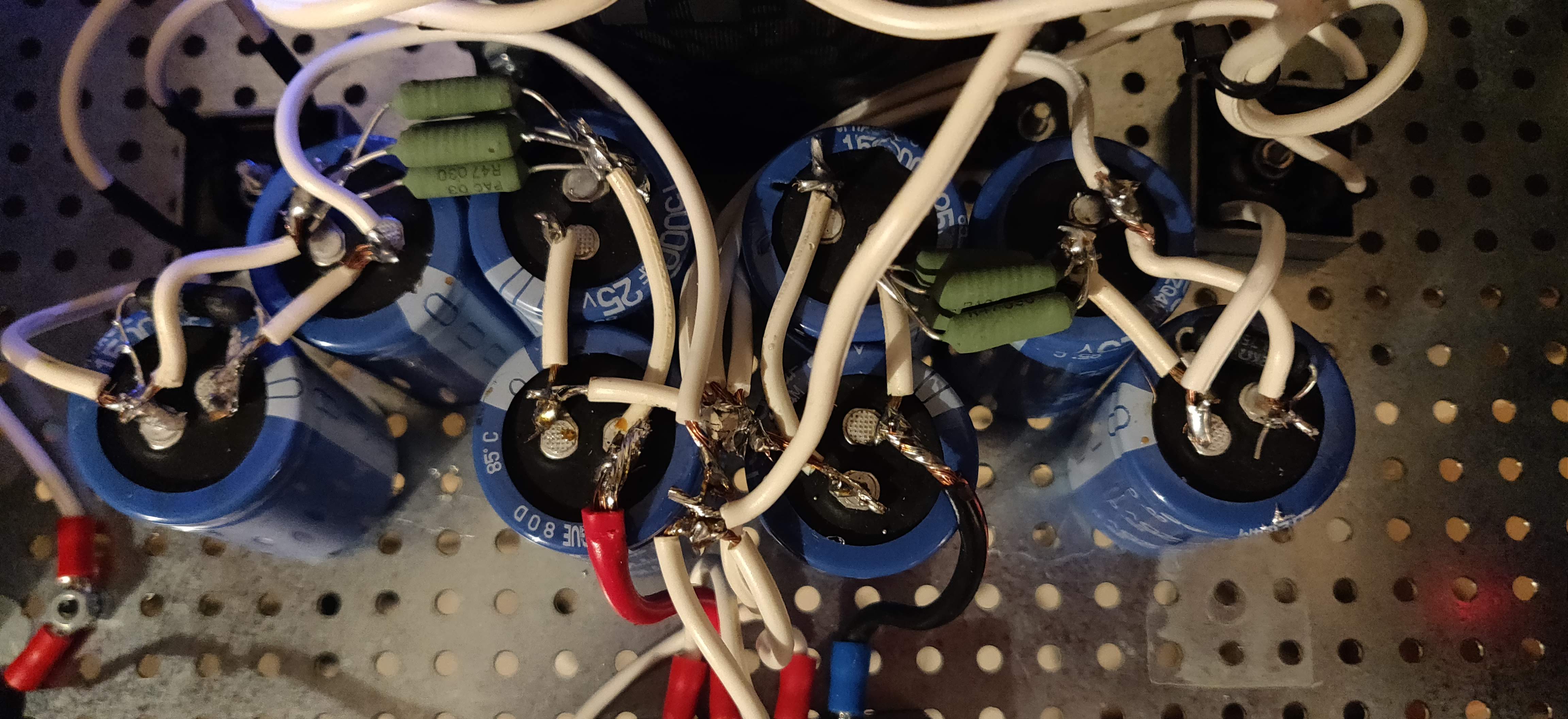

I tried to connect them as the schematic, no change at all, not better not worst.
Exactly the same.
I am checking with an rca connected between the two inputs if the hum persist.
I also tried to remove ground connection from one rca and the hum is still there.
I am attaching a photo of the last arrangement... I know it is a bit messy now.
Maybe use something like a copper bus bar? Know it seems to me like a star ground.

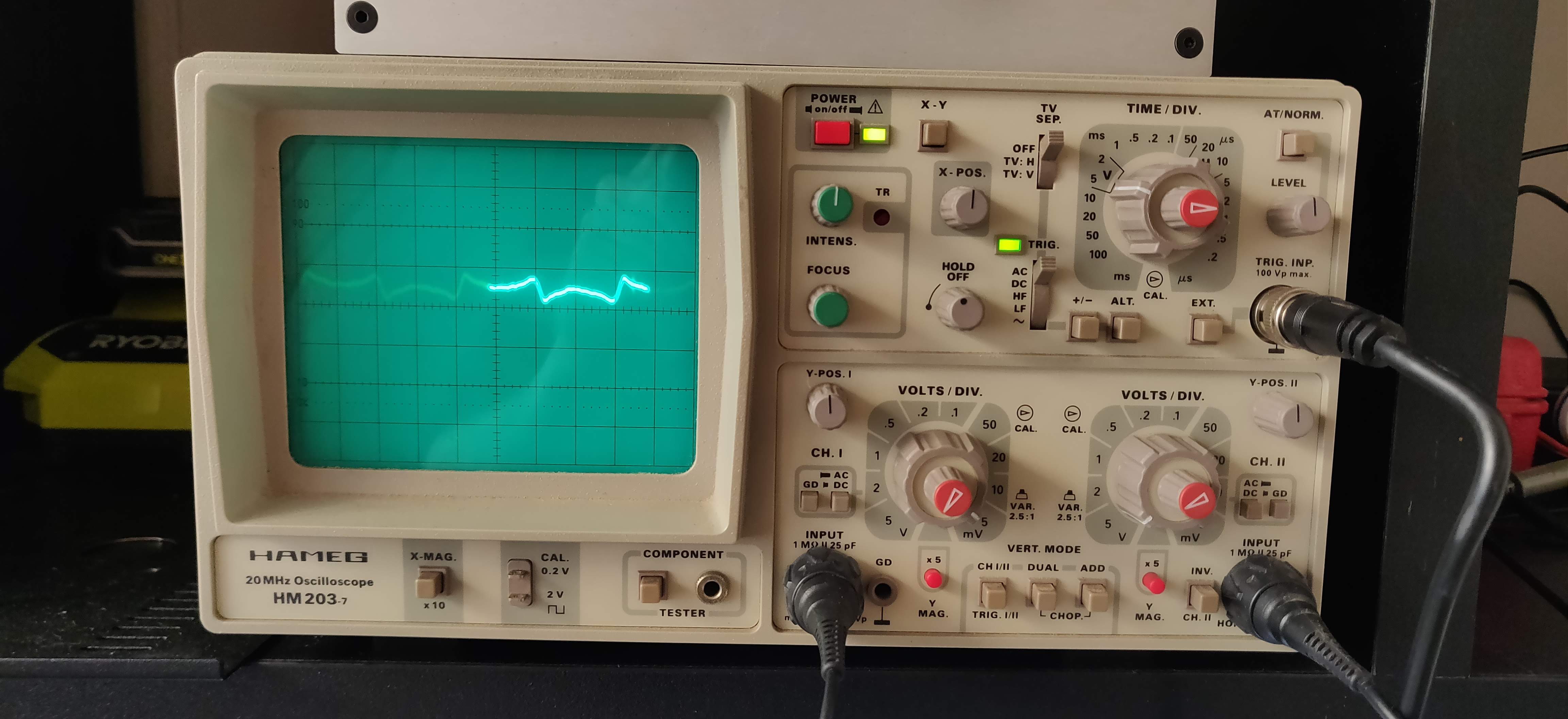

I am also attaching a photo of how it is on the outputs with the speaker connected and the oscilloscope parallel and connected to an iPad on battery.

I mean - leave everything as is, and make fat bridge ditto between two pcbs
if nothing else, it'll show is it there potential difference between them

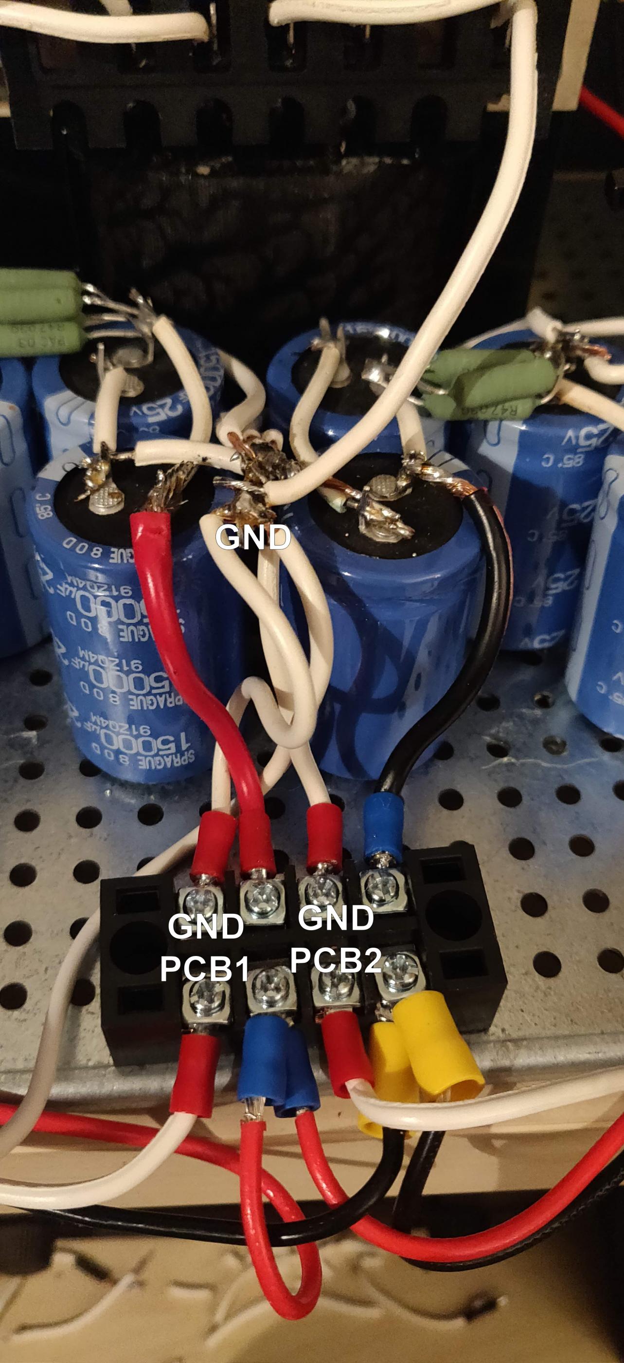

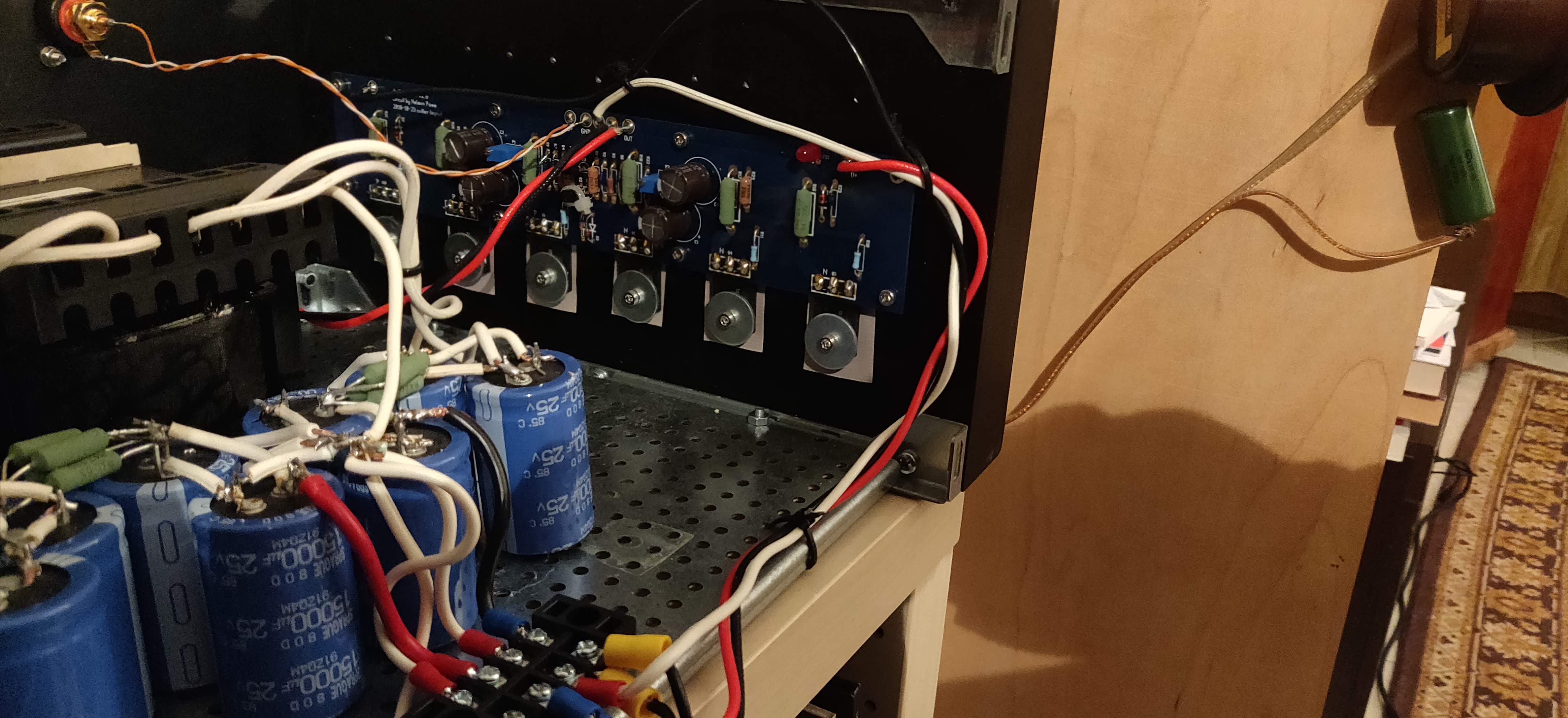

Can you post a pic of that terminal block, curious to see what way the GND from each PCB is connected to the cap bank
I tried to connect with a fat wire:
1) Gnd of one pcb to other
2) Input ground of one pcb to other
3) Output ground of one pcb to other
Nothing changes at all
I am posting three pictures of how the ground is connected to the pcbs.

Just some friendly observations and what I do personally... I like to mount the transformer at the front of the amp, rather than at the back as you have it. My monoblocks have large toroids with steel covers. I tightly twist all rectifier wires, both to and from. I do my best to route twisted input wires and speaker wires far away from any PS components or wiring. DC to pcb's? Ya tightly twist those too. My own caps are screw mount with a custom copper plate but with caps like you are using, I would have used one of the many pcb options you see around here to keep that nice and tidy. Hope you are able to get it figured out, the F4 is one of my favorites for sure..
yup
major reorganization, as W. sez
if nothing else, make PSU pcb - you can do that from raw pcb material, using exacto knife and metal ruler .... 1.5mm drill
