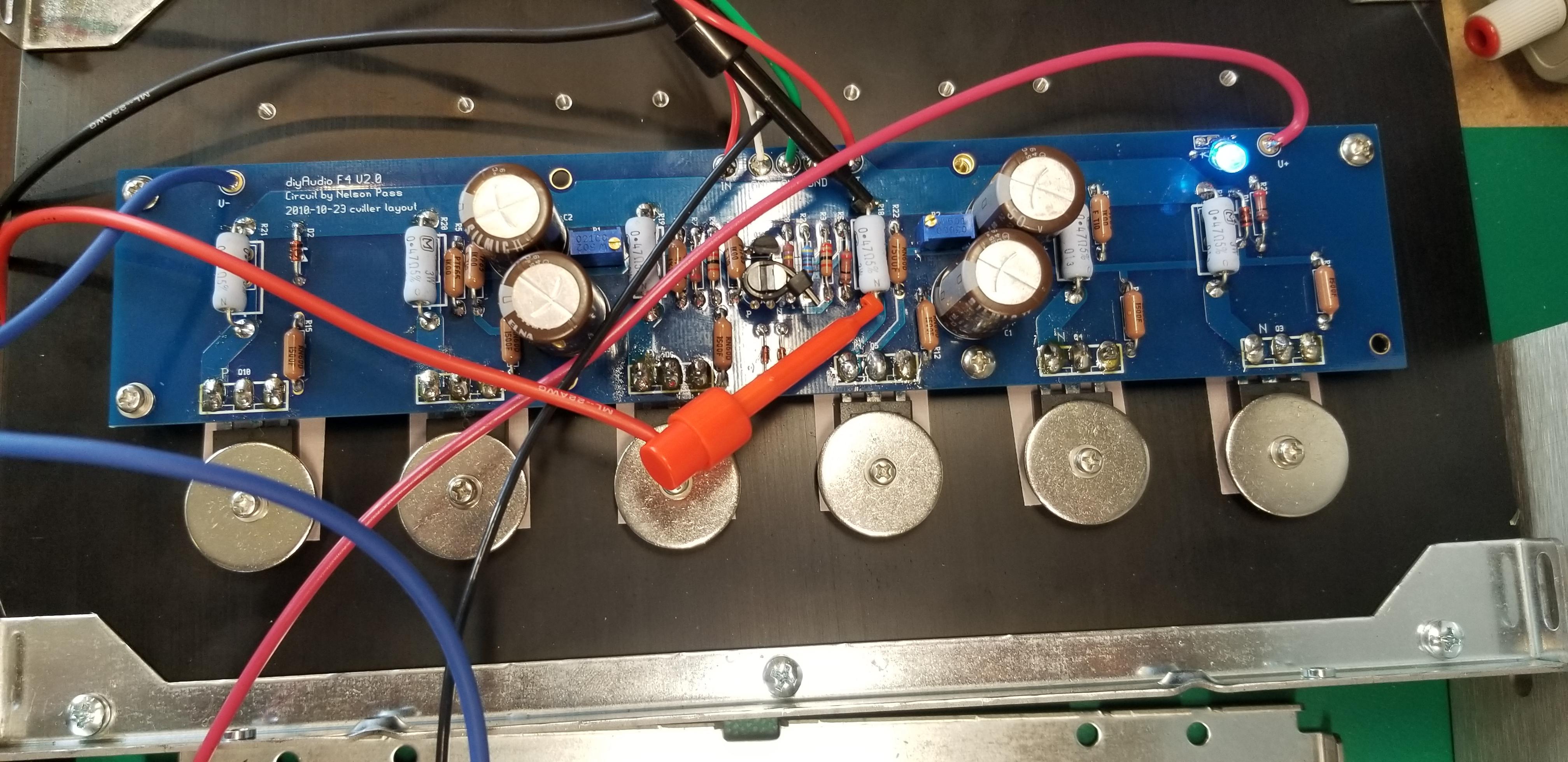

Hello, unfortunately I had no luck with my build :-( Here are pictures of the faulty channel, hopefully you can see them:
f4 | Flickr
Everything worked perfectly so I decided to solder R9 properly through the holes on the board and then close off the chassis and enjoy the amp. The 8k resistors were merely riding on the leads of the previous 5k. So I did. And then (fortunately) I ran a last test before closing the box and on the left channel bias was strange, too much too soon, then it went over 1500mv all of a sudden and the fuse blew. I tried everything in my power, resoldered a different 8k, made sure there were no bridges etc. Nothing works, With 60V from the variac and P1 at lowest, bias sits at 160mV and rising fast if I raise the input voltage (from variac). P2 does not seem to have any impact on dc offset, which behaves erratically, going up and down. Bias also sort of fluctuates slightly without any visible cause (not so on the other channel, which seems to work beautifully). I have no idea what to do.... P1 and P2 measure proper, they seem to function) Any help will be greatly appreciated, I 'm sure you can tell!

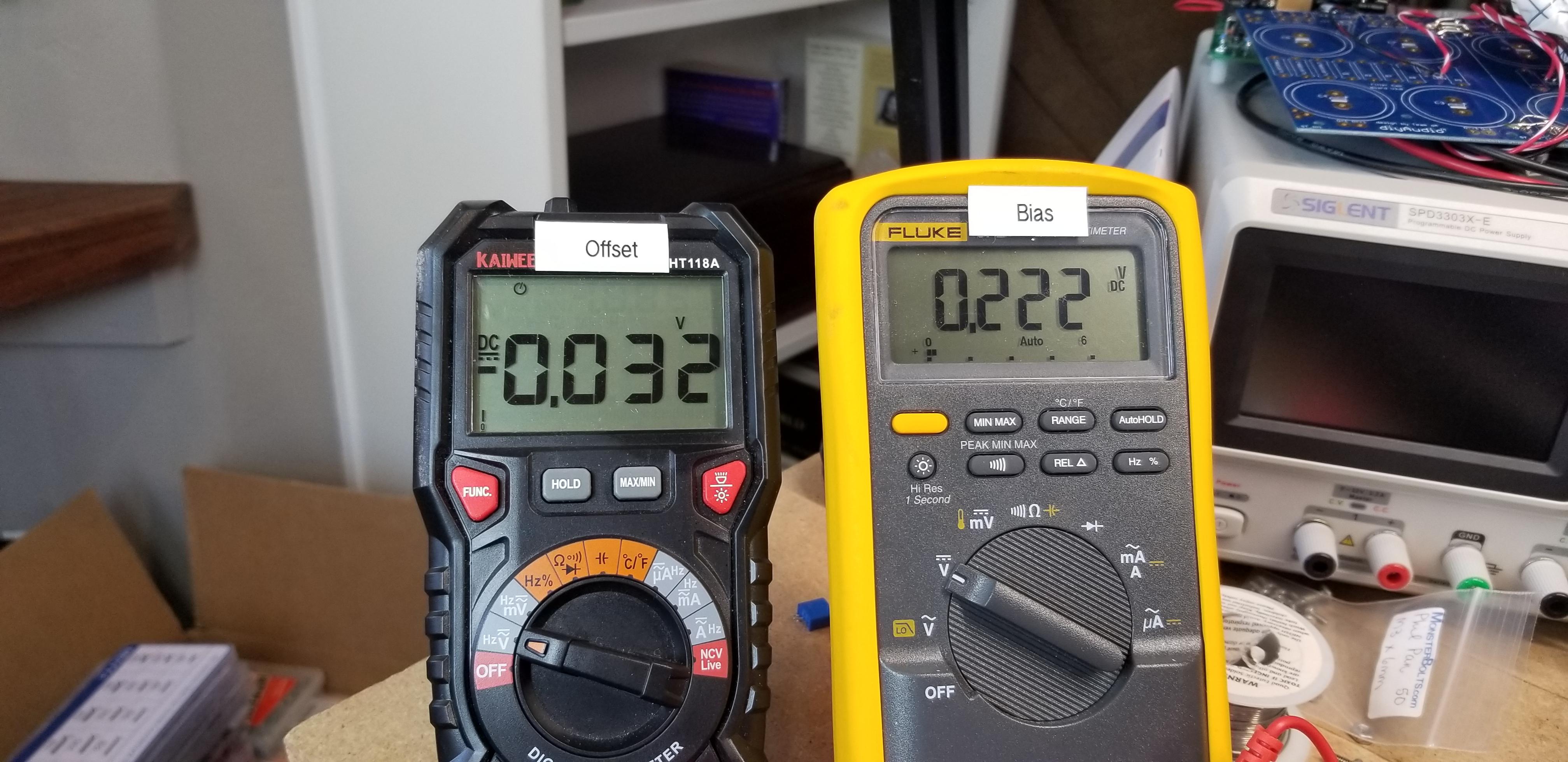

Hello, I seem to have a similar problem as I start to bias my right channel. I'm using a Variac [thanks God] and at 50V I quickly get over .222+ in bias with the trimpot set all the way down. Offset works normally.
I'm using:
R8 27.4K
R9 4.75K
P1 5K
P2 500R
I checked all the mossfets for continuity. All the Mossfets were warming up.
I read thru the forum, but can't find something to guide me forward.
Appreciate any thoughts.

On one of my FW builds I had a similar problem. After extensive searching, it turned out that while fiddling around with the transistors and screwing down the PCB too hard, I had fractured one of the transistor legs. It was still put but not well enough to give consistence measurements / bias values.
Just a thought. 🙂
Chiptech, as ZM wrote, you need P1 at 5K for minimum bias current.
Also, why is your R9 = 4.75K instead of 10K in the schematics? With 4.75K, even
with P1 set at max of 5K, your TL431 will give a min voltage of 9.5V and the Vgs
(and hence the bias) of the mosfets will be quite high.
Dennis,
The reason it is 4.75K is it looks like I mistook your direction back in post 1712:
"I had a closer look and it seems you have 22.1K for R8? If so, I suggest changing that to 27.4K (as in the latest schematics) and leave R9 at 10K. If you change R9 to 4.75K then even with max value of P1, you will have significant current flow (since you already have 110mV across 0.47 in your current setup)."
My mistake. I will change R9 to 10K and try again.
Thanks,
Chip

I'm happy to report I've successfully biased my right channel.
All on my own, by researching thru the forum, I figured out I had expertly reversed the trimpots, so that was fixed.
And thanks to Dennis for sorting out my error on R9.
