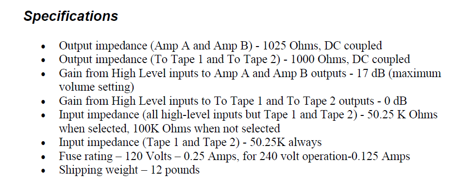

What is your preamp?
I have been using my Akitika PR-102 Preamp thru the building of my now 4 Pass amps.
Is it AC coupled (capacitor in series with the signal output)?
Specs [attached] are a 1025 Ohms, DC Coupled output

Your preamp is DC coupled so it can pass DC. The Starving Student is AC coupled, with a capacitor at its output, so it cannot pass DC. You said you tested with it a few days ago. More information please. What was the result? Was that with the new JFETs installed?

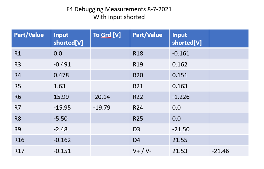

Measurements with no preamp, input shorted.

Ok, back to measurements.
I've used this preamp with all three working Pass amps. I've had it for two years.
Course I did build it, so no guarantee it's to spec.
I did check all wiring and made sure nothing is connecting circuit board to heat sink.

The voltages at R5 and R22 indicate 1.6mA flowing towards the bias circuit and the JFETs. The voltages at R6 and R7 indicate 1.6mA flowing to the bias circuit. That would leave no current flowing to the JFETs. Yet the voltages at R3 and R4 indicate 22mA flowing through the JFETs.
The only components left that may be questionable are D3, D4, and the JFETs. At this point I would replace D3 and D4 and double check that the JFETs have been installed correctly.
I am out of ideas.

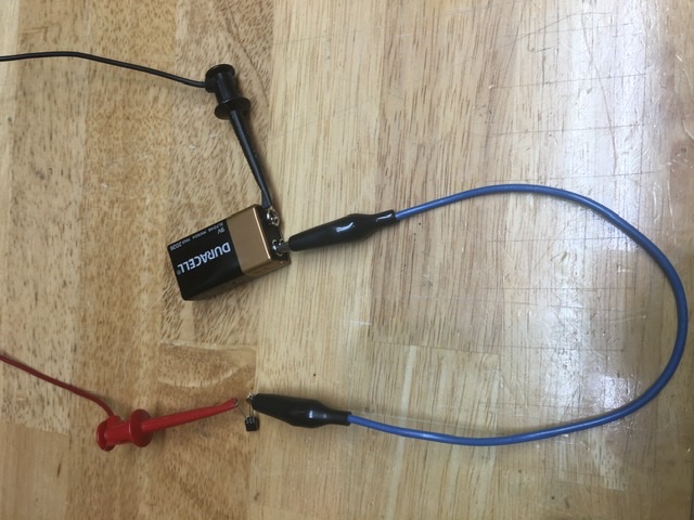

You can test them with a 9V battery:

The connection for measuring Idss would look like this for a P channel transistor. Red and black leads in series with your meter set to mA.

To connect to the JFET, you can use clip leads, some sort of small socket, or a solderless breadboard.
Also note the difference in the schematic symbol for N-channel and P-channel. You may not remember it but that is how to differentiate N-channel from P-channel if the schematic is generic with no components specified.
So that is how to do it.
And if you build a new board, after you have set the bias and output offset, use your headphone preamp first to test it. You have had the board testing properly with no preamp and then things went awry when your preamp was connected - multiple times. So try something different.
Ben, thanks for taking the time to lay the above out. I understand it all much better. And will use it.
Also, I am going forward with a new board, just have to add the MosFets. And I will use the headphone amp to bring it online. Will report out in a few days.
