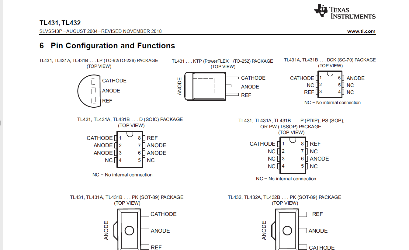

I have been using this one:TL431BQLPR but I also have TL431AIZT if there is any difference?

I usually use the TL431A. I might have read that some people may have had issues using the TL431B.
Go with the A.

Just when I thought [and still think] we've figured it out, I tested six new TL431As, all I have, and none test as working. I have 3 different transistor testers to run them thru.

It seems unlikely to have that many broken TL431. Are you sure your transistor testers are able to test that part?
Can you measure the voltages across R22, R6, R8 and confirm the values of those parts?

Chip,
Ben asked you to measure the D2/R9 voltage and you got around 2.1V. This
suggests your TL431 is not regulating. One reason would be if the TL431 is current-starved.

Chip,
As far as I can tell the Vref measuring locations that I marked on the pcb looks correct. I just checked the pictures of the front and back of the board and the locations look good. The D2 location is connected to the TL431 anode pin and the R8 location is connected to the TL431 ref pin.
So if the soldering is good and the part is installed correctly, and you are not getting 2.5V, then I would assume that the part is faulty.
The other way of measuring is to use small clips to attach directly to the TL431 anode and ref pins and measure directly.
I had pointed to the marked locations on the board for ease of measurement.
