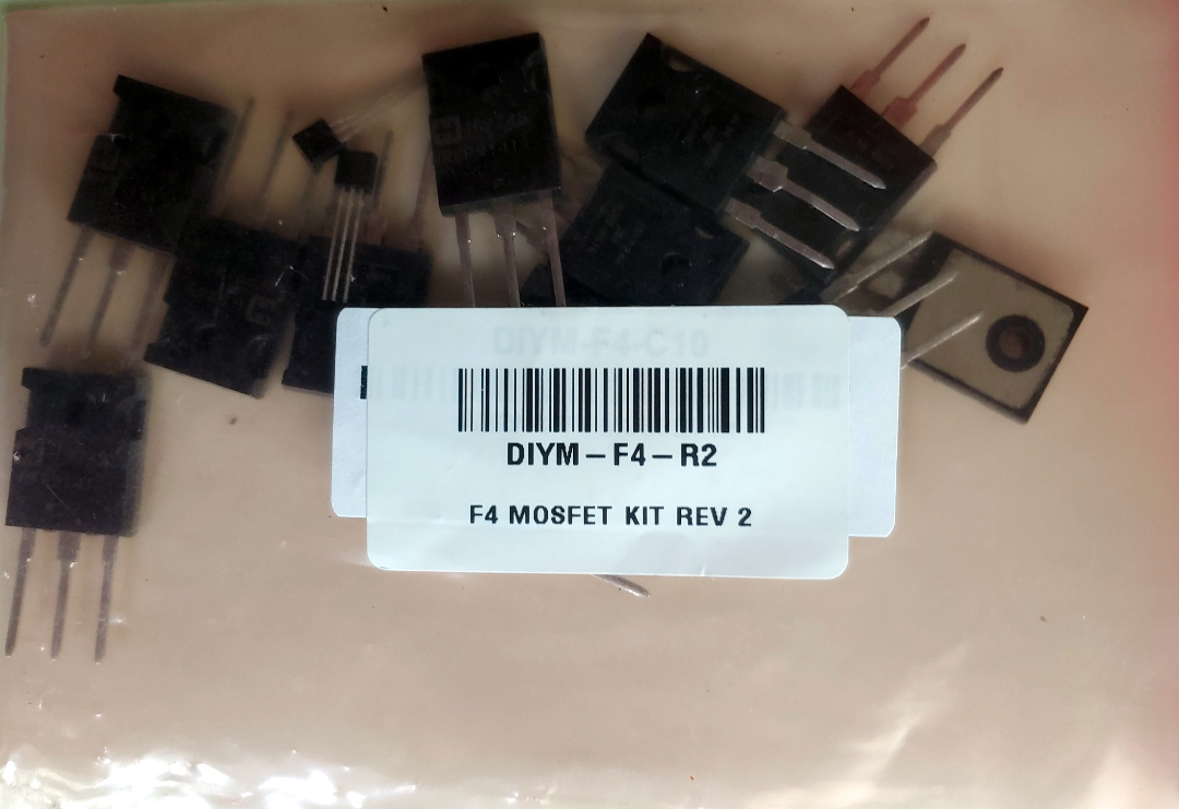

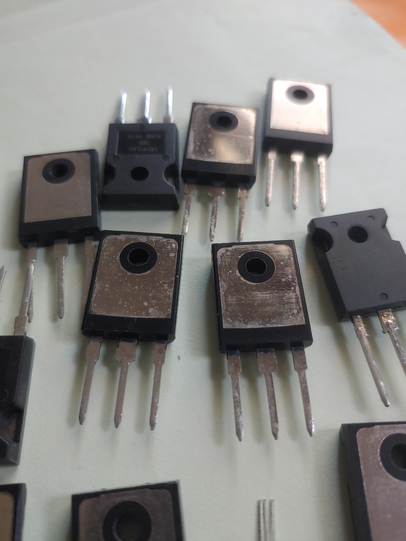

Mosfets ok?
I ordered an F4 transistor kit from the DIY audio store.
Surprisingly, the contents were not packaged in bubble wrap or a static-safe envelope. As a result, they don't appear to have weathered transit very well.
Some pins are bent; and the silvered surface of several of the mosfets seem to have been scratched by the pins of the others.
Similarly, the two tiny TL-431s were loose - not taped like shown on the image on the store site. Their pins are also bent.
Can folks with experience tell whether these transistors are good for use? Or should I ask for replacements? I'm past the store's 30 day return/exchange policy so I can only hope they'll help.
Any suggestions?

I can only speak for myself, but mine were shipped the same way in several different orders. And work just fine 🙂
Mark Johnson, I think it was he who wrote it, says it is a good idea to sand the surface with very fine paper anyways in general. I guess iot ensure even contact with the pads. Either way, they look OK to me.
That said, some of the ones I got weren’t as tightly matched as expected. Is the reason damaged surfaces during transport and therefore uneven pad contact? I must say I haven’t thought about it, but I guess everything is possible. But I don’t think so.
Wrt returns, I have tried that once. But you might have more luck than me 🙂

Same here. Your photos show the way my parts arrived.
And I've ordered a lot of parts.
But not because any of them were bad.
