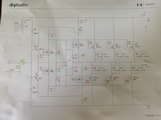

post your reference schmtc (or link to)
See attached. 2011 revision. All resistor values as indicated.
bulb tester only for initial - no biased - state
remove bulb tester, or - as soon you start increasing bias, amp is going in voltage starving
Thank you.
you'll need to alter few resistors , nothing more

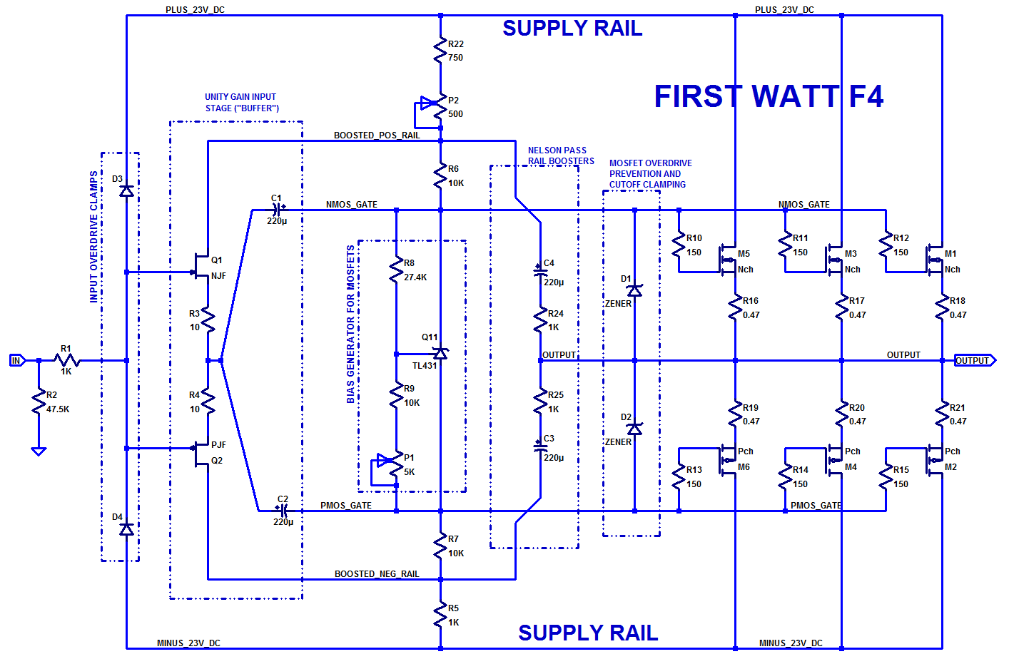

So perhaps the combo of TL431 and R9 / R8 values causing it not to breathe past the jfet stage? I don't quite understand what the TL 431 does in the circuit. I do have others (OnSemi NCP431ACLPRA) I purchased.

There's a 16V drop across R6 (10k).
can't see nuttin at that schm, too small - can't see nomenclature even if I can see most important values
increase 22K - upper TL431 resistor - to 33K
set 5K trimpot to max value prior to powering up
be constructive how to check that max value with ohmmeter
or leave 22K as is, replace lower TL431 10K resistor to 5K1

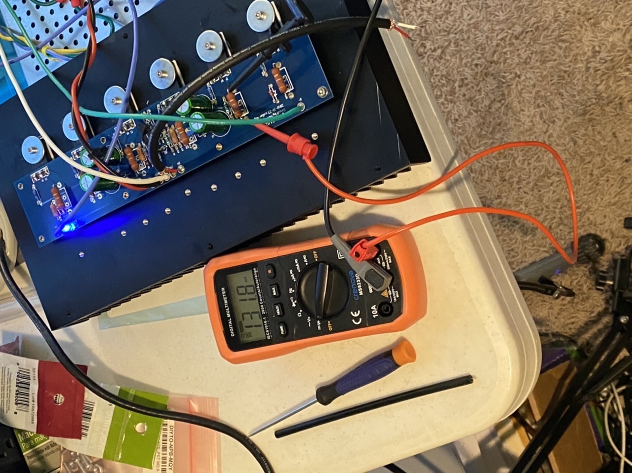

As both channels are (mis)behaving the same way, I'm going to focus on one.
I replaced R9 (originally 10k) with 5k1. Started with P1 trimmer to max. Rails at 23v, reduced P1 full way, and never budged from 0.00 voltage drop across the Source resistors (used R20, r21). Also, no voltage drop across gate resistors (R10-R12). They show approximately 1.3V
Because I have them, replaced the TL431 with the OnSemis I had ordered, triple-checking the pin-outs as per schematic.
Reference and readable schematic I'm following is attached.

For my education, to understand that portion of the circuit, I think...
R8 and R9+P1 form a voltage divider, sending a positive voltage into the TL431,.
Which from what I can understand is acting as a zener, setting a specific voltage from the TL431?
But this in turn is talking to the D1, D2 zener pair. And I'm lost as to the purpose.
Understanding that this little network is setting a bias for the mosfets on the Out line between the N and P sides.
Nope, I don't get it yet.

There should not be much voltage drop across the gate resistor since the DC gate current is negligible. However there should a bit over -4V from gate to ground in order to open up the mosfet.

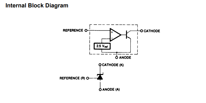

It may be that your TL431 is not functioning properly. A check of that would be to measure the voltage between Ref and Anode, which should be 2.5V if it is working.
Measure between the Ref pin and the Anode pin of the TL431. You should see the Ref voltage of 2.5 volts. Divide 2.5 volts by the resistance, I=V/R, between Ref and Anode (this would include the potentiometer.) This current then flows thru R8 developing a voltage. Add 2.5 ref voltage and the voltage across R8. This is your bias voltage.For my education, to understand that portion of the circuit, I think...

With the original values and the potentiometer at mid point. 2.5/12.5K=0.2ma. 0.2ma x 22.1K=4.42 volts. 2.5 Ref voltage plus 4.42 volts =6.92 volts
With the pot at zero, bias voltage is 8 volts
With pot at max 5K, bias voltage is 6.18 volts
Vout=(1+R8/(R9+P1))Vref
D1 and D2 provide over voltage protection
Hope that helps you get started
I suppose 22R won't do the work of 22.1k in R8, now will it? Stupid clerical error identified.
I have a 20k for R8 in my box.
With @BDP 's formula above and the 5k1 in R9 position, that will give me:
P1 pot at zero, bias of 12.5V
P1 pot at max 5k, bias of 7.5v
If I put the 10k back in R9, I'll get close to BDPs range above.
What's the better option for R9 given R8 of 20k not 22.1k?
I'll put R8 20k in on the other channel that still has 10kR9 and see if I can bring it up.

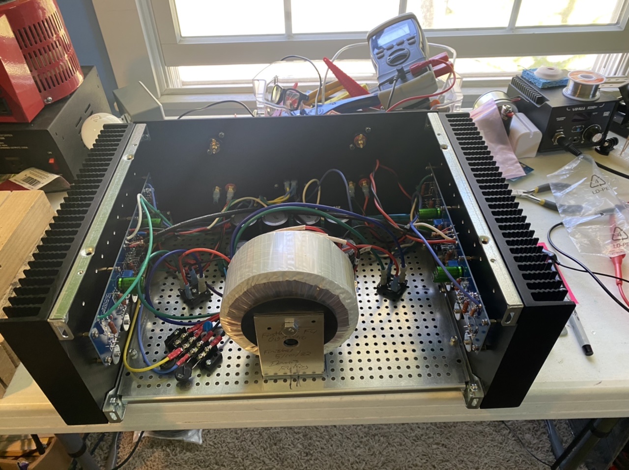

Got it fully assembled and biased yesterday. Boring, long conference calls can be a blessing if you build your amps in the home office.
When biased, the DC offset trim (P2) let me adjust to .1mV and just sat there, rock steady.
