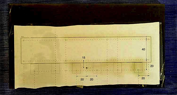

Is this an accurate plan of the dimensions of the PCB? I'm planning the heatsinks. The plan indicates 40mm between the centres of the Mosfets - is that accurate?
