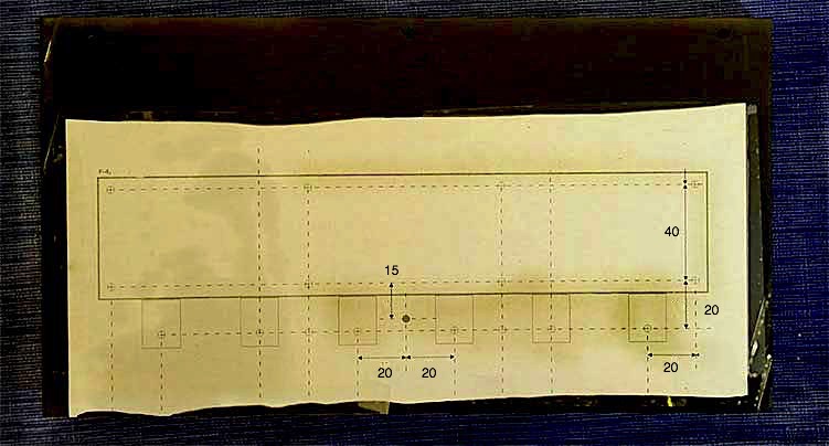

Here is a link to the UMS (to which the F4 boards conform).
https://cdn.shopify.com/s/files/1/1006/5046/files/universal-mounting-specification-v2.1.pdf
Here is a link to the F4 board / mounting layout.
https://cdn.shopify.com/s/files/1/1006/5046/files/P-F4-1V20-dimensions.pdf
Hope that helps. FWIW - I think you've got it correct assuming your units are mm.

This looks good, but you should verify on the pcb just to be confident.Is this an accurate plan of the dimensions of the PCB? I'm planning the heatsinks. The plan indicates 40mm between the centres of the Mosfets - is that accurate?
Can you place the mosfets closer to the heatsink‘s center? Better thermal-transfer…
Is there any difference in thermal transfer between:
1. making a thread in the heatsink and screwing in the bolts
2. drilling a hole in the heatsink and fixing the Mosfet with a bolt and a nut
My heatsinks have 40mm spaces between the fins so 2. is easily done. A washer could be fitted on the bolt before the nut.

No.
It’s not the method that matters, but the pressure and just as importantly, the perfect contact (100% contact, zero airgaps)
Of course, you will use a proper thermal compound (like keratherm red 86/82, silver mica + goop etc)

I have another question - I have a heatsink 300x150x40. I have another heatsink 300x50x40. They would fit together vertically to make a larger heatsink 300x200x40. So how do I join them up to get good thermal transfer? Do I need a copper plate to join them or would aluminium be OK, like 300x70 or 300x100 e.g. 3mm or 4mm thick? And bolted together with thermal paste.
Unless you want to do it because you can, I‘d say you don’t have to, the heatsinks seem to be sufficient.

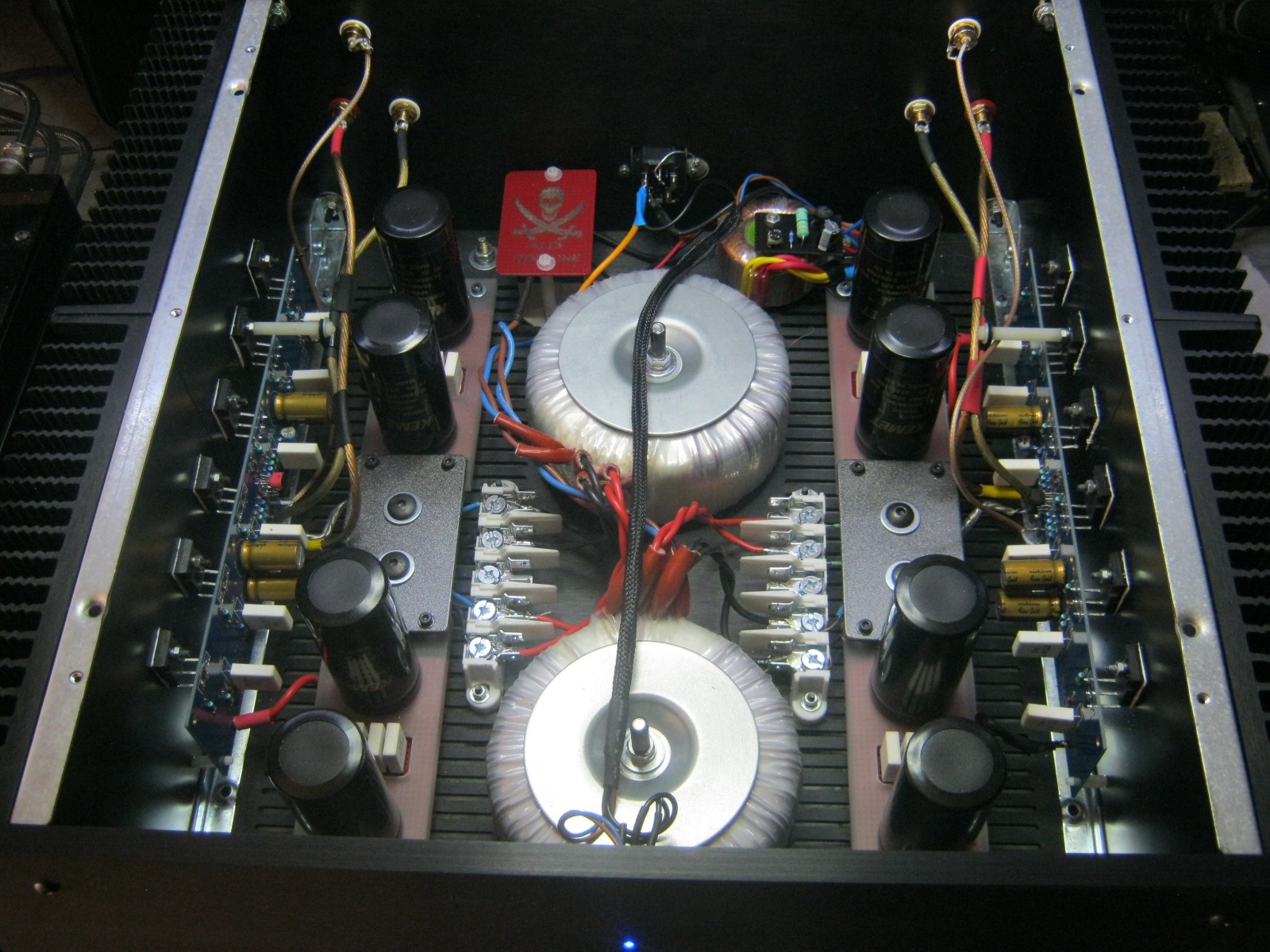

My F4 didn't last long, fuse broke, changed and broke again, my skilled friend checked it out at my place and found out the diodes on a channel might be gone, it is still waiting to go to his workshop for restoration but at this point I am thinking to rework the filtering part.
Story being the guy who assembled it for me didn't want to use the DIY Audiostore boards, he said he would arrange that section and you can see the big caps which are connected with the other components with cable wiring and the rectifiers being underneath the thick aluminum plates in between the two caps boards.
On the back of the case you can see a relais underneath the skull shield and a small transformer to power the amp out as not to roast the switch (put it very simply, I don't really remember how this thing works), at this point I'd like to rework the filtering and rectifiers part of the amp with the UPS from the DIY Audiostore and wondering if with the actual layout (transformers in the middle) they would fit and then would also add the soft start board still if that fits and if it is not superfluous.
Please your suggestions are more than welcome, I'd order the boards the soonest as they take quite a while to ship off the US to here and in the meantime my guy should also start and work onto the BA-3 preamplifier which would squeeze all the gentle power off the F4 since my AR SP9 doesn't make justice to it.
Grazie mille for your attention

I'd recommend asking your skilled friend to e-mail you the schematic and parts list they used for the existing system. You can post that here, and we can maybe help a bit better.
There may not be a need to re-do so much. It may be a good design with a small issue.

best (easiest) recipe is using 35A or 50A metal case bridges (KBPC35 or KBPC50), firmly bolted to bottom of case, with some thermal paste in between and - as a must - having split washers under bridge screw nut
( I had dead bridge in amp built by someone else - bolt got loose from thermal cycling, without split washer ...... and bridge simply gone Dodo)
trick is simple - these bridges are enduring declared current only if cooled properly
example - in my T-Bed (chassis for prototype work) I have one 50A bridge, mounted on 120*120mm, 2mm thick Al plate; with regular Iq of 2*1A7 (to 2*1A8), bridge and plate are at least 55C
same conditions in regular amp, one bridge on bottom plate (scratch the paint!!), bridge is just warm
same conditions in regular amp, two bridges on bottom plate (scratch the paint!!), bridges are just warm
go figure ........

The diodes probably got too hot and the aluminum heatsinks don't dissipate enough so what my local skilled tech suggests is to change the diodes and add a proper heatsink on top of the aluminum plate to begin with, his other doubts are about the in the air cabling of the filter boards and the relais to switch the amp on which is the reason I though to add a soft start board since there should be enough room for it
Let the guy do his bit, change those diodes for a better pair and heatsink properly with thermal goop ane tighten properly to 2 NM.My F4 didn't last long, fuse broke, changed and broke again, my skilled friend checked it out at my place and found out the diodes on a channel might be gone, it is still waiting to go to his workshop for restoration but at this point I am thinking to rework the filtering part.

It’s a nice build. The stores PSU boards are not nescessarily going to get you a better amp. Gnd scheme had great room for improvement. In fact, as long as your F4 is quiet and nice when working, use what you have. Like Mighty sez, even he had diodes crap out on him. So it is not the end of the world.

just do what I wrote and implement big NTC * Cl60 class) in primary of each xformer
bridging demands nothing else than XLR jack at back plate, one hot going to one side, second hot going to other side, pin 1 hoing to both sides gnd input pad
output taken from two hots
read article, all explained

If you do what Mighty sez you’ll be fine. CL-60’s and replace and heatsink bridge rectifiers, both of them.Oh well, I know it's not the end of the world but since I have to be away from it for a while and also wait for the BA-3 tp be done I won't mind wait a little more as to not just fix it but also make it more reliable with a proper soft start instead of the transformer-relays, the PSU would only make it if they help prevent other issues, it will be my guy to tell me, once I have to get the soft start I would also get the PSUs to combine shipping.

I didn‘t quite get the concept of that relay-thing, isn‘t that something like a softstart? Or does it just „ignite“ the real thing (switch triggers relay which triggers amp)?
The softstart would basically do the same as mZM‘s CL60, plus it then (after the start was made softly) goes out of the way… mo complicated (more parts, oh mighty!
Don’t know if this would save the diodes, I thought it was more to give the PSU a better and longer life with less stress
If you want to go really fancy, look out for mark Johnson’s superduper softstart thing…

I took the amp to my friend (not the guy who built it), he will take care of it and arrange a kind of soft start without to use the already there transformer, of course new rectifiers with wider surface heat dissipation, in the meantime I am gonna order the case for the BA-3 and hopefully by xmas there will be the F4 mate with some extra gain :-D

Please ask your friend to verify proper bias of the amplifier as well. I seem to recall you mentioning that it was running quite cool.
