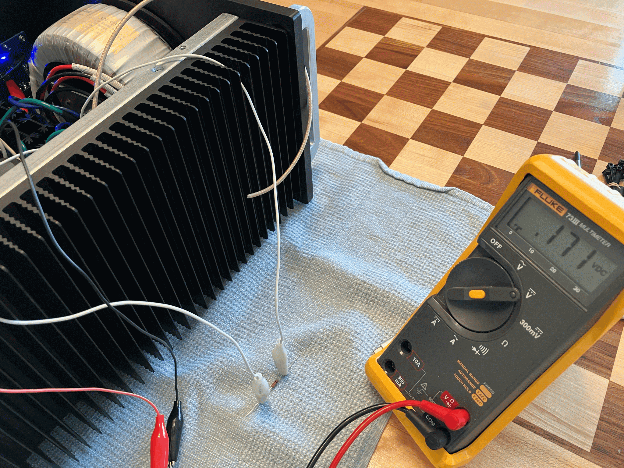

How close can you get? What other resistors do you have? Anything between 10K and 4.7k?
Getting 200mV on the right channel, 170mV on the left.
Or, couldn’t you piggyback a 10k onto r9…
The simple solution, ha! Last night at 9pm, didn't seem so obvious.
@6sX7 : Sounds like you need to increase R8 or decrease R9. See post #2931: https://www.diyaudio.com/community/...ass-f4-amplifier.234355/page-147#post-7018397
Since it seems you are already getting some bias current (ie. the mosfets are already turning on), you don't want to change things too much that the new min voltage is too high to get the bias you want.
That's the info I'm looking for, trying to get deeper into understanding circuits. Thanks Dennis! Time to go break out the coffee, calculator and cogitation.
Temporary solution following myleftear's suggestion. Piggybacked a 10k resistor via alligator clips. Getting 170mV across the source resistor with the bias pots dialed all the way down. Guessing 3.3k will be too little. Ordered some 4.7k as recommended. Still working thru what the circuit does mathematically. I did verify that I've got 2.493V between the reference and anode of regulator (Q11). Brain hurts. I think my physics brain died when I became a manager. Bloody neck tie cutting off the circulation.

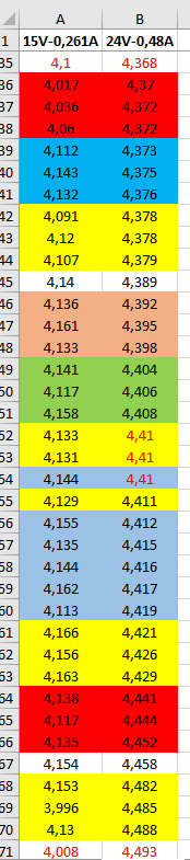

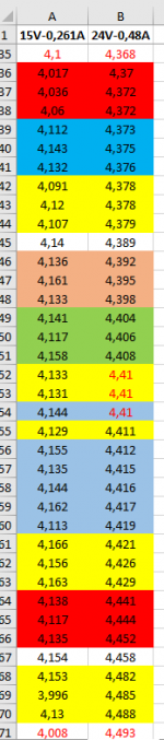

Are those triplets god for F4, matched at 15V and .25A for 30 seconds, and after 2 days matched again at 24V and 0,48A for 30 seconds? Matching is done on a very large heatsink. I think is better to choose the higher voltage because is closer to the real operation point, am I right? Thanks.

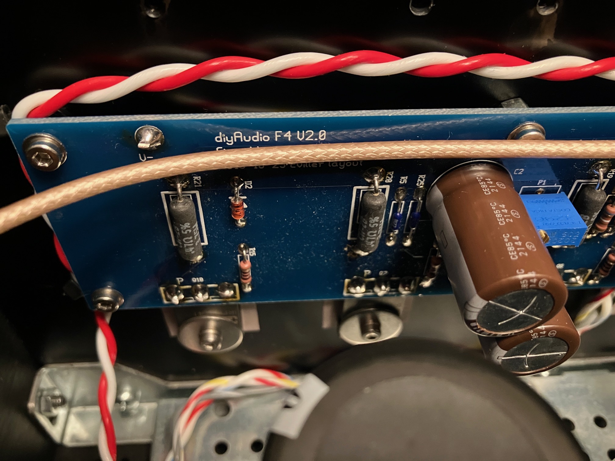

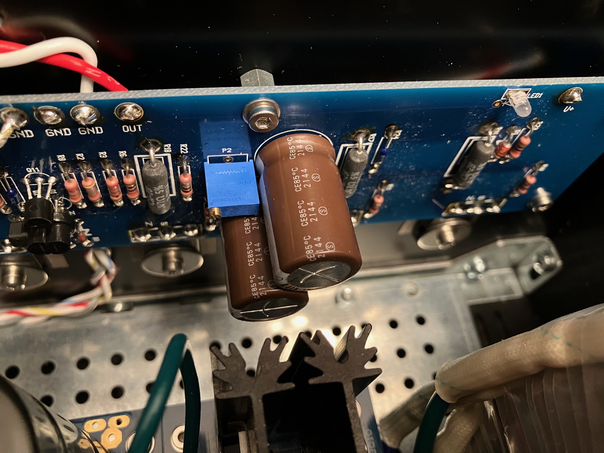

Got 3 out of 4 channels of the monsterblocks working correctly. Getting odd bias behaviour from the right channel of amp 2 (call it RchA2). All other channels start out with a biasing voltage of ~170mV. RchA2 starts out at about half, ~85mV. When I get RchA2 biased up to 300mV, the heatsink is 10C more than the other channels. Hooked it up to the system and have some very clear distortion going on. Any quick ideas? Pictures to come in the next day or so. Have to tear the chassis apart to get clear close-ups and a bit burnt after a marathon DIY day yesterday.
output DC offset, for functional channels , and for non functional one?
clarify " the heatsink is 10C more than the other channels"
if source resistors are the same, Iq is set to same value ( voltage sag across source resistors), rails are the same ...... physics sez that heat W are the same ...... and hsink temp must be the same
if htsnk temp is not same, you need to find what else is not the same, to decipher root reason for unequal temperature
check voltage sag across each source resistor, in all channels, to be sure that each and every current path is functional
