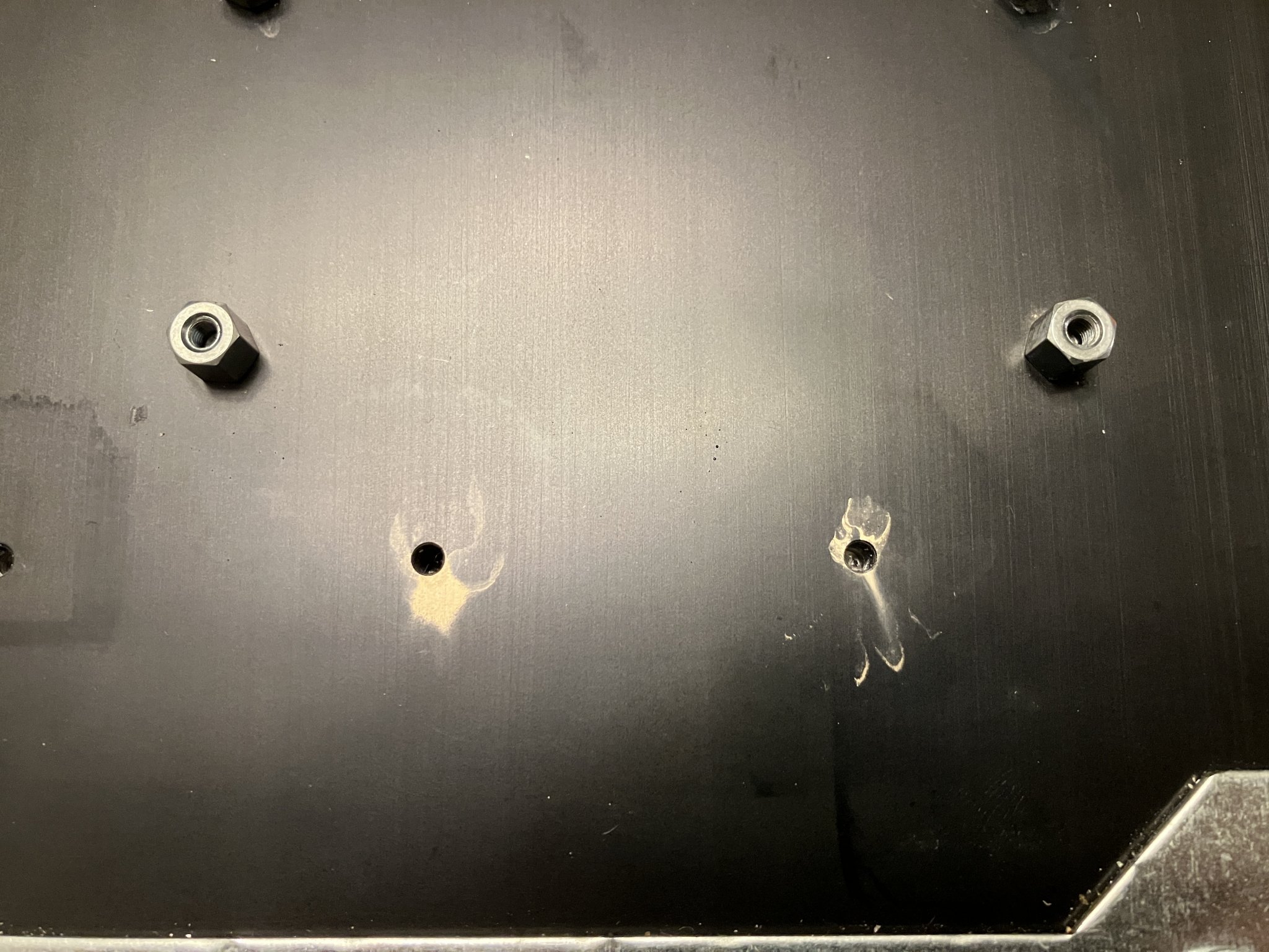

Finally attempting to swap MOSFETs around. When I unbolted the boards, found some oddities where the FETs mate to the heatsink. Is this a product of the UMS machining or a sign of shorting thru the keratherm? Don't recall from when I assembled them.
Got the L ch. up and running with the swapped FETs. Set Q3 source resistor drop to 130mV. After an hour, drops across respective resistors are:
Q3: 152mV; Q4: 138mV; Q5: 147mV; Q6: 148mV; Q7: 134mV; Q10: 159mV
A spread but within 20%. Looks like MOSFET swap had intended effect but the set may not be optimal. Later today, will get R ch. up and running and see where it all sits.
Not so lucky on the R ch.
Q3: 147mV; Q4: 167mV; Q5: 106mV; Q6: 144mV; Q7: 128mV; Q10: 151mV
Something isn't right with Q5 but unsure how I'm going to proceed. I have all the parts (including a matched set of MOSFETs from Etsy) to build up another set of boards. Thinking best bet is to give a fresh build a chance and set aside the offending board for troubleshooting when I can get a real test bench set up.
I guess that just means that at a common gate voltage Q5 conducts less current than Q3 and Q4.
Prior to swapping the parts, did you measure the gate voltages per post #3063?
Assuming you have new triplets that are well matched, I suggest you go ahead and use them and leave these existing ones for testing later. Whether you want to build completely new sets of boards will depend on how comfortable you are in desoldering the existing mosfets.
Sadly, I did not. Got too focused on getting something done this long weekend.
with your input there about desoldering the MOSFETs and what I went thru the last 2 days, going to build new boards. The dinner table actually gets used for dinner. Unpacking and packing is getting old and tiring. Looking forward to buying a house and having a work bench.
