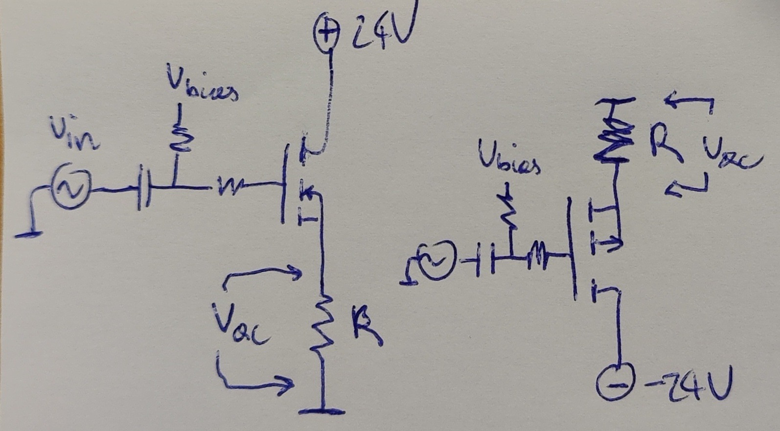

After having built a scaled down version of the F4 for headphone duty (see https://www.diyaudio.com/community/...ass-f4-amplifier.234355/page-102#post-6281443) it's now time to build a full scale version for my stereo.
I have a full set of curve traced IR irfp240/9240, and I'd like to match the P-channel transconductance to the N-channel by using appropriate source resistors. On page 233 of Designing Audio Power Amplifiers, Bob Cordell suggests 0R15 for the N-channel device and 0R22 for the P-channel device, which I'd like to use as a starting point.
Ideally, I'd like to measure the respective transconductance with the parts I have on hands. Following https://www.firstwatt.com/pdf/art_mos_test.pdf I have drawn the attached circuit.
At a given bias point mimicking operating conditions in the F4, the transconductance should be gm=(Vac/R)/Vin and so by keeping all other parameters identical between N and P measurements, a gm match is achievable by selecting R accordingly, right?

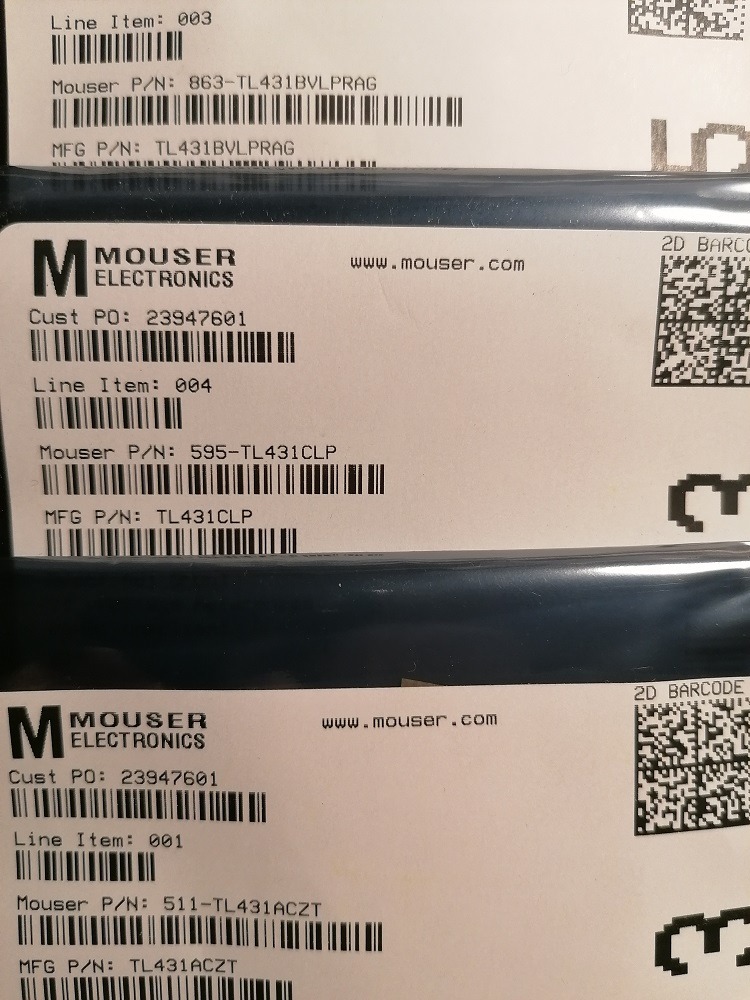

TL431 is TL431 is TL431 ??? 🙄
While waiting for the ACA-Mini boards to show up in the store, I'm building a pair of F4's. 😆
Problem is, I can't find a 'just TL431'. I have TL431CLP, TL431ACZT and TL431BVLPRAG. Are there any difference in functionality or quality, or is it just a matter of manufacturer being clever?
Not very familiar with the new interface yet, look up my posts here and following discussion, there is an explanation and links to what you need.
here:https://www.diyaudio.com/community/threads/f4-power-amplifier.97540/post-6360536

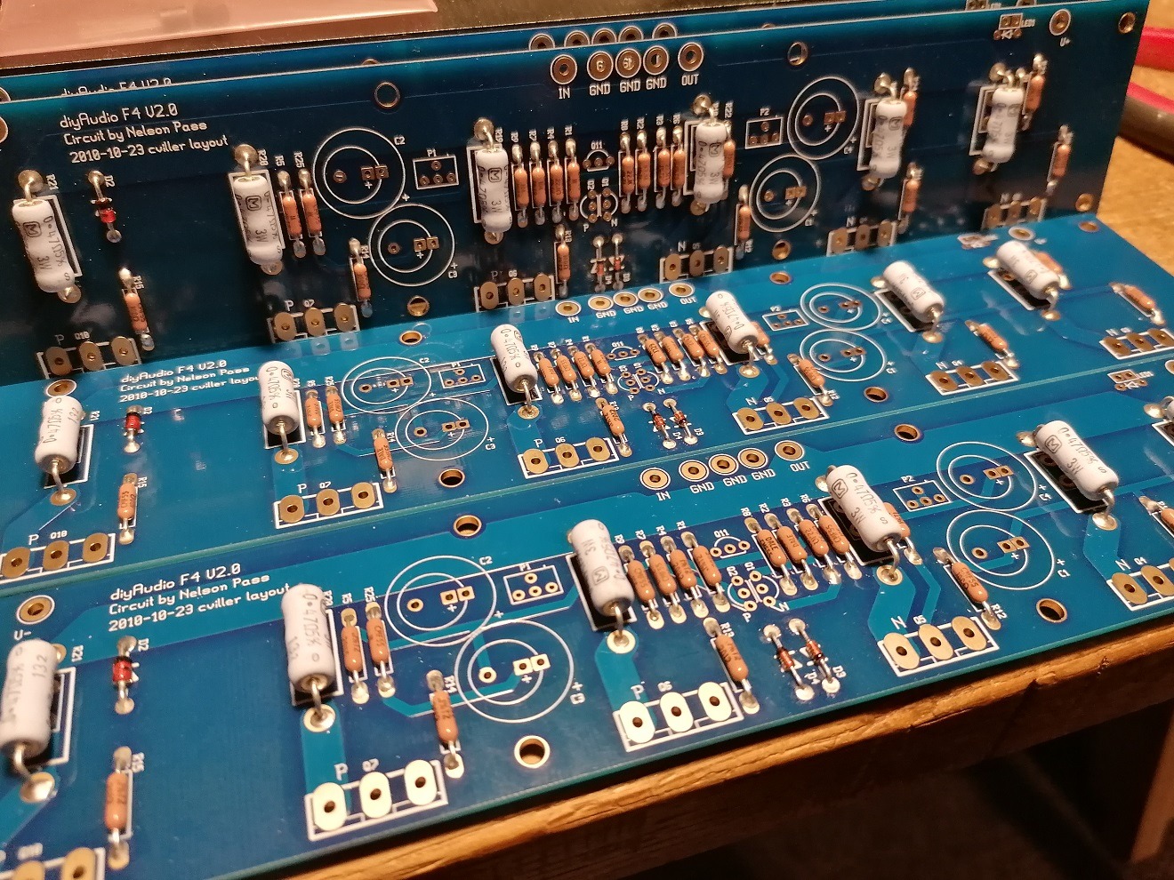

I'm bringing up my F4 build on the variac and a dim-bulb to bias, and I'm getting no voltage across the source or gate resistors, regardless of P1 movement. Either channel. I can adjust DC-offset with P2. Dim bulb is dim, because clearly three's no current passing through these front ends. Power supply is working fine V+, V- is correct at the amp boards.
First thought: I'm not setting up the biasing properly. I have no input signal and no dummy load on the outs. This is correct procedure, yes?
Second thought: Something in the combination of the TL431and the JFETs. I used that which came with the DIY store's F4/BA3 kit, and matched quad Toshibas, 8-11ma.
Third thought: Turns out the C1-C4 I bought were biPolar, not polarized. I used the "long leg positive" rule of thumb when stuffing them. I wouldn't think this should matter, but more knowledgeable of you might enlighten me differently.
Any advice for sussing this out?
post your reference schmtc (or link to)
bulb tester only for initial - no biased - state
remove bulb tester, or - as soon you start increasing bias, amp is going in voltage starving
you'll need to alter few resistors , nothing more
but schmtc first, to avoid broken phones game
