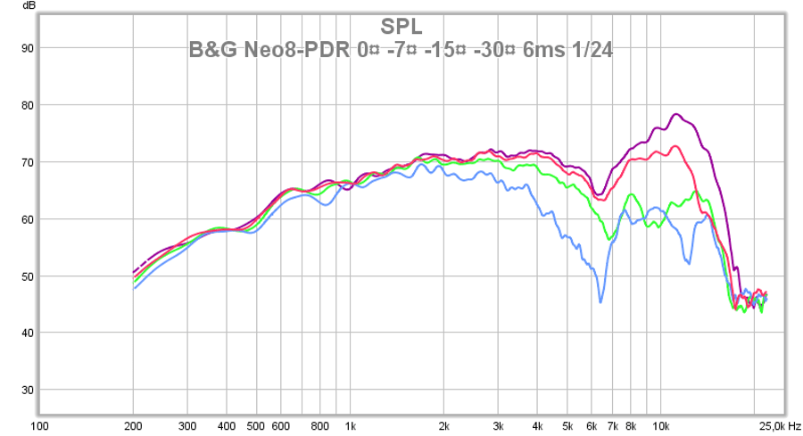

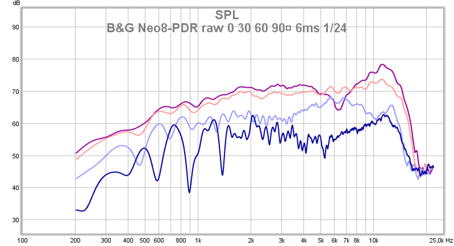

B&G Neo8 has narrow vertical directivity, which "needs" compensation in on-axis spl to sound right at normal listening distance.
My measurements in plywood frame, mounted on the backside
neo8 raw  0¤ -7 -15 -30¤  6ms 124.png neo8 raw 0 30 60 90¤ 6ms 124.png ne8 test baff back.jpg
Reactions: mikessi
By compensation, do you mean EQ boost in the treble or...?
Is the first graph you posted vertical directivity & the second horizontal?
Haven't done any off axis sweeps yet. My 6 degrees tilt back might help.
Have you tried reducing the vertical height of the Neo8 using triangular shape open cell foam? 2 blocks, each about 2.5-3" long blocking the upper and lower face of the Neo8, leaving only the central 2-3" unimpeded. It would have increasing effect on higher frequencies, and overall, should increase vertical directivity. If it works, the backside could be treated similarly.
Since the neo8 sensitivity requires reducing output by 7~9 dB to match the Seas woofer, the reduction in its output might even be beneficial.
Neo8 has boosted treble on-axis, which compensates for beaming, in total sound power. But beaming can be heard.
Yes, first graph is vertical, right one horizontal off-axis. Those are from 2013, in test baffle. I lowpass Neo8 around 3500Hz, so I haven't tried foam or other trick with its. But I use felt pads to expand Neo3's radiation!
I think that Neo8 can work OK without a tweeter, and foam or felt blocks are worth testing! Rearside symmetry is not terribly important, if you want to keep it simple...

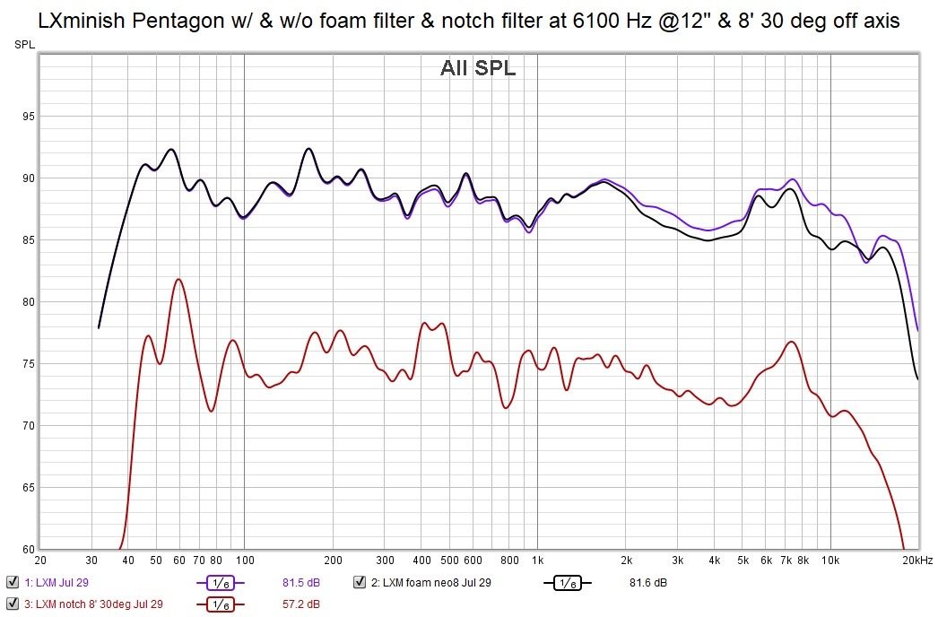

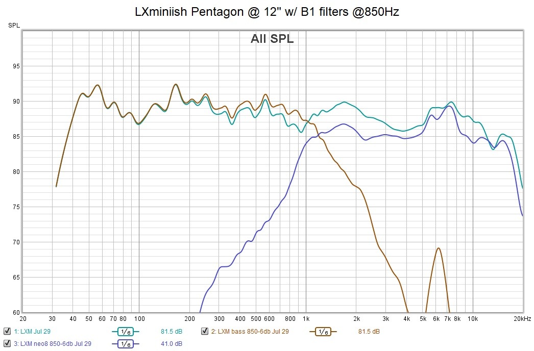

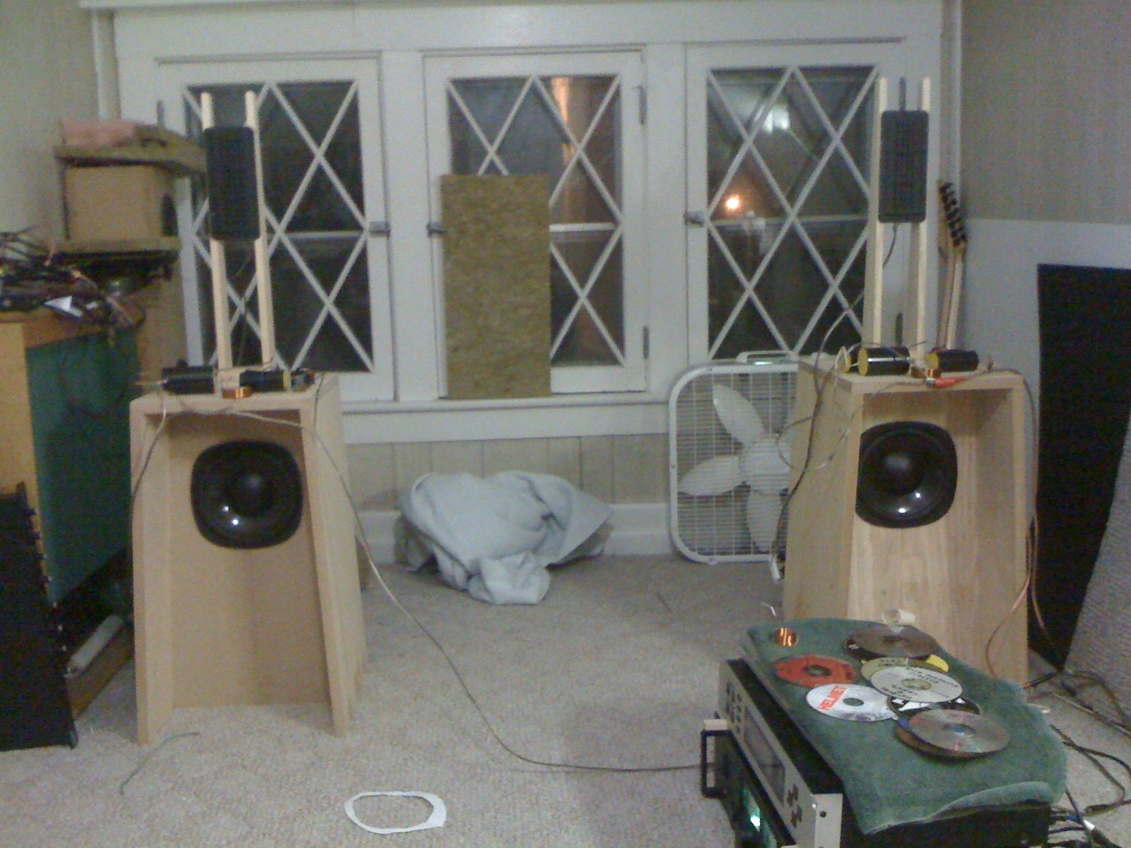

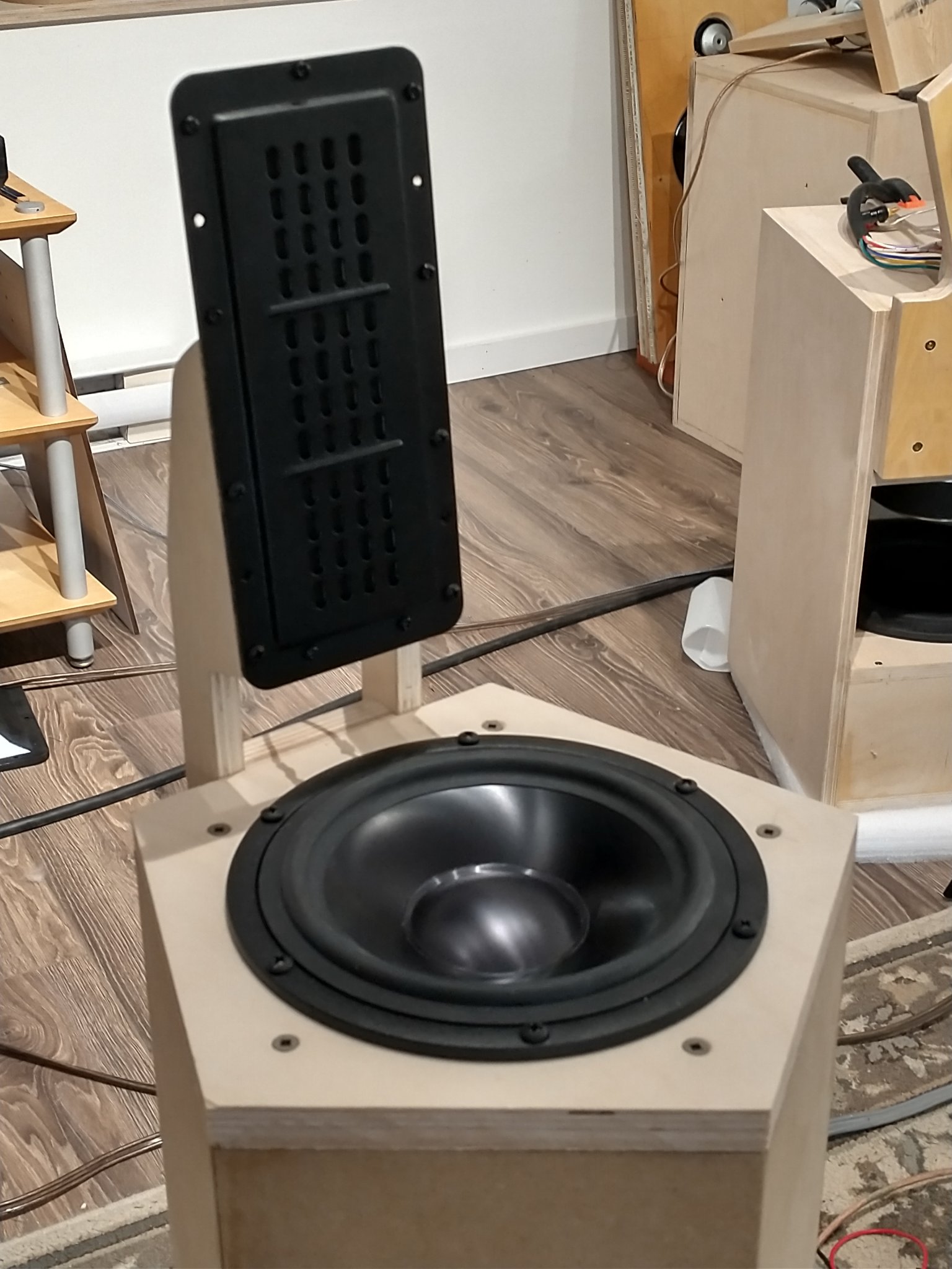

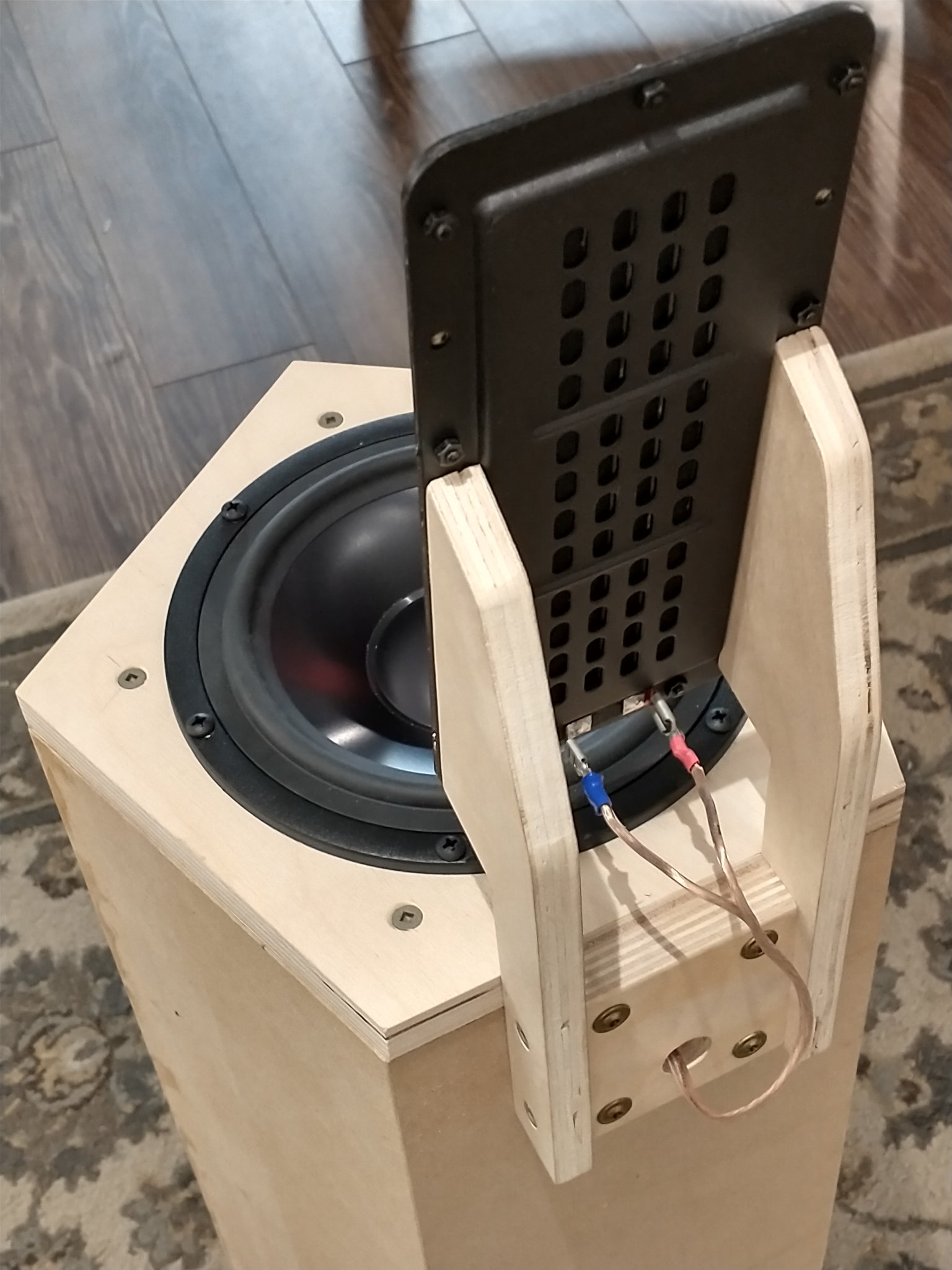

The 2nd box is glued up but needs a lot of fine detailed work. Meanwhile, I've made a change to the way the Neo8 is mounted on the 1st tower. It's less physical imedance than before. Of course, the rear pointed tail of the baffle was also removed. The tilt is now 6 degrees -- 1 degree change, probably not audible.
I had applied a bunch of filters in the minidsp 2x4 HD yesterday based on 1m measurements, but decided to start from scratch with the new Neo8 mounting.
Tried 2nd order for woofer, then tweeter, then played with xover points from 750Hz to about 1kHz. A few measurements but none kept -- I kept going back to the B1 filter @850, so decided to keep it there.
WOOFER EQ: A +5 dB Q=1.3 boost @ 50Hz brought up the bass nicely, both measured and heard. Later, I used a narrow Q=5 -16 dB cut at 6100Hz to get rid of the metal bass cone breakup.
TWEETER: Applied -4 dB Q=1.2 cut @11kHz to tame the on-axis peak, and +3 dB Q=1 boost @4300 Hz.
All 1m measurements had this deep suckout centered around 110 dB, which I didn't really hear. It is still there at 1' -- and 8' @ 30 degrees off axis where I'm seated at the control desk.
I tried some wedge shaped foam pieces covering the top and bottom portions of the Neo8 to increase vertical dispersion, but after half an hour of measurements and listening, decided they weren't worth the trouble. Forgot to take pics.

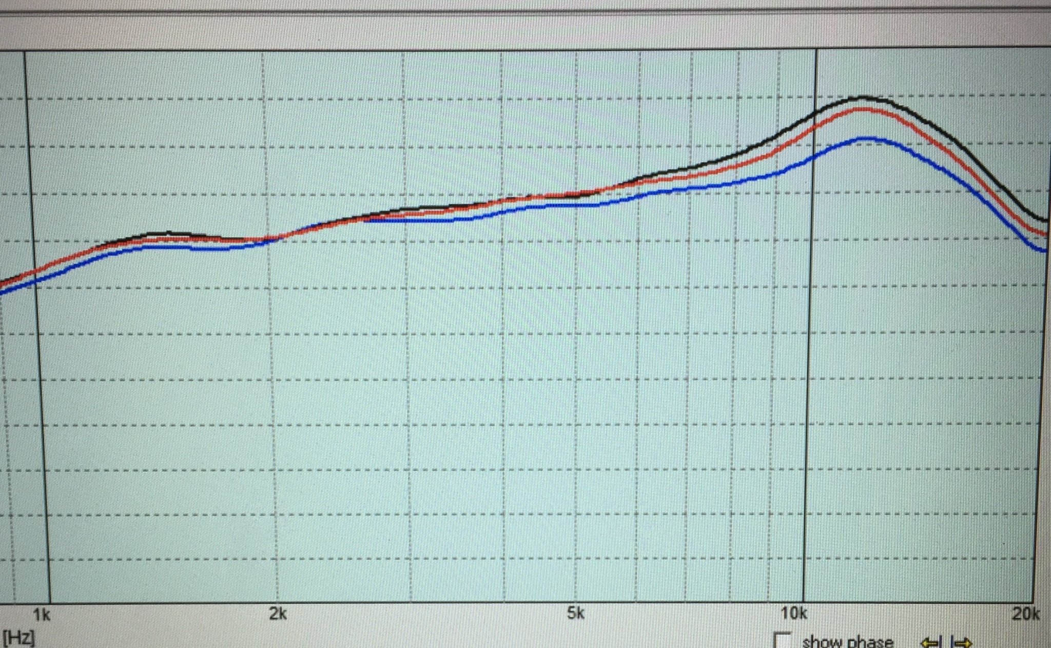

REW screen captures for the above added.

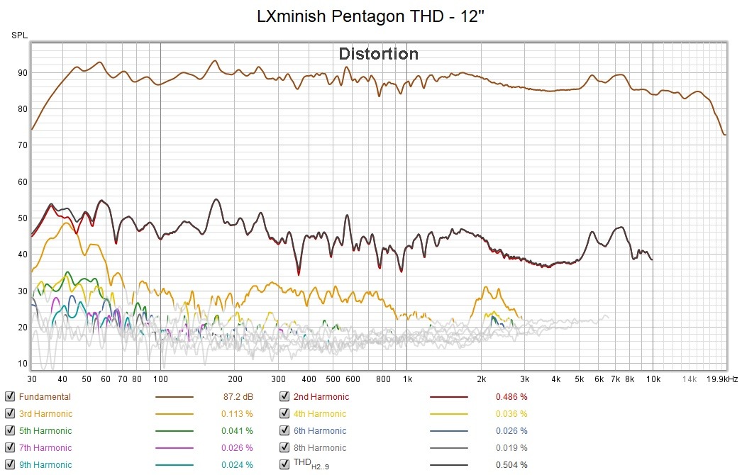

For distortion measurements, the amplitude is about 6 dB less at 1m, so mid 80s. Overall distortion is modest, even with the bass boost. I did hit 96-98 dB peaks around 50 Hz in music and noticed a bit of audible distortion compared to lower volume settings. I'd guess around 100 dB @ 1m is probably a safe max in the bass for these speakers -- in my fairly well damped ~4000 cubic ft room.

One more change I just applied -- 6 dB Q=2 boost at 20 kHz in case anyone can hear up that high. I'm pretty sure my sensitivity >15 kHz is quite reduced.
Made no difference at all in the measured response at my seated position. 😆
Turned that off & turned on a cut of -3 dB@ 7.5 kHz which tamed that brightness.
