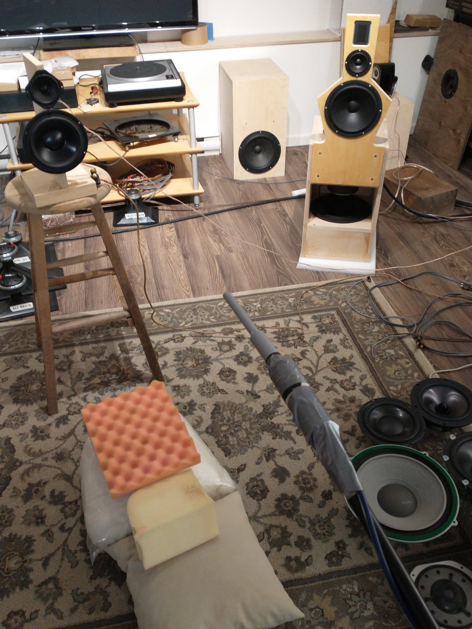

Spent much of yesterday working on crossover trials with analog Dayton measurement mic, REW, and the filter/REQ software in the minidsp 2x4 HD in mono. A Rotel RMB-1048 amp was used. My focus was on the OB array, considering it as a 2-way. SPL was ~90 dB mostly at 1'
I tried multiple 2nd and 4th order crossovers from about 1 kHz to 1.5 kHz after applying EQ to the mid & tweeter to ensure reasonably flat response beyond the xover point, down to ~100 Hz on the SEAS 6.5". A variety of vocals-heavy musical tracks on Tidal & on my PC via JRiver were also used for listening. While a few configs produced fairly linear FR (say +,-2 dB from 1' mic distance) through the transition, none actually sounded great. This was with the OB module about 2' from the wall. Tried moving it to 4' and it improved subjectively, but the two drivers never really meshed. I hear the TC9 as somewhat distorted, perhaps tizzy and fuzzy. May need to examine the phase response as well.
In the end, I mounted another TC9 in the same ~0.7' cardboard box with foam stuffing that I've used to test/listen to the Scanspeak 10F and SEAS MU10RB drivers, and running it full range without any EQ. Hmmmm. Inconclusive, but despite it being successfully used in some XRK971 FAST/WAW systems, as a tweeter, the TC9 sounds unsatisfactory to me so far. Perhaps my perception is affected by high expectation bias.

1' mic distance
Close to a dipole, things tend to measure incorrectly (unless you're going to listen at that distance). I'd put the microphone at least a meter away if trying to equalize for basic frequency balance. I'd do this far away from any room boundaries also. It sounds like you're dealing with too many variables simultaneously. I'd wait until I had some things calmed down before introducing the rear wall issue (or any walls for that matter - they just confuse things if you don't have the basics ironed out).
TC9 seemed like an odd choice to me, given the budget you've alotted to the rest of the system. Good for the price, but I don't think I would personally make it the heart of a $1500 system. That said, the one time I heard TC9's was in a less than ideal setup, so I am not familiar with the outer limits of their potential
Yeah you're probably right. Reprise soon with dipole in middle of room & mic a meter away.

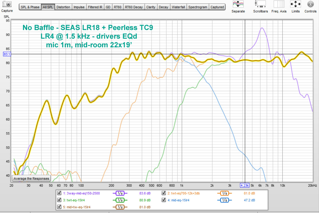

The best FR for LR18 mid+TC9 tweeter achieved 6-7' from front wall, tweeter @ 43"H, mic 1m aimed between mid + tweeter.
Should have been doing this -- mid room/1m -- right from the start. :rolleyes:
Listening again just to the pair, w/o woofer. Mostly vocals. Overall much better than previous configs, and where the pair is positioned, there's great spaciousness but still something a bit off with female voices. Sibilance doesn't sound natural, kind of "thick"; any vocalist with a trace of lisp -- a lot more of them than you might think! -- sounds bad.
Increasing tweeter gain 1-2 dB helps but not quite enough. A 5 dB boost @ 12 kHz, 0.5Q helps a lot. But the lisping sibilance is still a bit weird.
Atop the bass box, OB drivers 2' from wall, a lot of the spatial openness fades. Sounds constricted. Pulling whole thing 4' from wall makes it better. This seems like a nail on the 2' from wall OB. :(
