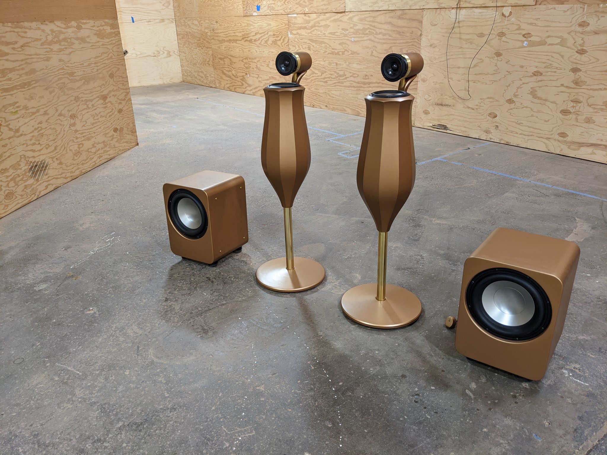

Nothing is out of the question; the Lxmini was touched upon earlier. Its standard plastic pipe form is generally not acceptable cosmetically, but if the performance and other criteria meet my requirements, I'd have to take a close look at making it a more attractive form.
I was introduced recently to a local resident who has a working pair of Lxmini in a unique & attractive champagne flute glass shape finished in multiple coats of a white automotive paint. CNC used for construction. Haven't had a chance to hear them; he's away at the moment.

Pic of another pair this CNC gent made. And no he doesn't have a CNC anymore; he used to run a biz with a large CNC at it's core.

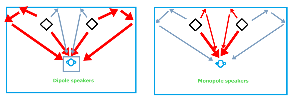

Front wall reflection shouldn't be a big problem with dipoles in stereo setup. Angulation tames reflected energy. A cardioid won't give any rear radiation, so it for sure will sound different, not so airy. I have taken measurements of the effect, but I couldn't find it now.

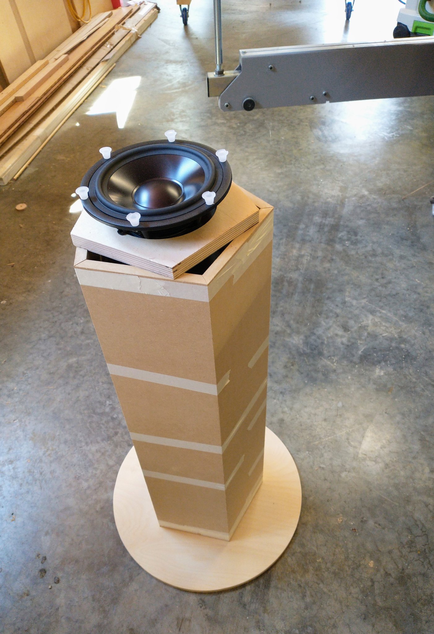

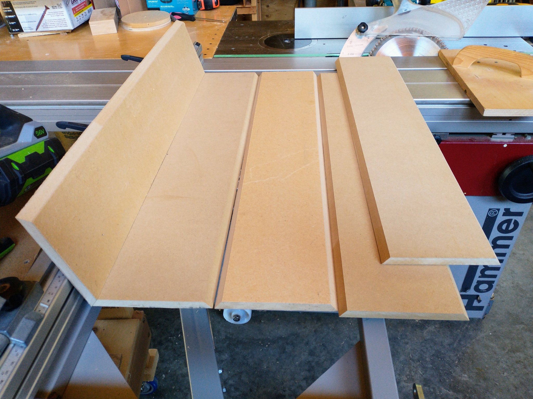

Unlike some of the truly meticulous posters here, I don't even have any drawings or a fully fleshed out plan, but I starting making some sawdust. Nothing like some action to make one feel progress is happening. 😏

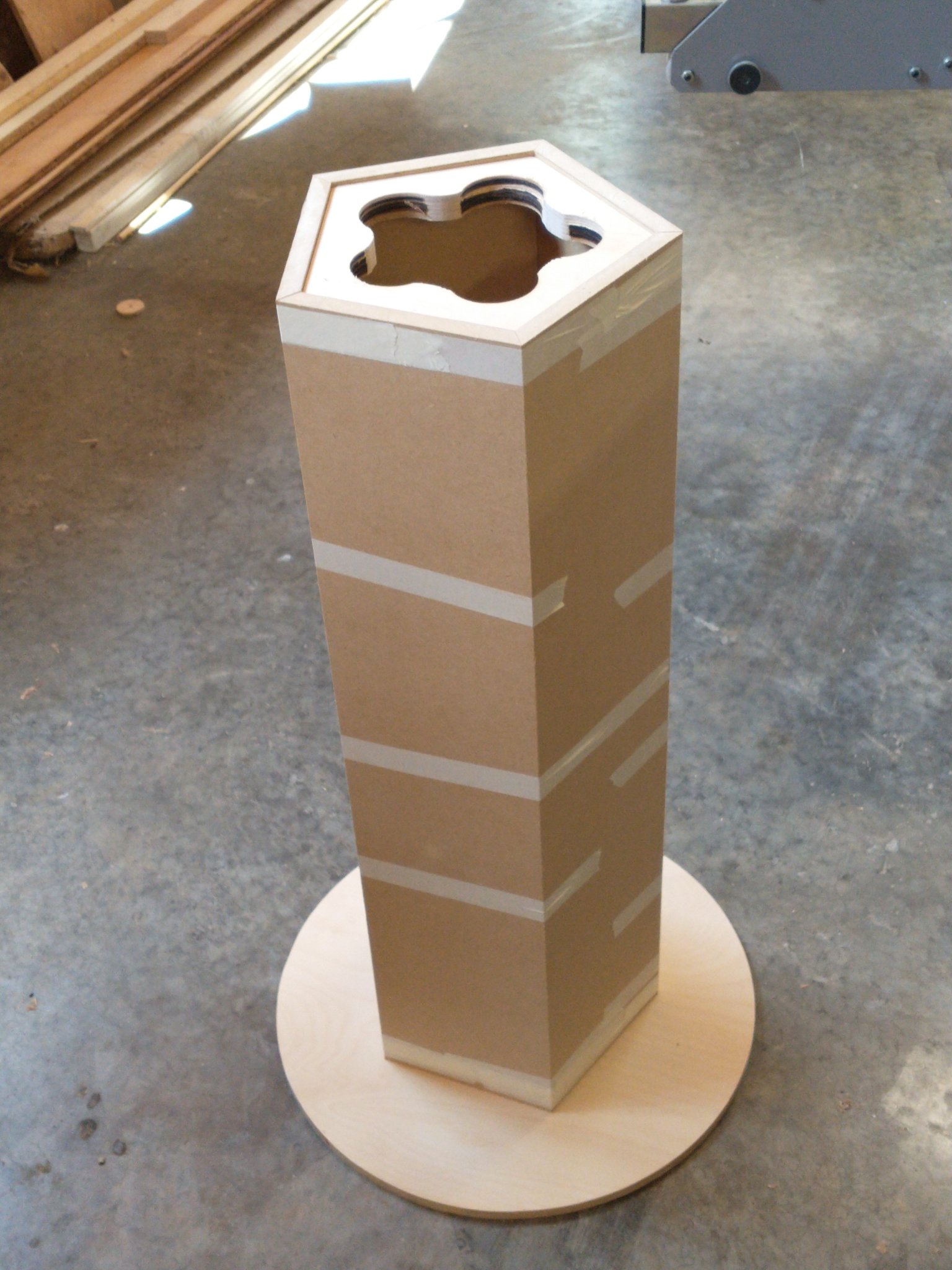

I was wrong about the angle of the edges for 5 boards to form a regular pentagon profile tube. It's 36 degrees. I cut 10 pieces of a 1/2" MDF sheet on hand for a pair. With a sliding table saw, I got good enough accuracy to make it work. The pentagon rings from 18mm BB plywood for internal supports were hard to get just right; this took more time than expected, but such are my woodworking skills.
1/2 MDF might be a touch thin, but with 3 internal braces (attached via silicone instead of glue for constrained-layer damping) + double thickness top baffle & cap on the bottom of the 30" tube, it should be rigid enough. Each panel is 5.25" wide internally, and the internal ring braces will ensure the longest unsupported length will be only about 7". A 5x7" panel's first resonance should be pretty narrow Q & high in freq.
The estimated internal volume is 24 liters, which is way more than the 18L needed for the WINISD predicted 0.7 Q for my Seas L18RN-TE driver. F3 @50 Hz, which is higher than I want but there's DSP PEQ, Linkwitz transform. The extra volume will give me options for things like maybe mounting a small amp in the bottom of the enclosure & help the deep bass (F10 @27 Hz instead of 30 Hz) The pentagon profile ensures there are no parallel surfaces (except the bottom, which a tiny portion of the total internal panel area) & thus no standing waves.
One of the edges will be the "front", and the tweeter assembly will be mounted on the opposite panel.
