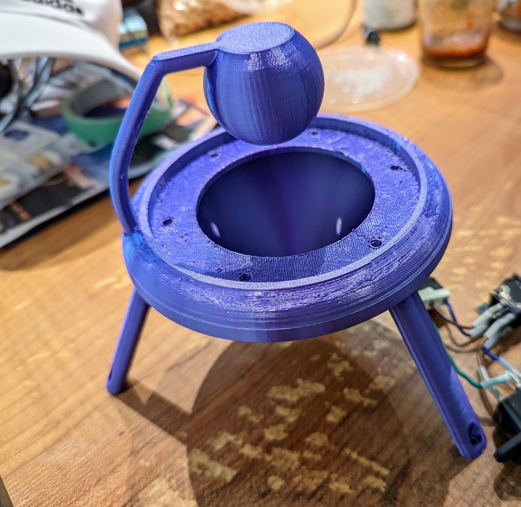

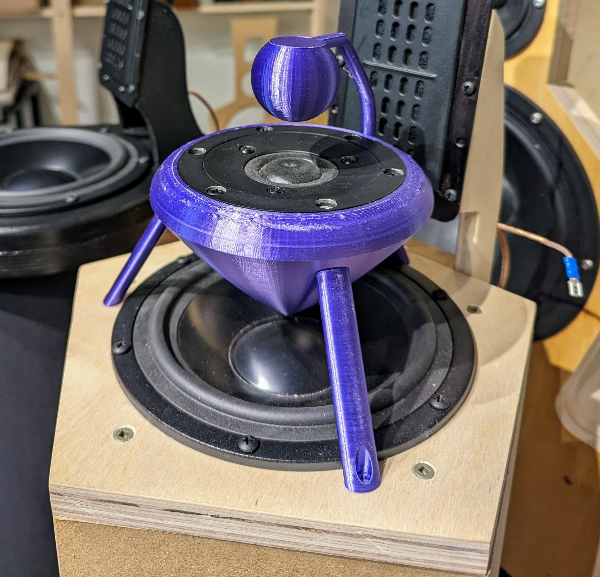

I chose a shallow cone for the first reflectors (v1 & v1.1), 3D printed in purple, to keep the distance between the drivers small. Why? Instinct. It was sized so that when viewed from above, the outer edge of the woofer surround is just visible. The tweeter reflector was sized similarly.
Initial sweeps & listening with these reflectors suggested that a fair proportion of the drivers' energy was radiating more upwards than across. Positioning the mic (@1m horizontal distance) at tweeter height to one foot higher increased overall SPL. Sitting and standing, I could hear this. So, for version 1.2, the black one, the main reflector's contour was made shallower, closer to the angle of the woofer cone to create more of a 90 degree reflection, and the legs shortened to bring the reflector closer to the cone. The latter I misjudged, not taking into account the excursions of the 6.5" cone at low frequencies. At some point during testing or listening, the woofer center cap hit the bottom of the reflector. The cap got crushed inwards (much like domes of tweeter poked in by kids' fingers. ) No measured or audible consequences of that accident, but this is why the pics of the black reflector show it raised up by screws on the based of its legs. The nippled ball tweeter reflector, positioned closer to the dome, was introduced in V1.3 In any case, reflector v1.3 directs more of the speaker's acoustic output horizontall. This was confirmed by both listening & measurements.

Not really. I simply copied existing designs that seemed successful and fine-tuned my interpretation by measurements and listening.Did you need a lot of trial and error reflector profiles to balance this out laterally, or are there worksheets somewhere for this sort of thing?
