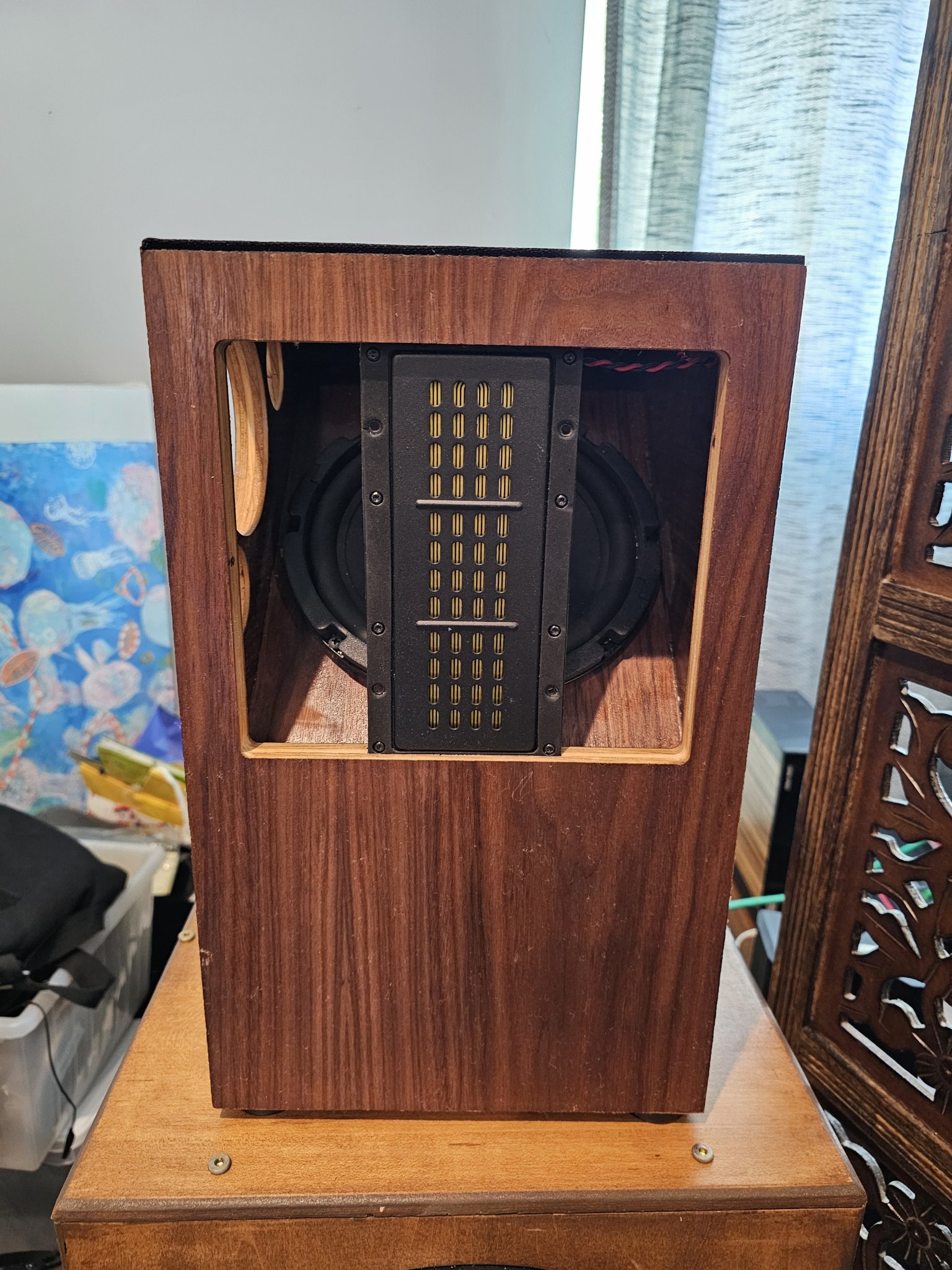

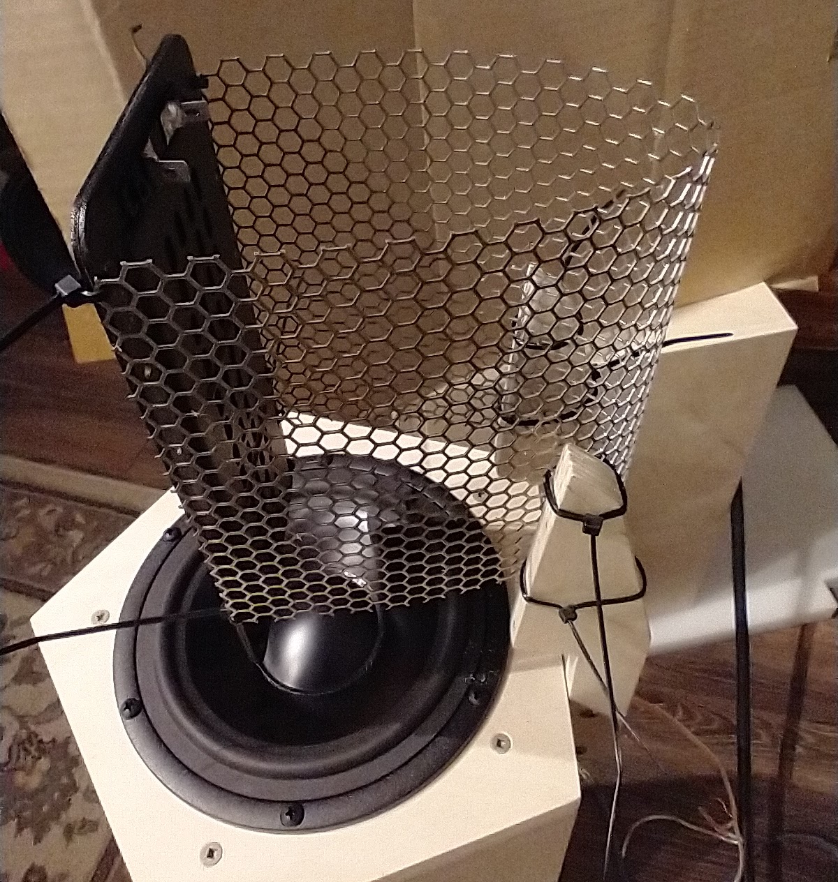

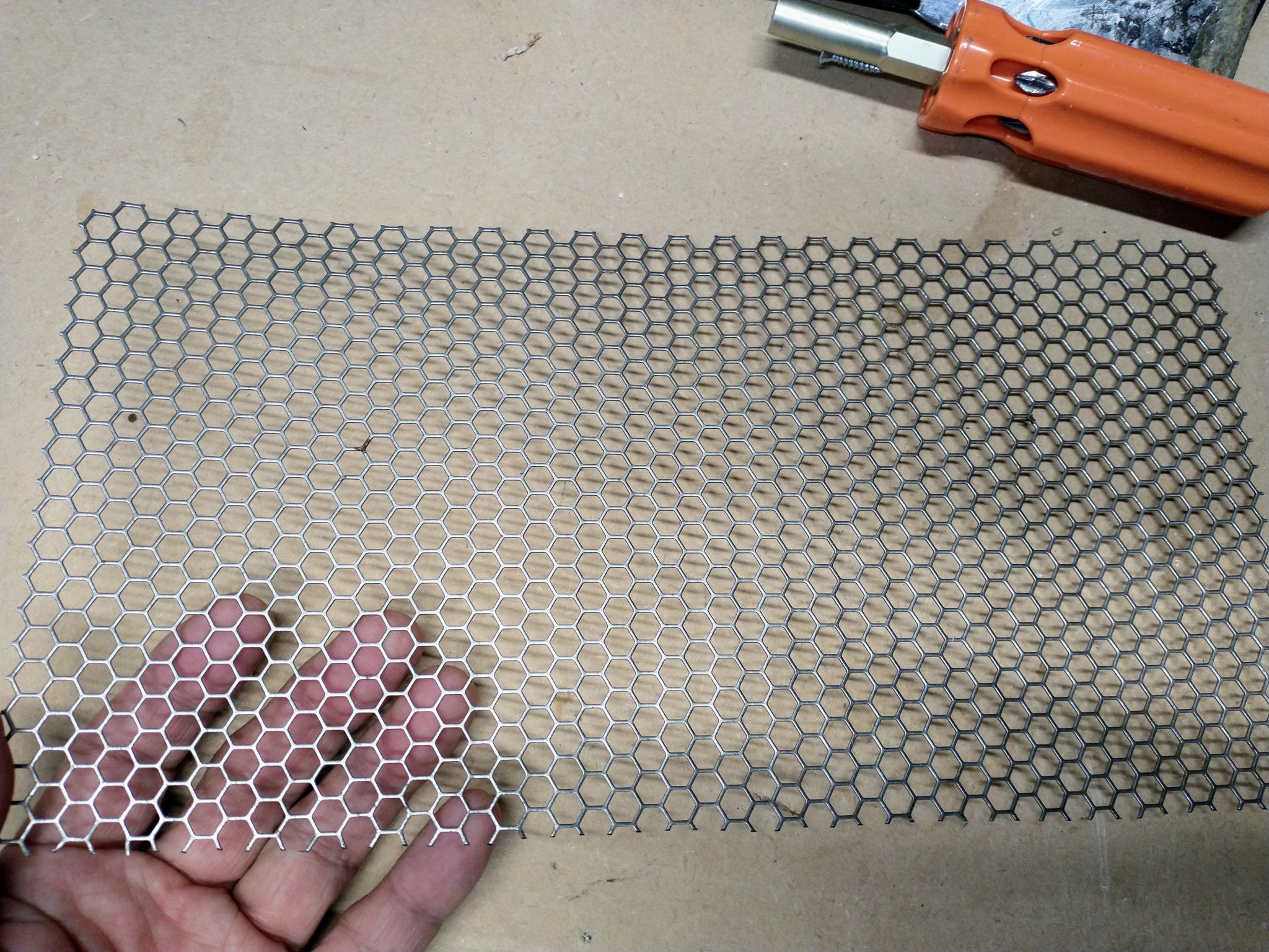

I did find a solution: A piece of hexagon mesh aluminum from some long-forgotten project. Removed Neo8 driver from one Pentagon tower & mounted it with the mesh sheet, zip-ties & wires over the bass driver. The bottom edge of it ended up a bit closer to the woofer cone -- about 1" above the level of the surround vs 1.6" or so on the original offset Neo8, which was left untouched on the other speaker. The original wood supports for the Neo8 were used to anchor the mesh.
Disconnected the PTmini-6 & passive crossover components, put both towers in the middle of the room about 2' apart. Measured FR of just the Neo8s with mic 2' away, both front and back. A 300Hz 48 dB/oct high pass was set in the minidsp 2x4hd to protect the Neo8s.

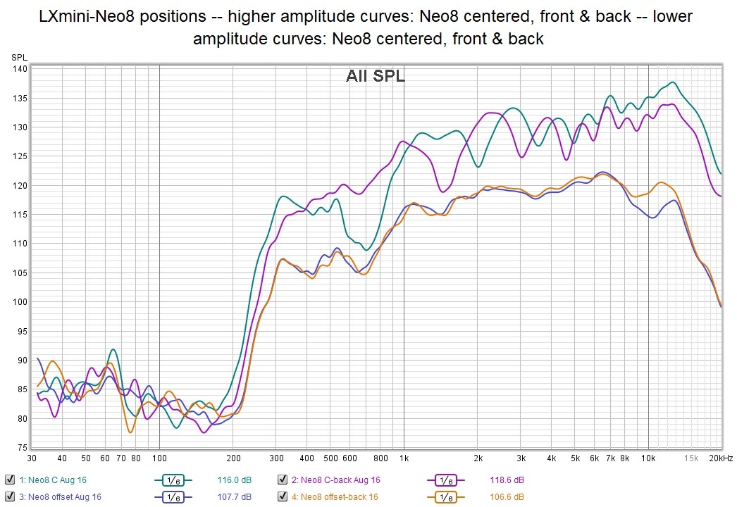

I find it curious that contrary to drewmc's concerns, the offset Neo8 has virtually identical front & back FR, compared to the centered Neo8, whose back directivity is considerably different from the front. Of course, the wooden supports left on the center Neo8 speaker could be responsible, and it's also possible the mic wasn't at exactly the same distance.

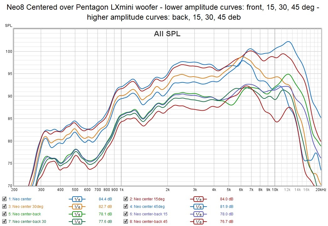

Front & rear FR curves for Neo8 centered over woofer on Pentagon LXmini woofer (about 1" above level of surround)

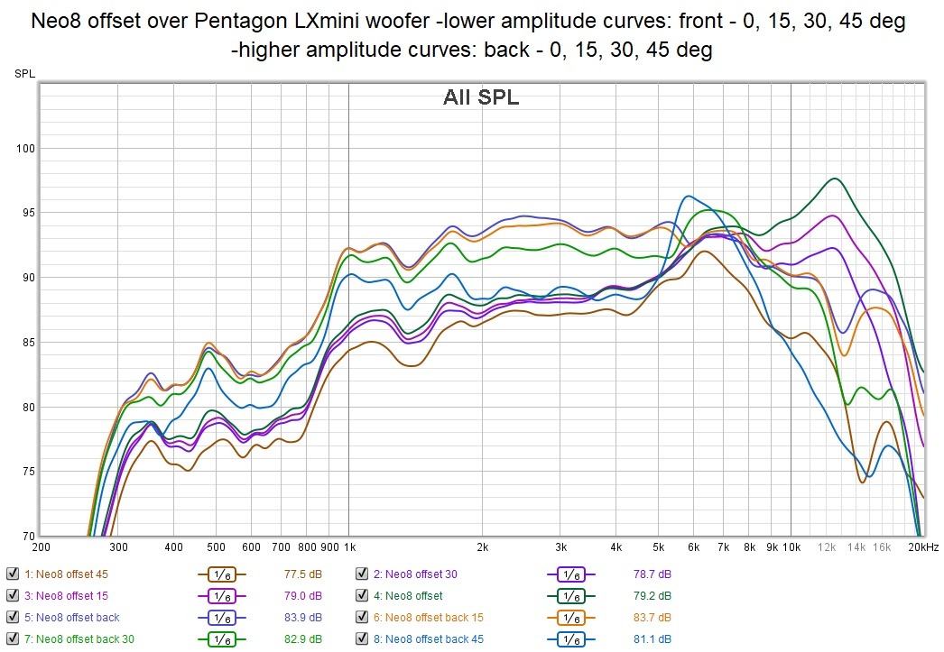

Front & rear FR curves of Neo8 mounted offset off the back, not actually OVER the Pentagon LXmini woofer. rather more over its "back" edge.
The front & back curves on both of the above were done at -20 and -15 dB sweeps to try and make them easier to see.
I know leaving the support structures for the Neo8 in place may impinge on the clarity of this test/comparison, but... 😐
It's a lot of data but you can see that...
1) the stretch 1~5kHz is more linear on the offset Neo8, both front AND back.
2) Both offset & centered mounting show increased peakiness around 7kHz for the rear waveform.
3) The above peak begins at a slightly lower frequency for the offset Neo8 and has a higher amplitude.
Given the flatter 1-5 kHz response of the offset Neo8, it's my preference. I don't think the linearity of the back radiation is as important. Also mounting the Neo8 in the offset position is much easier.

First glance the centered looks a bit better because of the bunching up of the offset between 6-7KHz. Seems after a bit of EQ the centered would perform a little better?
Not sure about "a bit of eq". More like a lot, methinks. Between 1.1 kHz & 2.2 kHz, the front FR of the centered Neo8 has >5 dB difference. That's a whole octave -- 2nd to last on the treble side of a piano. Much smaller difference with the offset Neo. The higher freq peaks are actually much narrower if you view them musically, in octaves, and affect mostly overtones. The 7-12 kHz peaks seem nearly unavoidable -- which is why I tried the PTmini-6. Actually, all the curves look kinda bad. 🙁 But the last config I had of LP filter on Neo8 + high pass on PTmini-6 sounded about the best of all the configs I tried so far. Going to go back to that and keep working on the filters & PEQ.First glance the centered looks a bit better because of the bunching up of the offset between 6-7KHz. Seems after a bit of EQ the centered would perform a little better?
If someone has a brilliant scheme to simply and securely mount the Neo8 over the center of the woofer w/o acoustic impedance front or back, I'm all ears and eyes. I suspect it will have to be formed from metal.

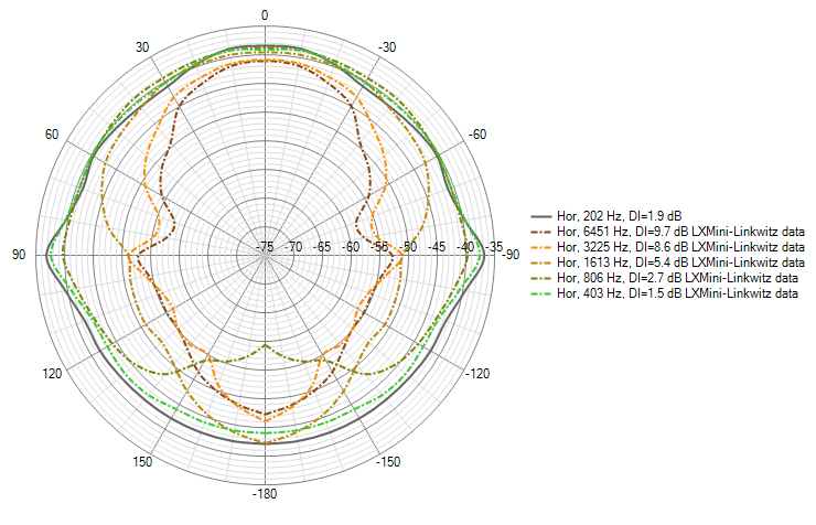

Right. From Linkwitz...
If I've followed correctly, the current experiment involves placement a safe distance from the back wall.
...and...The rear radiation from the dipole must be attenuated or scattered and diffused in order to minimize the influence of a large reflecting surface behind the dipole radiator. The cylindrical body behind the dipole driver serves that purpose as its dimensions are in the fractional wavelength range of the frequencies concerned. There is a small gap between the magnet and the inside of the pipe. The rear is open and stuffed with absorbent material for very high frequency attenuation.
So his intent was monopole + dipole = cardioid in the crossover region, then a modified dipole, more dispersed at the rear, to temper issues with relatively close boundaries to the rear.The radiator remains acoustically small through the crossover frequency range, where woofer and open baffle tweeter form a cardioid polar pattern around the tweeter axis. In the tweeter frequency range the radiation is dipolar, but with the rear radiation dispersed irregularly and gradually attenuated with increasing frequency. The pattern is formed by coaxial monopole and dipole sources.

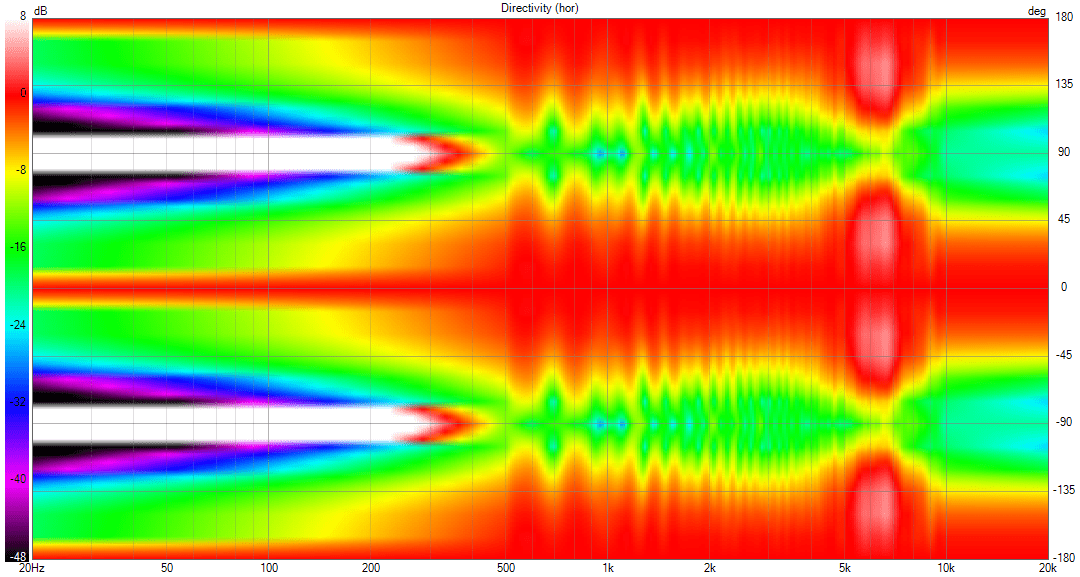

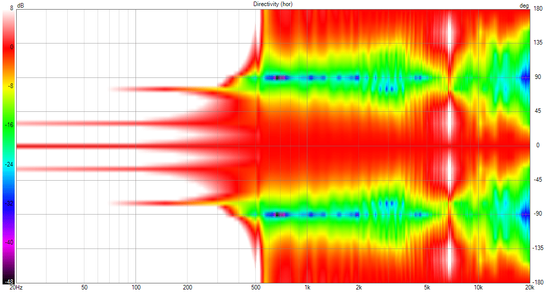

I became curious enough to trace Linkwitz' FR curves in VCad. The cardioid is in a pretty narrow range around 800 Hz, then dipole as promised. At higher frequencies (not shown), the peak at 180 deg that Linkwitz describes (as inaudible) shows up.
Ehem, SL perhaps tried to find recommendations that fit the acoustic properties that LXm happens to have, rather than did tremendous effort to make it perform that way.

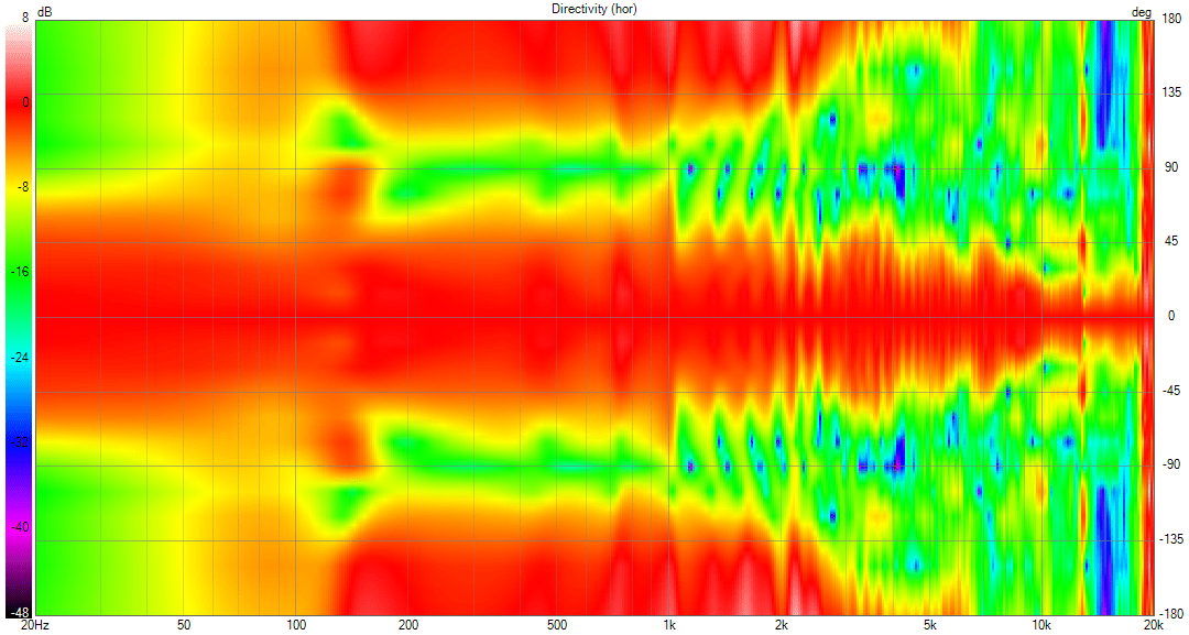

I still don't see how different the tube makes rearside radiation compared to a simple nude cone driver. Here I show Erin's Klippel NFS of LXmini horizontal and my homemade measurements of a 4" Audax HM100 that I was thinking of using as dipole mid for AINOgradients - ten years ago! After seeing these and looking at the relatively big magnet, I decided to order B&G Neo8. Sorry, I haven't saved similar 0-180 data of just the Neo8.
My raw response measurements were normalized in VCAD. Notice the similarity in general pattern. Pure dipole pattern is lost above 2kHz - rearside spl drops down and it's practically monopole with narrow pattern above 3kHz.
I copied my Neo(PDR nude 0-90 measurements as 105-180deg - they really are similar without a baffle! Freq was limited to 500-10 000Hz. Measurements are from Oct 2013. Dipole null is 7,5kHz.
And same for Neo3 PDR (in AINOgradient test frame) from 2015.

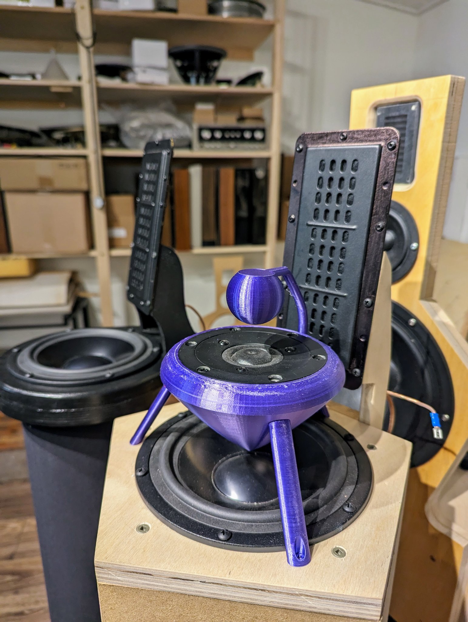

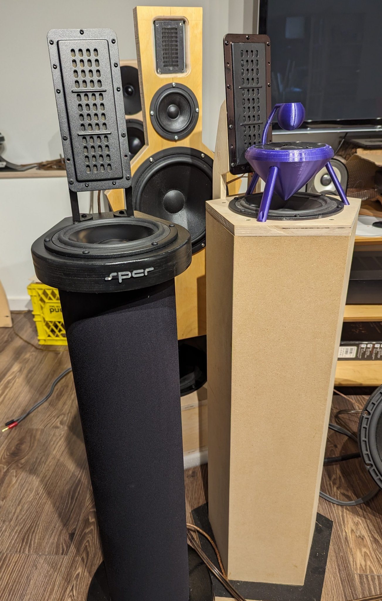

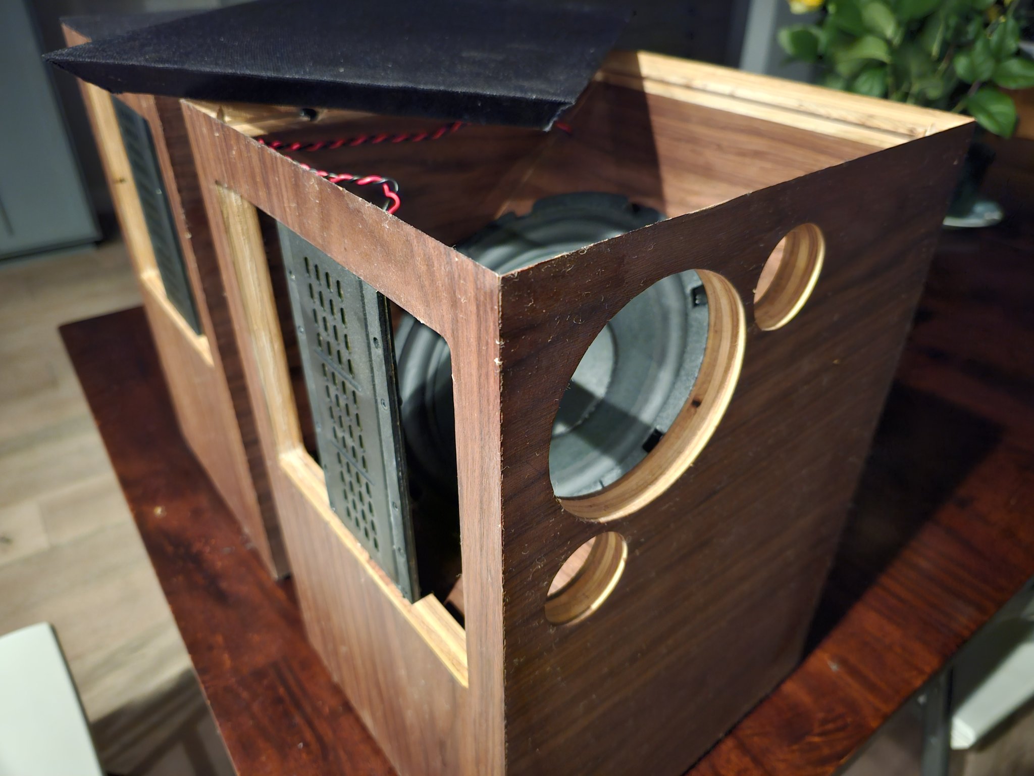

Here's my latest LXmini+NEO8 LXmini variant, and a 3D printed omni deflector that can replace the NEO8 with a SB TW29RN tweeter facing up toward a spherical deflector. This is the first iteration; a few adjustments need to made -- tweeter deflector needs to come down 1-1.5cm, and the struts made a bit sturdier. Obviously some smoothing of the surface also has to be applied. It's just a start. At least one more deflector has to be made, and a pair of these 7" towers modded to take the deflectors.
I also looked at the the Larsen speakers, which are basically omnis, but no one seems to have hands-on experience with them. They are often shown placed closed to the wall. Then I came across the Morrison speakers, which again are omnis combining the resonance-cancelling bass loading tech developed originally by Hegeman and now implemented in a different way for tweeters by KEF with its metamaterial damper. I've never actually paid much attention to omnis, but recently found that those who like them often aren't interested in other designs at all. Why this dedication? They can't all be nuts, right? (We all are, I know.) I needed to find out for myself. It occurred to be that omnis might be placed close to the wall without much negative effect: if properly implemented, the sound is projected in 360 degrees, horizontally at least, so the power response wouldn't be affected regardless of positioning. So...
