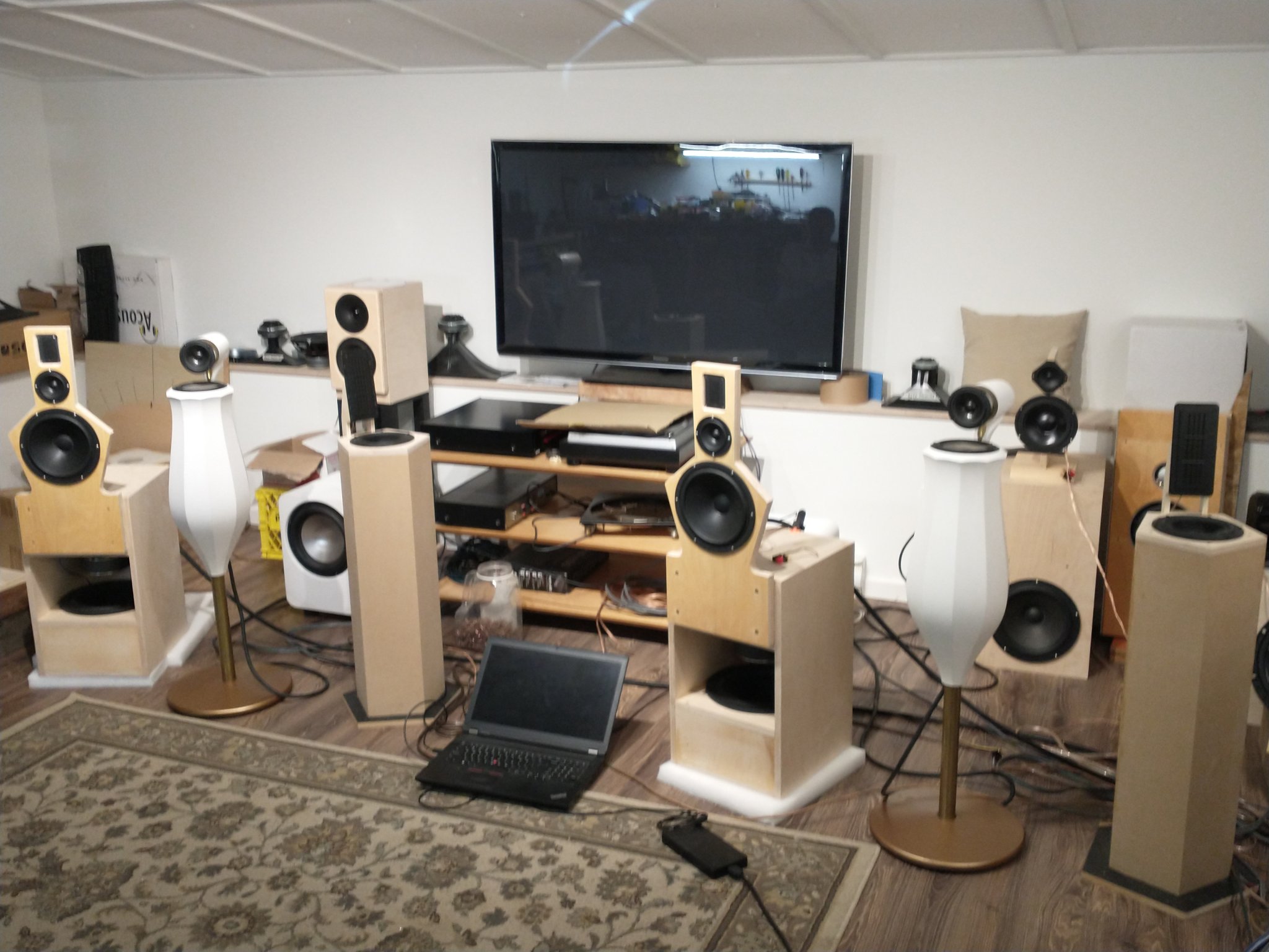

Finally got together with Brent, who brought his champagne flute LXminis + 2 Seas L26RO4Y subs. His subs each have a Hypex FA123 3-ch plate amp; each LXminis is connected to a sub/amp.
It was an interesting comparison. The deep bass of the champagne LXm was expectedly way better. But my pentagon tower bass is OK especially a bit higher up, and through the middle & highs, the Neo8 provide better detail & clarity. AND I think the more symmetrical dipole & undiminished rear radiation of the Neo8 gives it greater spaciousness -- closer to the LX521s.
No changes were made to the champagne LXm DSP settings. Brent cautioned that he'd toned down the treble because the room it resides in is quite lively and reflective. In contrast, the slanted ceiling of my 22x19x9' studio has 12" of fiberglass insulation behind panels normally used for drop-down ceiling, supposedly 50% reflective. And the intersection of the back wall and ceiling is a 19x3' tube trap made from 8" thick UltraTouch™ Denim Insulation. The balance is nice, but significantly more damped (and quieter) than your typical LR.

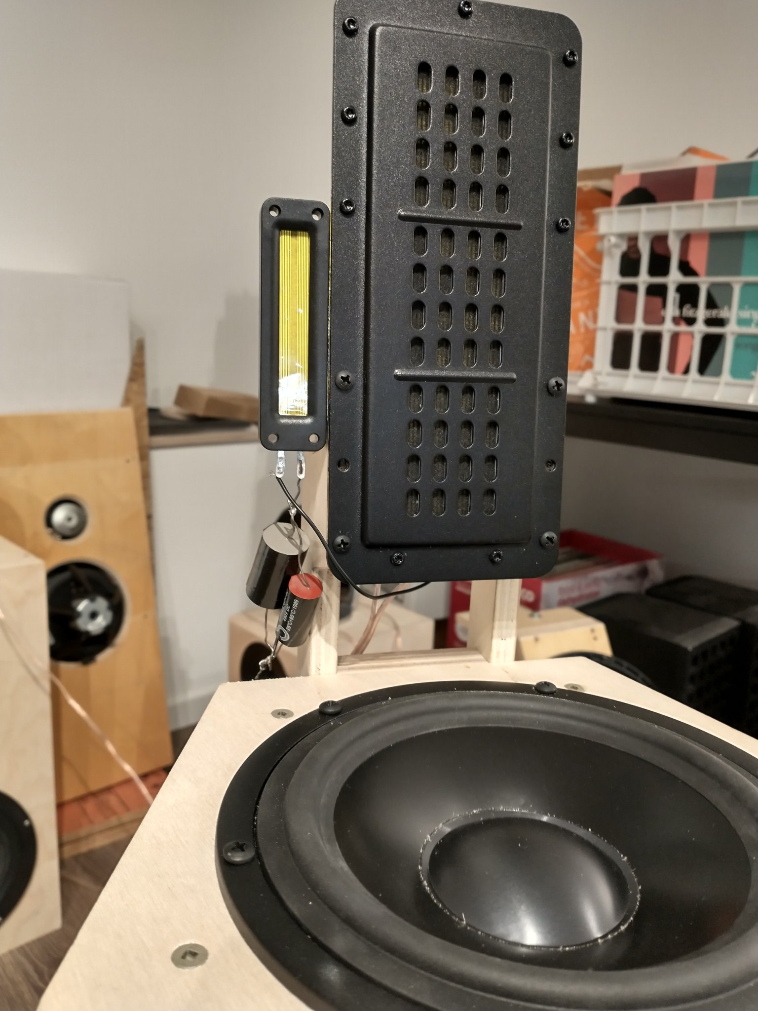

One other thing I did this morning was to add a Dayton PTmini-6 planar tweeter in the inside edge of each Neo8, using double-sided tape. At first, I tried 2 + 1 mfd for a ~9kHz 1st order high pass for the PTmini-6, but then changed it to just 2mfd for 13kHz. No attenuation -- the Neo8 is rated for 92 dB/2.83v, and the PTmini-6 is 90 dB. It sounds balanced to me. The result is sparkle at the top which was missing with just the Neo8, easily audible with most recordings from anywhere in front of the speakers. Yes, the improved extension and dispersion is quite audible & welcome.

After a day of listening with the PTmini-6 as a super-tweeter, I have to say it sounds better thasn without. But I wonder if rolling the Neo 8 off before its steep on-axis peak @12kHz would help. This would mean lowering the HP frequency on the PTmini-6 to around 8~9kHz. The 6.5 ohm flat impedance curve of the Neo8 means a 0.11 mH coil would provide 1st order HP @9kHz. But not sure I have that small an inductor. And my Dayton DATS V3 is flaking out so can't measure inductance even I wind the coils myself.

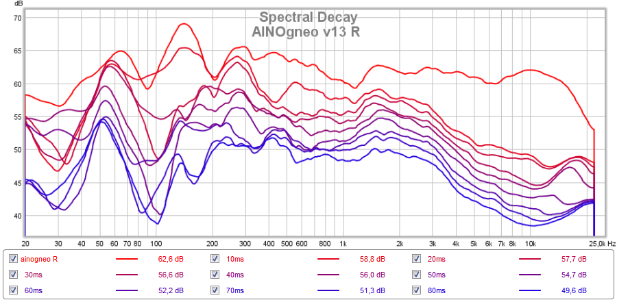

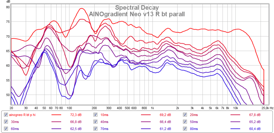

In addition to spl response, you should check decay - it reflects how you perceive tonality. "Dull" sound typically has falling treble response in decay.
Here the effect of added rearside tweeter to a tweeter with a horn. Mid is Neo8. Interval settings make graphs look very different, you must try this with REW, both with CSD and Decay

OK, got the DATS V3 running again -- mysterious Windows driver conflict maybe. Got am inductor 0.11 mH in series with each Neo8. The result is a 1st order LP for the Neo8 starting @9kHz. PTmini-6's 2mfd cap is a 1st order HP at 13kHz. Hole in the middle? No, because of the peak in Neo8.
This crossover is so simple to implement because of the flat impedance curve of both drivers, at ~6 ohms. The little planar is only asked to play the last octave of usable sounds (in music), and the overlap between them is broad.
