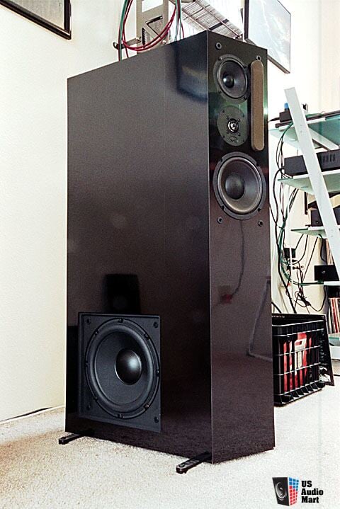

Ken Kantor’s NHT 3.3 speaker took advantage of the bass reinforcement effects of room boundaries with a low Q sealed enclosure to provide predictable deep bass extension. This large late ‘80s 4-way combined a 12” side-firing woofer positioned at the intersection of floor and front wall with an ear-height assembly of lower mid, high mid & tweeter. The 3 smaller drivers were at the top of a front baffle angled 21 degrees toward the listening area; in mirror image pairs, the woofers for a stereo pair faced each other. They had an unusual shape and size: 42" H by 7" W by 31" D. No typo -- just 7” wide but 31” deep! The angled baffle made it just wide enough to fit the 6.5” low mid driver. The narrow deep shape was deliberate. The upper frequency drivers ended up >2.5’ away from the front wall, which reduced diffraction and increased the ratio of direct-to-reflected sound. These speakers were lauded for deep articulate bass even at high levels, good imaging and neutral balance. https://www.stereophile.com/floorloudspeakers/1293nht/index.html
I ran the smaller NHT 2.9 in my main system for some years. The woofer was a 10” instead of the 12” in the 3.3, and the cabinet was scaled down, but the other drivers were identical to the 3.3. It was not the last word in immediacy or transparency, but those aspects were decent, and the overall tonal balance when placed close to the short wall of my room (13’ x 30’) was excellent. Bass was deep and powerful if a touch heavy on some recordings, and the speakers were tonally neutral, not favoring any particular type of music. They were quite enjoyable.

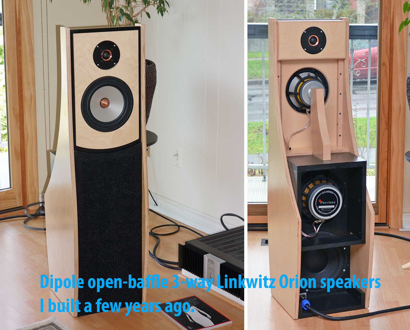

The Linkwitz Orion (3.3) I built in 2014 outperformed the NHT 2.9 in every way, but this was to be expected. The Orion was active, EQ'd electronically, fully dipole, and employed drivers that cost upwards of CA$3,000 -- many times that of the components in the NHT. It was also driven with 50Wx8 rather than a 100W/ch stereo amp & needed to be further out away from the wall to do their magic.

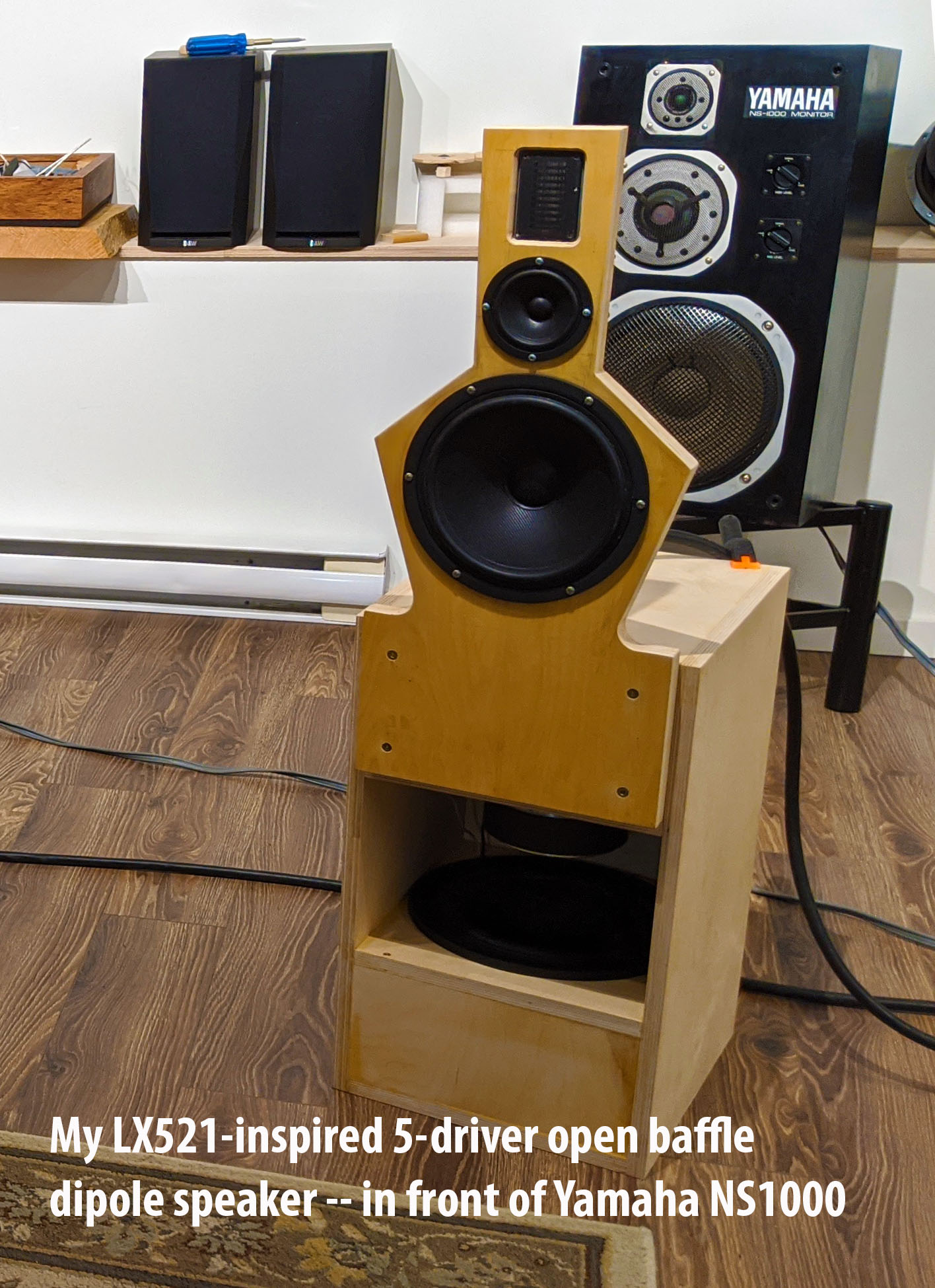

I’ve been experimenting with open baffle speakers ever since. My latest LX521-inspired speakers are likely as good as I’ll ever want. They are amazing performers that evoke “wow” from just about anyone who listens to them. But much as I love the imaging, depth & openness of open baffle speakers, their complexity, cost and positioning requirements are not for everyone. My LX521-inspired build, for example, uses drivers of ~CA$2,500 net, 8-conductors of cable to each speaker, an 8-ch Hypex NC252 amp connected with 8 signal cables to a minidsp 4x10 HD. In my audio-dedicated acoustically treated 22Wx19’D studio, they sound best nearly 5 feet from the front wall and >6’ from the side walls. Such positioning plus >CA$7,000 in components (before any source or control components) aren't feasible for a lot of folks. (Never mind the US$24,000 for a factory-built LX521 system from Linkwitz.store)

  1. NHT floor/wall-adjacent bass driver in low-Q sealed enclosure -- a fairly reliable way to obtain articulate sub-40Hz bass. Not as good as OB, imo, but sealed bass generally sound better than most ported ones to me, and have better overload protection from low frequency grunge in vinyl sources. A system Q of 0.5 is ideal (I believe) for quarter-hemispherical radiation, but if the box is made a bit too small and higher Q results, then positioning a bit further from the front wall can counter any bass hump -- but many prefer a “fat” bass over a more linear presentation anyway. The question of crossover frequency and slope for the inside-facing woofer comes up. The NHTs had 2nd order crossovers at 100Hz & 320Hz, and 3rd order at 3.5 kHz. The 100 Hz xover point may have been chosen to prevent directional confusion as the woofer is mounted sideways. However, a 100 Hz xover point is challenging for an open baffle driver that might also need to go as high as 1500 or 2000 Hz. 100 Hz almost demands at least an 8” mid driver, a size that limits how high it can go. Perhaps a 6.5” mid should make it to 1500 Hz without much beaming. Also, would a front-facing woofer get enough reinforcement for good bass extension? If so, crossing to a 6.5” mid at 300 Hz or higher is probably preferable.
The Peerless 830668 10” SLS, used in John K’s NaO Note II, seems a good inexpensive woofer choice: A sealed 1.6’ enclosure would put F3 at around 45 Hz. (Key parameters: 32 Hz F, 0.55 Qts, 62 liters Vas) Judicious stuffing & placement against the wall should bring F3 down below 40 Hz. EQ with DSP would make this easy. The stamped frame is less than ideal but pressure-bracing against the back of the magnet should reduce effects of frame vibration. Unlike so many Peerless drivers, this one is still available from Solen & Parts Express in <1000-lot quantities.​
A box of ¾” thick panels with outer dimensions 24”D x 30”H x 5.8”W is 1.6 cubic feet. Increasing the width of the front panel would make it look more balanced with the open baffle module on top, so the height could be dropped to 28” and width increased to 8”. Any extra volume won’t hurt.​

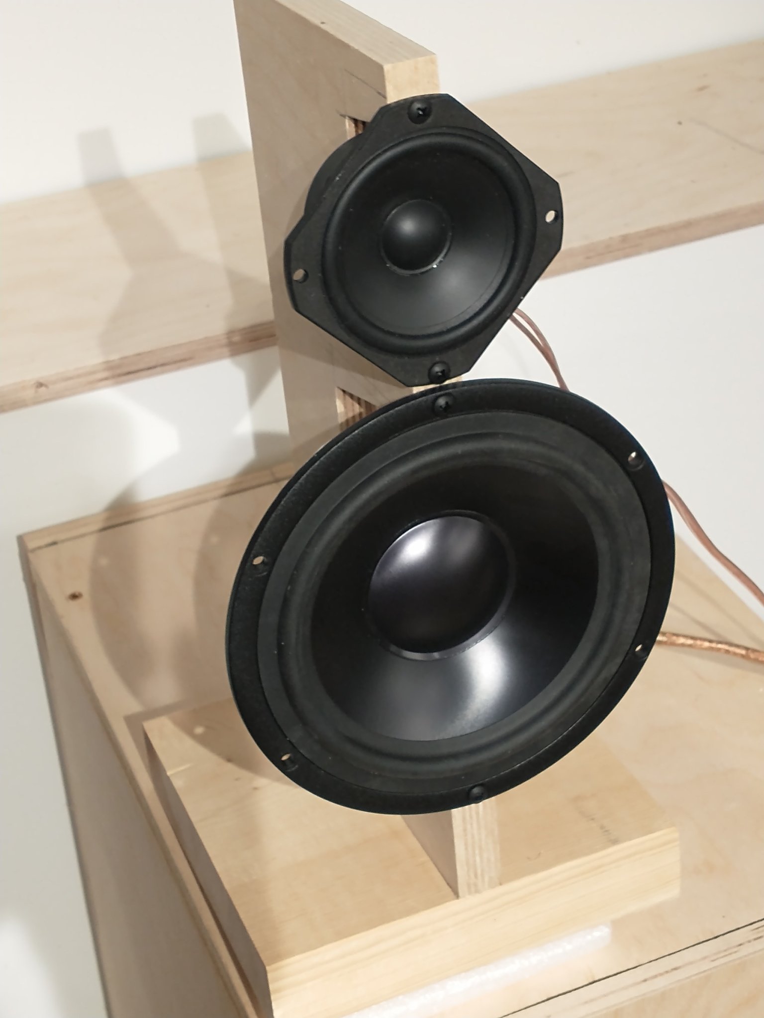

  1. Minimal-baffle dipole for mid & tweeter, rotatable for “aiming”. There are so many examples of minimal baffle dipoles, and much discussion of the benefits (and drawbacks) so no need to elaborate. The main question is how much distance between wall and back of drivers is needed to get at least some of the dipole benefits? I aim to determine that experimentally, but if others can chime in with experiences or simulations, that would be most helpful.
I have a handful of new aluminum cone 6.5” SEAS L18RN drivers. They were custom made for a Canadian startup that didn’t during the covid pandemic. Optimized for low bass but with decent measured FR to 1.5 kHz. Well made, typical SEAS quality. This is my choice for the midrange ATM.​
Dipole tweeters like the GRS magnetic planars and small AMTs were considered, but none are able to extend down low enough. 1500 Hz is a tough call for most small tweeters. However, XRK971’s well-liked FAST / WAW Ref Monitor uses the Scanspeak 10F full-range 3” driver as a tweeter, which got me scouring my shelves for similar drivers. The 10F (used in my version of LX521) is a bit too pricey to meet my (semi-arbitrary) cost target, but a Peerless TC9FD18-08 is just 20% of the price, and fairly close in performance -- iirc, they did originate from the same developmental team. The magnet structure looks like it impedes the back radiation & the plastic frame is a little chintzy, but…​
The aiming part is based on the notion of angling the dipole to minimize side wall reflections. In some rooms this can be very beneficial, especially with a 3" full range that beams considerably more with increasing frequency than the typical 1" dome tweeter. A mid/tweeter dipole module with a bolt through its base to the top panel of the bass box would allow it to be turned as desired, then locked down.​

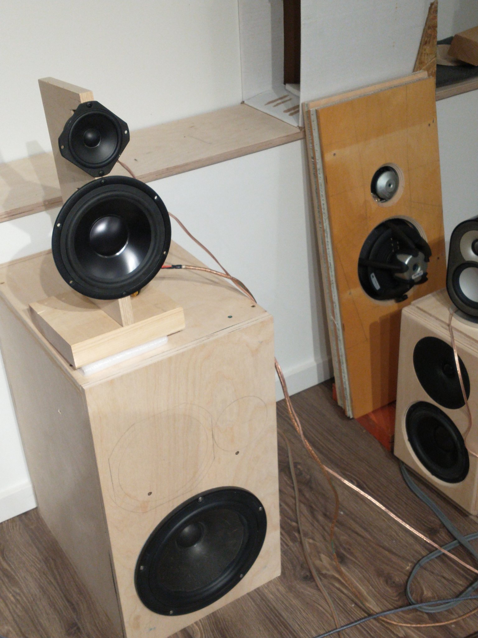

For my first try at the mid/tweeter module, I adopted the no-baffle scheme used in the Vistaton Nobbi open baffle speaker kit. I like the simplicity of the perpendicular brace, though the small flange of the TC9 driver makes it less than perfectly stable with just 2 screws. I will sort this out later if necessary. If dipole cancellation causes too much low end rolloff, I’ll try something closer to the LX521 baffle or larger. https://www.lautsprechershop.de/hifi/nobbi.htm

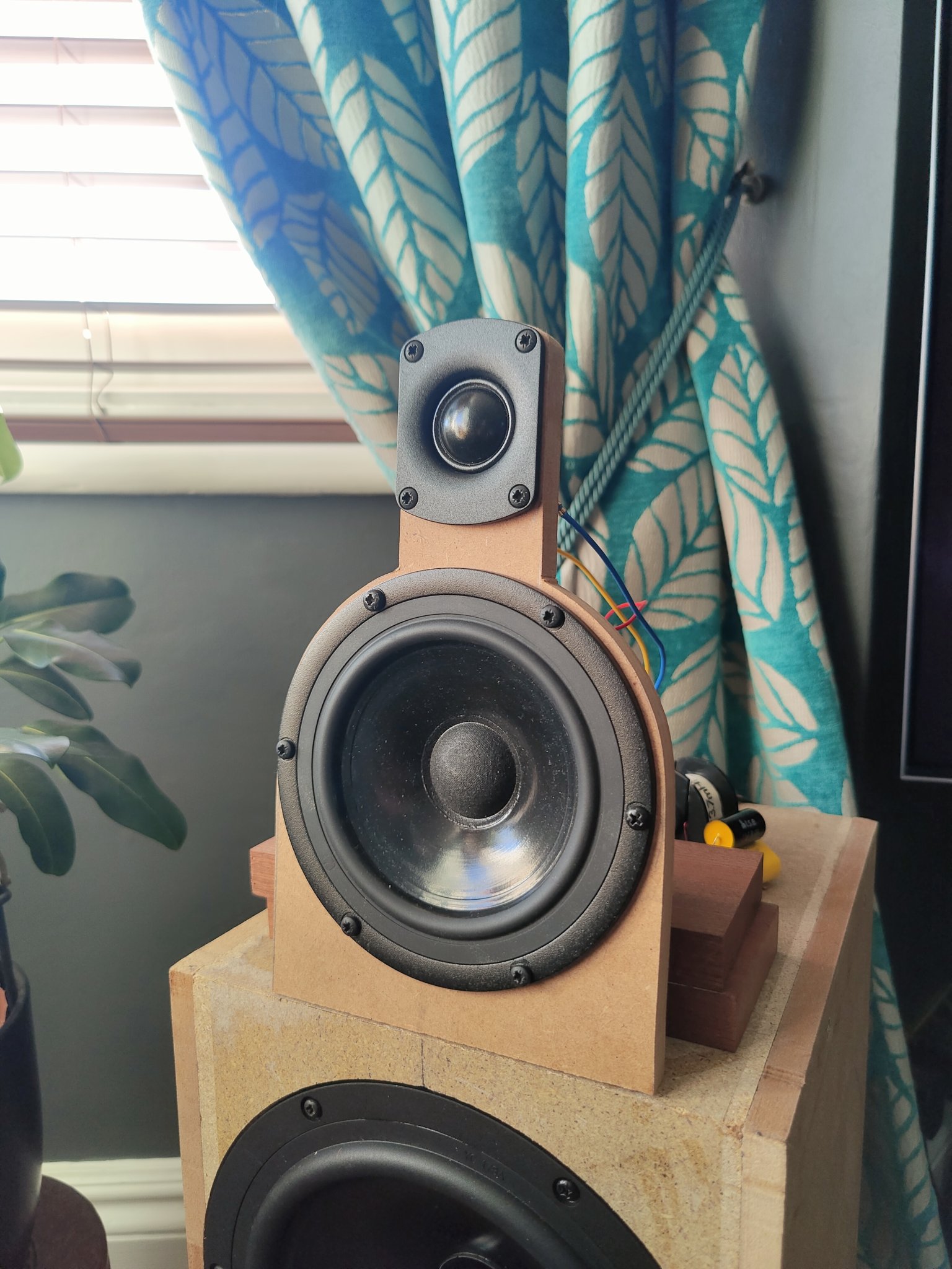

Interesting project and I look forward to the developments. Sounds similar in theory to my recent build. Sealed bass and 'dipole' mid and hi but I probably don't get the figure 8 due to proximity to front and side walls .
No side firer mind you
Ah, I noticed your thread -- https://www.diyaudio.com/community/threads/3-way-sealed-bass-ob-dipole-mid-hi.398072/ -- maybe should have just posted there! The woodwork of your post #24 looks excellent. Kudos!
Your xover also looks like it's coming along nicely. I still haven't broken into XSim or VtuixCAD yet -- need to do it soon.
Using 3 ch of a minidsp 2x4 hd with 1 speaker for crossover trials right now. And a random 2' box + woofer. A couple hours in, with LR4 at 350 Hz, LR2 at 1200 Hz, and a handful of PEQ adjustments, the FR looks decent, sound is not bad. Plenty of bass to below 30 Hz -- it got boosted by 8~10 dB below 50Hz when I moved the box from 2' out to the wall. Haven't turned it sideways yet. Overal tonal balance is OK, tho it needs a lot more work. Have to sit fairly close to tweeter axis for highs >6-8 kHz.

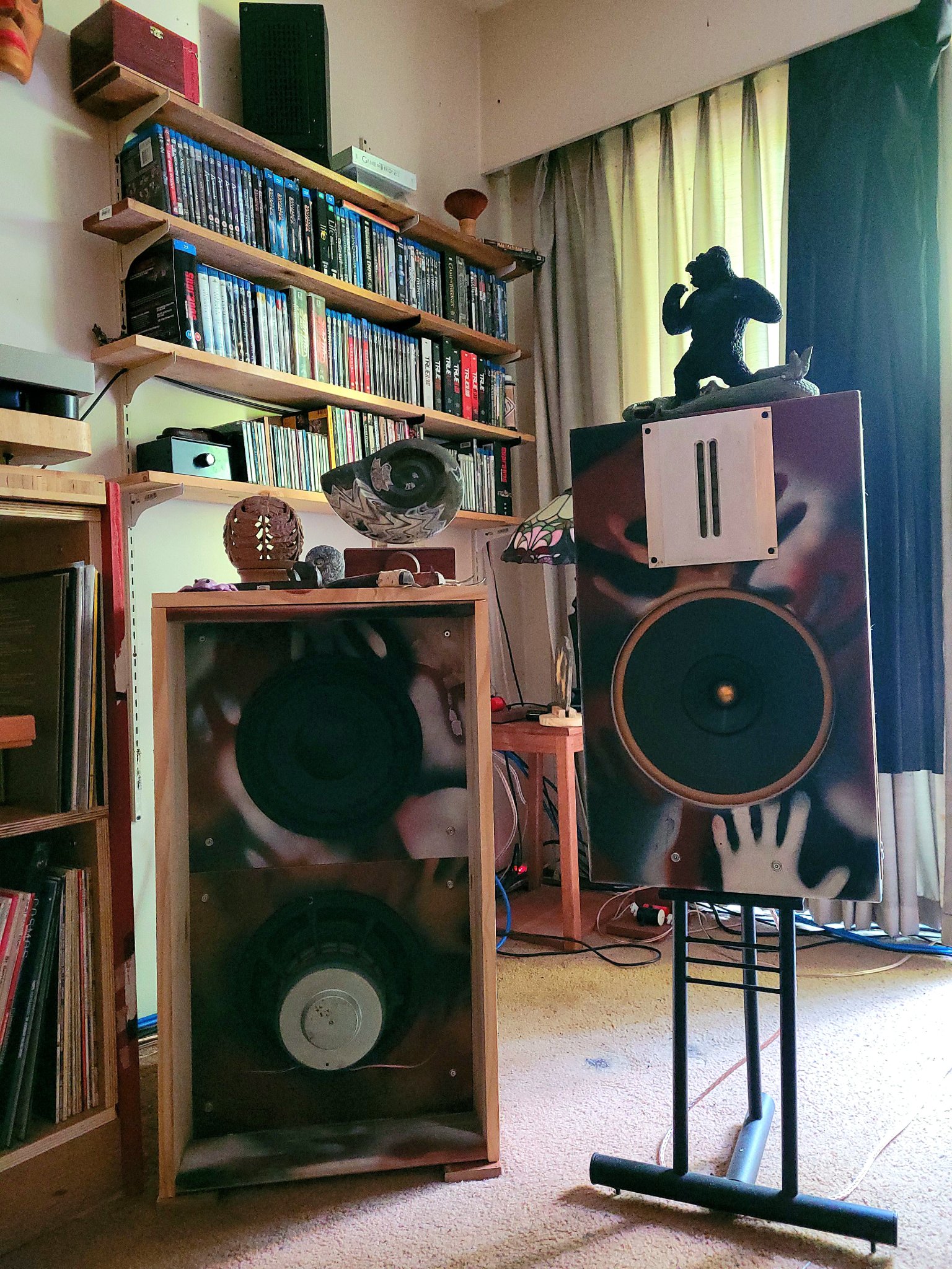

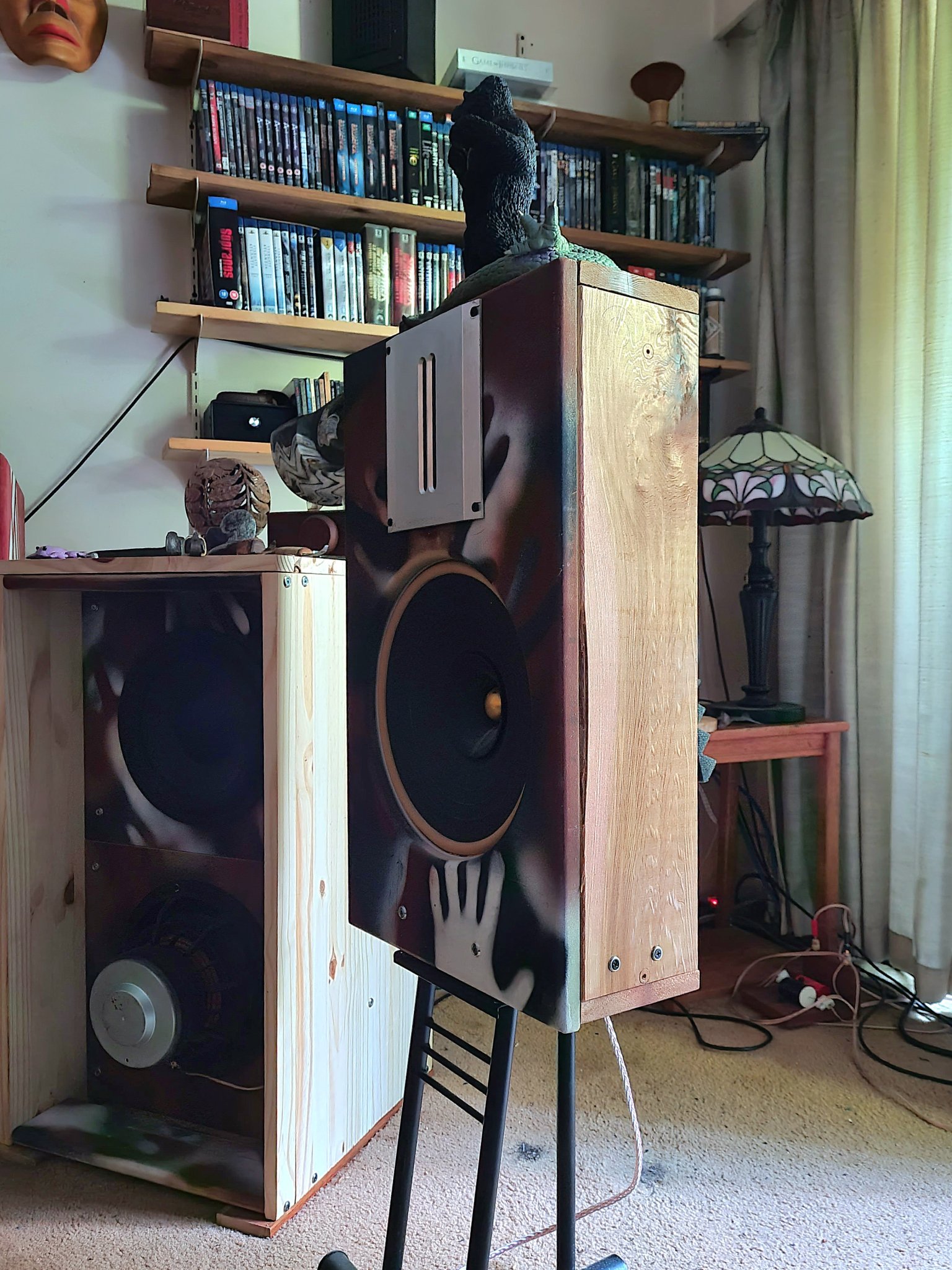

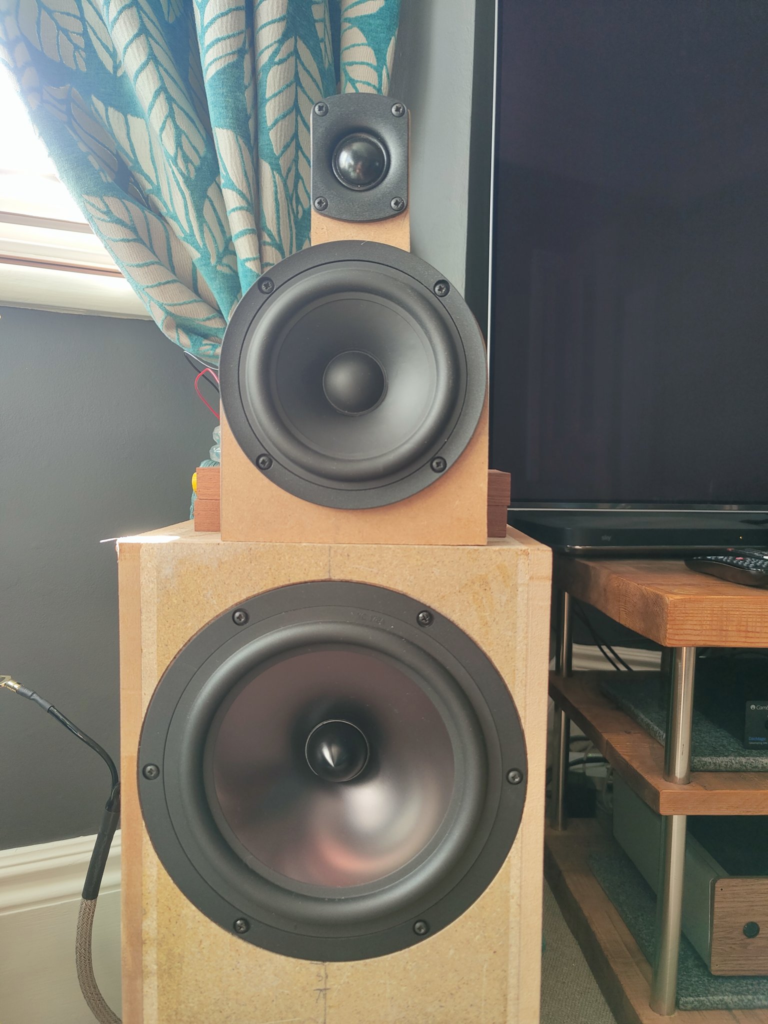

After years of building speakers for other people , I decided on a project to my own tastes. No measurements, I just fine tuned my best guesses for the stereo speakers based on impressions and notes taken about these specific extended range 12 inches.
They started as flush mounted drivers off centred on wingless folded baffles.
But were a little lean in the lower male vocals, so got first a single deep wing on one side, then shallow wings all around, along with being sunk in the front about 3/8ths of an inch.
This got the sound from a smallish baffle acceptable with jazz or classical with a turntable without a sub, ditto for late-night apartment movie sound.
Settled on a simple H Frame push pull sub with an 80 hz crossover point for cinema sound.
Next up was finding the worst breakup point on the cones with a receiver's built in parametric equalizer, and approximating it with sort of a passive crossover, instead of a notch filter.
I settled on a shallow Q crossover point with widely spaced knees, centred about 8500 hz, and used a fairly decent tweeter about 5db less efficient than the main driver.
I do like treble, I just like it in lesser levels than most people. I didn't believe I'd like a rear firing tweeter, but tried a couple different ones anyways, and didn't keep them.
So I keep most of the cohesiveness of a single driver, get cleaner wider dispersion treble, fewer baffle reflections and more front wall reflections for spaciousness, and thanks to my neighbour allowing to do comparisons, more in my room bass with much less through the shared wall in theirs, even with some capable ported speakers at the same 80 db test tone playback.
Best of all, even playing music, with the sub less than a foot from my turntable at pretty exuberant levels, there's no feedback since the cartridge is right in the sub's null.
It took a few near hits and misses to get these this simple and still work to what I'm after.
I didn't think 32" was all that far from the wall. For me it's a compromise between traditional 4 to 6 feet, and 2 or 3 feet as with a lot of speakers, or the home theater a few inches from the wall thing these days. It is pretty far out into the room compared to a lot of Paradigm and similar models I see around postings lately.
