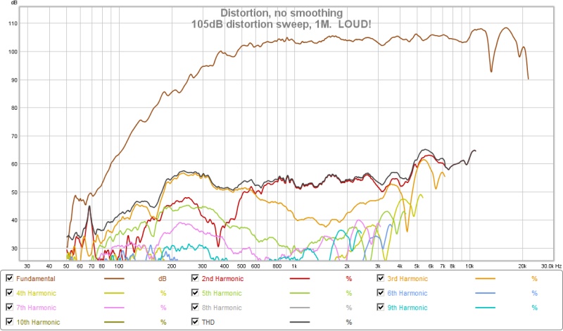

Just tried cranking things up a little..
Now bear in mind this measurement is with a naked horn just sitting on my desk in my study, not mounted, no damping on horn, able to vibrate all over the shop at 1m.
I am hopeful with it mounted in cabinet and with all the epoxy filler/mounting plates/woofers added, distortion will drop further (given your measurements when you added CLD to your trynergy.

The 105dB case HD looks excellent actually. Very nice!
It must sound good - even when this loud with -50dB HD, it is clean and may actually not sound as loud as you think. Given this plot and if you think you can bring it down further with construction details that will be an amazing improvement as it is quite low already. I do not think there is a compression driver with -50dB HD over same range at 105dB.
Please tell us qualitatively what it sound like when playing music ?

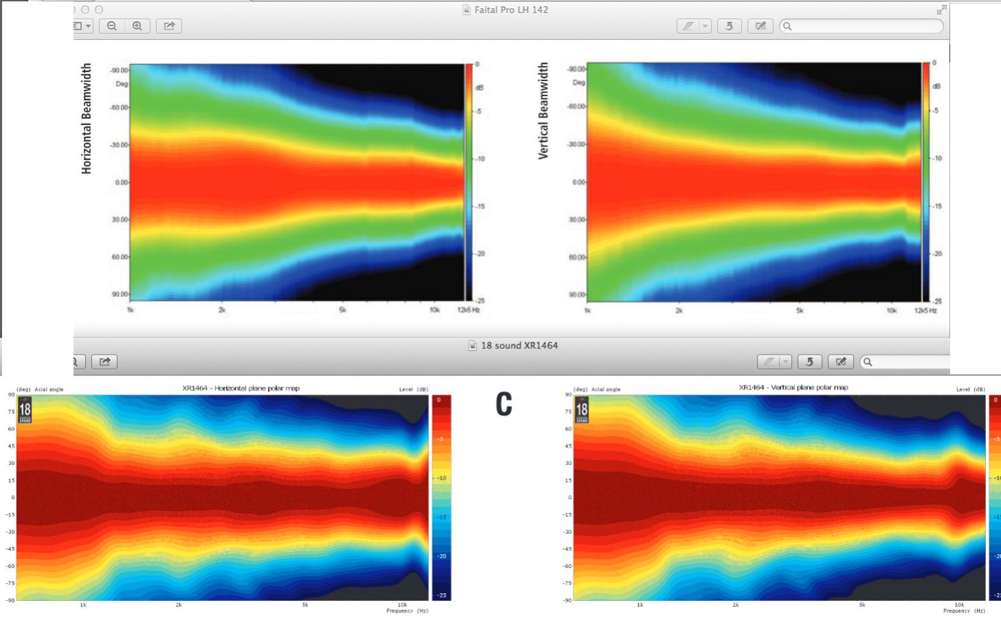

I'm really considering this waveguide as an alernative to XT1464. What do you guys think of the performance? Similar? The size is about a dead on match. Not sure if mounting the woofers will be easier or more difficult but there at least appears to be no ribs in place to get in the way. One big reason for me is that it is stock item at PE for $59.
https://www.parts-express.com/pedocs/specs/294-1042-faitalpro-lth142-4-bolt-specifications.pdf
Here is response with HF146 comp driver:
The measured beamwidth looks pretty smooth:
Closeup of mounting flange area:
Let me know what you all think or should I just stick with XT1464 bia eBay? About same price really.
I am also looking for an easily obtained and cost effective WG similar to the 18Sound you have chosen.
What do you think of the Faital Pro LTH142 60x50 deg tractrix elliptical? It is about the same physical envelope as the 18Sound.
xrk971,
Assuming Bushmeister is using the 18 Sound XR1464, the Faital Pro LH142 polars looks pretty similar, perhaps a tad smoother (though it also looks like more "smoothing" may have been applied), but the vertical pattern flip starts at a slightly higher frequency due to the smaller vertical dimension, dispersion has gone from around 50 degrees at 5kHz to 120 at 1kHz.
Although the "bookshelf" goal is understandable, going with a larger horn capable of vertical pattern control to 500 Hz (or at least 1000 Hz) would be preferable for reducing floor and ceiling reflections.

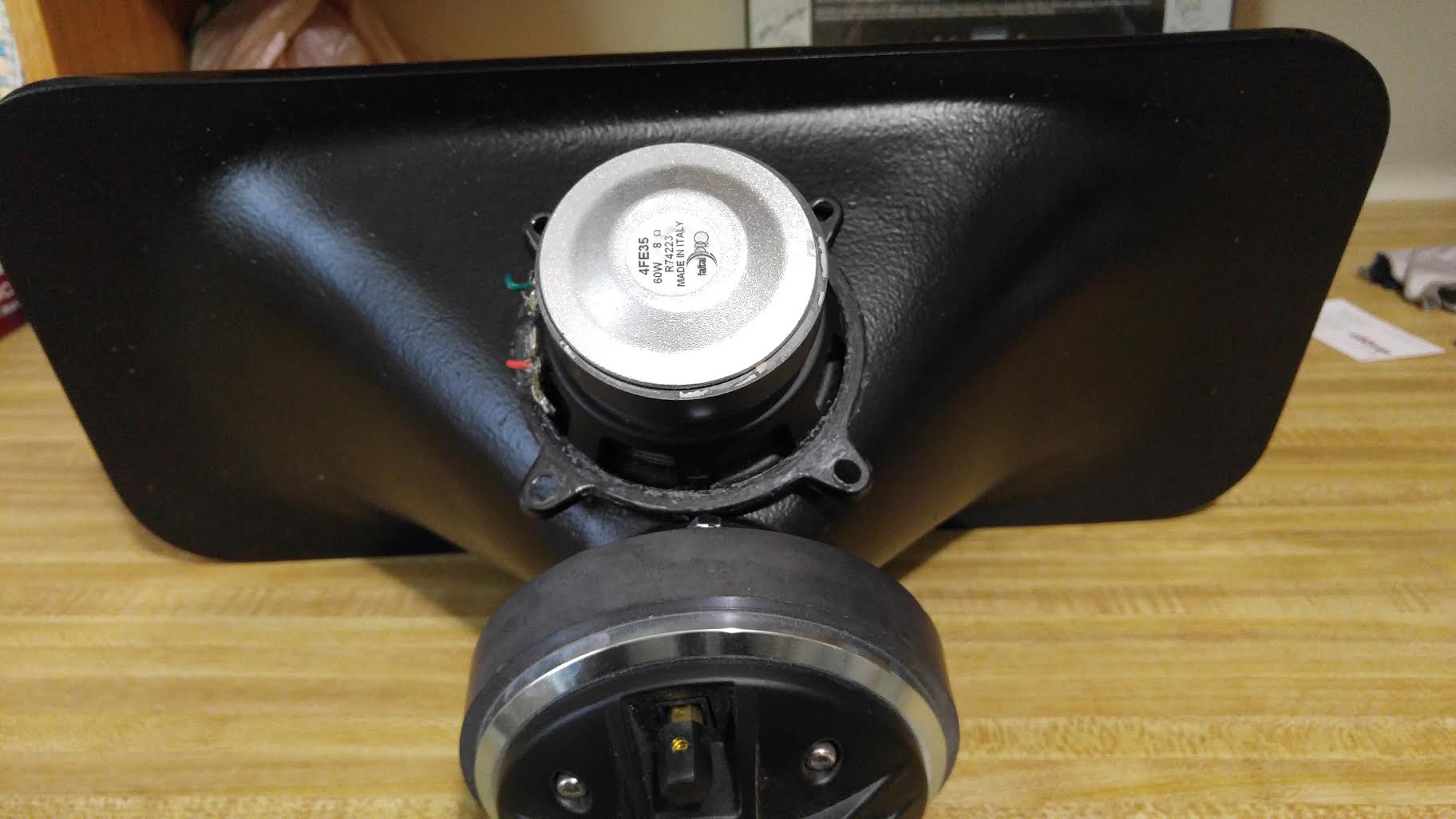

You guys have got me thinking about synergizing the SEOS18s I've got sitting idle in my closet. Here is a picture of one with a 4FE35 sitting on top of it and a DNA360 CD on back. Its pretty easy to visualize 4 of the 4FE35's on the WG, two on top side by side and two on bottom firing into the rounded corners. I know from other work I've done that these mids will be good from about 1200 Hz down to 300 Hz in 2 PI space and 200 Hz in 1 PI space, hitting >=120 db SPL. Team them with separate 15" or 18" woofers on top and bottom for vertical pattern control and you've got, not a bookshelf synergy but a bookcase sized synergy🙂

I wonder if the whole smooth throat and damping pad trick that Bushmeister did with the SB65 and a 1.4in throat can work on a 3.5in driver and a 2in throat?
Interesting idea to use a larger SEOS 18. It only has a 1in throat so not sure of a 2.5in driver like SB65 can be used - but maybe a 1in or 1.5in full range cone driver might work.

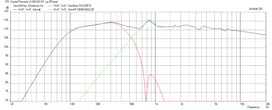

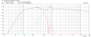

RS225P-8 is another woofer possibility
The RS225P-8 (paper cone) has a nice high sensitivity and low distortion motor and alloy basket. Price is reasonable and the sims show that the thermal limit will put out about 112dB (at 24v) with an f3 of 100Hz. This is very workable and may be an alternative over the SB23NSRXS45's which cost substantially more here in the US. Sensitivity is about 94dB at 2.83v.
https://www.parts-express.com/pedocs/specs/295-367--rs225p-8-spec-sheet.pdf
Thermal limited SPL (cone displacement is only 4.5mm of 7mm xmax):
525519d1452984218-bookshelf-multi-way-point-source-horn-xbush01-rs225p-8-max-spl-thermal.png

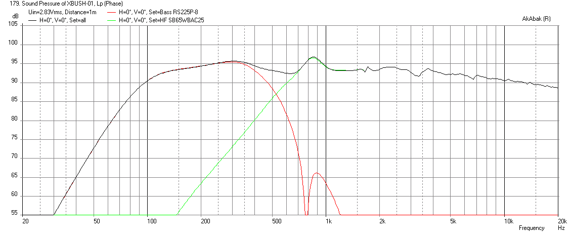

Sensitivity at 2.83v:
525520d1452984218-bookshelf-multi-way-point-source-horn-xbush01-rs225p-8-max-spl-2.83v.png

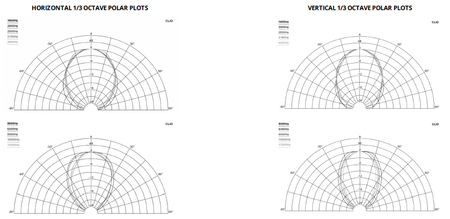

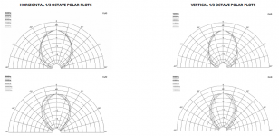

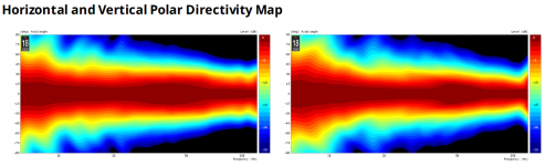

This is before Bushmeister fixed the cancellation dip, the polars appear to track the advertised performance of the XT1464 waveguide:
I don't think the cone driver makes it "beam" any more than the compression driver as the directivity is really a function of the WG profile.
http://www.eighteensound.com/Portals/0/PDFs/XT1464.PDF

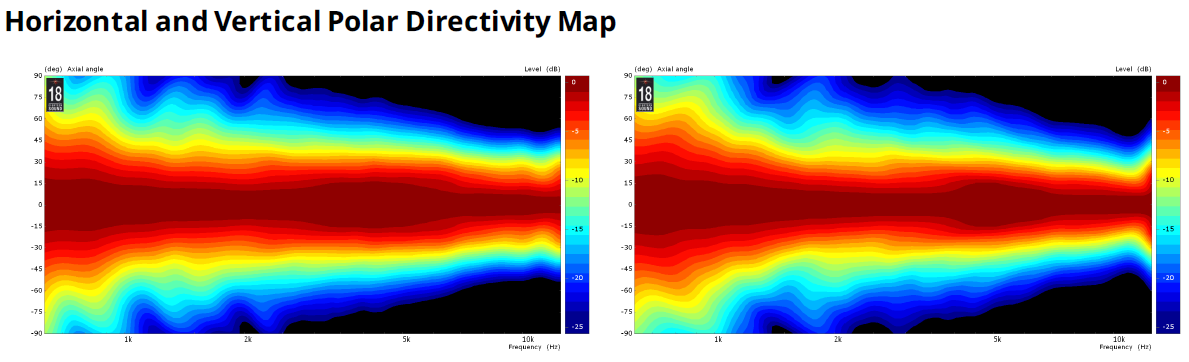

Here are the extracted polar plots and directivity map from the pdf above:
