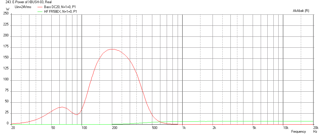

DC200-8 woofers and FR58EX mid/tweeter

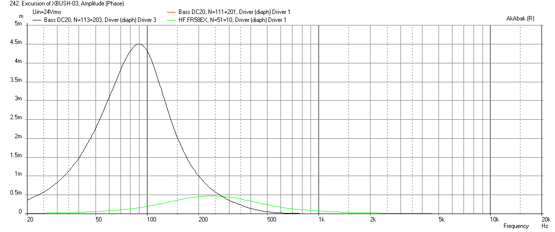

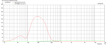

While waiting for my Faital Pro WG and DC200-8 woofers to arrive, I decided to model the system with the Fountek FR58EX driver. This driver has some really nice TS parameters for horn loading. A stronger lower Qts motor than the SB56WBAC25-4, and 2.9mm of xmax (although we will see that only 0.5mm of displacement is needed to match up with the DC200-8), leaving a lot of headroom to EQ the circa 12dB high shelf to flatten the top power response. I had to move the XO point to 570Hz to get a better integration. It will depend on how the WG loads the driver. As I will be using the Faital Pro LTH142 which is a tractrix, so it may achieve lower frequency horn loading.
The DC200-8's are not as sensitive as the SB23's but the price is right 🙂. I am able to achieve about a 91.6dB sensitivity at 2.83v at 1m for the system with an f2 of 91Hz. Maximum SPL is 110dB if excursion limited - and this is a little bit over the max rms thermal limit but not max crest limit.

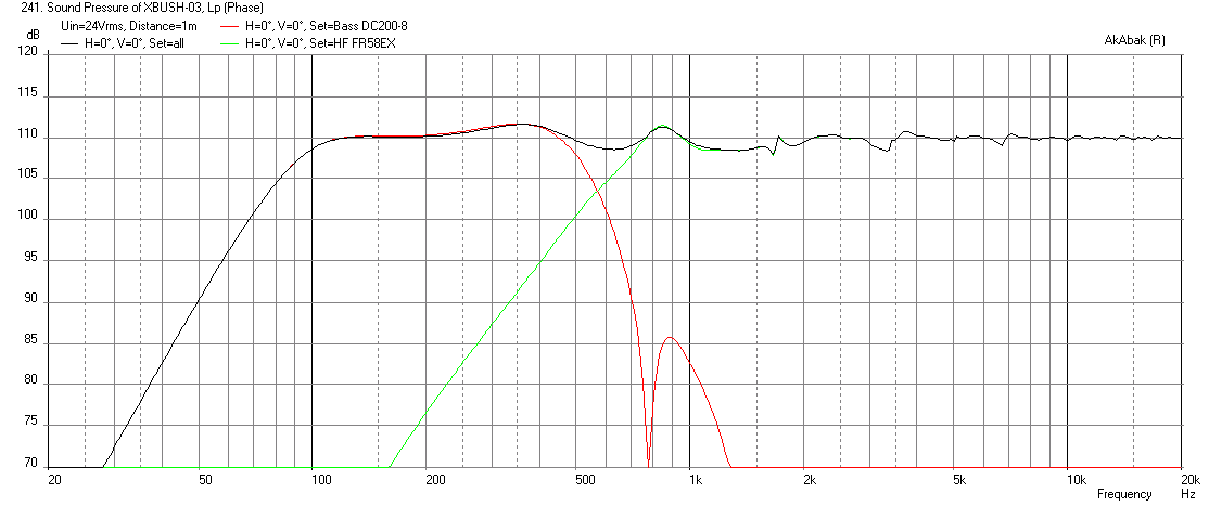

Here is the predicted SPL at xmax for the woofers:
Here is the corresponding cone excursion, note that the FR58EX is only going to 0.5mm which will really keep the HD low as xmax is nearly 3mm:
Here is the corresponding electrical input at max SPL, note only 7w is being used for FR58EX, leaving headroom for boost EQ to flatten HF response:

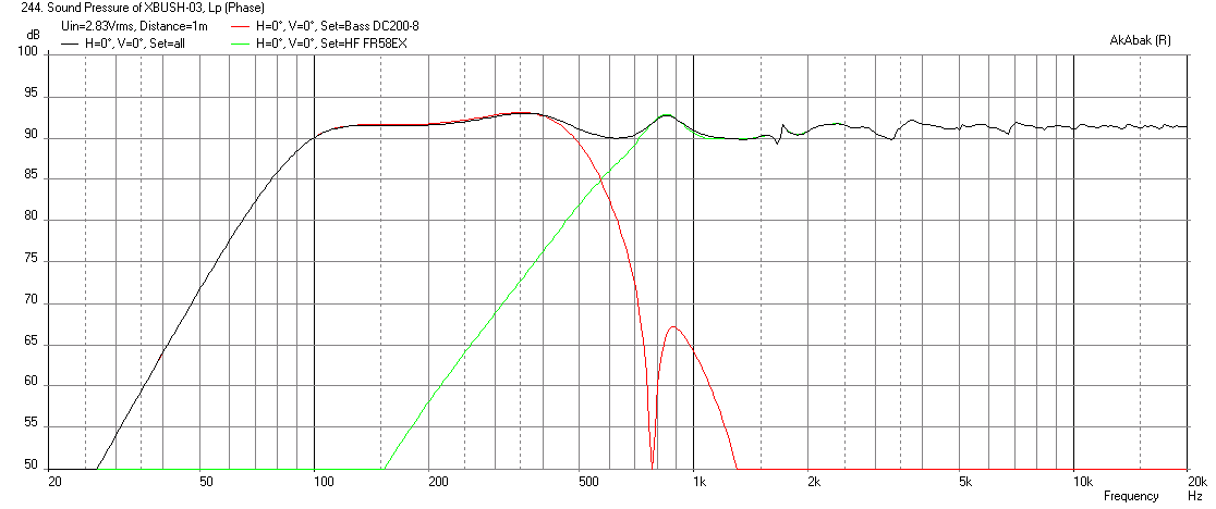

Here is the sensitivity at 2.83v and 1m, about 91.6dB:
Clearly, the performance is not as high as the SB23 and SB65 combo, but the woofers are about $50 a pair vs $180/pair for the SB23's.

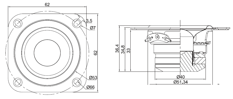

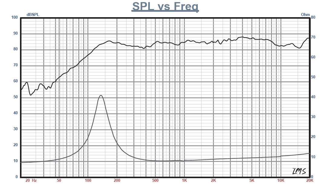

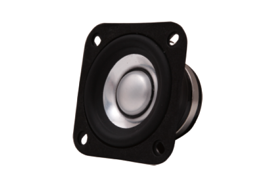

The shape of the FR58EX bezel is already designed for backside mounting as it has a foam gasket on the bezel face, and the bezel is very low profile. I think a very low volume adapter plate with nice radiused edges can be made to transition the FR58EX surround to the WG throat.

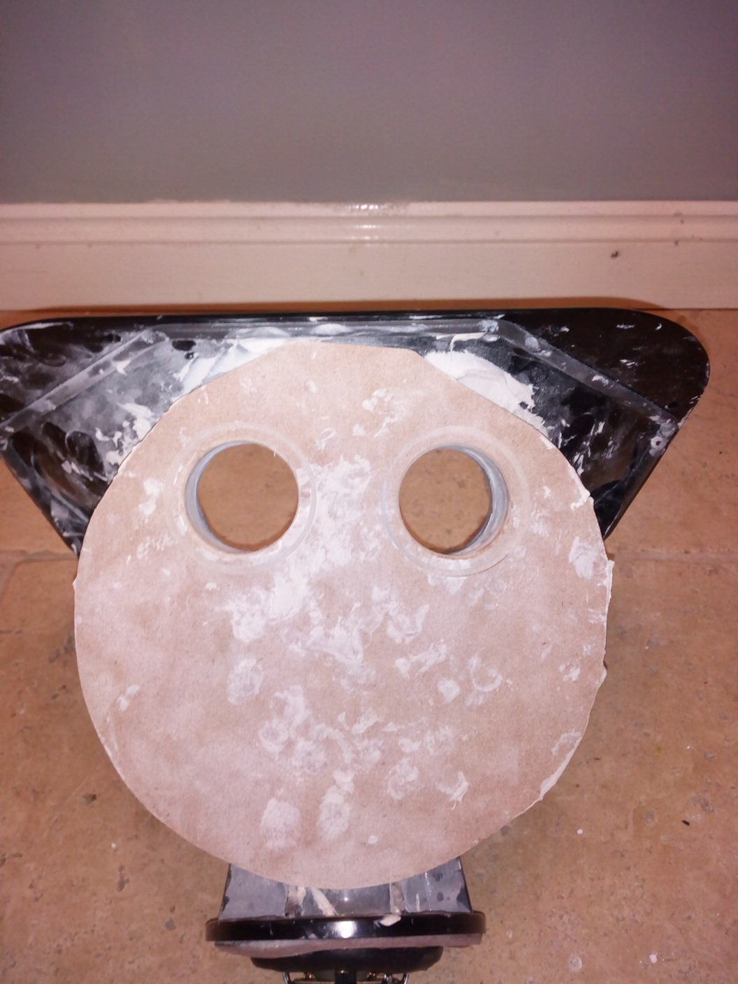

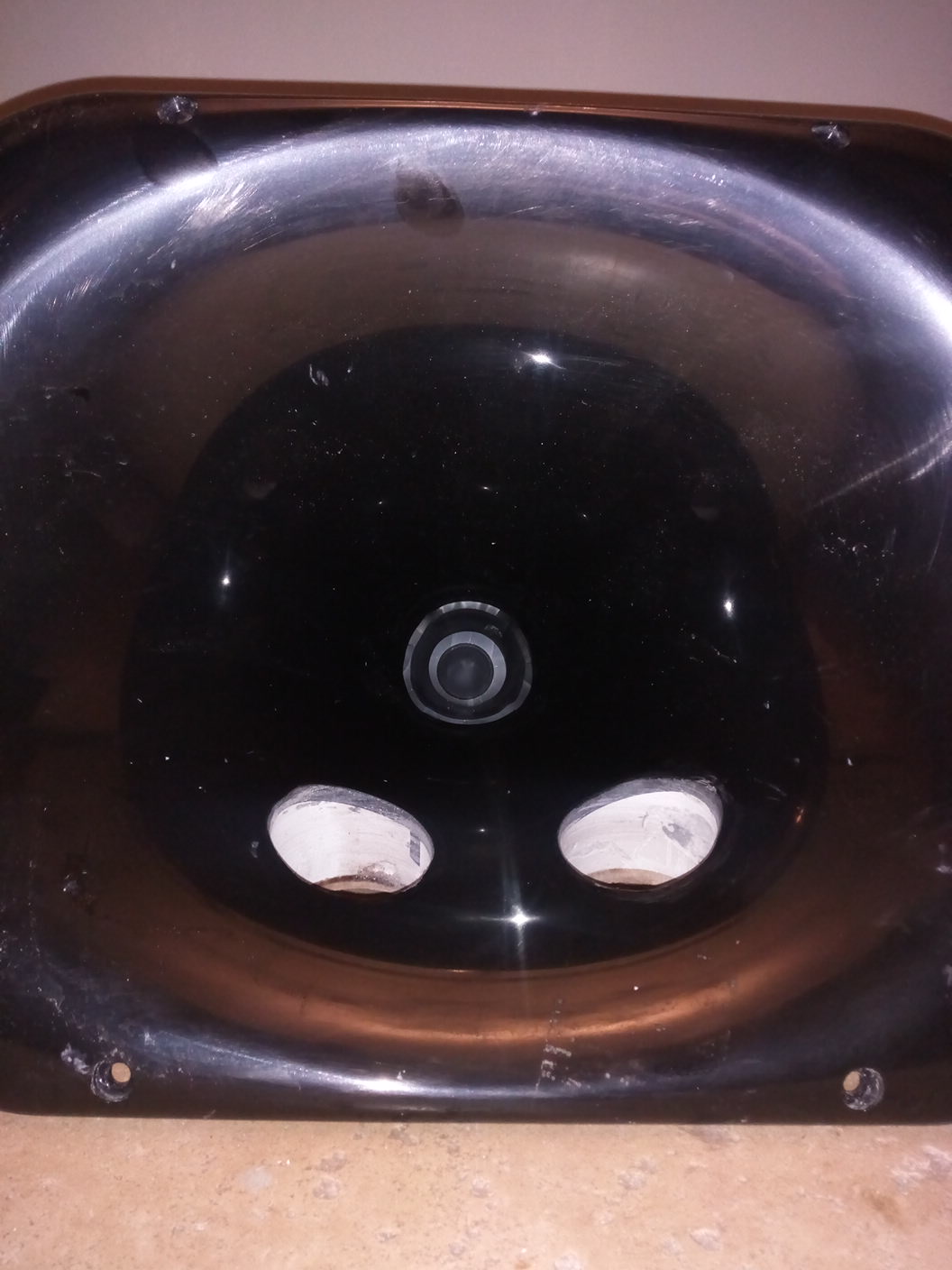

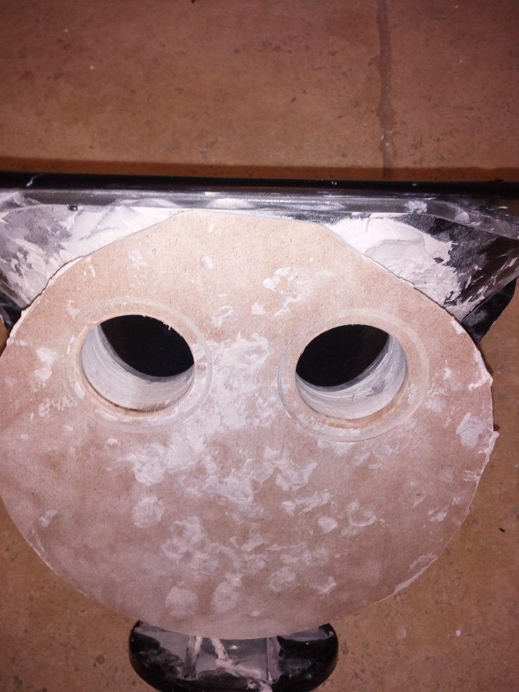

Progress is being made. These are some of the very messy mid production shots.....😛
As you can see there is a very deep layer of structural epoxy building up the horn to a flat mounting surface. A disc of MDF is then glued to this and then using a hole saw two 6cm diameter ports have been cut.

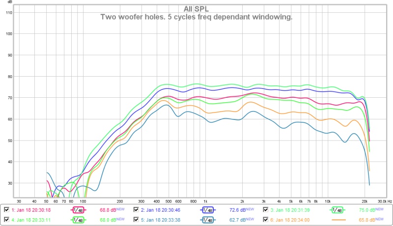

I need to route out the holes to provide better flow, but couldn't help taking some measurements as it is, just to see how it affected the power response - I was really worried it would screw it up.....
Yay! You're well on your way! Very good results so far! I can imagine the suspense you felt getting that measurement done.
What do you mean by "route out the holes"? I was going to suggest "frustrum"ize some way as discussed in the patent. At the very least go around the holes with a V-bit to widen them out on the side towards the driver Is that what you are thinking?
Yep - I was dreading it all turning to the brown stuff!!

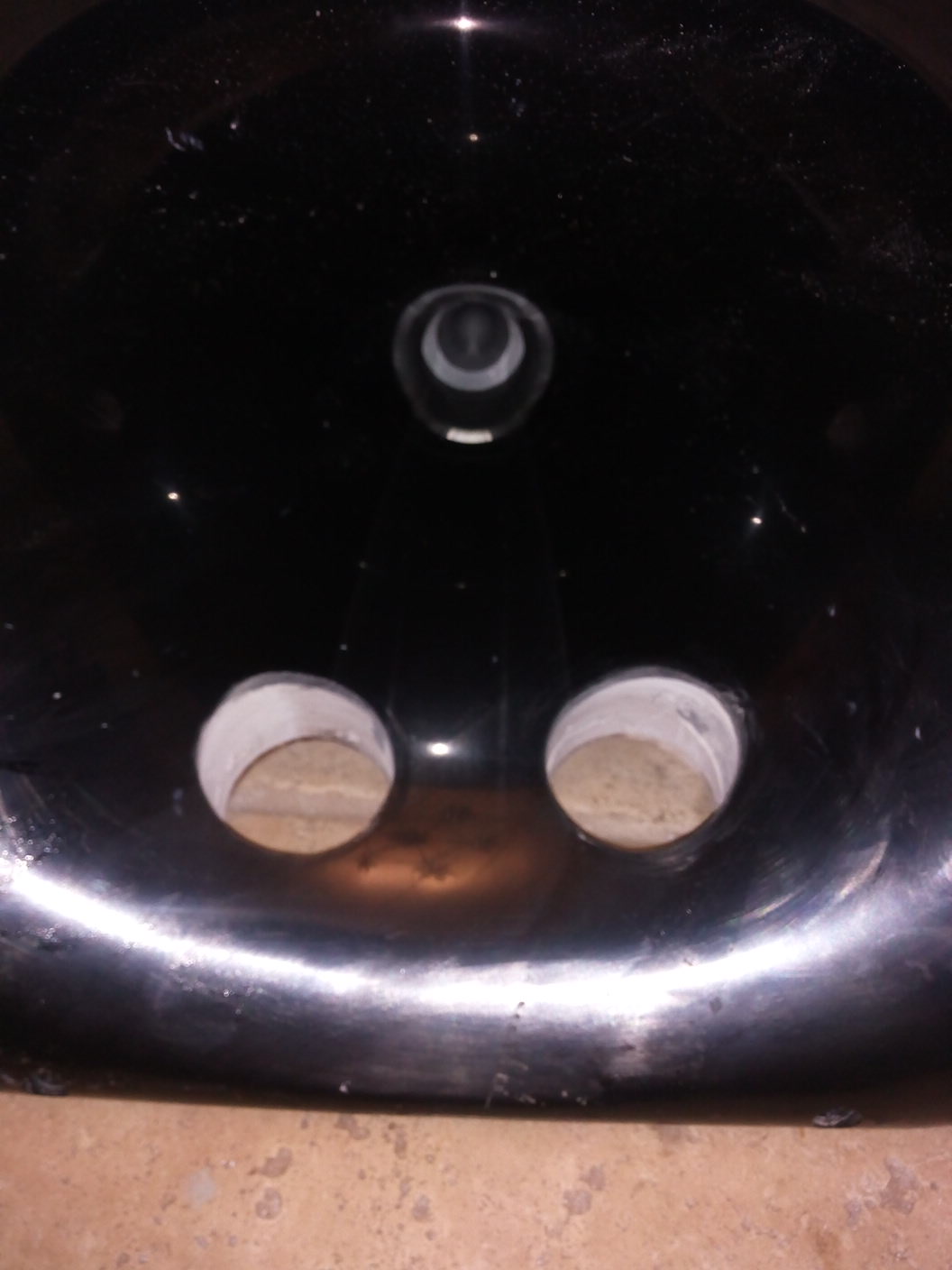

nc535 - that is exactly what I am doing! each hole from the MDF side will look like a funnel down to the circular tap into the horn.
I have just used a 5cm wide v-bit, then I will use a file to gently taper them down in a smooth curve.
Then I have to do the same work on the other side of the horn (two woofers per horn). Then sand and polish around the taps to make everything shine. Then paint the MDF and epoxy a nice mat black. Then mount the woofers.....
Then the fun begins! 😀
However, I wasn't going to embark on all that without checking to make sure cutting those holes out didn't totally screw up the horns freq response.
Hence the measurements whilst they look so rough and ready!
Great progress! So was there a substantial difference with/without the holes? Looks like not.
I think this data looks solid:
You are very close now.
Regarding frustrums - that will increase the front chamber volume - which may decrease the upper bandwidth notch location. I would first put a round over on those 5cm holes and mount the drivers and measure the bass response. The model with a 30mm duct from woofer to horn wall seems to work fine. So not sure if all that manual labor of making a big funnel is worth it - especially if it messes up the response. You can always widen the funnel later if it does not work with a simple hole and and roundover.

Actually I think the freq response has possibly improved with the woofer taps added - I can only guess this is to do with the act of removing the SB65, and remounting it. Or perhaps the addition of 1kg of structural epoxy....
Anyway these things are going to end up being really solid. Each horn will need 2-3kg of epoxy. Then the MDF mounting plate, then the surround ring, then the woofers....
I don't think I will need to worry too much about damping.
As soon as I have both woofers mounted I will start taking some measurements and report back....😀

Makes sense, though I sort of expected a routered groove in the current MDF piece for the surround to fit into, to keep/get the chamber volume under the cone as small as possible. Is this MDF piece the part that sits in the cone perhaps?
As is I couldn't understand the fixation of that MDF piece to the horn before routing that groove 🙂. Looking forward to following this journey.
