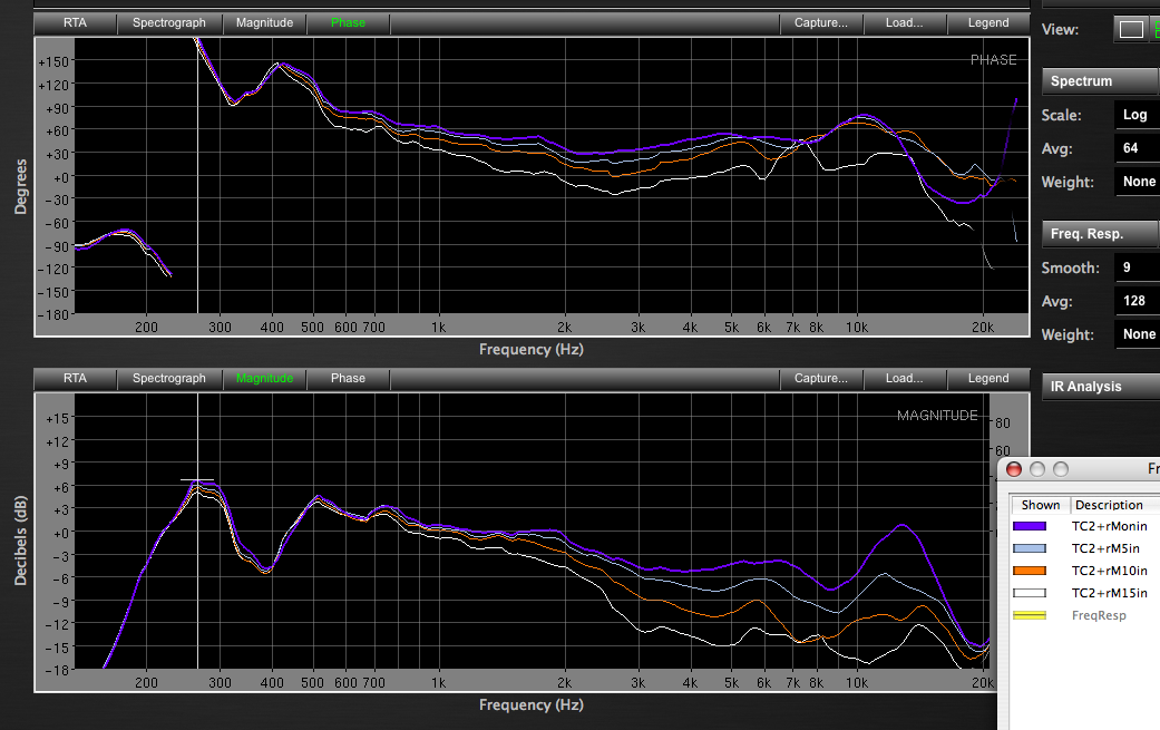

Got the TC9 3.5" smooth by expanding the 2" throat to 2.5".
Surprisingly, a 1/2" radius rounding of the throat entrance made virtually no difference, the charts are almost identical with or without.
Chart below is indoors, I think the dip around 390 Hz is an exaggerated room artifact, will do comparisons outdoors another day.
Lost a bit of the 500-2kHz sensitivity, but the Maltese is actually smooth enough now to use without EQ, with EQ should cover the decade from 200 to 20kHz. "0 dB" on the chart is around 94 dB sensitivity one watt one meter, a quad (40 x40 dispersion) will be 100dB, will do 120dB+ at rated power, 130+ if you keep an eye on the program material 😉 .
A damping circle on axis behind the grill cloth will smooth the 12.5kHz peak, though for my intended use (center fill for live music) will probably just EQ it down a bit, want all the sensitivity available.

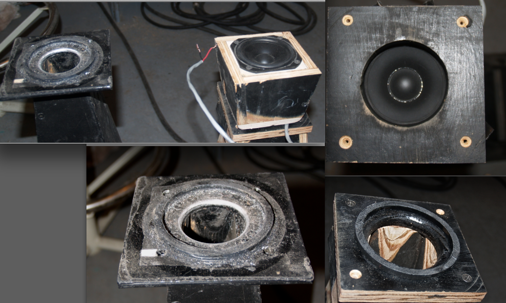

Nice work! Did you end up using a foam or felt damping ring as Bushmeister suggested? Was the main difference getting the throat enlarged? So it seems that driver cone dia and horn throat dia are a critical value to match up as Bushmeister suggested earlier that the surround needs to be out of view of the throat so that the cone proper just fills the throat when viewed end-on.
Do you have some photos of the throat and driver spacer and damping?

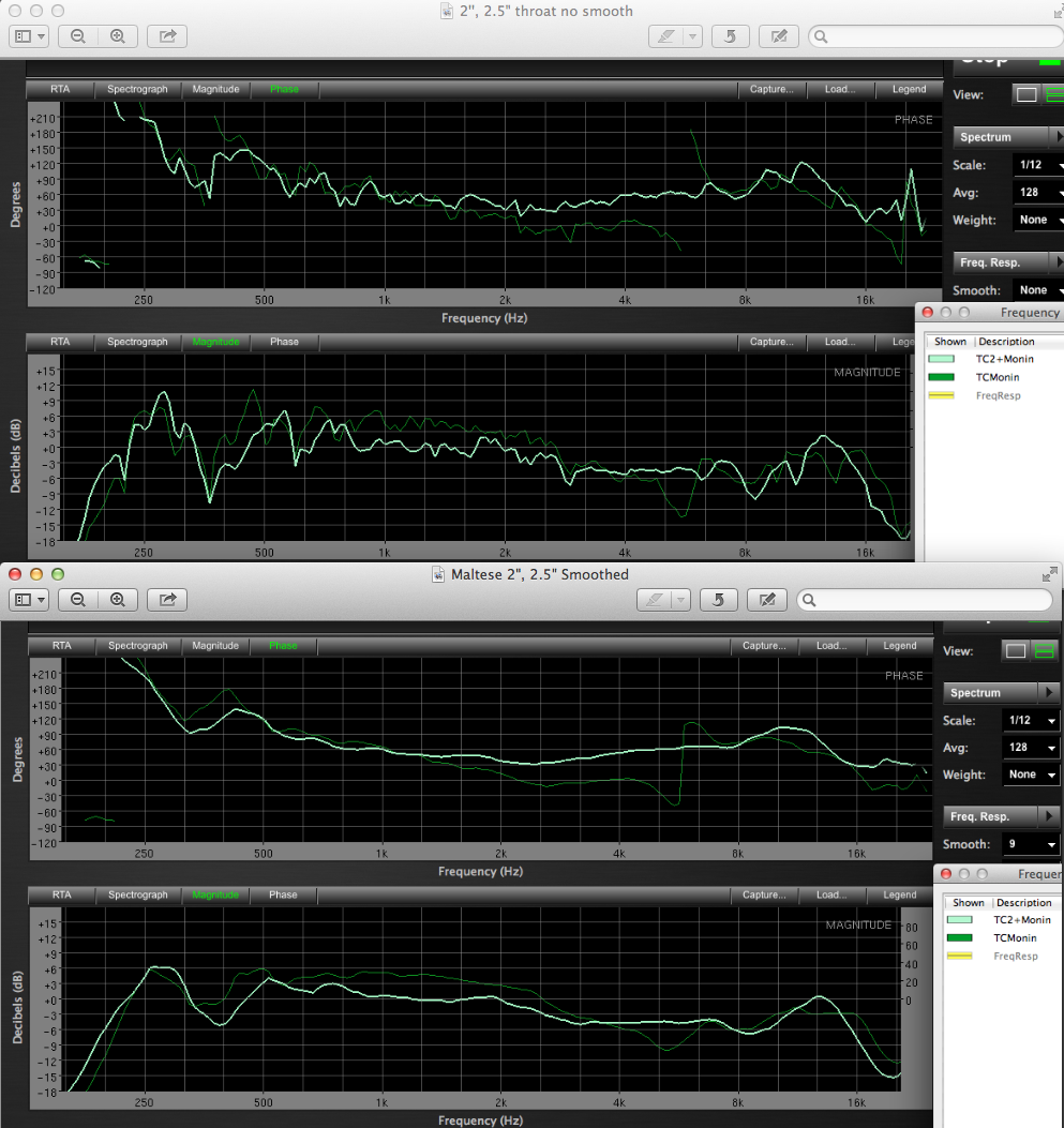

1)No, I cut the horn length down to the point where the entrance was 2.5" instead of 2". As posted in #249, the felt ring in the 2" throat made the 5.9kHz notch much worse, and expanding the throat to 2.5" (the diameter of the TC9 cone) would leave hardly any room for a felt ring. A 1/2" radius on the driver side of the throat actually made the response just a tiny bit rougher.
2) Yes. The unfortunate consequence is the larger throat looses horn loading, dropping sensitivity by as much as 5 dB below 4kHz and exposes other peaks and dips caused by the wider beaming "piston" exposed. The resultant 8.2 kHz dip is nearly as deep as the 5.9 kHz dip, so probably won't be cutting any more horns down, which will save a lot of work on this project using 8 horns configured as four two-cell units, normally arrayed as a 45x45 quad-cell either side of stage.

3)The photos below show the throat 2" and 2.5" throat comparison, and the horns side by side. The 2.5" throat horn has a shorter secondary expansion (termite problem...) which may have contributed to some of the gain loss, will make the horn the same length and re-test, though I don't think it will make much difference.

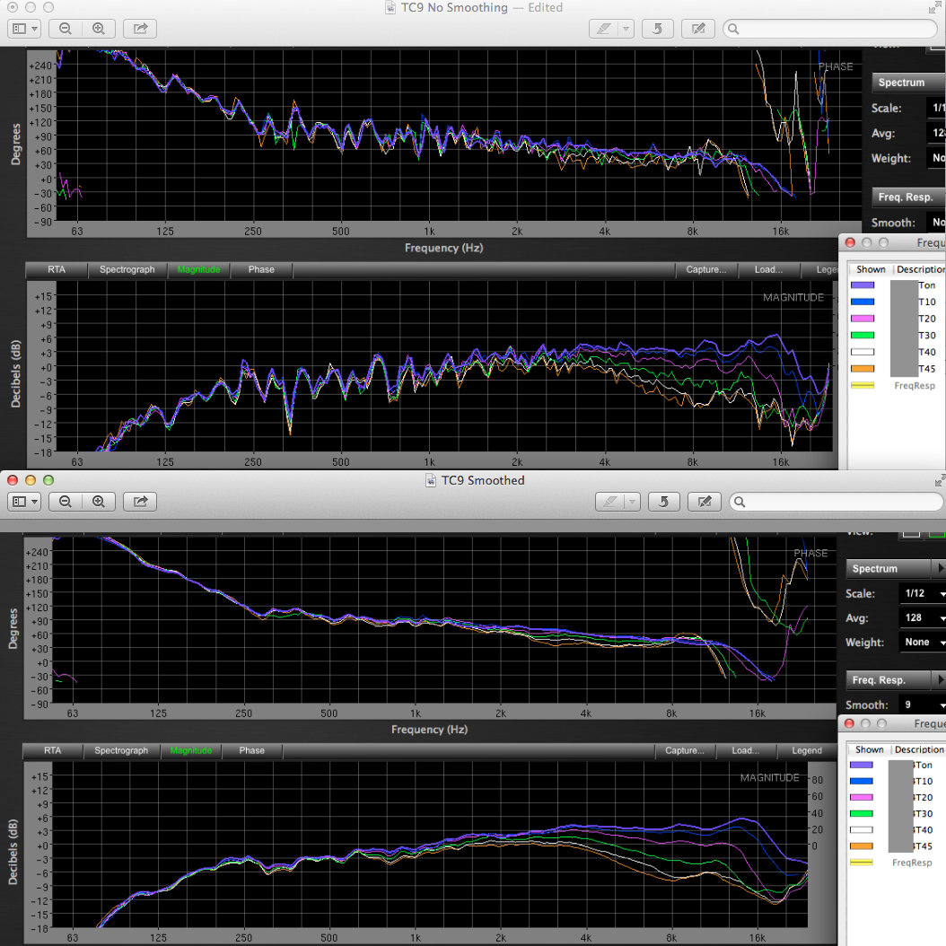

It is interesting that the TC9 loaded Maltese horn actually has smoother response than the driver as a front loaded unit.

Weltersys,
Those horns really did get cut down to achieve the matching throat! Ouch! Can you explain the differences in the plots? What are we looking at? Are the smoother lower graphs the cut down ones with a rounded throat?
Also, I don't know what you mean by this:
Isn't the TC9 a front loaded driver in the Maltese?
