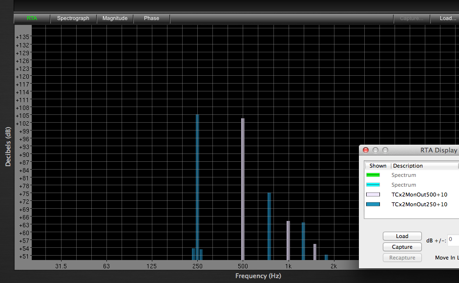

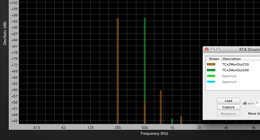

What were the HD levels you were getting in your Maltese with the TC9FD? Say reference to 95dB or 105dB at 1m?
A pair of Maltese outdoors at two meters high, two meters distance, (basically free space) produces 94.3 dB at 250 Hz, 94.4 dB at 500 Hz with 2.83 volts (nominal 2 watts per driver).
That is equivalent to 97.3 dB one watt one meter, distortion is -34.9 at 250 Hz, about 1.78%, and -48.5 at 500 Hz, less than .5%.
Raising input by 10 dB (20 watts per driver) raises distortion to around 3.16% at 250 Hz and a bit less than 1% at 500 Hz at the equivalent of 108 dB at one meter.
Extrapolating, at 160 watts driving four units (40 watts per driver), the peak output should be around 117 dB at 250Hz with about 6.5% distortion. Distortion at 117dB should be only about 2% at 500 Hz.
The TC9/Maltese horn ability to cross over at 250 Hz with high SPL makes it possible for an inexpensive 2-way covering 10 decades (20-20kHz) capable of producing the dynamics of the most demanding live music.
But it would require a deep bookshelf 😉.
Art

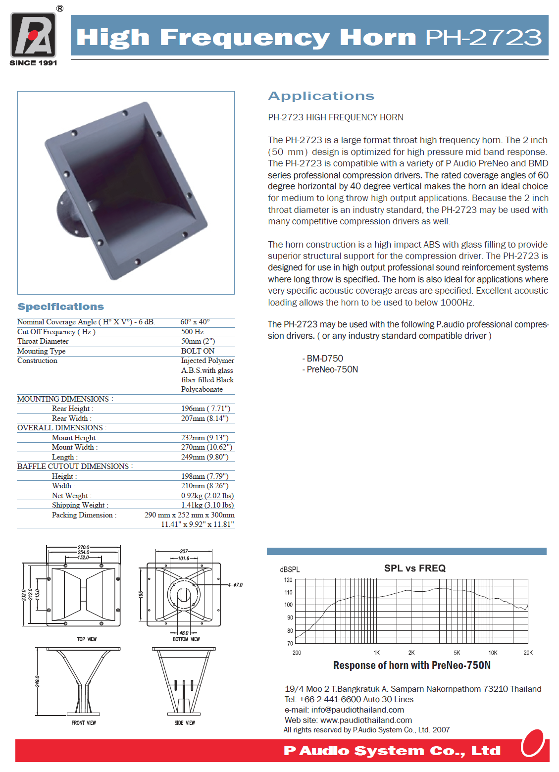

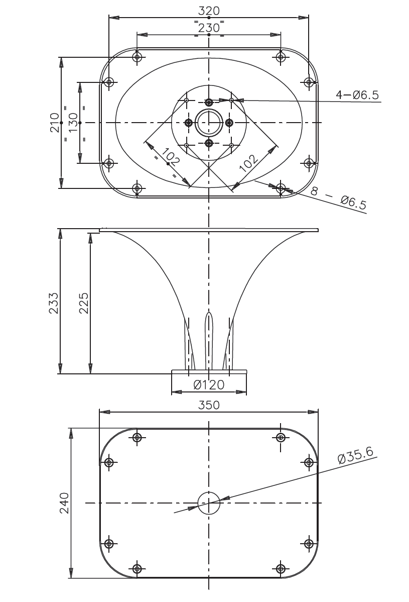

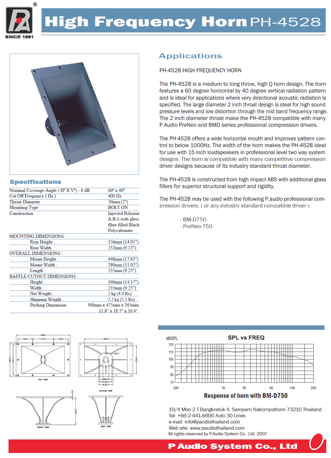

Got the bug too here, just ordered two different horns with 2" entrance that are low cost available in EU area at GB £32 and £25. Idea is first to measure and listen with a 10F and TC9 and after that see if they can be improved with bored up entrance or modified in some way as weltersys did. If it works fair will then order one more horn of the best performer of the two.
If it will improve diffraction with big round over exit think of after mounted on a flat baffle one can on front add a around 4" deep rectangular frame with inner dimensions same as mouth exit dimensions and sand that frame round to have round over exit as the bigger JMLC horns.
As this thread evolve can really see possibilities for great bigger home stereo system as wesayso suggested use one of the bigger JMLC horns so as to get constant diretivity down below 500Hz as also weltersys recommend and then add B&O 90 tech to control lows. They big horns seems available at - Horns by Auto-Tech but they costly.

Nice Byrtt! So we will have 18Sound XT1464, Faital Pro LTH142, and now P Audio PH-27233 PH-4528 and builds going on in this thread! Great to have multiple options to see what works. Art is doing the Maltese but I don't think his will have bass injection - and its not exactly bookshelf anymore 🙂
Wesayso, you are next! Since you are the one who brought up JMLC, you need to do the JMLC-400:
JMLC-400 - Horns by Auto-Tech
Or the wild looking E-JMLC-600:
Another option is the JBL 2386, which can be had for dirt cheap used ($35 in US). Martinsson has shown that this horn works well with a 2in Tang Band in this thread: http://www.diyaudio.com/forums/full-range/205146-2-madness-hornloading-tb-w2-803sm.html
JBL 2386 Horn, $34.99 – CLAIR Used Gear
Specs in JBL 2386: http://www.sound-image.com/wp-content/uploads/JBL_2386.pdf
