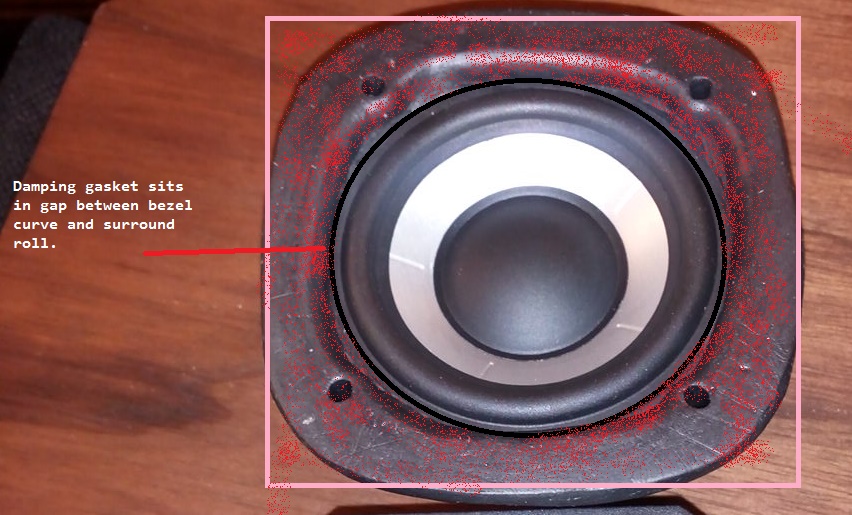

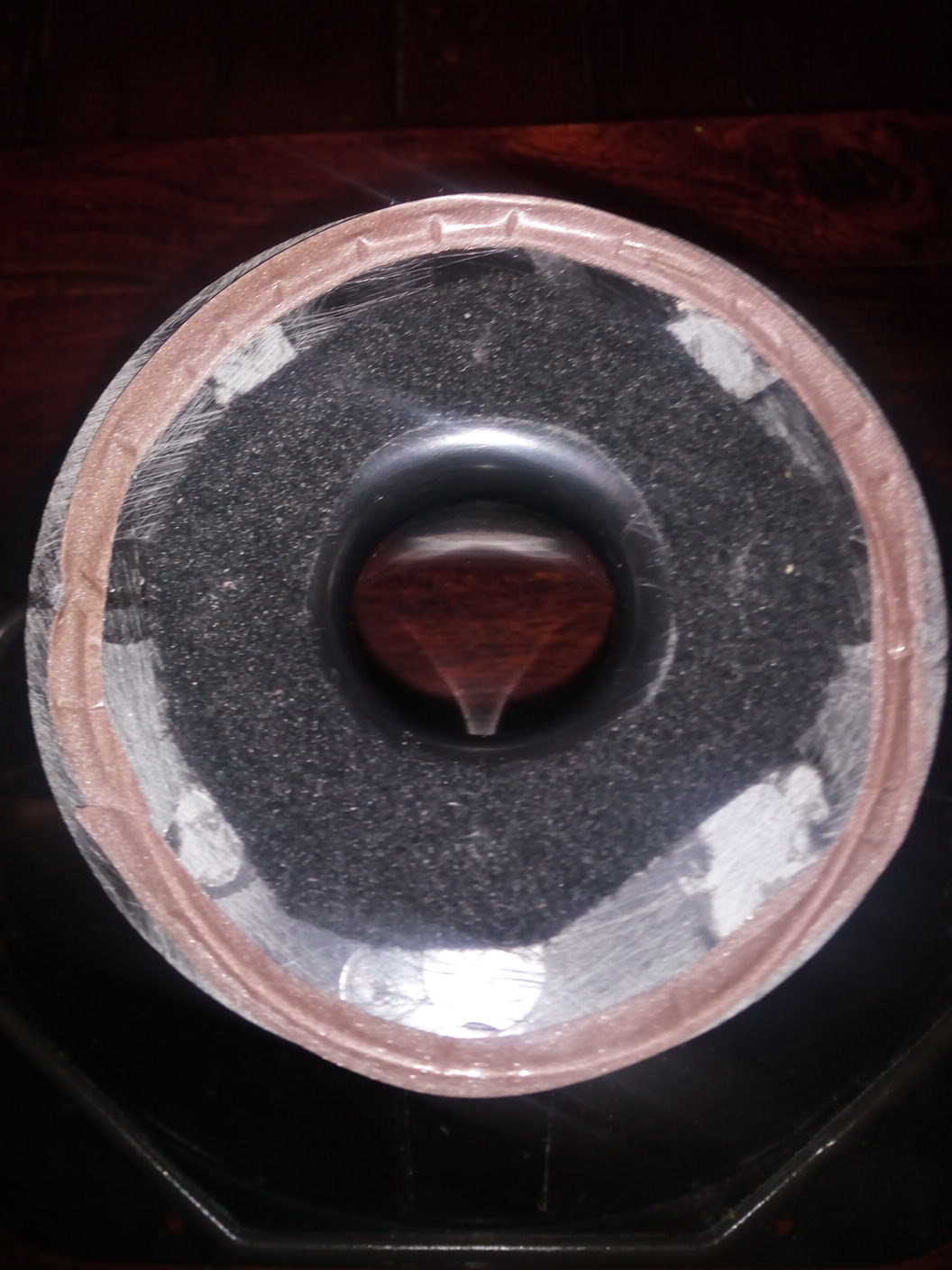

A quick photo of modifications. Doesn't come out well on the pics I am afraid.

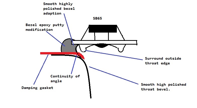

Perhaps an oblique angle shot would help. I see the black open cell foam there - does that foam go just up to the inner lip of the bezel wall that you built-up, or does the driver bezel actually clamp over it? Or perhaps a sketch of the cross sectional view of the different layers where profile of the throat. It does look like you made the throat radius much smoother - would you say 0.25in radius?
The horn flange appears to show a white color from all your sanding? The specs actually says it is a based on foam and plastic covered? Are you getting down to the foam?

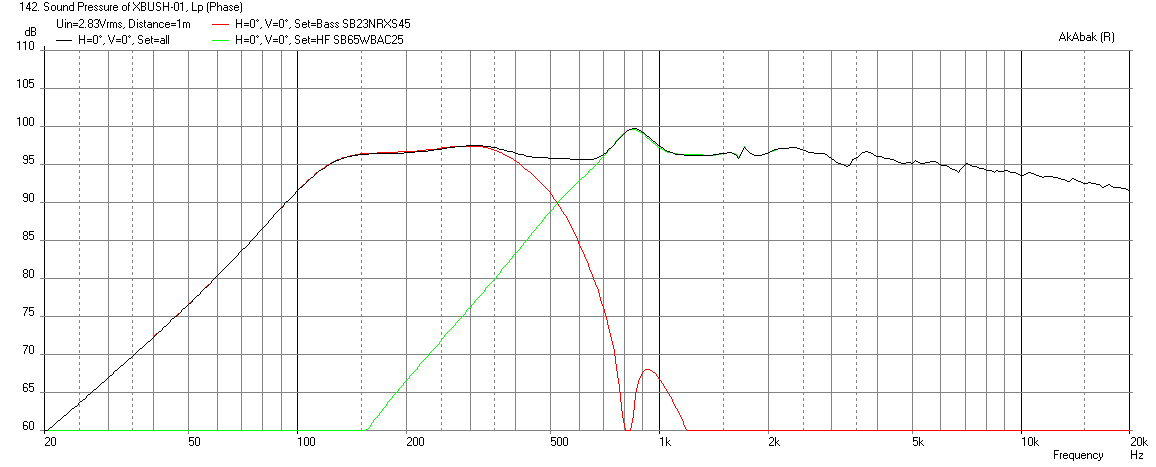

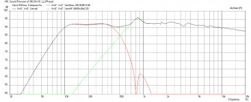

I was looking at other woofer possibilities and the Peerless 830869 8in HDS Nomex is interesting in that it can achieve a higher sensitivity, but still does not did deep like the SB23 - that driver has a unique combination of fs, Qts, and Vas that give it the ability to go to 82Hz in a sealed band pass injection. I am able to go to an f3 of 110Hz with the 830869 but sensitivity is up to 96.5dB.
Here is predicted sensitivity at 2.83v (uses 5.5 liter rear chamber per driver) - I know, plot still shows SB23 - did not have time to change label:
525399d1452937031-bookshelf-multi-way-point-source-horn-xbush1-p830869-2.83v-freq.png

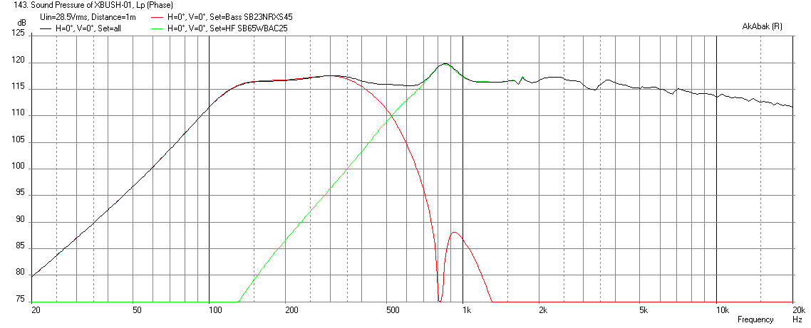

Here is predicted max SPL at xmax (of course thermal limits are violated by by about 2x):
525400d1452937095-bookshelf-multi-way-point-source-horn-xbush1-p830869-28.5v-smax-freq.png
I would say almost 0.5 inch radius on throat. I tried a ring of damping which helped a little so this is an entire gasket which my modified bezel clamps down on. If you look at the close up shots of the bezel I made earlier in the thread, the ring of damping sits in the gap between the surround and bezel curve. Acting like stuffing in a sealed enclosure. It was my guess that if I could damp that space effectively it would eradicate the diffraction dip. I got lucky!

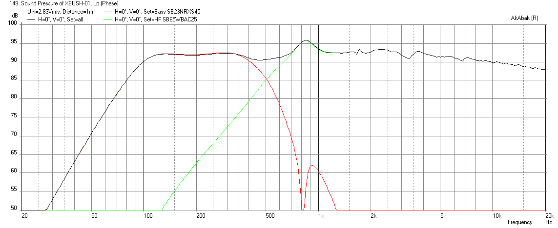

Although a really inexpensive Dayton Classic Series DC200-8, can get a lower f3 of about 94Hz, it has only 92dB sensitivity. But at $25 ea - may actually be a great "budget" alternative for some people.
This is with a 4.5 liter rear chamber so it can actually make for a very compact box if you make the box angled and curved to conform to the horn shape a bit.
How thick is the foam - and is this the same type of open cell grey foam we see used to package electronics and such? Weltersys tried felt damping ring on his horn with a TC9FD and it made it worse.

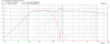

I just ran it through the sim, if you use qnty 4 in series parallel you get 92dB sensitivity and 100Hz f3. But very high SPL way beyond thermal. So maybe just two can work.
No sorry - I bought it years ago, and had some lying around in the garage. But I think the exact type isn't that important - I tried some felt too and it worked well, but didn't compress as well.
I think the important points are this:
1 Highly smooth transition from cone area to throat area - gentle curve.
2. Surround should be outside throat area - not visible on axis.
3. Gap between surround and bezel should have a smooth wall which transitions at the same angle into the throat curve so it is one single curve (hence important to create either a modified bezel or a very high tolerance molded gasket ring).
4. 3mm gap between surround edge and the bezel curve, filled with damping material which has decent absorption at cancellation dip - as up in the 6000hz range - most acoustic foams/felts have good absorption here.
5. Damping material must be compressible so you don't lift the bezel up too high, or a larger chamber is created between surround and throat and the problem is worsened.
