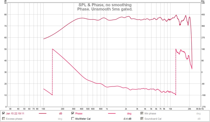

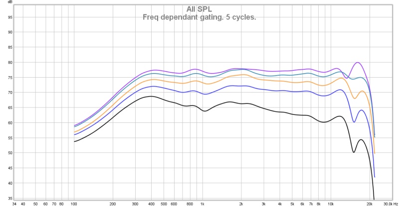

It's because what Wesayso is suggesting is to EQ at listening position which has a mix of reflections and direct sound. I measured at 0.5m and with 5ms hating can get rid of all first reflections. But I guess at LP or would look different and what we want here is a broad stroke of a how to help the response of not just the direct sound. At least that is how I am interpreting this.
xrk971,
Your measurements at .5 meter (and gating) effectively remove much of the room contribution, but may not accurately reflect the polar response of your horn, which IIRC, is larger than .5 meters across the longest dimension.
To accurately obtain phase information at different angles requires rotating the cabinet around the acoustic center, which can change in frequency depending on horn design and the HF driver used.
This is the uTrynergy with an 8.5in x 13in mouth, 13in is about 0.33m.
That will take some work and you are saying it should be rotated at where the voice coil is? That would cause a huge theta x R effect of swinging the horn face around and you have this big lateral offset of the horn mouth with angle. I rotate about an axis on the horn face.
The voice coil would be fairly close to the acoustic center at high frequencies for the type of horns discussed in this thread, but the acoustic center can change with angle depending on the type of horn and driver used.
I have not delved into REW enough to know whether it automatically adjusts delay on each measurement, in which case the acoustic center (and phase) are already corrected for each polar measurement. I'm still primarily using Smaart, which requires the delay to be set for each measurement for accurate phase response.

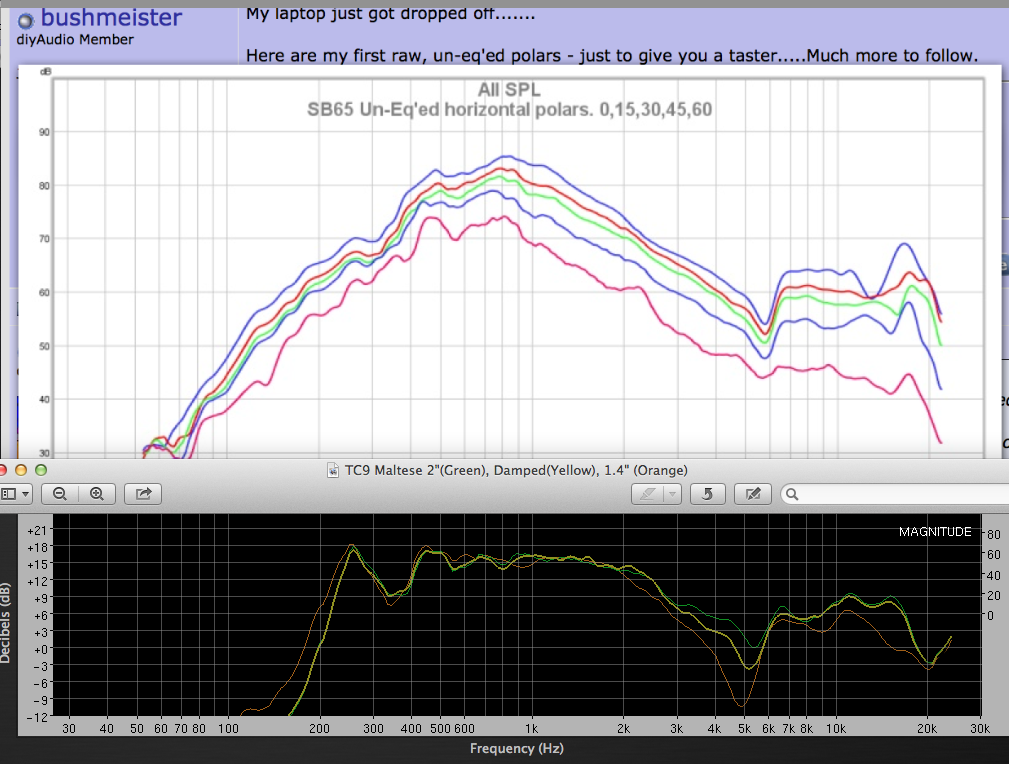

Have you guys worked out a solution for the suckouts at 6k and 14k?
That appears to be only real drawback of using cone drivers wider than a wavelength of the upper frequency desired, as XRK mentioned it is a reflection cancellation at the driver and throat. PEQ can "fix" the cancellation to some extent, since the primary dip remains at the same frequency regardless of listening angle.
The dip is a function of the cone diameter and throat exit diameter, rather than horn geometry.
Of interest, yesterday I tried using a damping "O" ring of felt on a two inch (50mm) round entrance horn between the TC9 driver (nominally 3.5") and horn flange. The TC9 requires a standoff ring around the surround to keep it from hitting the mounting flange, a 3/16 (4mm) deep 3" (76mm) inside diameter plastic pipe around the surround works well as a standoff. The TC9 cone diameter is 2.5" (62mm), though the "effective" cone diameter including 1/2 the surround is 2 11/16 (68mm).
I expected the damping ring to reduce the dip, but the opposite result occurred, the damping made the dip 3 dB deeper, and wider!
Using a 2" to 1.4"(39mm) adapter to reduce the throat size increased the -5dB cancellation dip another 10 dB (!) to an unacceptable 15 dB hole, dropping from 5.6kHz to 4.9kHz. The frequency reduction and depth of the nulls indicates that the cone diameter should not be much larger than the horn throat to avoid the problem.
Bushmeister's smaller diameter driver using a 1.4" (39mm) throat ends up with a near identical dip as the TC9 on a 2", even though the horns used are quite different. A closer match of the throat entrance to cone diameter would reduce the dip, but as the excursion of little "full range" drivers seems limited to around 2.5mm, also comes with a reduction of SPL potential.
It may make it worse if the damping ring actually increased the distance from the throat to the cone center or throat to edge of where the end of the damping ring is. I was thinking that making a damping ring of width (radial dimension) equal to 1/4-wave of cancellation frequency and having it act as a stub to dampen the dip out.
A tuned "stub" can reduce a peak, the damping made the dip deeper 😉.
The graphs in post #249 all used the same exact distance from the cone to the throat mounting flange. The radial felt ring I used was about .5" (3" diameter standoff ring-2"diameter exit), a quarter wave of the 5.9kHz dip (.6") would only be .1" deeper.
I had not even considered the damping as a function of wavelength, just thought it might knock off some of the reflected energy from the outer portions of the driver, reducing the path length error that causes the cancellation.
To reverse engineer the data, you might consider the hard portion of the cone diameter (66mm) compared to the 50mm and 39mm throat sizes, and the resultant dip frequencies of 5.6kHz and 4.9kHz.
I guess that won't work then - I was hoping it smooths things either peaks or dips. It may depend on the Q of the stub.
OK, so a LOT of polishing, I tried various spacers - settled on some acoustic damping wool I have used in the past on baffles to reduce baffle diffraction.
I sloped the throat a little bit more, then lined the space between the surround, bezel and throat with a ring of it.
It has completely removed the cancellation.
