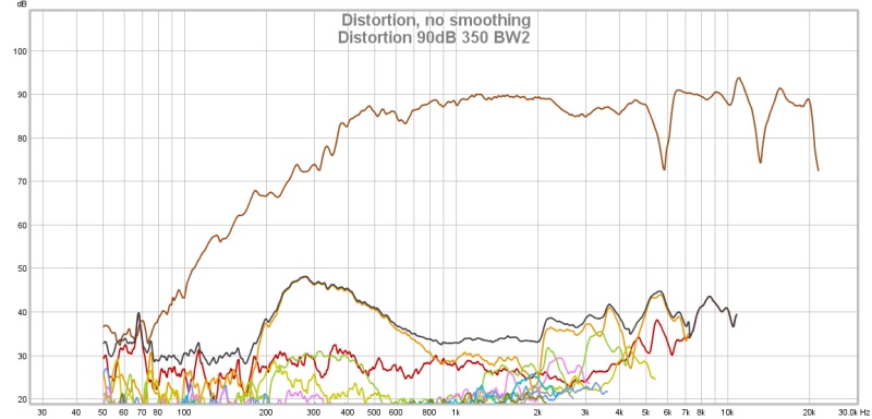

45 to 50dB disortion below your fundamental is not bad for a little 2.5in cone driver at 95dB. Looks like XO at 500Hz should keep all that mush in the lower frequencies out. What high pass filter are you running? Can you put a BW2 350Hz HPF and see what HD looks like?
Make sure you start wearing earplugs for full level sweeps... 🙂

It's been a great day full of progress Bushmeister. Thanks for plugging through it all. Now go save your marriage! 🙂
-55dB HD at 1kHz and 90dB is a nice clean sounding speaker. I do think this will work out quite well too.

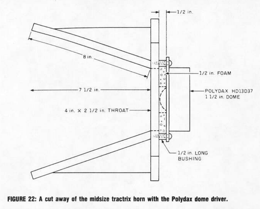

I looked up the method that X mentioned about using foam. I have attached a diagram that shows it taken from a pdf on volvotreter's site http://volvotreter.de/downloads/Edgar-Midrange-Horn.pdf

Thanks for the drawing, but my idea is a bit different in that I want to seal the back end of the foam so that sound doesn't leak out of the space between the driver and horn flange, but for it to act as a 1/4-wave absorber stub to soften the hard discontinuity of the edge of the driver.

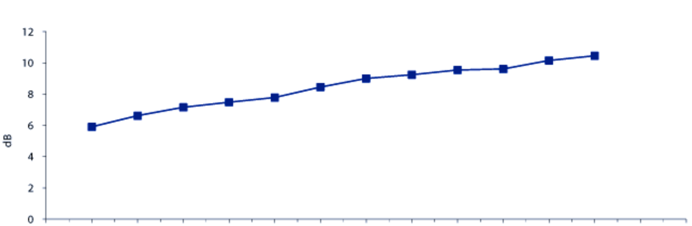

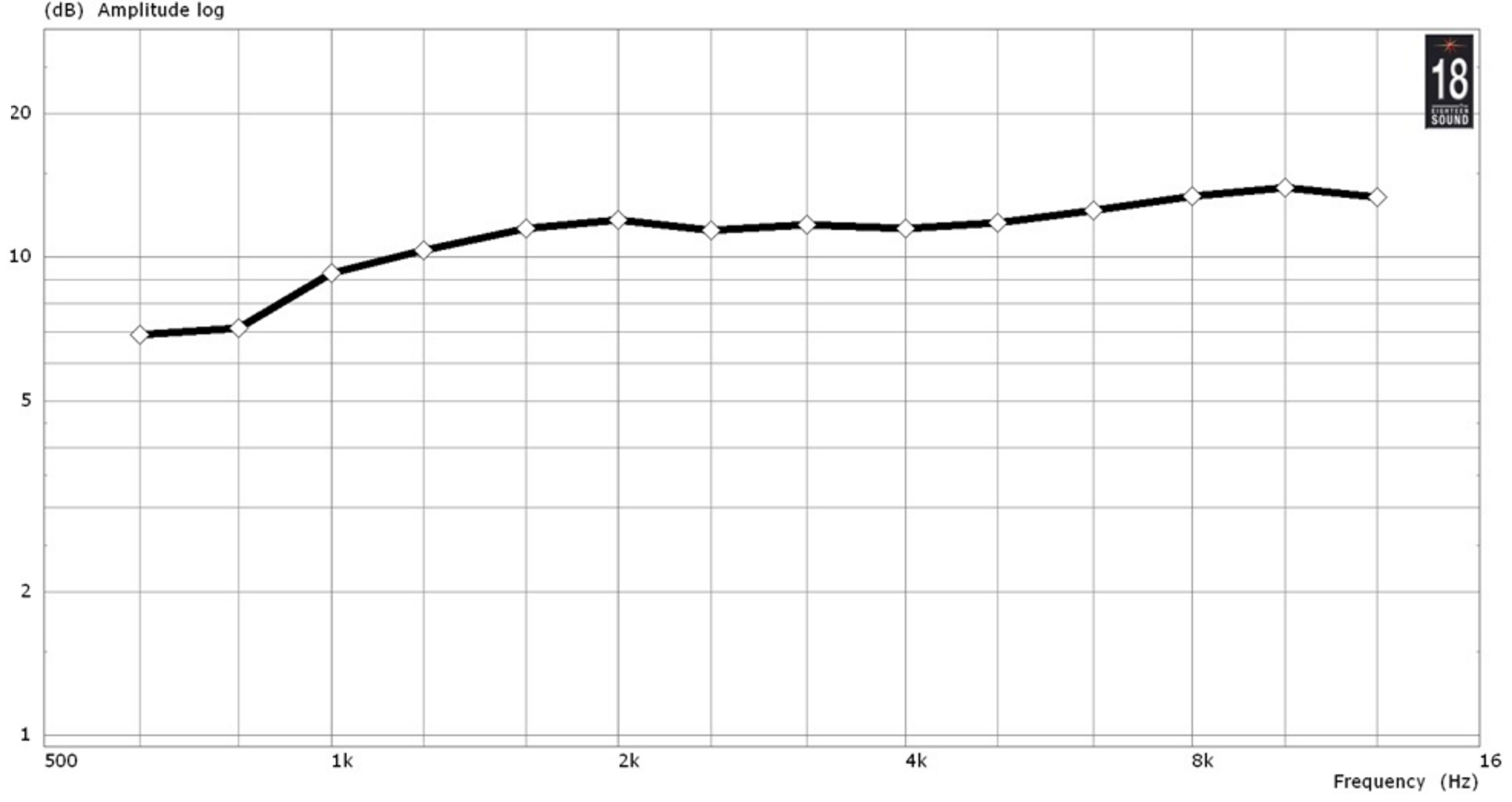

Both are very similar but XT1464 has more constant directivity LTH142 beams more at high frequencies due to the tractrix shape.
Directivity indexes
XR1464 pretty flat between 2k and 6k with a rise and fall either end
LTH142 rising directivity with frequency but still very good
Both look well made and smooth and are more similar than different probably comes down to price and availability
Directivity indexes

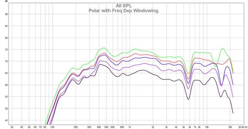

I don't quite understand the gating you've applied next to the frequency dependant windowing. I wouldn't do that. If we take a gating of 5 ms, that would mean a gating where 4 cycles at 800 Hz still fit. An 1/6 octave frequency dependant window is 4.3 cycles long. So in my opinion it shoud be enough to only use that 1/6 octave frequency dependant window. No separate gating.
I'll tell you what I would do, I'd start up DRC-FIR (oh no, sorry 😀).
I'd take the listening axis plot of your preference. I wouldn't pick on axis, probably 10 or 15 degree off axis.
Take that measurement, do like Greg did on the convolution thread: export the IR while putting a check mark at minimum phase. (export the minimum phase IR) You'd probably have to generate minimum phase first to do that.
Import that IR back into REW. Now apply the frequency dependant window to that plot. Look at phase and FR where the dip is in that plot. Maybe even run the Auto EQ from REW to see what REW would advise running it's analysis.
That way you'd correct for minimum phase deviations. This is the plot I would use, including the frequency dependant windowing, to base my EQ decisions on. Makes sense?
One more tip: also look at how these plots look gated with only one cycle FDW. Is the dip there at that point? Turn up the number of cycles from there, just to see what it does over time. Is it turning into a huge null at any point?

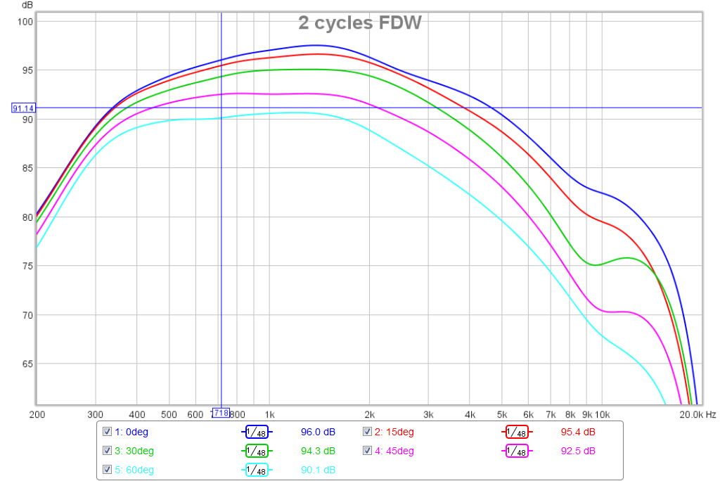

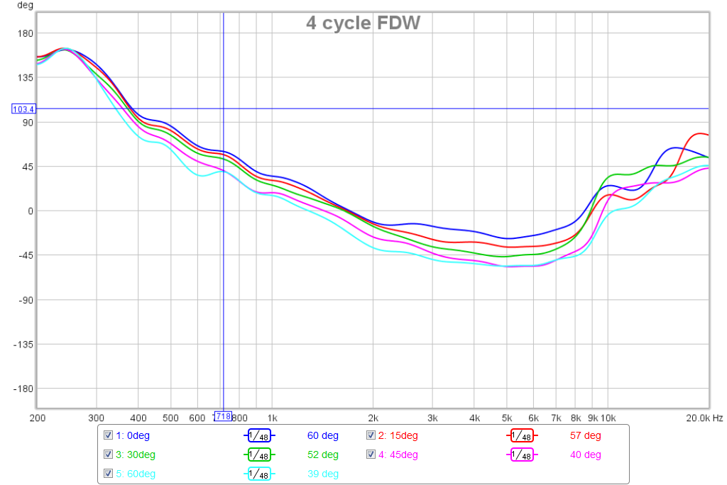

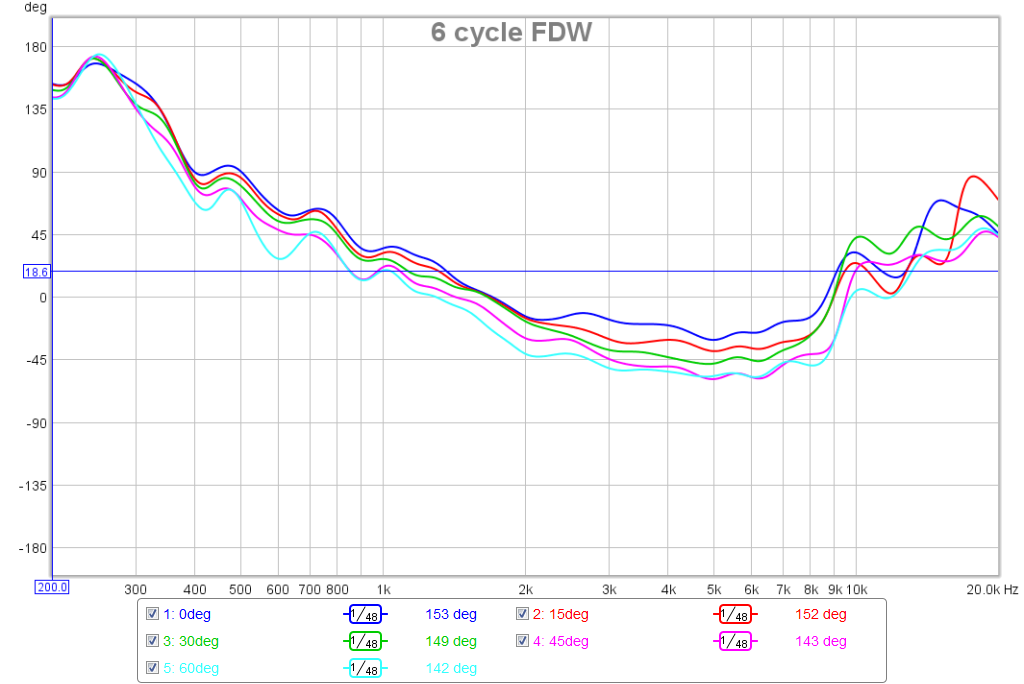

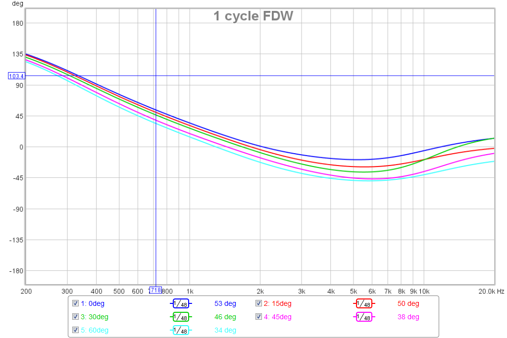

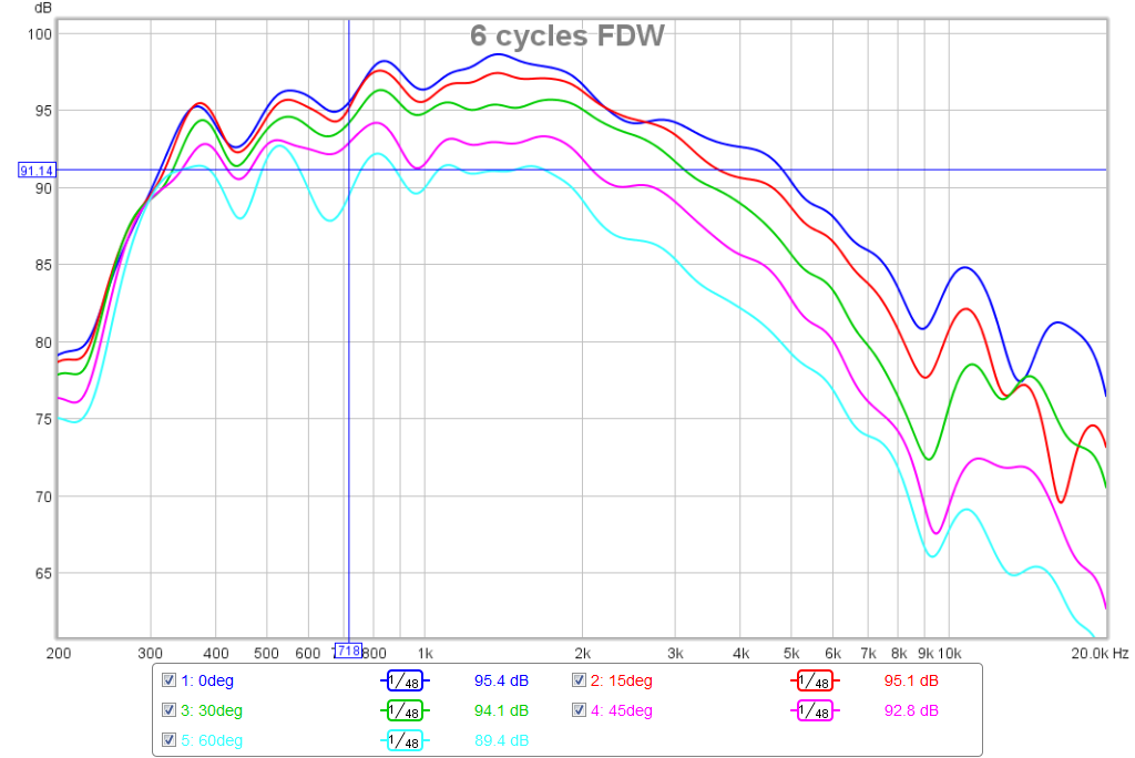

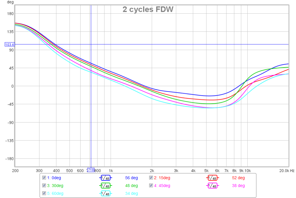

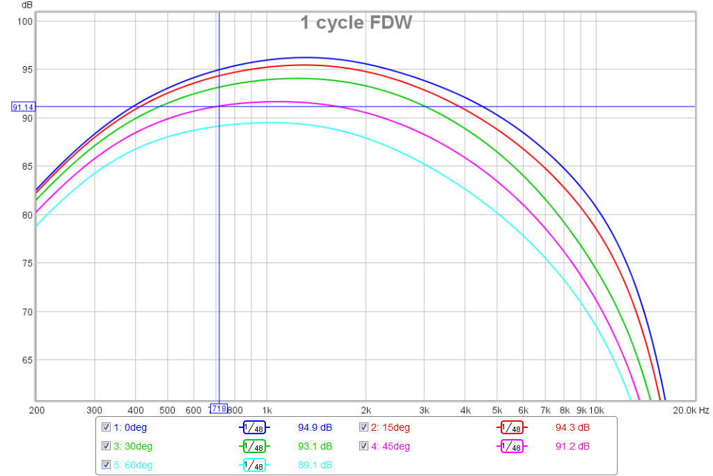

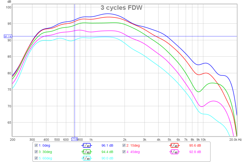

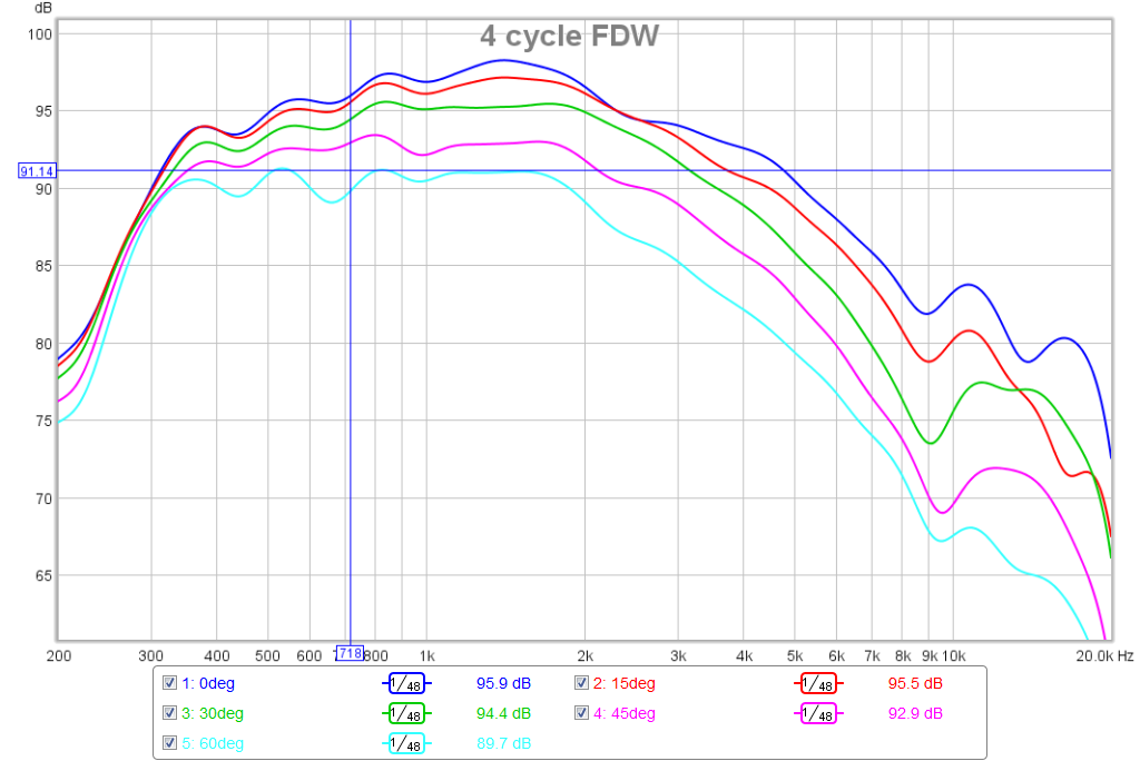

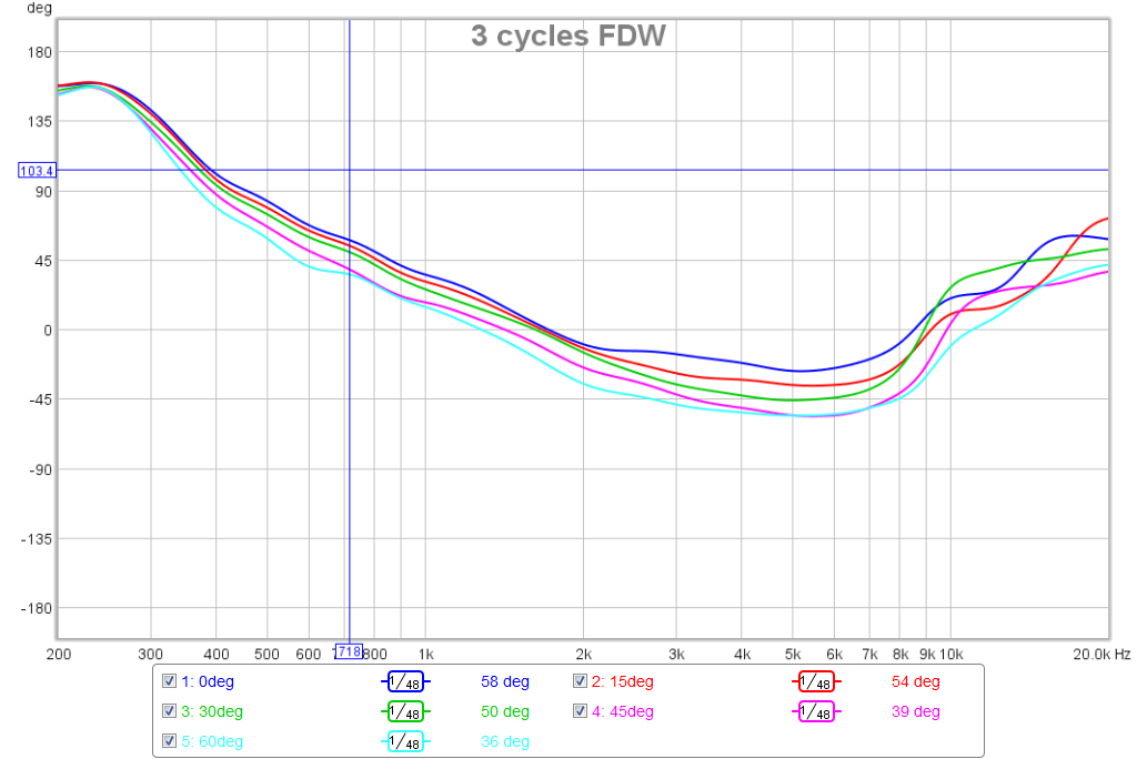

On second thought, rather than posting the reply to this over in the Trynergy thread, I will keep it here because I think this can be useful to Bushmeister in figuring out how to best EQ the native SB65 in waveguide response.
As I cannot take new data, I am playing around with the data I have already and doing what you suggest:
1. Generate minimum phase data
2. Export IR as wav file
3. Close existing data and import IR wav file
4. Apply FDW from 1 cycle to 6 cycles and look at FR behavior and phase behavior

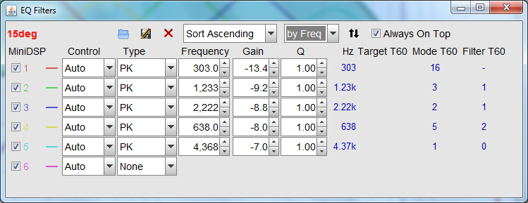

5. Use curves generated from this process to base EQ decisions with the goal to flatten the minimum phase with gentle adjustments in 6 cycle space
So here is the Frequency Response from the re-imported min phase IR for 6 cycle FDW (ignore the blue cursor - I accidentally checked the show cursor box and its on random location):
Phase for 6 cycle:
Freq for 4 cycles:
Phase for 4 cycles:
Freq for 3 cycles:
Phase for 3 cycles:
Freq for 2 cycles:
Phase for 2 cycles:
Freq for 1 cycle:
Phase for 1 cycle:
Based on the above analysis, it appears that the dip starts to show up in earnest at 3 cycles and the minimum phase is pretty consistent here. It would seem that to first order, an EQ to flatten the 3 cycle FDW would be a good gentle touch to get the system to go in the right direction to correct and help flatten the minimum phase, which you are proposing as the goal to shoot for best sound quality.
This is really helpful because it helps to separate what is correctable from the intrinsic behavior of the driver in WG vs what is really uncorrectable (without room treatments/positioning).
Yep - keep it here Xrk - this thread is very much a collaborative one, so all data/input welcomed!!
3 cycle FDW - REW auto EQ process

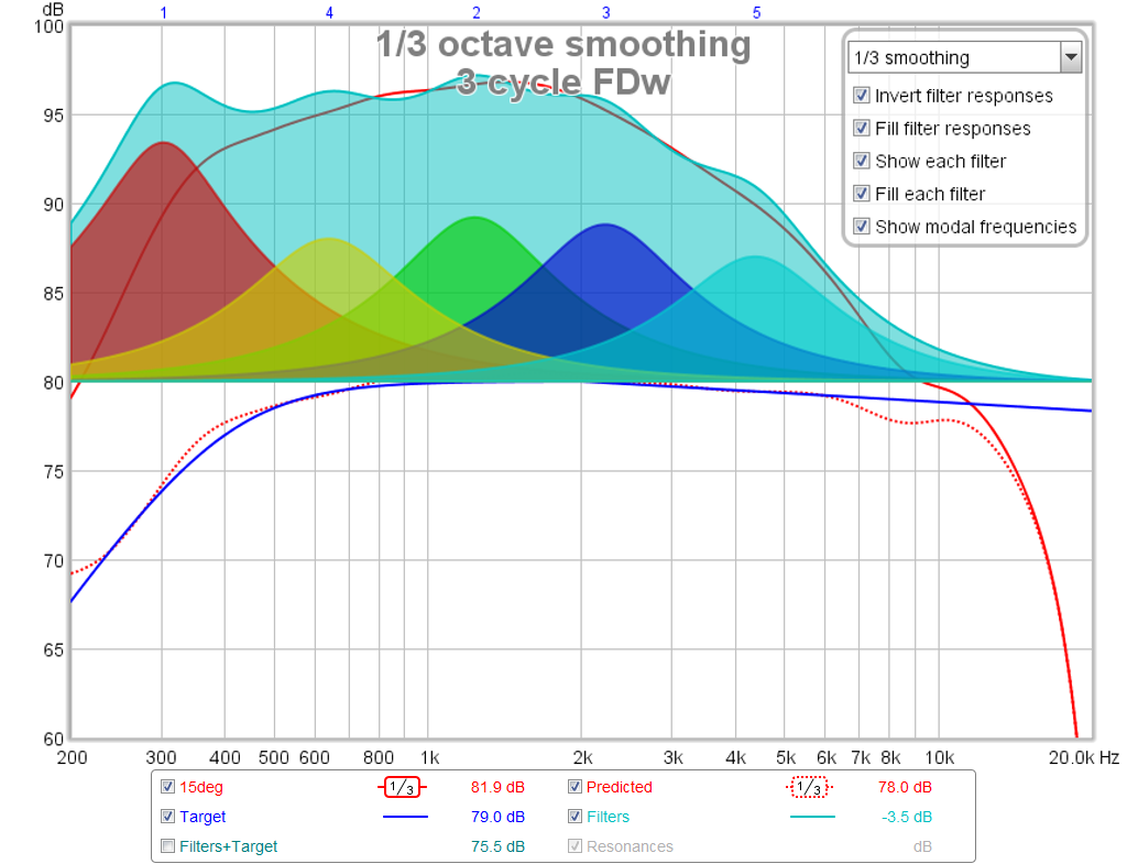

So I tried the auto EQ in REW, and in fact, this feature is the software's namesake (Room EQ Wizard) which I have never used before. I know there is going to be some play here as the outcome is very dependent on the input settings you give it. Here is my first try at it and I am using the 3 cycle FDW minimum phase data at 15 deg as the basis for my horn EQ.

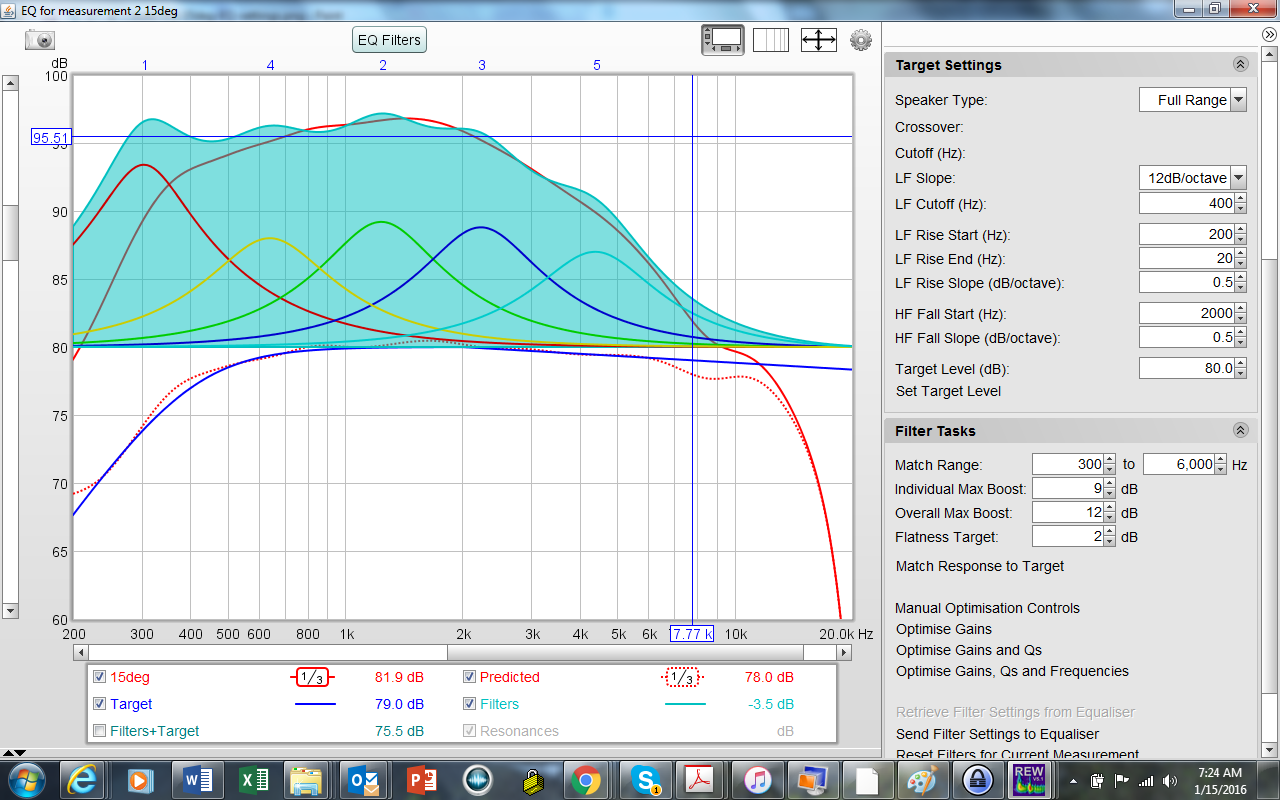

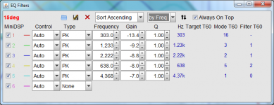

Here is a snapshot of the settings and the resulting auto EQ "sand painting chart" that resulted. (looks like a native American sand painting):
Here is a closeup of the EQ filters that were applied along with the target (blue line) and the predicted outcome (dashed red line), note that filter responses have been inverted for clarity:
Here are the suggested miniDSP PEQ's settings:
The predicted target still has the dip which I decided to leave alone by setting the target match below 6kHz. The HF falloff can be dealt with using a manually applied high shelf separately.
I think the predicted curve looks pretty good and it will be interesting to see how the measured minimum phase works out - probably flattened quite a bit.
I think this is all starting to make a lot more sense now. Am I on the right track?
Thanks Wesayso.
