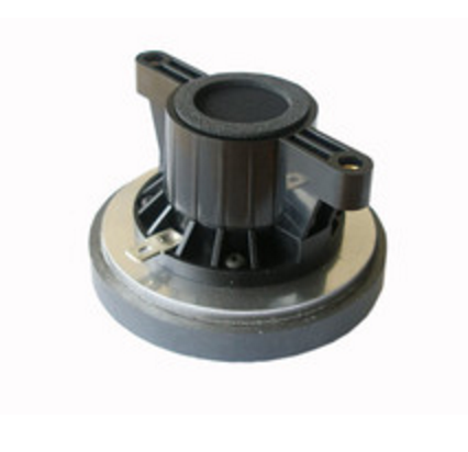

I just had a look at the NSW2 driver and it's interesting from a lot of aspects considering how compact it is.
But the 16dB fall from 10kHz to 20kHz is not good for matching with falling response in a horn.
That is what I thought but hoped it might work better.

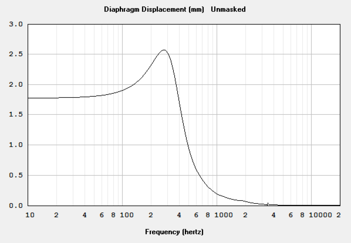

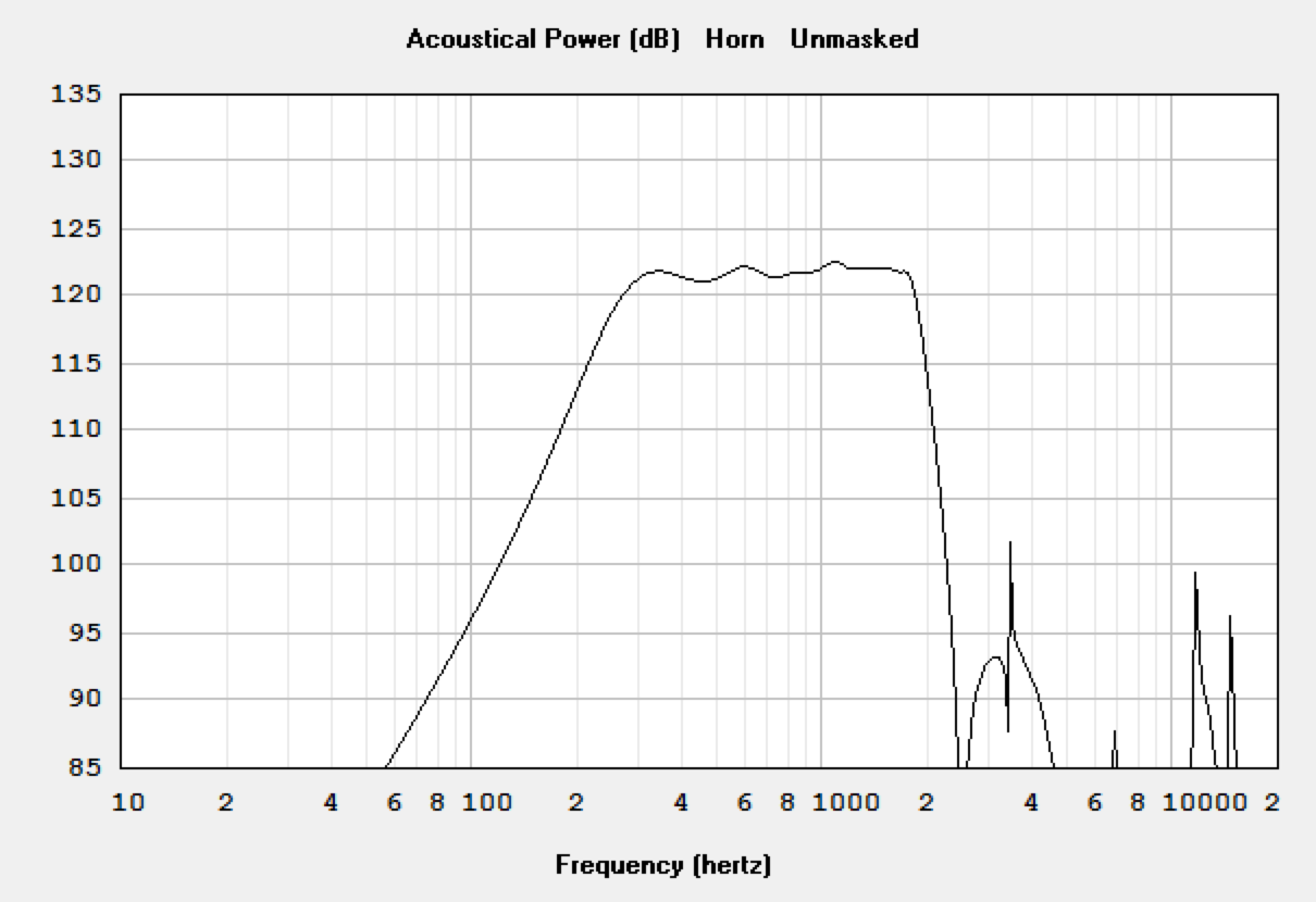

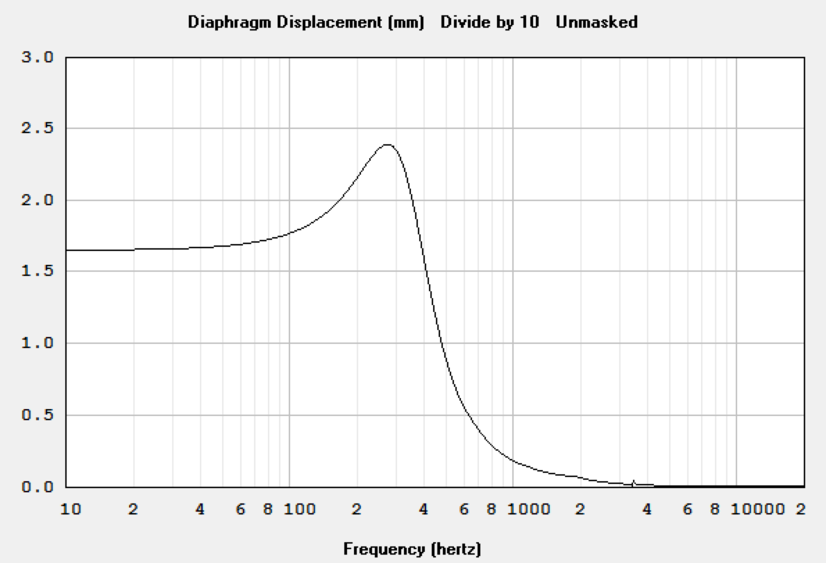

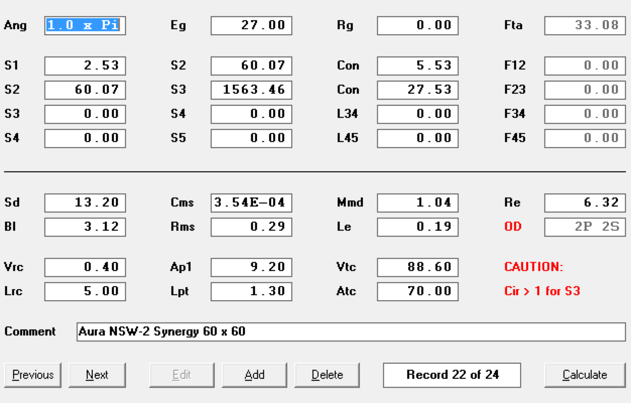

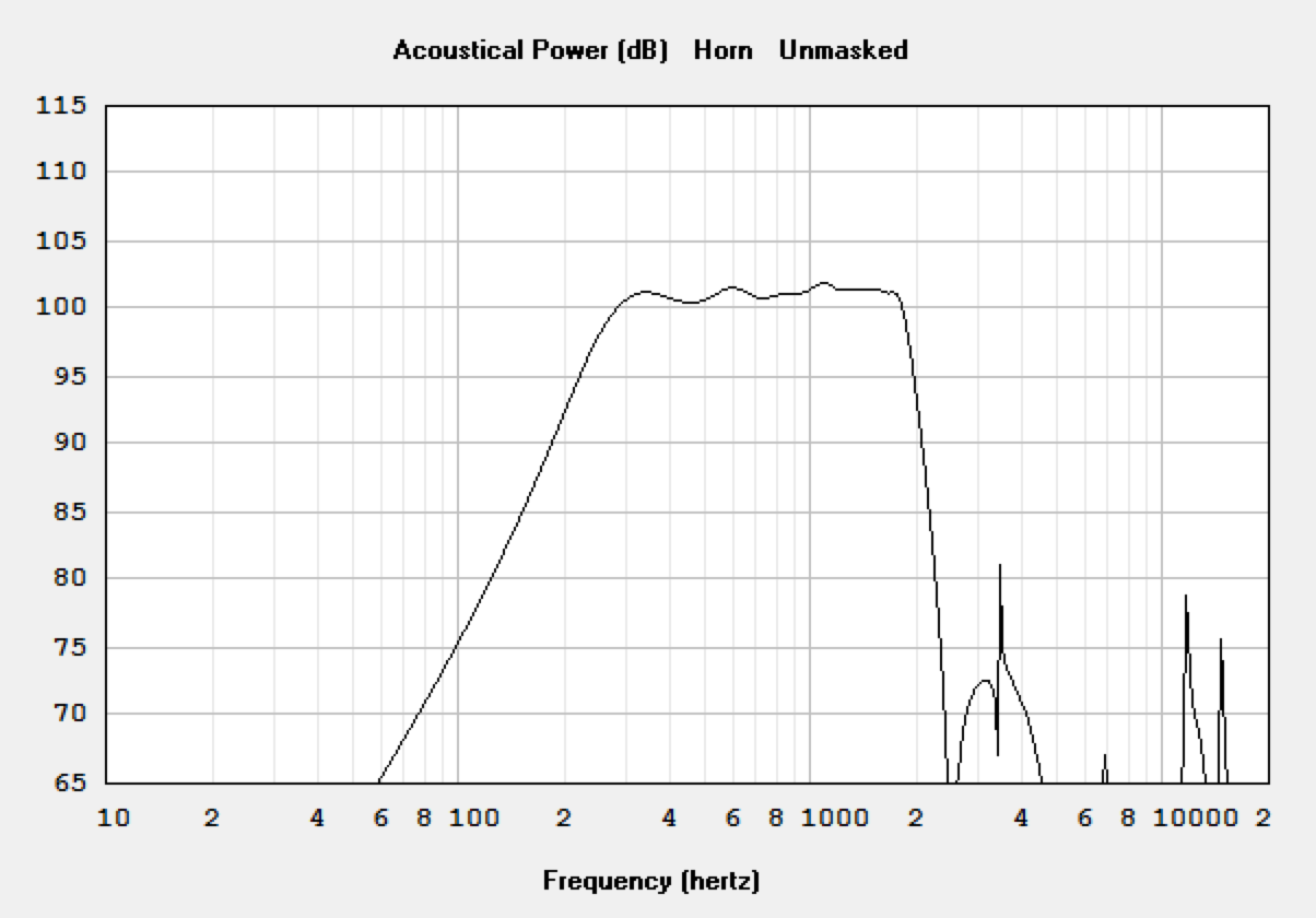

I bought them to use in a more standard synergy design. 4 Auras per horn and a BMS 4524 aiming for a 1.5 to 2k crossover. Your thoughts on the sims are pretty much spot on. I have found they work really well in a 60x60 conical horn roughly 16" square.
These are my Hornresp plots which include the path length for the BMS which is 3.56cm. Due to the physical shape of the BMS driver I can actually mount the auras over the back of the horn throat to get the drivers virtually on top of each other. As you can see these have no filters and xmax is not exceeded even at 120w with response that will work with a 250Hz crossover to woofers.
1W power
1W displacement
120W power
120W displacement
Hornresp input
BMS 4524
It is going to take me a while before I get out of sim land but so far I think these will work well together and I have hope that I will end up with something good for very little money. I bought the auras when they were on sale for $15 each and the 4524 is only 50EUR each so it is still a pretty low budget system.

That's a nice result to see that the little Aura's can push 120dB+ at 300Hz. Quite amazing actually - probably the 5mm xmax helps a lot. You should consider trying a dome tweeter rather than a compression driver - the harmonic distortion on the dome will be much less I suspect and it will sound better. I don't know if you can push 125dB out of it, probably not but for home use, probably just fine given a +10dB boost on 90dB sensitivity already.
Look forward to seeing your build. How do you mount those drivers - they have no screw bezel - just press fit and have a clamp on the back?

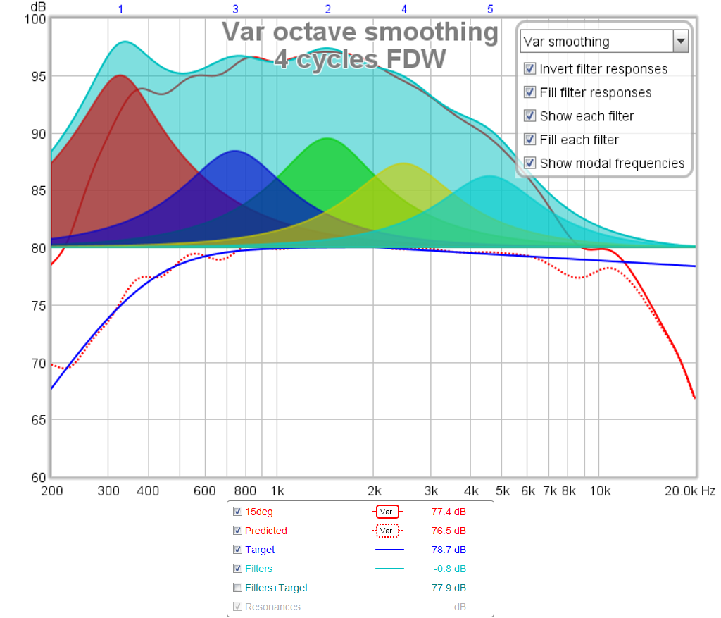

Within the EQ window dialog, there are choices for smoothing - should I pick 1/6th octave, variable, psychoacoustic, etc?
Here is 4 cycle with variable smoothing, I think there is more ripple in predicted outcome the LF's but maybe that just wasn't visible before and really are just reflections.
Here is new EQ:

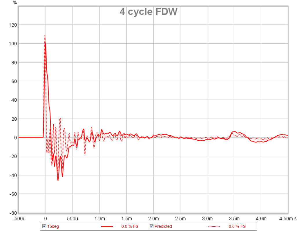

Here is predicted IR with new EQ:

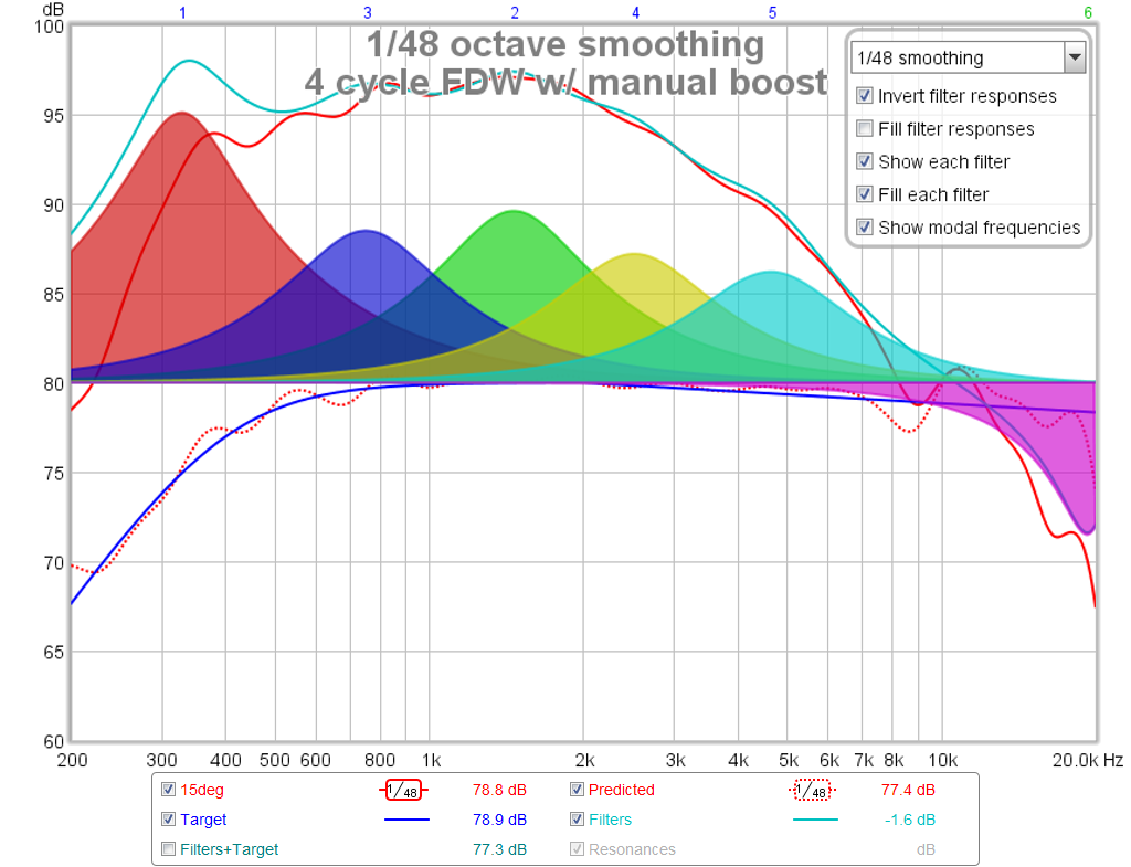

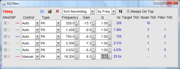

Ok, here is 4 cycles, no smoothing, with added manual peak at 19200Hz, Q=0.65, G=8.5dB to pull up the HF's.
And here is the new miniDSP PEQ settings:

No smoothing, the frequency dependant window IS your smoothing.
4.3 cycle window = 1/6 octave FDW
You might have to use a manual EQ/boost to counter the drop off at high frequencies. Let's see how it goes on the 15 degree FR.
I'd add a manual PK centred at ~8700 and figure out the Q and gain to fill that dip (*). But use the no smoothing version. The frequency dependant window does all the smoothing you need.
(*) = Just try it and run tests afterward of the full polar and check HD with dip filled and without.

I ran out of PEQ's for this bank. In miniDSP there is a second global PEQ that I can use to add the boost to fill in the dip.
Do use the non smoothed graph as the base for the actual EQ. And don't be afraid to edit the actual values (set them to manual) if you think you can do a little better.
Figure out the dip in this EQ session. Might set it to generic to have more available. We're on a test run here... 😉
Were there large changes in the predicted waterfall plot?

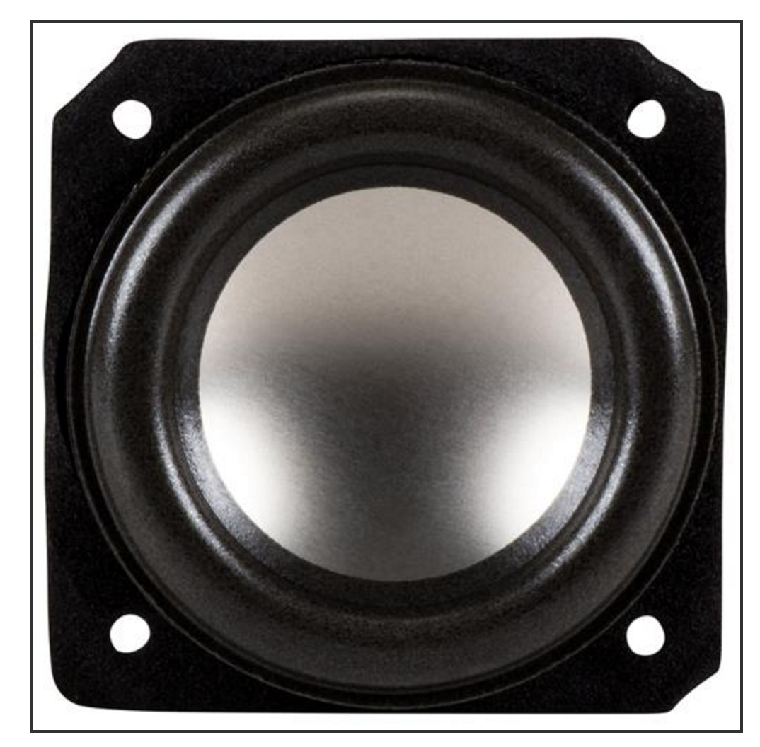

I liked the look of the sim Hulkss was posting in the Unity midrange thread and after some sims of my own I couldn't find anything better. The xmax is actually 3mm 5mm is maximum excursion not linear though. Once it got over 120dB I stopped adding power as I will have no need of it but interesting to see.
No they have a square mounting bezel with screw holes. Sometimes the pictures don't really show it but this is what they look like from the front
Interesting about the dome I hadn't really thought about it before but with a crossover above 1.5k could probably work. Any thoughts on suitable domes?
I have some Seas millenium tweeters that could be liberated from my Orions for a quick test as they work with a 1.6K crossover but I won't be buying any more of them at the price.
I haven't bought the BMS drivers yet so I can always try a dome out first. Probably harder to sim a dome as the path length will be somewhat unknown.
Yes, it did clean up the waterfall significantly but still looks a mess. I will play with the manual PEQ some more but you are right this is a test case. I am not even using the W2-852SH anymore so maybe a bit of waste - really just training for me to go through the mechanics of doing it when I get the correct measurement with the SB65 again,
