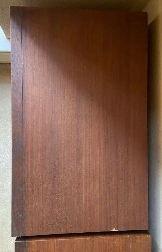

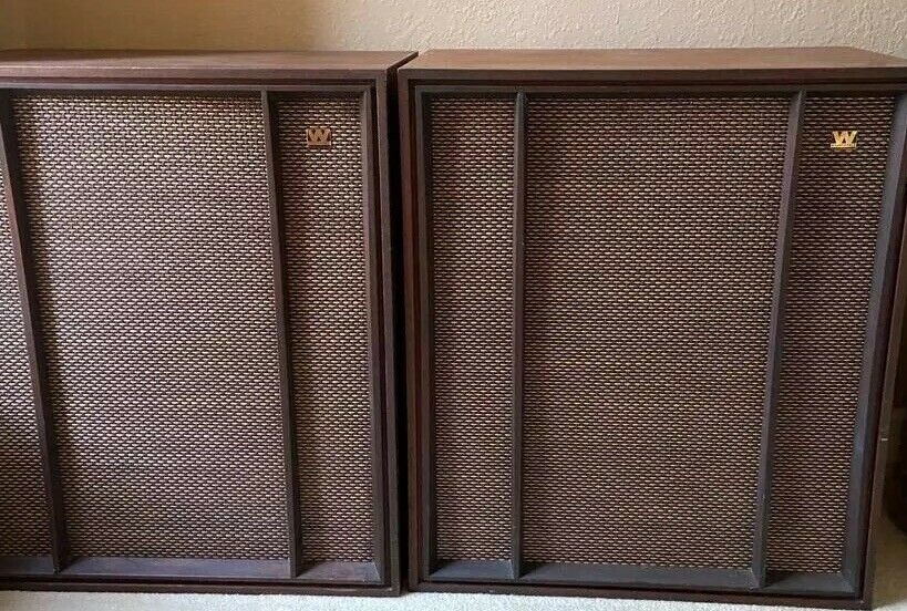

Hi Barry , Hope all is well with you , we are still alive and kicking here - 🙂 At present I am using my NHT3.3 Commercial speakers, but I will be selling them very soon. My next speaker project is in motion - I bought and picked up a pair of Wharfedale W70 Speakers that I am Restoring/Modding --- there are 60 year old caps in the crossover as well as the 60 year old dual L-Pads - (for Tweeter and Midrange level control) - - all need to be replaced - they have seen better days - LOL. I am going to use PIO Caps for replacement of the old original electrolytic caps. I also have a modern custom crossover design I am going to try on the speakers - I will have to see which crossover I like better, the old simple more full range xover or the new modern one. Also I want to get some help from someone with the crossover because after I find the right settings for the L-Pads I would like to replace the L-Pads with the right resistors, but I would like to set it up so I can change out the resistor like they do in the Pure Audio Open Baffle Speakers - - they use simple old fashion screw terminals for the crossover parts , so it's just a matter of unscrewing the screws and replacing the resister with a different one - about a 2 minute job. That way both myself and the person I will sell them to, can easily tune them to his room and tastes.... just not sure what the crossover will look like yet - I'm new to crossovers - - Luckily they are a very simple xover , just a cap on the Super 3 Tweeter/Midrange which is a 3.5 inch driver. And a Cap , Resister and Inductor on the 8 inch Alnico - Midrange/Woofer. The 12 inch Alnico Woofer is the most complicated part of the simple crossover - it has 6 parts to it , an Inductor and an EQ circuit ... don't know what it's for yet - LOL --- They are 24 inches tall, by 22 in. wide by 13 in. deep.. I plan on putting a box around the mid-woof because right now i think it's getting a lot of interference from the big woofer. I also have an idea on another mod to do on them , one of the guys on the Audiokarma Forum had the drivers all tested to find there Theil- Small parameters and found that the woofer would perform much better in at least a 5 cubic foot box, and larger would be better - right now it's around 3 cubic feet I think...... so here's my idea - I found a really great deal on another set of the same 12 inch Alnico woofers to add the speakers. I was going to rebuild the speakers and add the second woofers to the fronts of the boxes for even a better low end .... but they are pretty nice looking - the pictures don't do them justice. So now I'm currently thinking that I don't want to mess up the profile of the speaker box from the front by maybe adding that second woofer. So now I'm considering a crazy idea to try ... I'm thinking of adding a thin section to the back of speaker box - maybe 10 inches or so deep, slanted down to the floor (so smaller on the top of the box than the bottom) and placing each of the second woofers in those additions so that they will make the front set of woofers think they are in a Much Bigger box ( almost like an infinite baffle) - and perform much better.

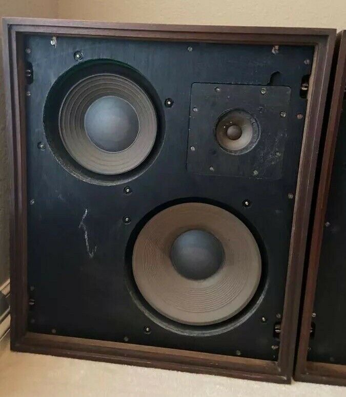

So to un-confuse something I said at the beginning, the reason I bought these W70's was kind of a proof of concept - they were a great deal - just $200.00 for the pair which is less than half of what they could have sold for which is about $400 - $500.00 --- they were local pick up only ..... I wanted to see if I liked them as much as I thought I would from reading lots of other peoples descriptions. ............. My ultimate goal was if I liked these enough i wanted to build their Bigger Bigger Brother it's called a SFB-3 .
When Quad came out with their revolutionary model 57 electrostic speakers , Wharfedale needed to compete with Quad's speaker so they designed a very cool Ultra Dynamic version of the Quad 57 using regular piston drivers. that speaker is their SFB-3 Speaker - unfortunately they are kind of rare and 1,500 to 2,000 dollars a pair - ( if you can find them ) - and probably $400- $600 to ship -- even the drivers are expensive and hard to find , Ill have to be patient and get lucky.
So after I have some fun restoring and improving My W70's I will probably sell them and clone the Wharfedale SFB-3 speaker! - I am currently trying to collect the six or eight 60 year old speaker drivers that I will need for them. I am quite amazed at how Great the W70's sound considering they are 60 years old and have messed up parts in them!!!!! - LOL ........ -- oh I also have discovered that as nice as the Vintage speaker grills look - ( they look great in person), they are too dense and not letting the speaker sound it's best, So since they don't look very good naked - I want to change the way the grills are attached to the front & go to embedded Neo magnets and then build a second set of grills to exchange to when listening to the speakers. I also am going to refinish them too.

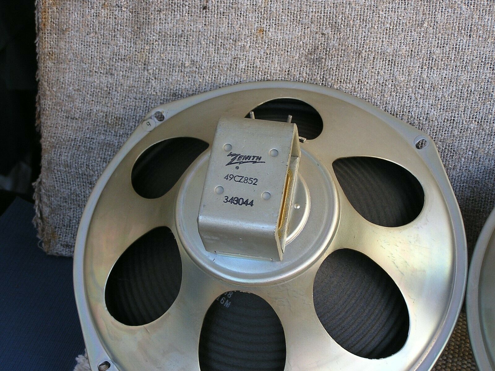

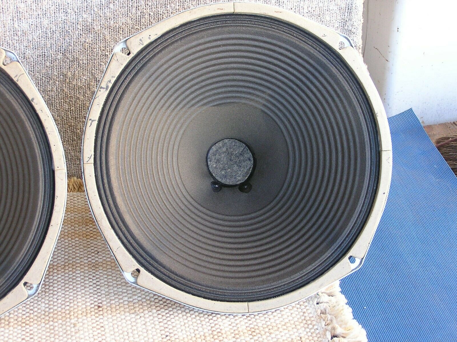

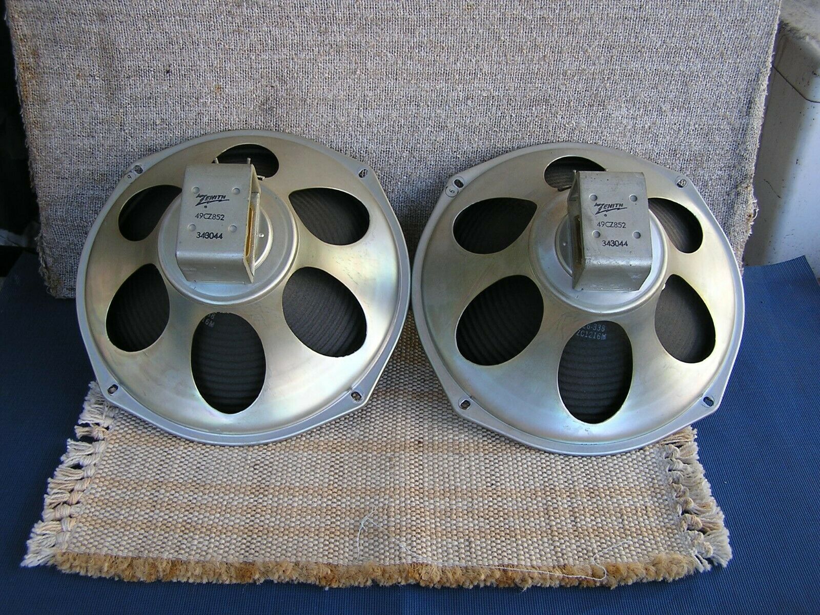

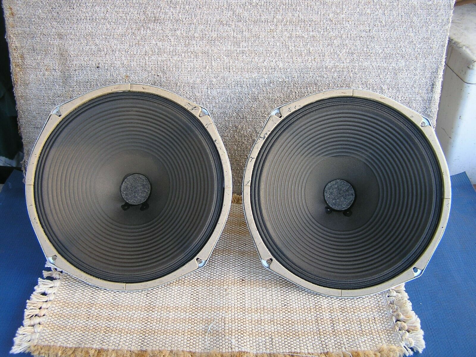

I don't have pictures of the Open baffle's using the Zenith drivers yet - i haven't decided on a design... so many choices , too many cool designs to choose from ... and I am also trying to make a decision on my woofer - and subwoofer choices.
-- I will include the 12 inch Zenith 49cz852 driver pics - but they aren't much to look at by themselves - LOL
-- more next time , i seem to get carried away writing - 😀
-- see pictures below --
Zenith 49cz852 Speaker drivers are up first ----

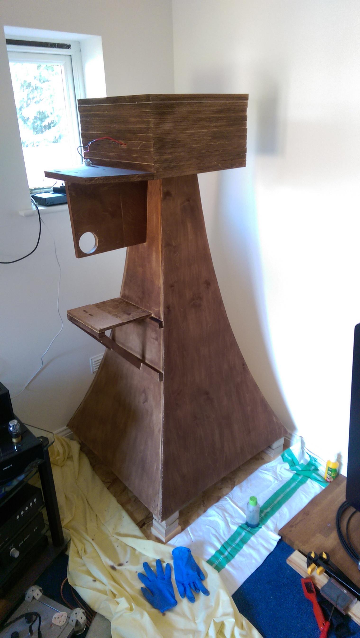

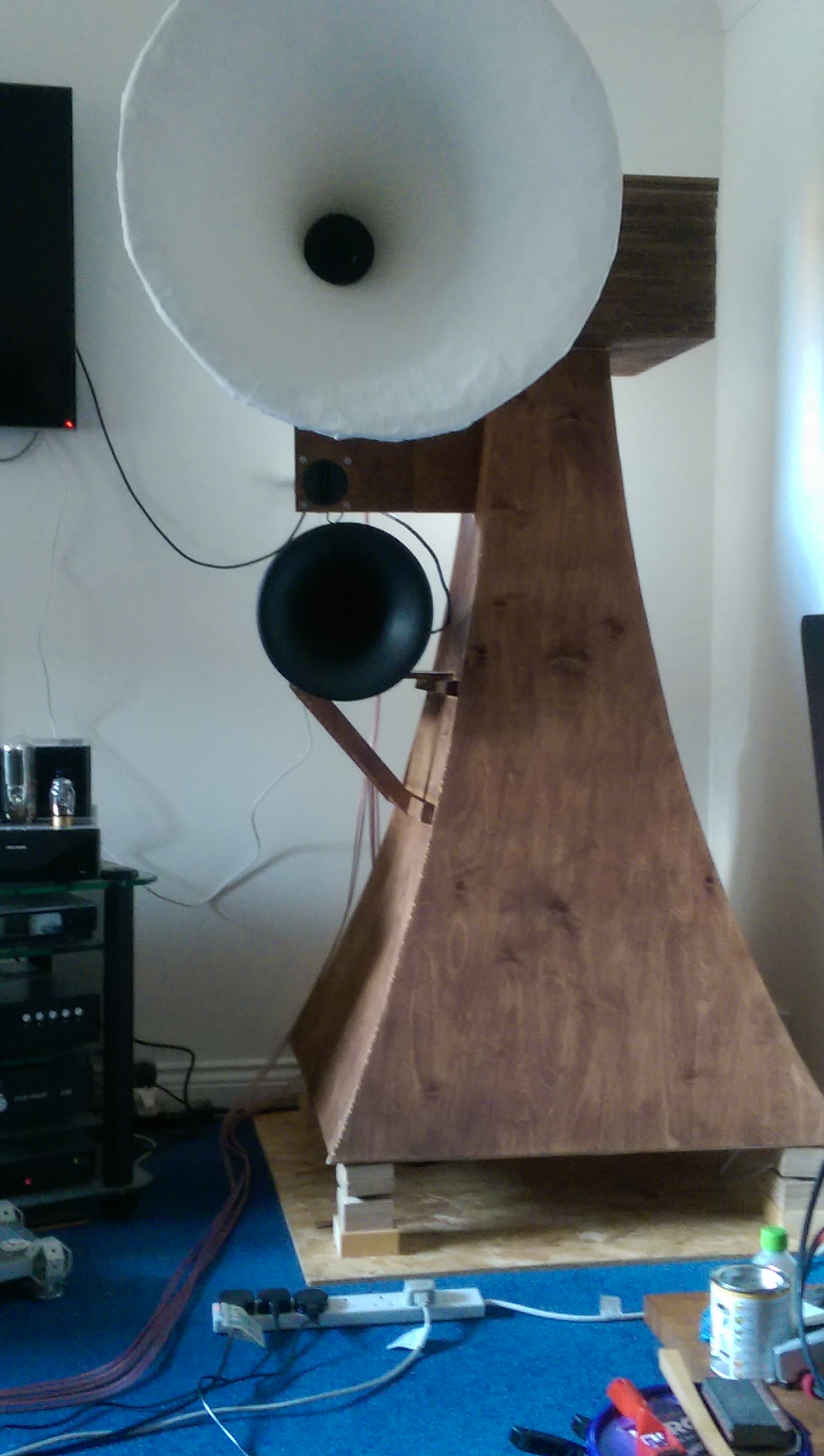

Hi Lucfm,
Thanks for comments. I’ll try and answer your questions, but I’ve had help along the way, so may not be able to fully answer them. No I have n't listened to the commercial version, but several friends whose ears I trust have.
Bass horn – one of my friends used hornresp to model it for me. We targeted 50 Hz with speakers in the corners, knowing if I needed more bass to look at subs.
Vrc – with the speakers in the middle of the room, we measured it’s response, starting with open top, closed top, then adding more insulation. As we added more insulation (carpet underlay) the response became flatter. My 13 litres is the nett volume after driver & insulation. The insulation is porous so I don’t know how you decide what the actual vrc is, if that makes sense.
There is no internal bracing in the bass horn.
Floor gap –due to corner position, I started with vertical opening equivalent to horn area and then adjusted in 25 mm increments. It probably still isn’t optimised, but it sounds ok to me (and others).
I’ve been buying drivers, parts for several years prior to finishing the design. Original plan was to make it 3 way with all front loaded drivers being horizontal. I had JBL2405, Fostex D232 & horns & Fane drives. Prior to building anything, I realised that bass horn would not work horizontally. Hence why I went vertical.
150 Hz tractrix, because I was aiming to crossover @ 250 Hz. Driver – I knew I had to use an off shelf driver, which would fill the gap & give me flexibility in handing over to Fostex.
I’m using a Behringer DCX2496 which only has 3 outputs / side. For ease I’ve just a cap between Fostex & JBL 2405 to crossover @ 8kHz. I have measurement equipment and use REW but am unsure where to place microphone to get the best results (after measuring each driver on axis @ 1m). Initially I had 6dB slopes everywhere, but there was too much overlap between the drives, hence after reading I settled on LR4. I’ve attempted to time align (post 94) and am willing to be guided by others as how to proceed.
When I decide on what to replace Behringer with my plan is to play with slopes, etc.
What plans do you have ? Any comments are welcome
Stay safe
Barry

- So my second set of 12 inch Wharfedale woofers arrived so the next step is to build another set of sand filled back walls, so I can install the new woofers into them as an Isobaric design , which should make the first 12 inch woofer think it is in a speaker box that is about twice the size as it is in now - for much Better BASS! - but it can be exchanged with the original back if the buyer wants it to be stock. ---- you never know about people ..... ha ha
- I'm also adding a second set of binding posts so it can be Bi-wired or Bi-amped. I also found good replacement L-Pads for the two L-Pads for the tweeter and Midrange on each speaker. . . . . Then I have to decide how to refinish them, i could go with new veneer, or just sand them and re-stain them.... should be interesting I haven't done much refinishing.

- A 4-way Horn speaker
