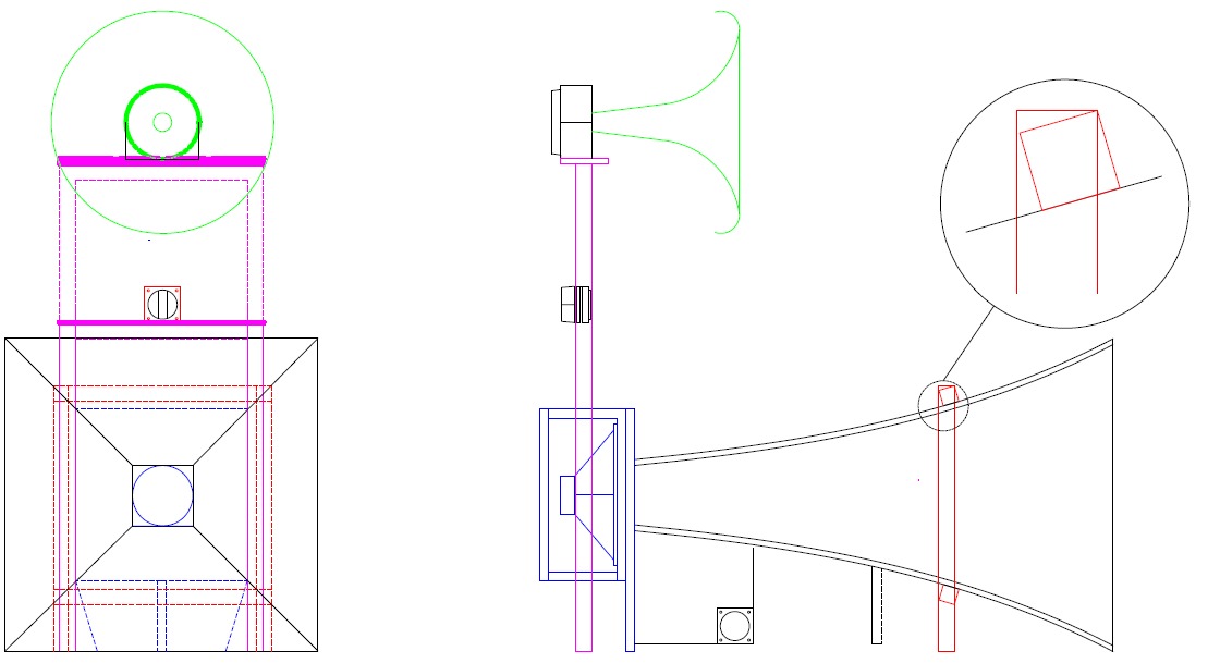

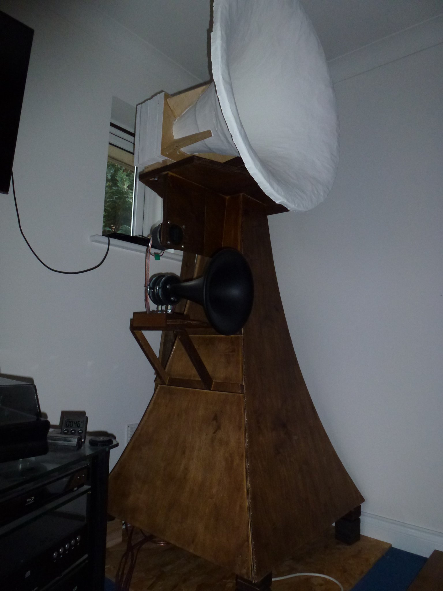

Which one is the main horn and how will you change it?I'm considering changing the main horn from vertical

My take on this is that it completely change the concept of the system. Anima concept allows good depth reduction with some compromise, quite hard to define if you maintain low cut and not that elevated position for the next horn (not as in your picture). By changing it orizontaly you loose all good packaging, not gaining much in your relatively small audition room. Also, today you have no excuse not using digital delays (and DSP) to compensate for so large acoustic path differences in such large horn system.Following some input from people with far more knowledge than I have on horns, I'm considering changing the main horn from vertical and would appreciate feedback [...]This potentially can allow me to simplify from 4 way to 3 way. I'll aim to use Celestion axi2050 c/w LeCleach horn and JBL 2405 as shown in the drawing.

I understand you are trying to get higher frequencies out of your larger horn. In addition this is going to change things quite a lot, but after some time you should find a way to make this work. The mouth conditions and effective length will change. Resonances due to axial reflections. Room modes coming from not so closely on the floor.
You'll also find the higher end of this will have a higher DI, it may be light on power. It may be challenging to cross to.
This midbass horn is in one of my possible future plans. How does it sound up to 250Hz? Can you really meet the midrange at 250Hz? Did you ever measure the midbass horns response with a microphone? Which midbass driver is it?Current set up is 4 way, as shown below. Mid bass is currently vertical firing into the floor.View attachment 1166171
I'm proposing to rotate the mid bass from vertical to horizontal & go to either 2 way using Celestion axi2050 or 3 way using a i2050 ÷ jbl2450 as shown in the drawing View attachment 1166172View attachment 1166172

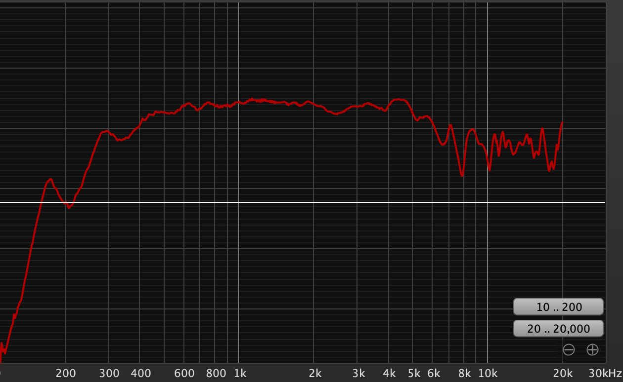

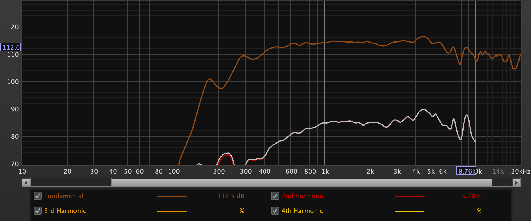

This is the AXi2050 on my horn, with something like Filters to make it more level than the natural response.
This the highest thd reading on this measurement, 5% @ 8.76khz/112db/1m..... Do you understand how loud that is???
In the domestic setting, we will will never use that headroom....but I guess its good to know its there. Never too much headroom right?
So regarding Josephs comments. Lets be honest and realize that we can measure everything that we hear for the most part. Just show us with measurements how "drastically" the playback changed right?
Below the Axi2050 outperforms the other driver in almost every aspect... Yet he says that the driver on the right has better HF. Strange, and I don't believe him, as well I think something is off with the mating of the horn with the Axi. Even if that is true... his own measurements do not line up with his subjective stance. FR above 10hkz is smoother in first measurements??? IMD and THD is lower.... but theres some magical harshness that doesn't show in the measurements??? Then his subjective is that the other driver sounds better on the top? Doesn't make sense. I trust measurements not ears.
How did he improve the FR of the other driver in the last measurement btw? But not the Axi? Too much strange stuff going on...
OK I see now that on the last measurement of the Axi, its showing up to 50khz. So its safe to say the Axi is fine till 20khz according to his measurements. I was wondering how the response got so bad.

This is the AXi2050 on my horn, with something like 3 or 4 Filters to make it more level than the natural response.

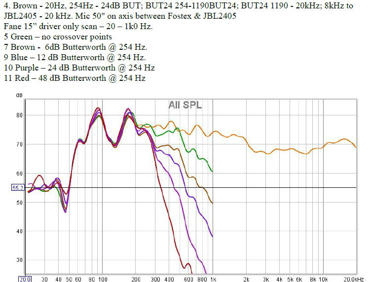

Hi, I'm currently using a Fane Crescendo 15" driver on the vertical horn up to 250 Hz.This midbass horn is in one of my possible future plans. How does it sound up to 250Hz? Can you really meet the midrange at 250Hz? Did you ever measure the midbass horns response with a microphone? Which midbass driver is it?

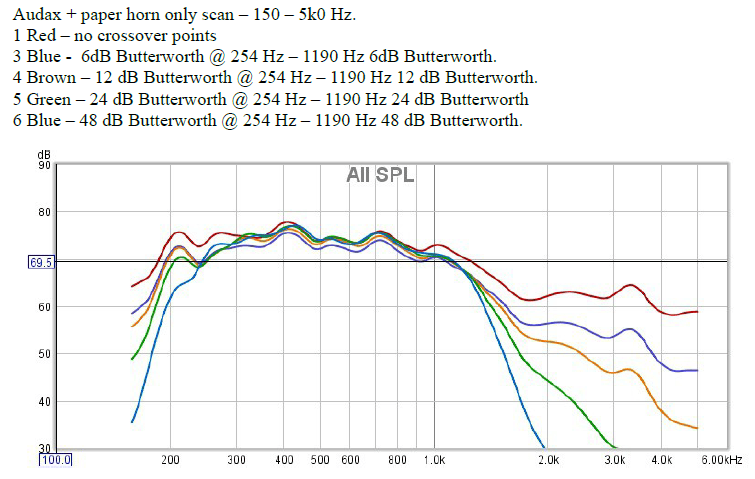

It hands over to Audax PR170 on paper horn up to 1k2,

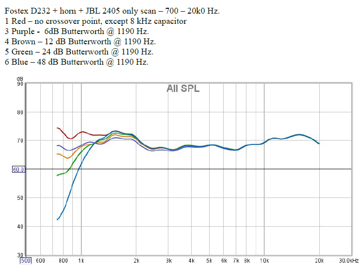

then Fostex D232 compression driver to 8kHz
JBL 2405 compression driver.
'm a novice at taking measurements, but here are three I've taken, which you may find the most useful.
These were taken with Behringer DCX2496 in operation and I used it to see the effect of different crossover slopes at the same point. I can't remember why I used Butterworth.
Behringer only has 3 outputs, so I've used a capacitor on JBL 2405
Re 250 Hz - A simple test that one of my friends did when he came round was to put the tuner onto BBC radio 3 and listen to male vocal - it was acceptable, not chesty, with nothing of note coming out of mid bass.
Thanks for your feedback.My take on this is that it completely change the concept of the system. Anima concept allows good depth reduction with some compromise, quite hard to define if you maintain low cut and not that elevated position for the next horn (not as in your picture). By changing it orizontaly you loose all good packaging, not gaining much in your relatively small audition room. Also, today you have no excuse not using digital delays (and DSP) to compensate for so large acoustic path differences in such large horn system.
The chance to buy a pair of secondhand Celestion axi2050 drivers came up, which had only been used domestically, so I bought them. The buyer gave me a pair of JMLC horns, but I won't be able to cross then @ 250 Hz, hence rotating bass horn through 90 degrees.
My plan is to convert one side and set them up active crossover. If it sounds better, change the second one.
Whilst the speakers will take up a bit more floor space, it's my music room, so my wife just closes the door. 😉
If it sounds worse, then I'll either swap it back or if I'm feeling brave make a larger horn to mate with axi2050 as part of a 3 way.
A passive crossover is an itch to scratch later.
Thanks for your insight. I'm on a learning curve so will be asking further questions as I go along.It may be challenging to cross to.
Sounds like a good/lucky purchase.The chance to buy a pair of secondhand Celestion axi2050 drivers came up, which had only been used domestically, so I bought them. The buyer gave me a pair of JMLC horns, but I won't be able to cross then @ 250 Hz, hence rotating bass horn through 90 degrees.
If you simply drop this newly acquired stuff into one channel of your current system, you'll have this -
[?]-250Hz via Fane Crescendo 15"
250Hz-1kHz via Audax PR170
1kHz-20kHz via Celestion axi2050
...and that should answer one of your earlier questions.
If you like the result, you'll know that you can simplify things by dropping the JBL 2405. No need to rely on reviews or hearsay about the Celestion axi2050 and how good it is as a tweeter, when you can simply try it for yourself 🙂
I still find the -13 dB suckout at 120 Hz somewhat disagreeable. Could be the sound wave bouncing right back into the horn and cancelling.
But I would not use a 15" above 250Hz even if it was pointing straight at me. Back to the drawing board?

I made a similar straight horn (smaller driver, bigger horn) and it measured fine 60Hz-1kHz. I used it as a dead simple 2-way (mono).
https://www.diyaudio.com/community/threads/artichoke-horn.298525/page-3
Lots of people (well a significant fraction of the people who are this nuts about audio) use similar midbass horns well past 250Hz.
The -13 dB suckout at 120 Hz could be anything. Most in-room measurements are this lumpy in the bottom octaves, horn / ported / sealed - doesn't matter.
The fix is usually to use multiple sources (to spread the lumps) and/or eq and/or room treatment.
