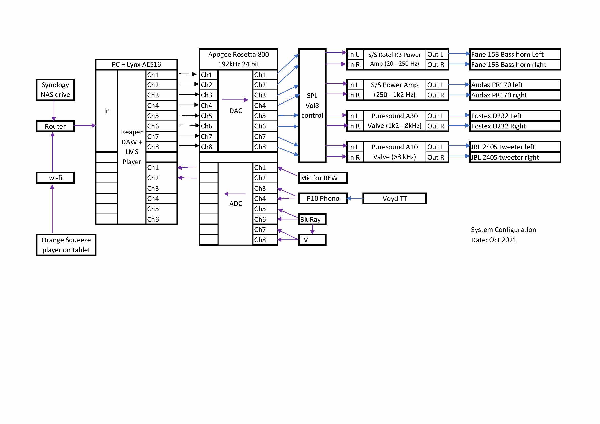

One of my friends lent me a Rotel power amp to try instead of one of Nobsound amps - it works really well, so I managed to find one on Ebay, just waiting for it to arrive.
Here is latest set up, I'll take some photos at the weekend in the light.

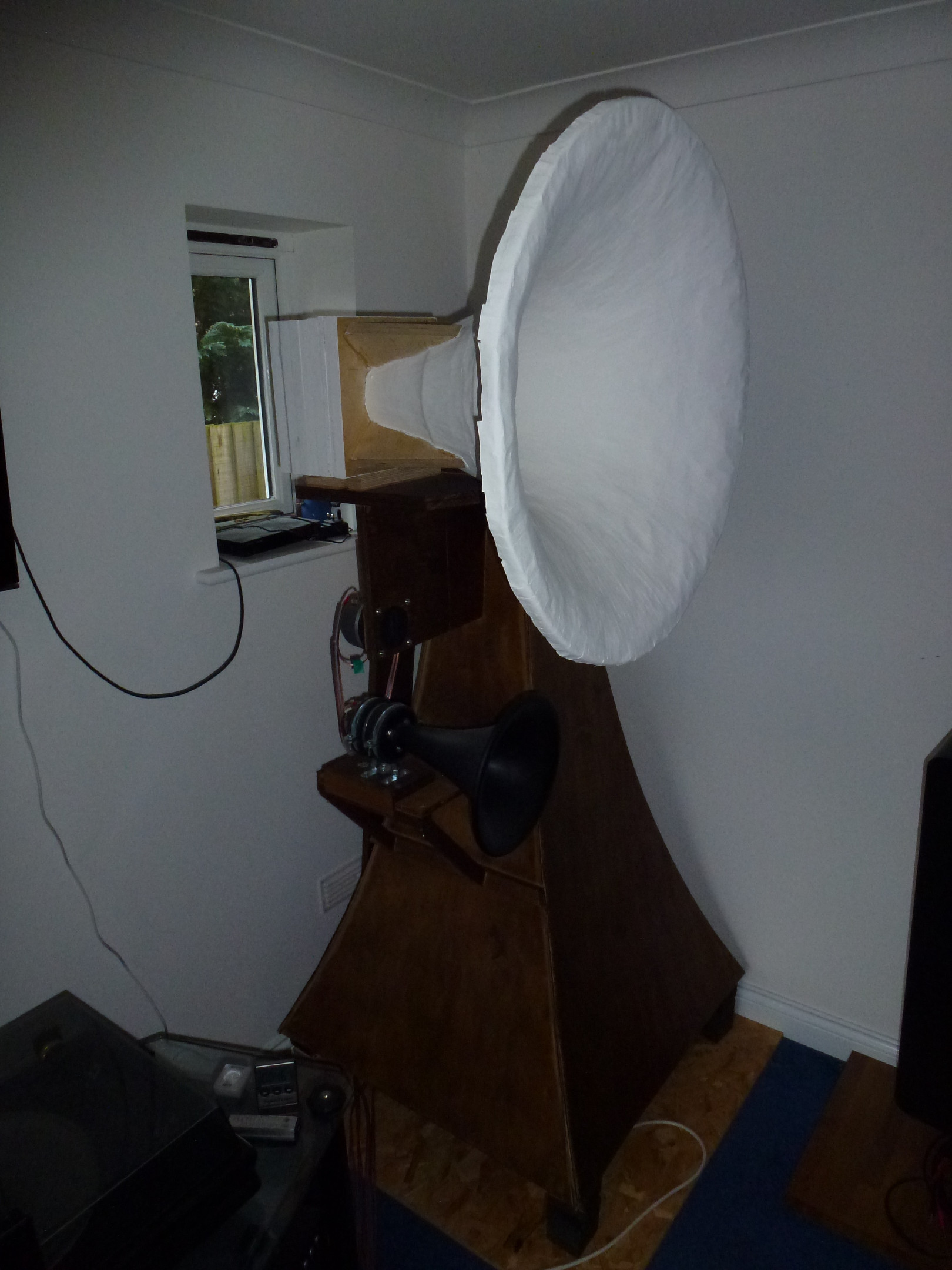

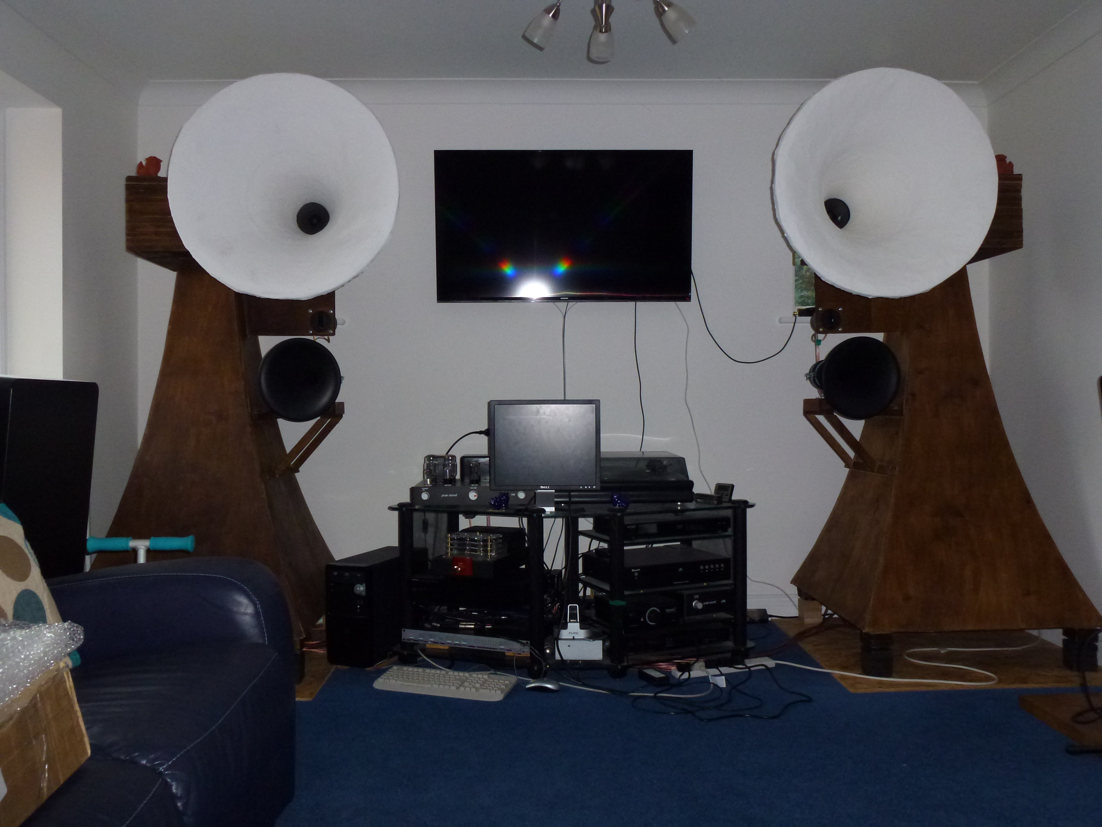

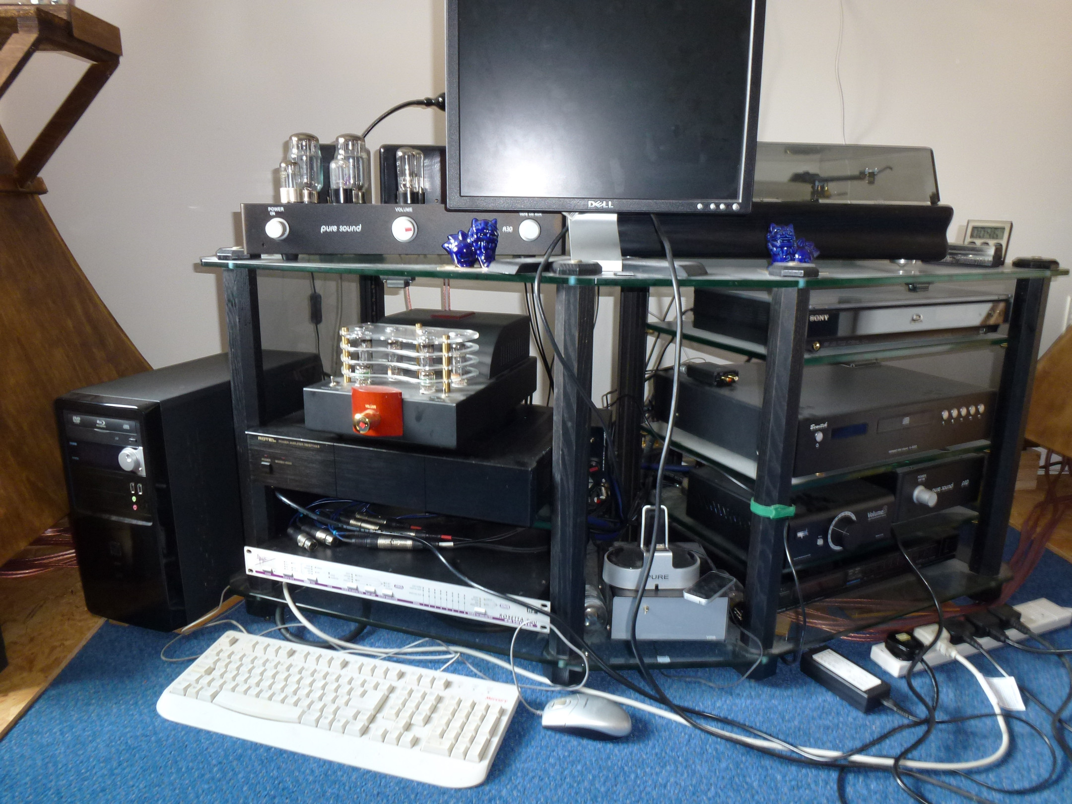

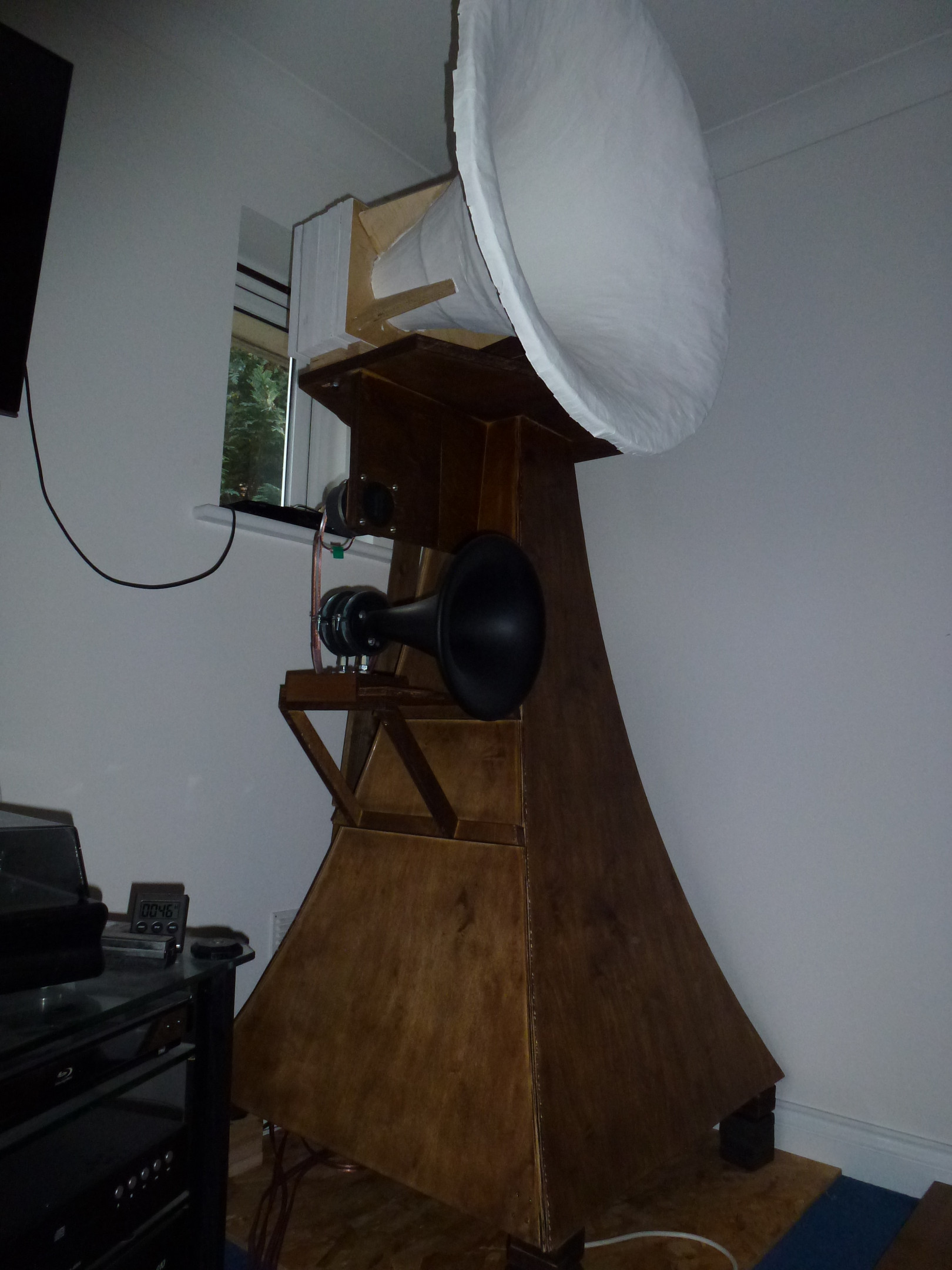

Hi Dean,
as promised a few photos
1 - from listening position
2 - PC, Apogee, Amps, etc
3 & 4 - 4 way horns.
If you have any questions, just ask
Regards Barry

Compromise ?
Ideally the midbass would be horizontal, but I don't have the space in my room for this.
With it vertical it is also useful to fasten the other horns to.
I targeted 50 Hz, but knew corner loading would help and there was always the possibility of adding a subwoofer or two.
I'm happy with the sound, I sit ~ 6m away so the drivers have distance to integrate.
I started with Snell Type K and Audio Innovation series 300 (10W class A) and have nearly always had valves, so I tend not to have chest thumping bass.
I keep looking at K402 horn and at some stage I may make something to replace the white paper horn & black horn.
Well, first of all, I can use a better DAC than what is inside the Minidsp. The Minidsp is handy when designing crossover but should not be a permanent solution. The DSP filters decreases the resolution of the sound, and the power supply is noisy.
You could try running the DSP with different power supplies.
It takes 5-24V, so there are plenty of options.
In my experience:
- plugged into a PC, it is noisy
- plugged into any independent supply (e.g. a leftover from a dead laptop), it is just fine
- plugged into a battery, it is also fine
I've used a mini DSP on a battery powered horn rig outdoors, with 12V (car) and 18v (power tool) batteries, and it worked well.
For people worried about resolution, but wanting to stick to a budget, you can could use the mini DSP in a hybrid form.
e.g. use the DSP for crossover, eq and delay for the LF drivers, and analogue for everything else.
In the voice range where your hearing is most sensitive, you can maybe pick the difference between DSP and analogue filters, if your system, recordings, ears and attention levels are all on point.
...but I doubt anyone would be able to pick the difference at 40Hz.

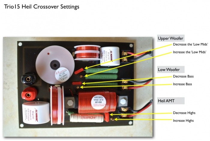

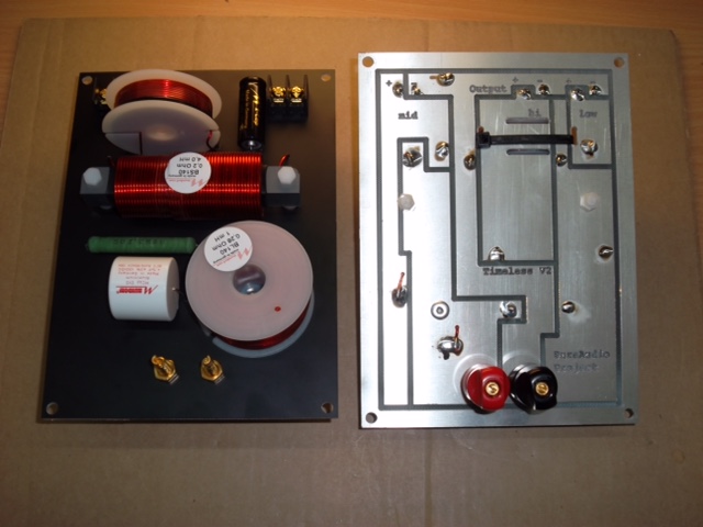

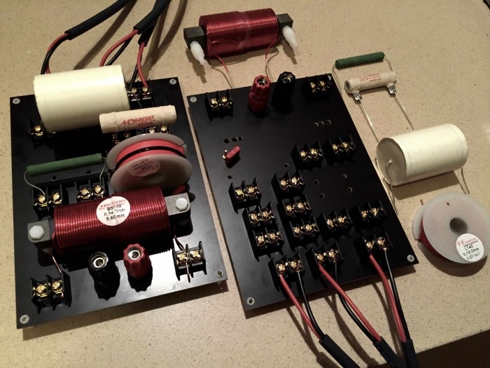

Back to the Wharfedale W70's - I have most of what I need to do it , I just need a couple more caps and the game will be A-foot , I plan on trying a good Dayton audio Polypropylene Cap which I have already purchase... and then trying a Russian POI Capacitor too, if one sounds much better then the other then that's the one I'll use. But if both sound good , I am going to figure out a way to toggle between them or maybe - build the crossover board on the back so you can just exchange the caps like the - " Leonidas " Crossover Boards that they developed over at Pure Audio Project - here are a couple of pictures of the way they built them below. The main idea is that each element can easily be changed out in the crossover to dial in the exact voicing that you want, granted this is much easier if you are using a relatively simple crossover like they were - but the crossover in the w70 is simple too so it will work out well if I go that route.
- I could buy better caps but this is mostly a experiment for me to see how much I can improve the sound of a Vintage Wharfedale Speaker , if it goes well with the W70's - then I may move on to Replicating their top of their line the SFB3 Open Baffle Speaker...... but unless I find a very well informed buyer most will not want to pay much over the price of other w70s that may be out there - (even with my fancy sales pitch) - so I can't go too crazy on big buck capacitors - LOL

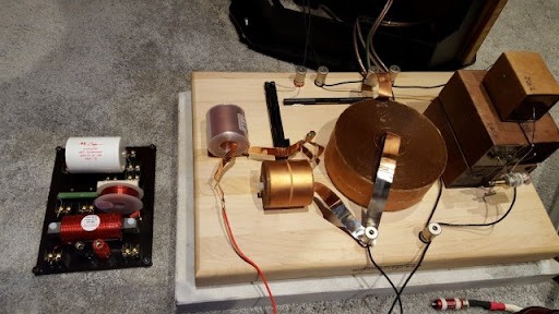

-- here are a couple of pictures of different Leonidas crossovers
This last example below is a major upgrade to the parts in the original crossover - LOL ...... there are $2,400.00 worth of High End Parts on this board, Stacked Copper and Wax Capacitors........ etc. - The cool thing is that since the guy already had dialed in the original Xover - with this design he could make the Speaker even more transparent by just physically attaching the leads from each of the parts to each other , no extra wires and no solder - He said it made a significant upgrade to the overall transparency of the speaker by doing away with the solder joints.

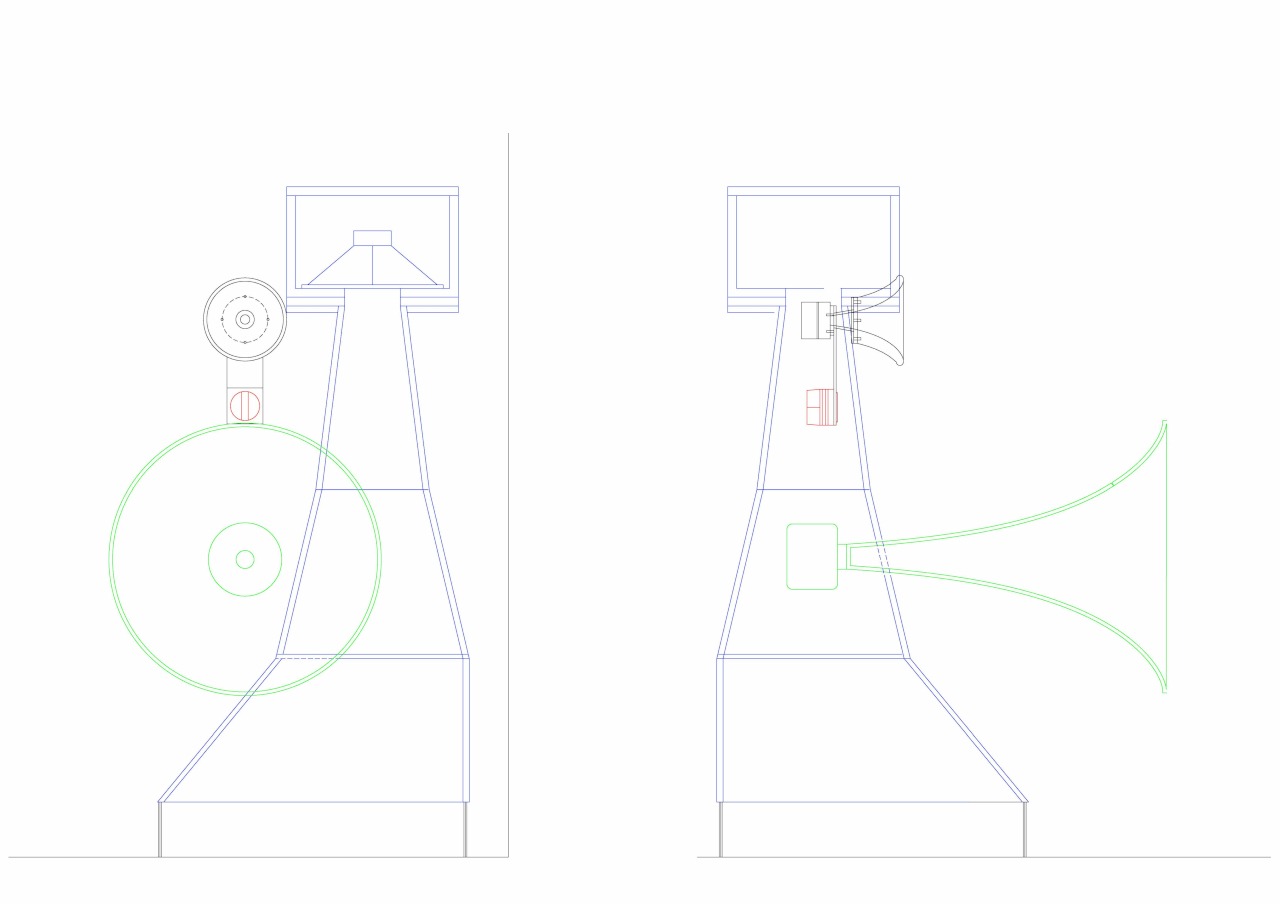

With the mid bass design as I have it, I was advised in the early days to limit the vertical horn to a max of 250 Hz,. In particular, I was warned about male vocals not coming from the vertical horn. By using a corner horn, such as the Olson one, there is not this limitation and there are more drivers available to work from 600 / 700 upwards and the horn is smaller. Attached image was an idea to reduce the overall footprint, but I decided the woodwork was too complicated 🙂
