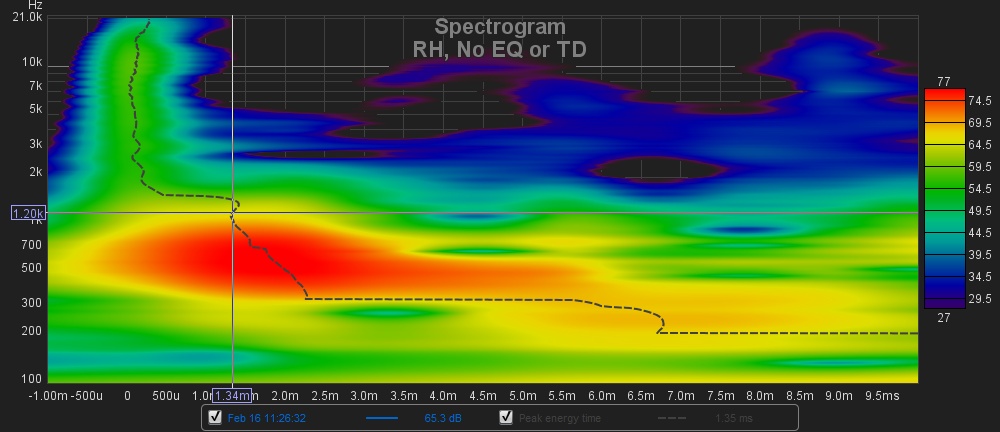

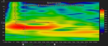

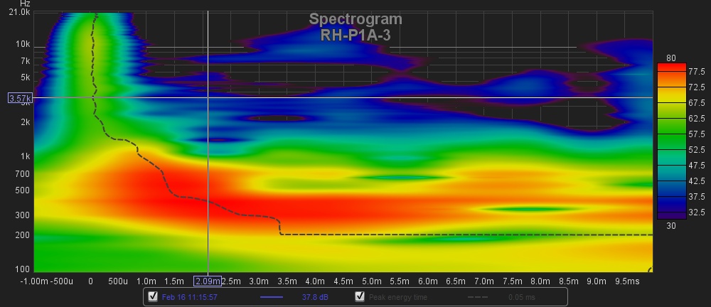

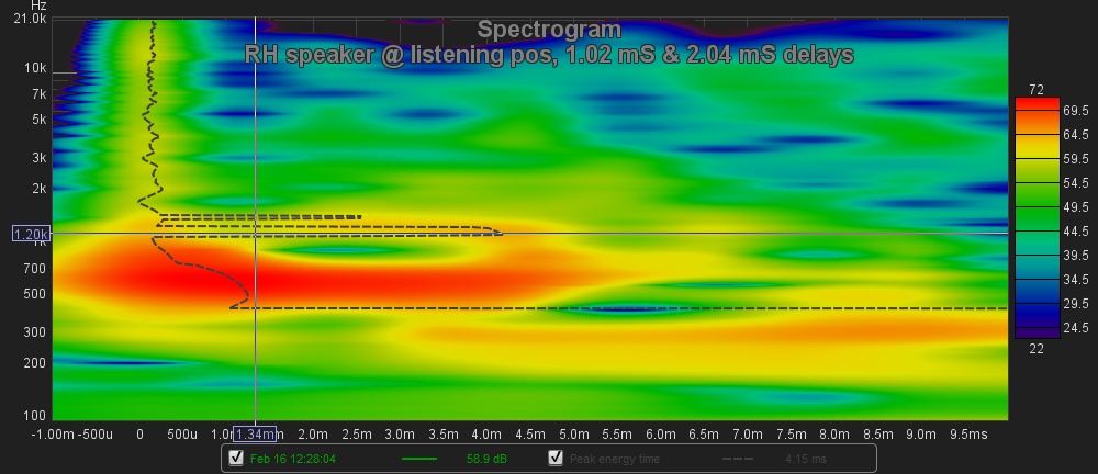

Here are photos of some recent REW measures.
I started measuring on axis with JBL2405 @ 1.3m, then moved to 2.6m, then to listening position. You can see crossover points @ 249 Hz, 1190 Hz. I then applied a couple of time delays in Behringer. I don't know why there are a couple of extra peaks @ 1.2 & 1.4 kHz.Comments / suggestions welcome on how to proceed.
