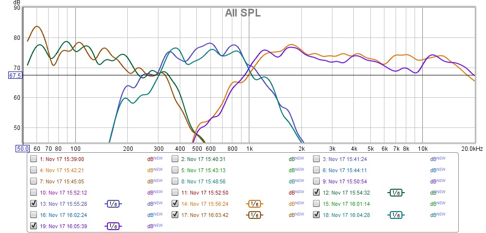

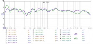

Here are 3 measurements taken using REW. 250, 300 & 400 Hz crossover. You can see the output from the horn naturally tailing off @ 300 Hz (even with the crossover set to 400 Hz :- 250-400_Xover.jpg - Google Drive
All measurements taken at listening position, which is approx 4m from the loudspeaker IMAG1652.jpg - Google Drive

50 - 20 kHz
Due to the sound changing from where they are to when they are moved into the room corners, my plan is to build the second one, put them in place and then optimise them. I think if I adjust the speaker with it in the middle of the room, I may be wasting my time because I'll have to do it again when it's in the corner - comments welcome. 🙂
Drivers & crossover points.
Fane 15B Vertical Horn up to 250 Hz;
Audax PR170 white horn = 250 Hz to 1k2 Hz;
Fostex D232 black horn = 1k2 Hz to 8k0 Hz
JBL 2405 = > 8k0 Hz.
Here's the frequency response from 50 - 20 kHz 50-20k_ungated-response.jpg - Google Drive

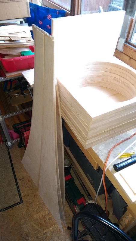

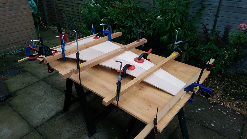

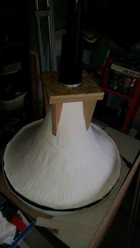

Hi, I've been able to do a bit of work on the second speaker. Pictures of clamping / forming arrangement to vertical pieces; vertical horn pieces including driver box and papier mache horn.
I'm still limited with what I can do, no heavy lifting, so will need to rope some friends in soon to assist.

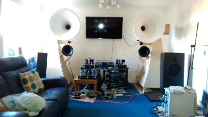

2 speakers built
Hi Dean, fully understand why you went missing. Sorry to hear re - cancer - chemo - radio, etc sounds bad news, what's the prognosis? hope it's good news. Have you been able to do anything with your build?
I've now got 2 speakers, one in each room corner & I've been messing around with crossover points, slopes, etc. 🙂
Here's latest measurement from listening position.

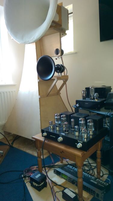

2 speakers built
View from listening position & close up of horn & amps.
Need to sort out alternative to Behringer, etc. all suggestions welcome. 😕
Originally I was going to use Nadja, but not now possible. Sources - vinyl, cd & Hard drive.
