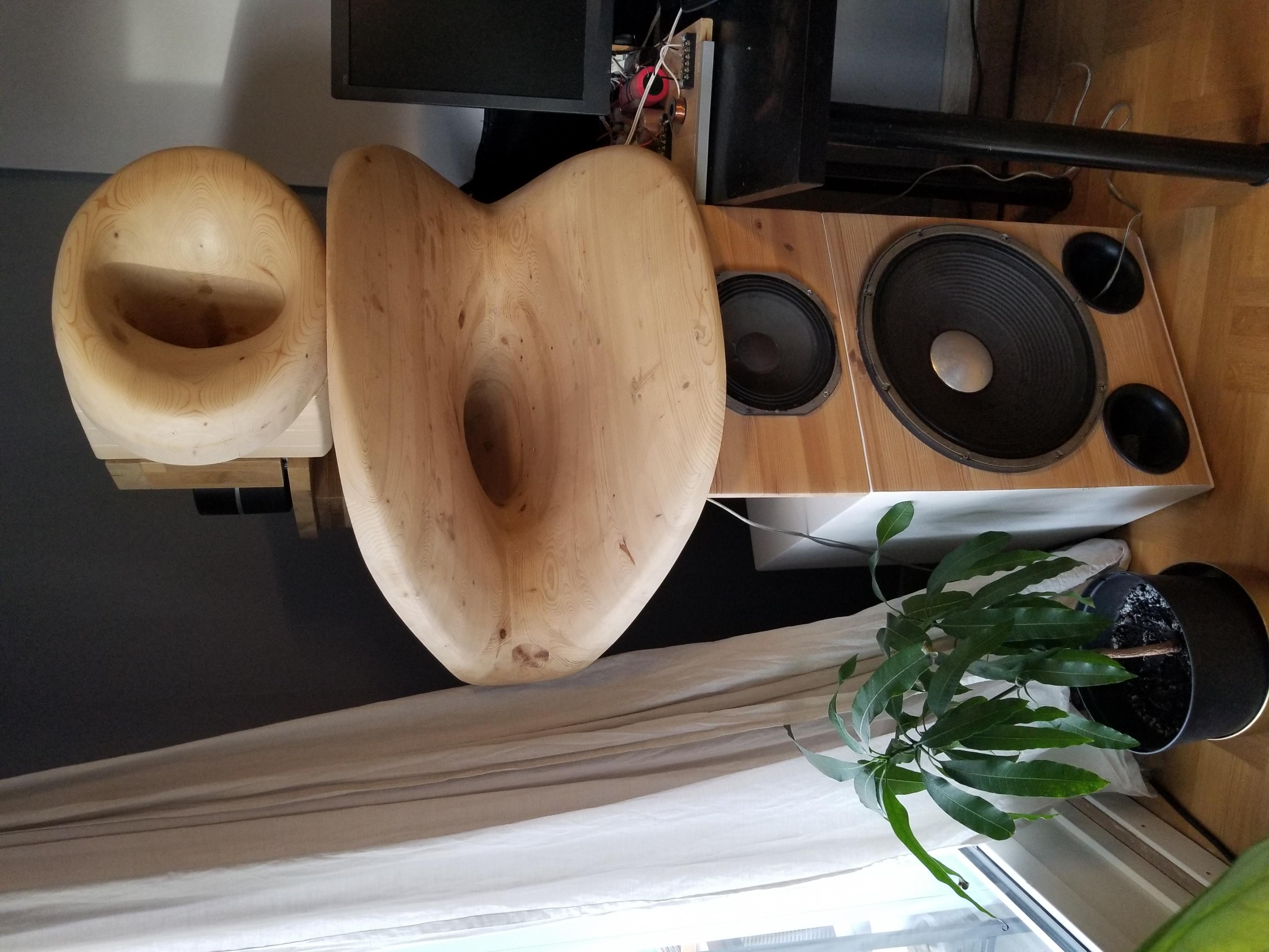

Very cool! How is the white mid horn constructed? I have to say I'm a bit confused on the bass horns in these designs. With the mouth so small, it doesn't seem to cover a very wide bandwidth to be worth all the trouble. From 250hz down to what? Do you eq to boost below that? Separate subwoofer?
White horn (250 - 1k) is made from layers of papier mache (Inlow Sound).
The vertical horn has a 15" driver and I'm aiming for 50Hz when it's placed in the room corner, I'll then need to raise the height of the mouth opening.
No EQ presently, but may be necesarry in the future.
Below is the initial design in Hornresp
Initially, the bass horn was going to be horizontal, but it came too far into the room. Turning it vertical takes up less room & it acts a frame to put the other drivers + horns on. My listening room is 20' x 14' and I listen down the room.

Well, I can share what I use: Lab12 Sealed 34L subwoofer 30Hz-80Hz, ported JBL K140 from 80-440Hz, Yamaha Ja6681B compression driver from 440Hz to 2000Hz in an JMLC IWATA 220Hz. RAAL in a big wooden horn from 2000Hz-20kHz. I will add a second channel as soon as I am done sculpting the horn, from 1400Hz - maybe 3000Hz, to use a smaller horn for RAAL. We will see what I end up preferring. I also have built two midbass horns with JBL 2220A (90-440Hz) that is waiting in the stable for approval from the Mrs.
For the two upper horns I currently use a Firstwatt F5 with a 2-way passive 2nd order crossover. I like it better than my Chinese 2A3 5 watt tube amp. Actually the 5 watt tube amp sound better with the 15" JBL drivers, but the JBL can play the 50Hz mains hum very vividly, something I will need to address eventually, probably with a Firstwatt F6.
I use a minidsp 4x10HD to divide the sub and the midwoofer and the two horns. I am looking to replace the minidsp with an LXmini inspired analog active crossover, but I am not sure it is suitable for a 3-way or a 4-way.
The Fane 8M is not in use, just a failed experminent. I though I needed something between the K140 and the horn, but the aluminum dust cap extends it well above 440Hz.

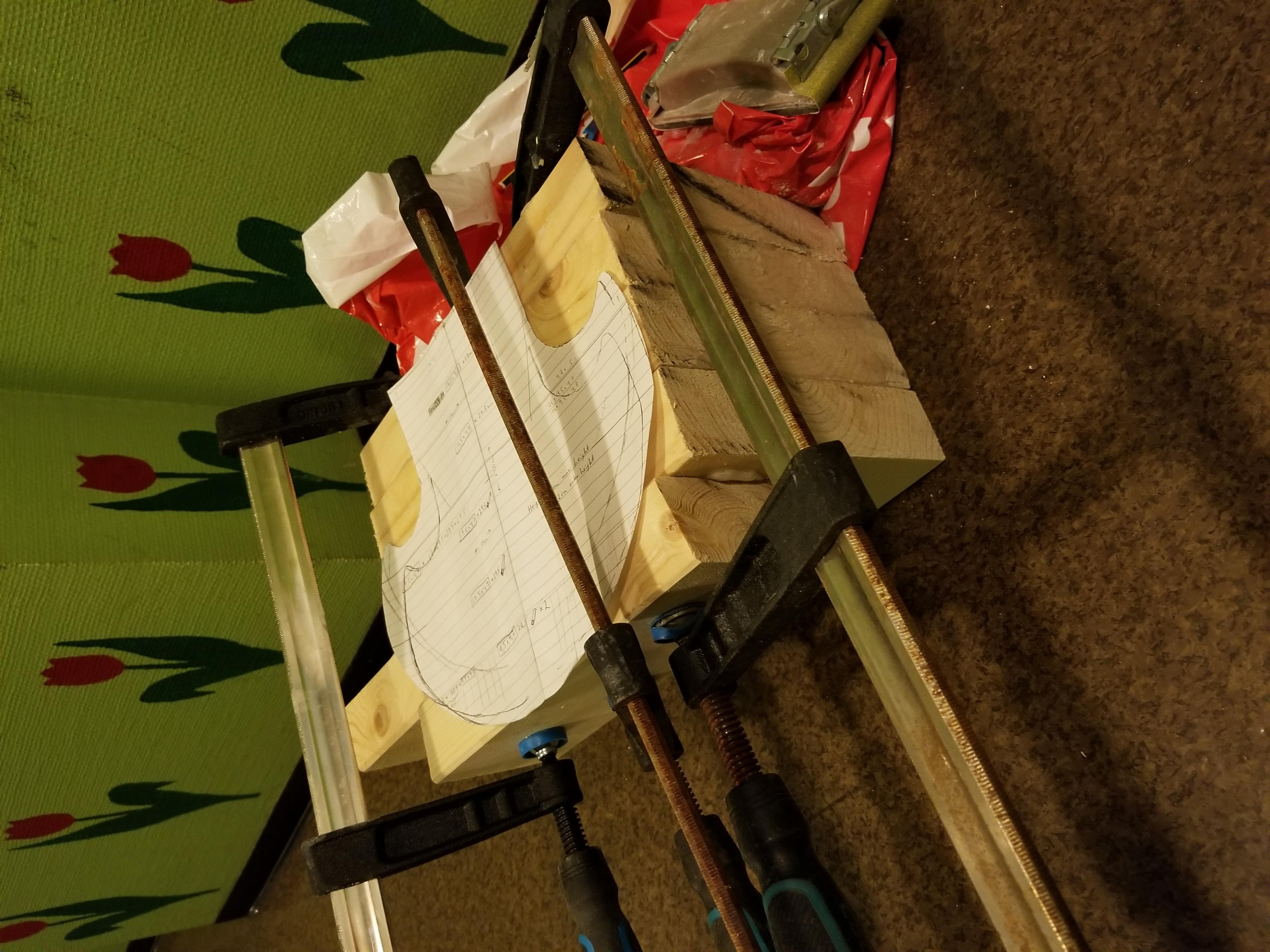

I start with cutting out the shapes on paper and then glue thick planks together and start sawing and chopping with a viking axe. Really quite therapeutic. 😛 For the large midrange horn I did not have access to JMLC calculations so I had to use pictures and dimensions I found of it on in a blog. I also changed it to a J-shape for increased WAF, so I took sections of a straight horn and placed them in angles. It might be wrong to call it a JMLC horn, but it is pretty close. The top horn I will store away soon when I add the second compression driver horns.

I don't know the difference in sound quality between horizontal or vertical. Due to space constraints, I can't fire it horizontally, so don't want to potentially upset myself by trying it that way 😀
The three horizontal drivers are physically time aligned and there is the facility within Behringer DCX2496 to time delay drivers. Behringer is a temporary device which I originally planned to use to derive crossover points and slopes. But after building the horns & measuring them (admittedly this was in the middle of the room where it currently resides), there is too much of an overlap between the drivers and so I need steeper slopes (currently playing LR24) which would make an analogue circuit outside of my ability to make.
I've seen crossovers such as Pioneer SF700, these don't offer time delay.
I was advised that the Behringer unit had limitations as far as ultimate sound performance but been pleasantly surprised, especially as it was £135 second hand. In addition, I've been reading about PC software to allow room correction + linear phase crossover filters and would like to explore PC sound cards, etc. further that can deal with 4 drivers / side and perhaps use JRiver DSP + RePhase.

Hi Rewind, thank you for sharing your horn build! Very Nice horns! I can't believe you carved those horns freehand - with an ax, that's amazing. I hope that your Mrs. lets your mid-Bass horns join the fun - 🙂
Hi Barry, my bad , I read your post very quickly yesterday and didn't see your name - 😱
- Also after taking some more time to look more closely at your pictures and study your horns , they are even more awesome than i first thought !!!
- I do have some questions , i can't make my brain work today - I couldn't figure out from your post - what are " notional " crossovers ?
- I was also wondering what are the drivers you are using? - (besides the Fane Crescendo 15B in the large vertical horn). Thank you, Dean

Hi Dean, no worries, thanks for the kind words.
By "notional" crossover I mean not set in stone. Once the speaker is installed in the room corner & re-measured the crossover points and slopes may change.
Drivers - Tweeter - JBL 2405 compression driver; Fostex D232 compression driver into black horn from Stereolab (Germany), Audax PR170 paper cone driver into white horn.
All of the wood is Birch plywood.
The vertical horn is made of 4mm laminated & formed pieces. I decided with my limited woodworking skills it was easier to laminate and bend pieces into the 4 sides and screw them together as opposed to having a stepped horn, similar to Tune Anima. The driver chamber is made of layers of 1" ply with circular holes for the drive chamber.
