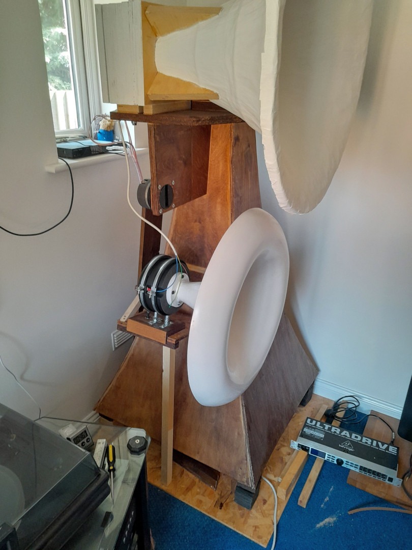

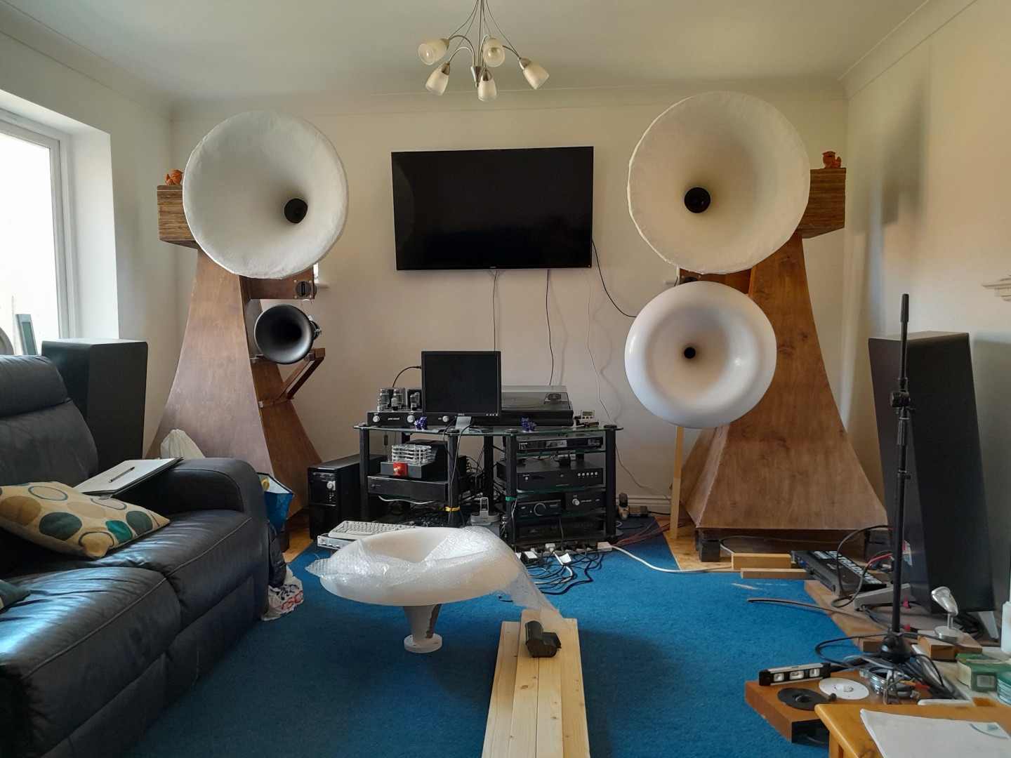

Finally managed to get some free time, to do a bit of woodworking & install one Celstion unit
[second fibre glass horn needs some repair work before I use it].
Due to analog inputs not working on Apogee Rosetta, I've put Behringer DCX2496 back into service.
RH, all on LR24
[?]-250Hz via Fane Crescendo 15"
250Hz-1kHz via Audax PR170
1kHz-20kHz via Celestion axi2050
LH
1kHz-8kHz via Fostex D232
8kHz JBL 2405 [using a capacitor, due to only 3 stereo outputs on Behringer].
We're looking after a nervous dog, so no measuring yet, but sounds ok so far.

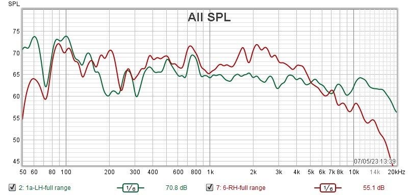

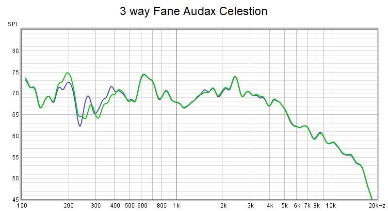

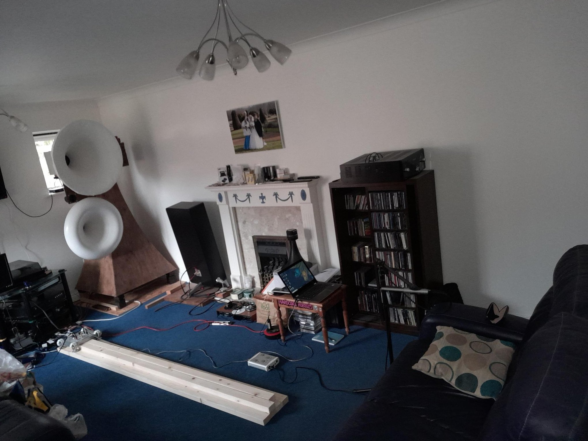

Finally managed to do an initial measure to set relative driver levels. Microphone is approx in the listening position, which is approx 4m (13 feet) from horn mouth and centred between both horns. All with 1/6 smoothing.
RH 3 way measure (Fane 15" phase inverted - green / blue)
LH 4 way measure - this caused me to look at the phase of Fane & invert it.
Then we have a comparison of 3way v 4 way.
All comments welcome.
Reactions: 1 user
Yes, at least 1 and 2, because supertweeters can interact with the midrange in a negative way.
And measure at different locations as room modes can play some tricks on you. Dirac Live asked me to do eight measurements around listening position. Also, if you sit with a cocrete wall behind the sofa this will can add some boomy peaks in the bass.

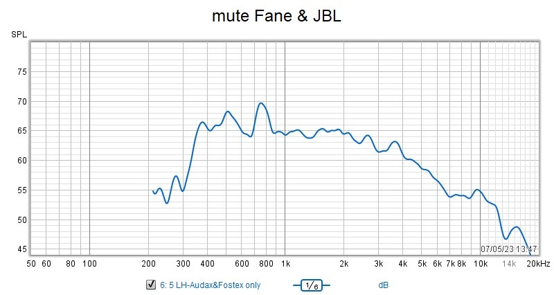

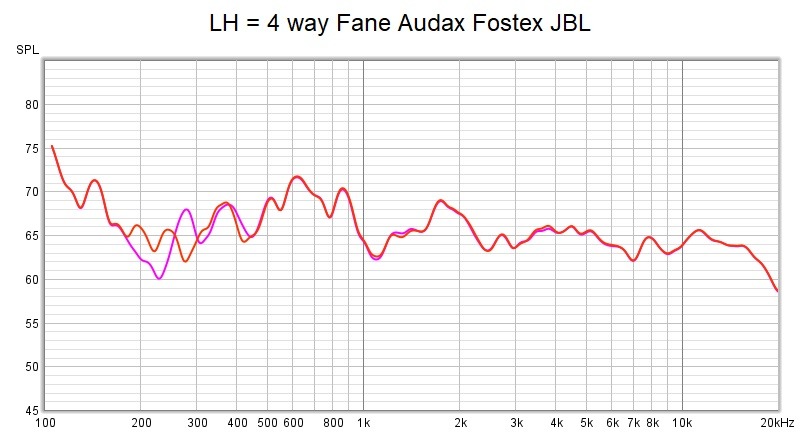

Here's a few more measurements from practically the same spot as yesterdays.
LH = 4 way; RH = 3 way all drivers playing.

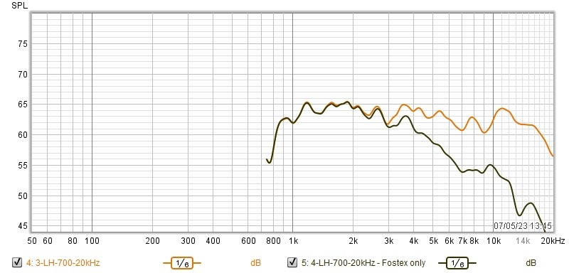

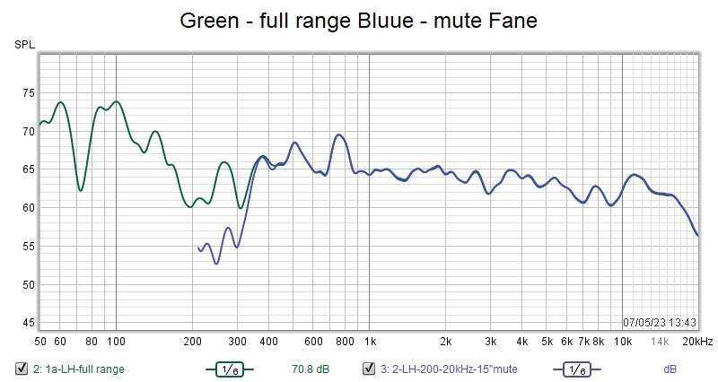

LH 4 way speaker - Green trace all drivers, blue trace is addax, fostex & jbl playing.
Then we mute Fane & Audax, leaving Fostex & jbl playing.
Then mute Fane 15" & JBL 2405, leaving Audax & Fostex playing.
Reactions: 1 user
I think it's fair to say that Celestion axi2050 needs help in my application at higher frequencies. I may even struggle getting it to meet jbl 2405 @ 7 / 8kHz

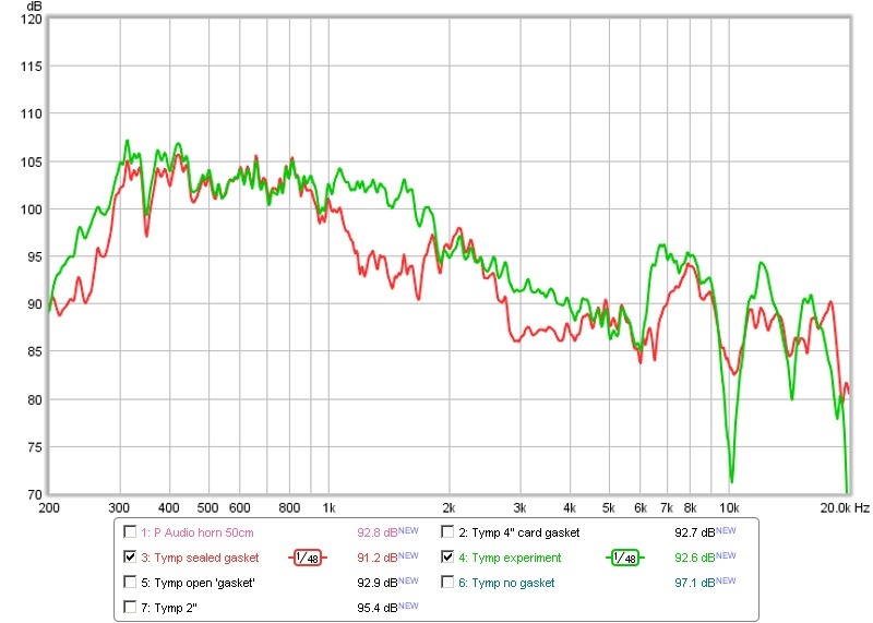

The peak at 800Hz doesn’t seem to want to go away. Something inherent with the Audax driver?
I tried lots of drivers including something very similar - I found a Chinese driver that is an obvious clone of the Audax, and liked it so much I bought ten.
I didn't find any inherent issues with putting them on a horn. I eventually went with a more modern 5" driver not because it is any flatter, but because it has a wider bandwidth on the same horn (allowing a 2kHz cross to the tweeter).
Sometimes, free "hacks" can fix or minimise horn+driver problems (measure before and after),
  • Intentionally introduce some asymmetry, e.g. mount the driver slightly off centre, or stick a bit of foam in one side of the fhroat.
  • try different mounting methods / gaskets.
The attached image is an example, it shows a 4" driver (NE123W-08) on a 2" throat horn
from this thread: https://www.diyaudio.com/community/threads/paper-cone-open-frame-driver-for-front-horn.275899/page-2
The bad plot is the NE123 mounted with a normal (airtight) gasket. The good plot is a leaky gasket (a ring cut out of a double walled cardboard box - so air can leak through the corrugations).
The leaky gasket has nearly an extra octave of flat response. That is an unusually good (lucky) improvement. Most tweaks (or driver swaps) give relatively small changes.
