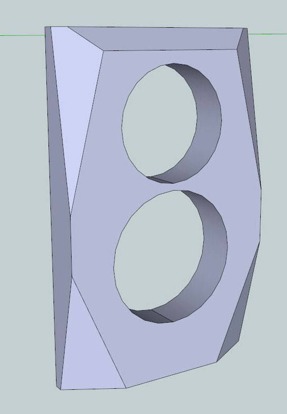

I've never seen a corner horn with canted baffle. I guess the alternative to that would be sloping floor and ceiling? : )
Is that the same principle being looked at where you see baffles with faceting on the side (vertical) edges?

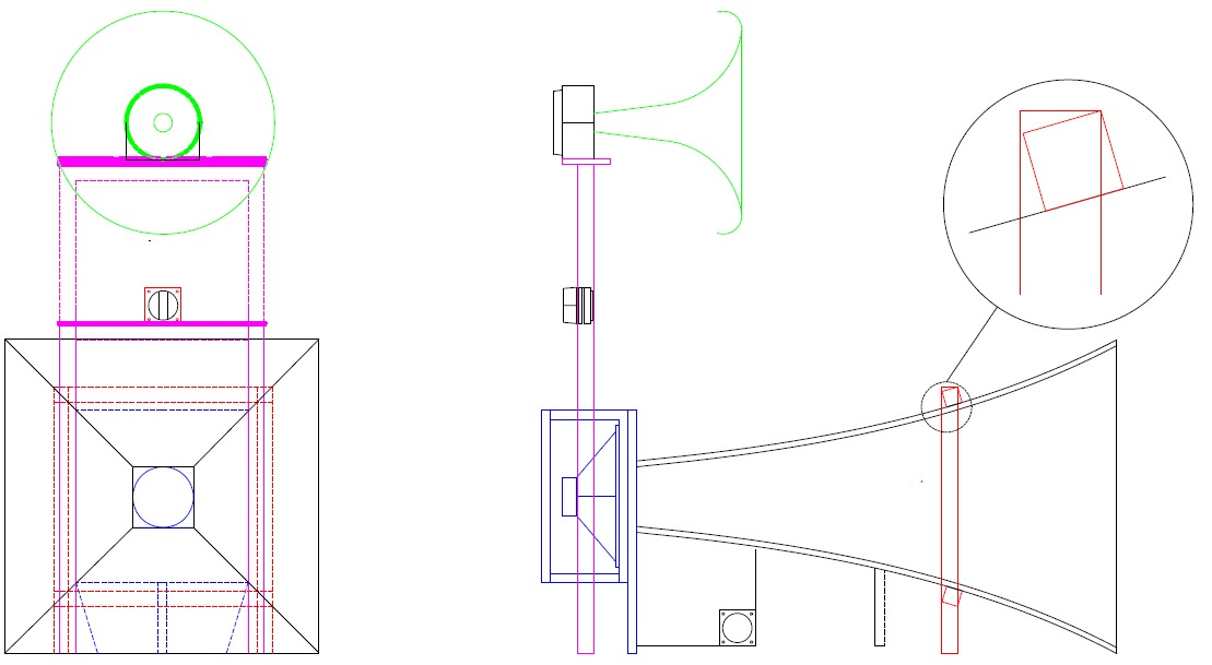

Following some input from people with far more knowledge than I have on horns, I'm considering changing the main horn from vertical and would appreciate feedback.
This potentially can allow me to simplify from 4 way to 3 way. I'll aim to use Celestion axi2050 c/w LeCleach horn and JBL 2405 as shown in the drawing.
I'll be looking to crossover to Celestion @ 500 Hz & JBL 2405 @ ~ 7kHz

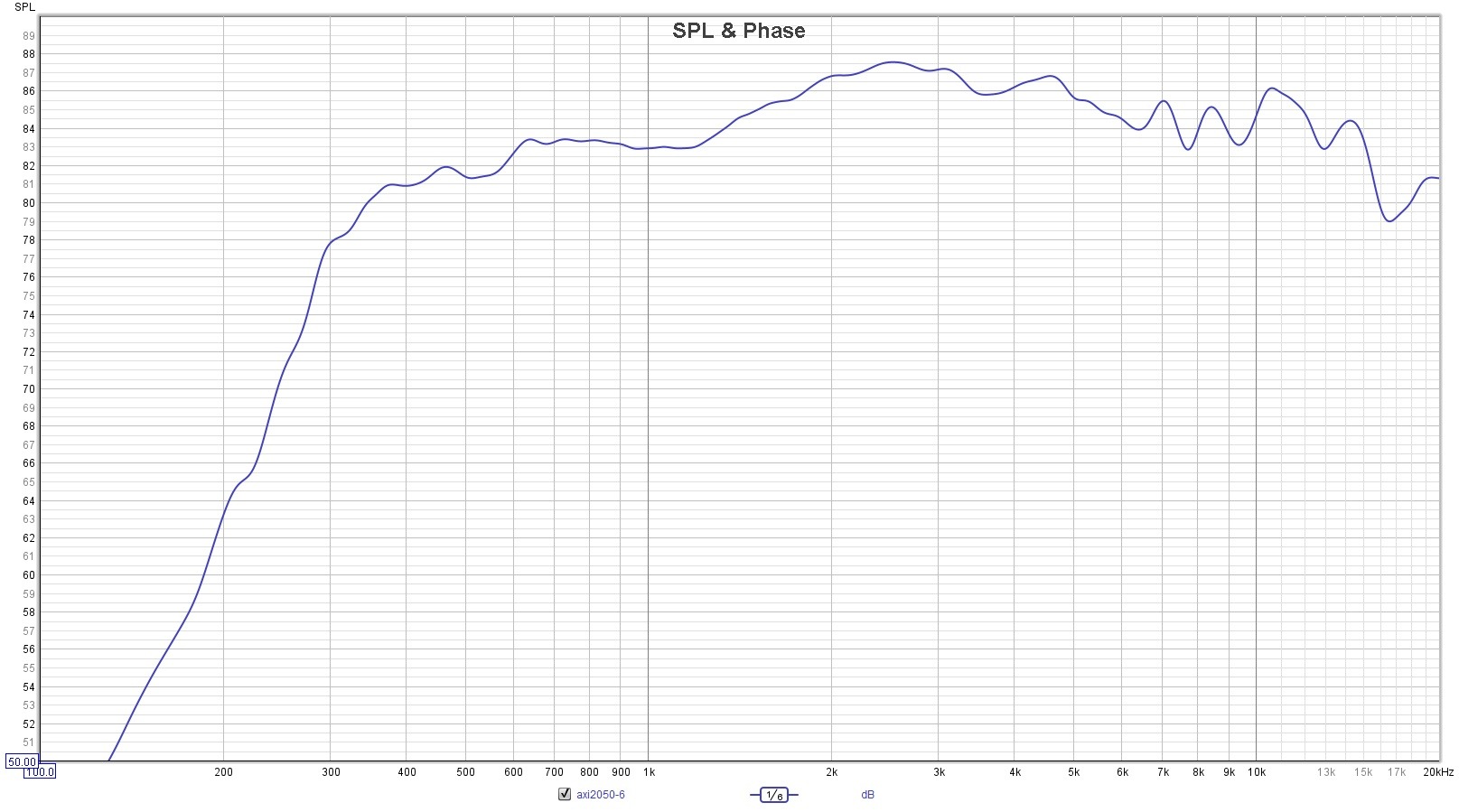

Below is a quick measure of Celestion.
If this is feasible, one itch is to go to a passive crossover, as opposed to active. Again, all comments welcome.
Rumour has it Axi2050 goes deep but not something to use as a tweeter.
Passive is fine, I like 1st order over 2nd order. I have been testing so many drivers that now I don’t care anymore. Just out cap on it and call it a day. Maybe a coil if using a tweeter.
GR research says use a tweeter that starts as low as possible. Almost down to 1000Hz would be good. It prevents problems with cancellations with the lower midrange. So maybe Ixnay on the 2405 and have a look at JMLC 1000 or similar. I Am not sure if this is applicable on horns yet, as I have not done the tests myself yet. Building a slider for ny tweeter horns to physically time align them.
I was worried about compression drivers as a whole when I first got into horns... My Axi2050 does fine as a tweeter and a midrange. I've speculated that the dry decay of the tweeter in the HF might be something unfamiliar to listeners. My measurements show it running up to 20khz so not sure what all the fuss is... in particular, lesser decays equates to higher accuracy. I listen to Jazz/Rap/Edm/Rock etc etc.... no complaints... its possible there isn't a 2" exit driver with a smoother fr above 10khz.
If the people commenting on the Axi as tweeter aren't voicing the driver in a neutral way.....what weight does their opinion hold? DSP is going to be required to level out sensitivity. So if they mean the Axi isnt the best tweeter for passive eq, or no eq.... theres probably truth in that statement

@Rewind & @camplo thanks for your comments and video link. I guess I need to put the legwork in and build, measure & listen
@AllenB aologies for not being clear. My current set up is shown in post 122
Current vertical horn covers approx 50 to 250 hz using a 15" driver. This is the horn that I'm considering turning from vertical to horizontal.
