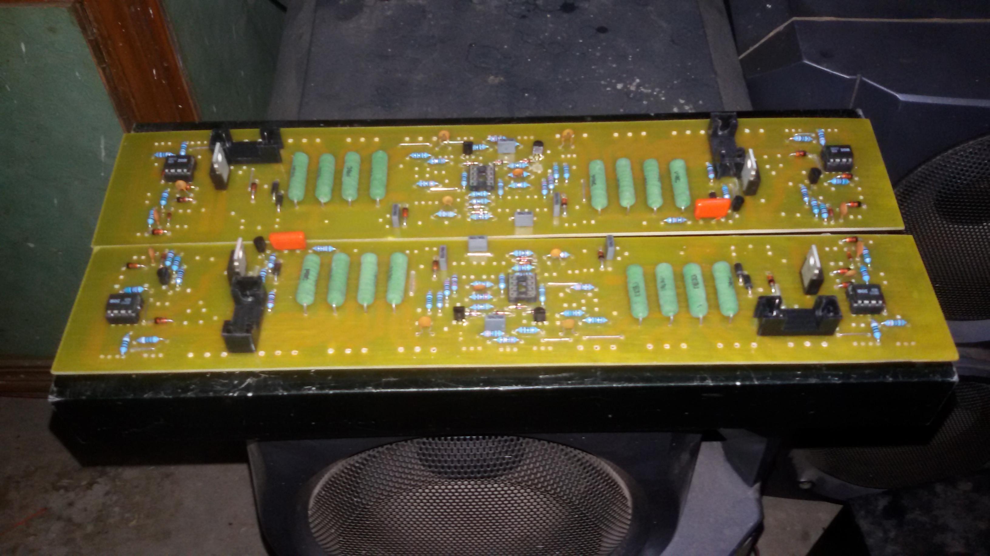

Good day to all DIYers.
Nice build BOSS2009 !!!!!!! Just a suggestion to you if you want to keep the temperature done on heatsink you should turn the module on its side. Because heat rises . If you leave the module like that shown in the photo uploaded your transistors temp will stay high.
please note its only a suggestion !!!!!!!!!!!

Thank you very much for your suggestion Audiobrad...

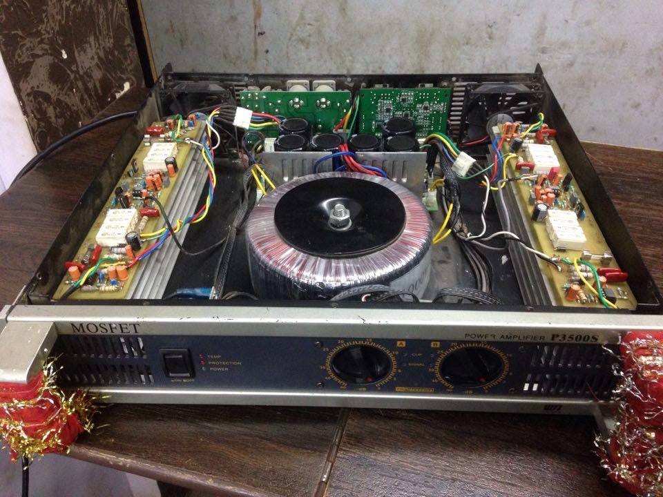

H900 in commercial amplifier whose pcbs burnt beyond repairs😉
Nice

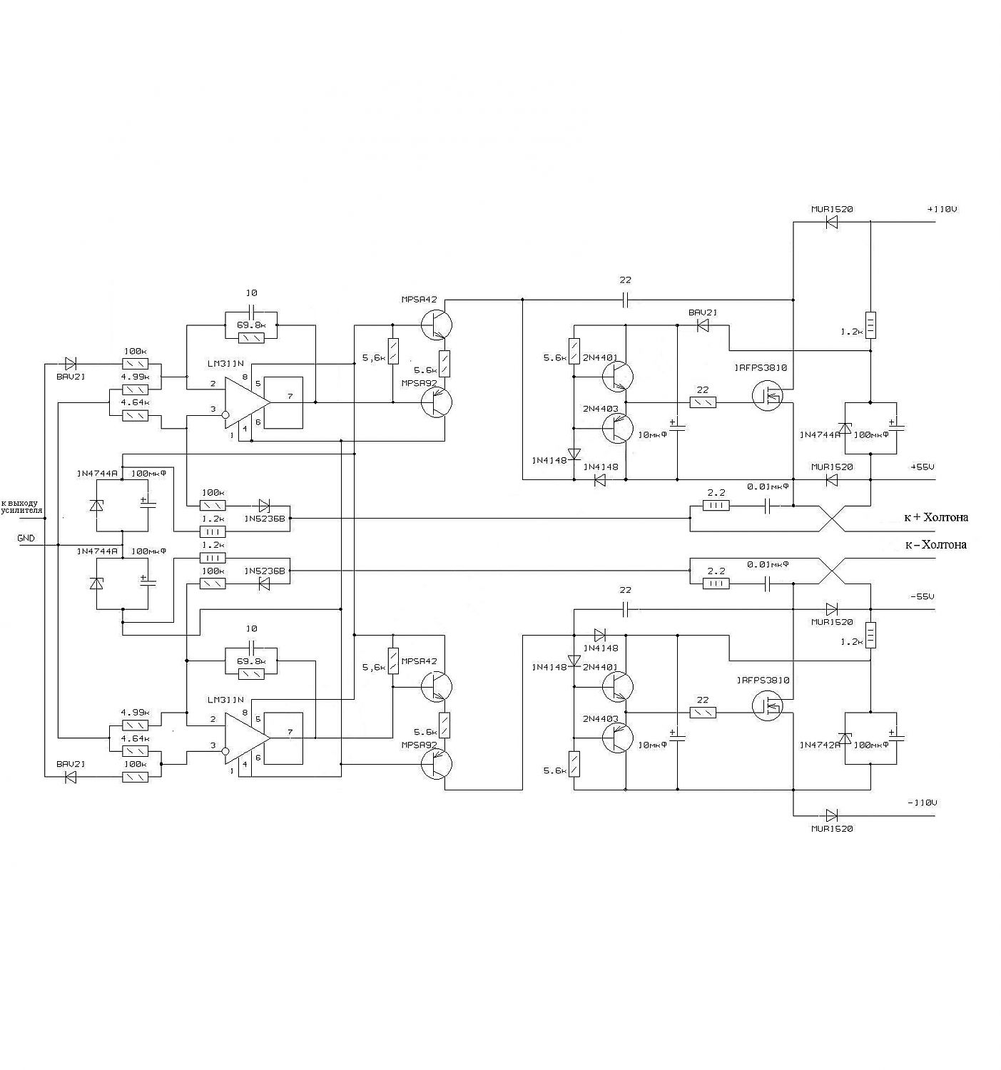

Hi all
I introduce you another version of a switching Rail H class from 900W H class amplifier.................I found this diagram on a Russian forum, VEGALAB , I hope you enjoy !
This schematic does not use expensive , obsolete or rare components, and will not pose problems when designing PCB

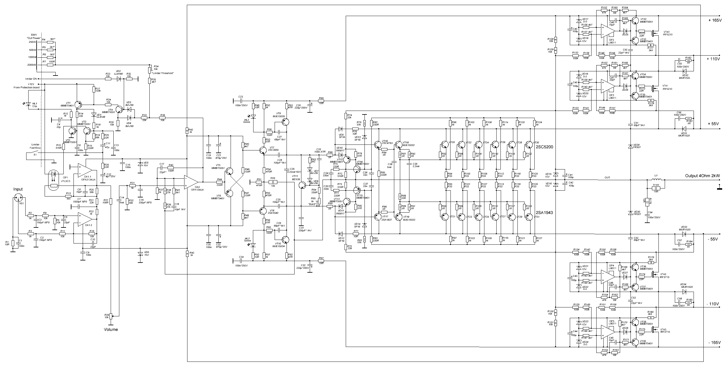

OK obviously
But why u don't tried h900 three tiered for less heat and so less weighted heatsink
And the term of heatsink size matters course we never buy airplane for distance of 5kilometers
Hahahah
A 2-step class-H produces 30% less heat than same rating class-ab and a 3-step class-H produces 45% less heat.🙂
It also helps in handling reactive loading of output stage, since the VCE across transistor reduces very much in Class-H, Hence less heat and much safer operation.

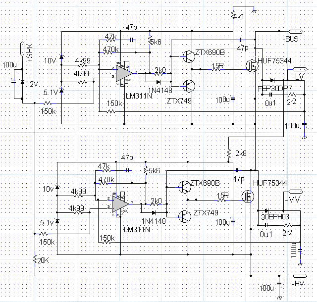

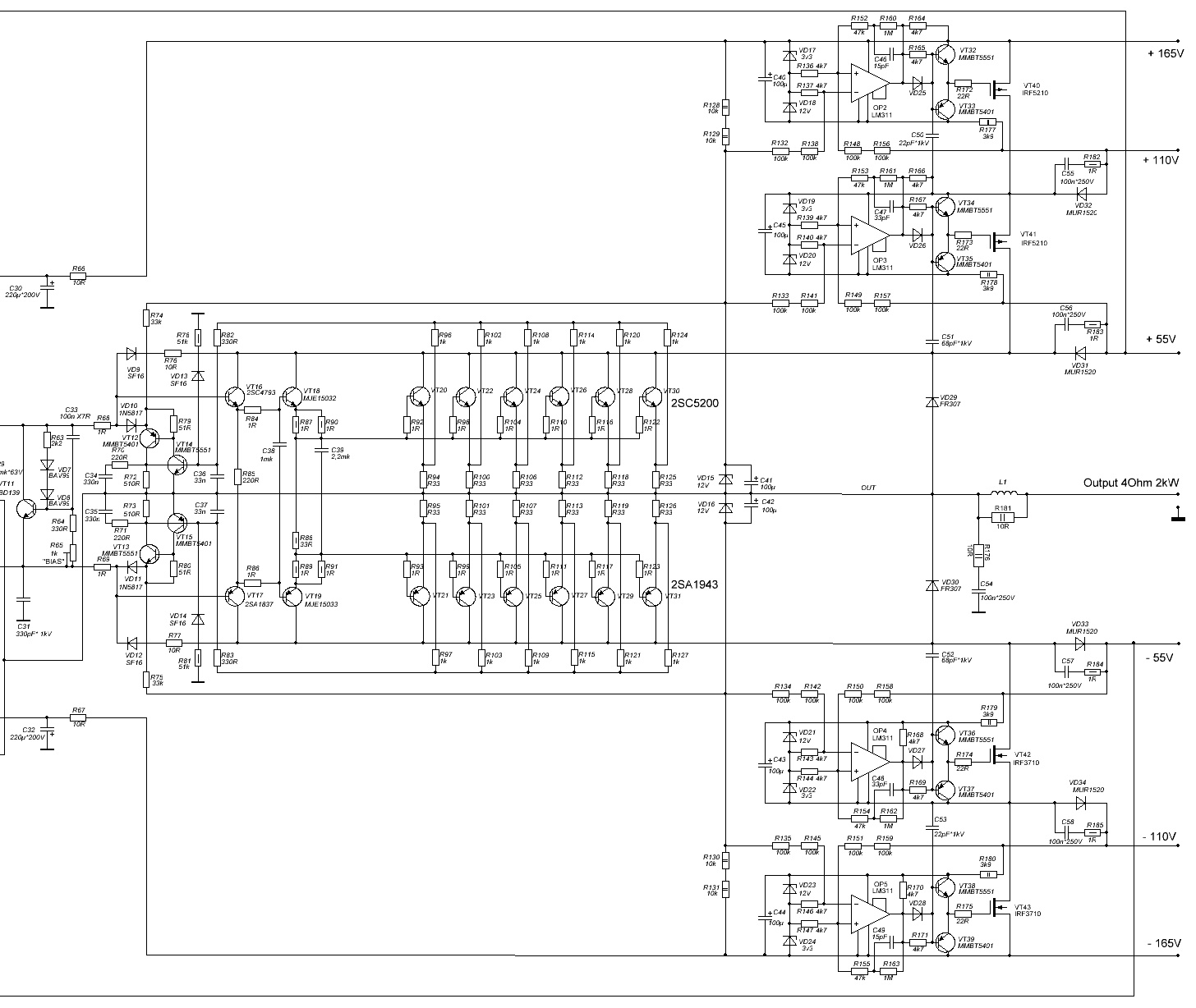

hi mr Apex please advice i wanted to make class h 3steps because of the above reasons wanted to use es1d , lm 311, irfz44 , (4pairs) c3856 , a1492 , mur860 , voltage to be used dc +135 , +90 , +45 0 -45 , -90 , -135 dc
please advice . i am even willing to use complimentary step up fets eg p channel irf5210 and n channel irf 3710 . like the below pictures
i hope to achieve to drive low impedance like 2ohms less heat and to use widely available parts like es1d , lm311 irfz44 /irf1010 , c3856 , a1492 , mur860
thanking you all in advance steve

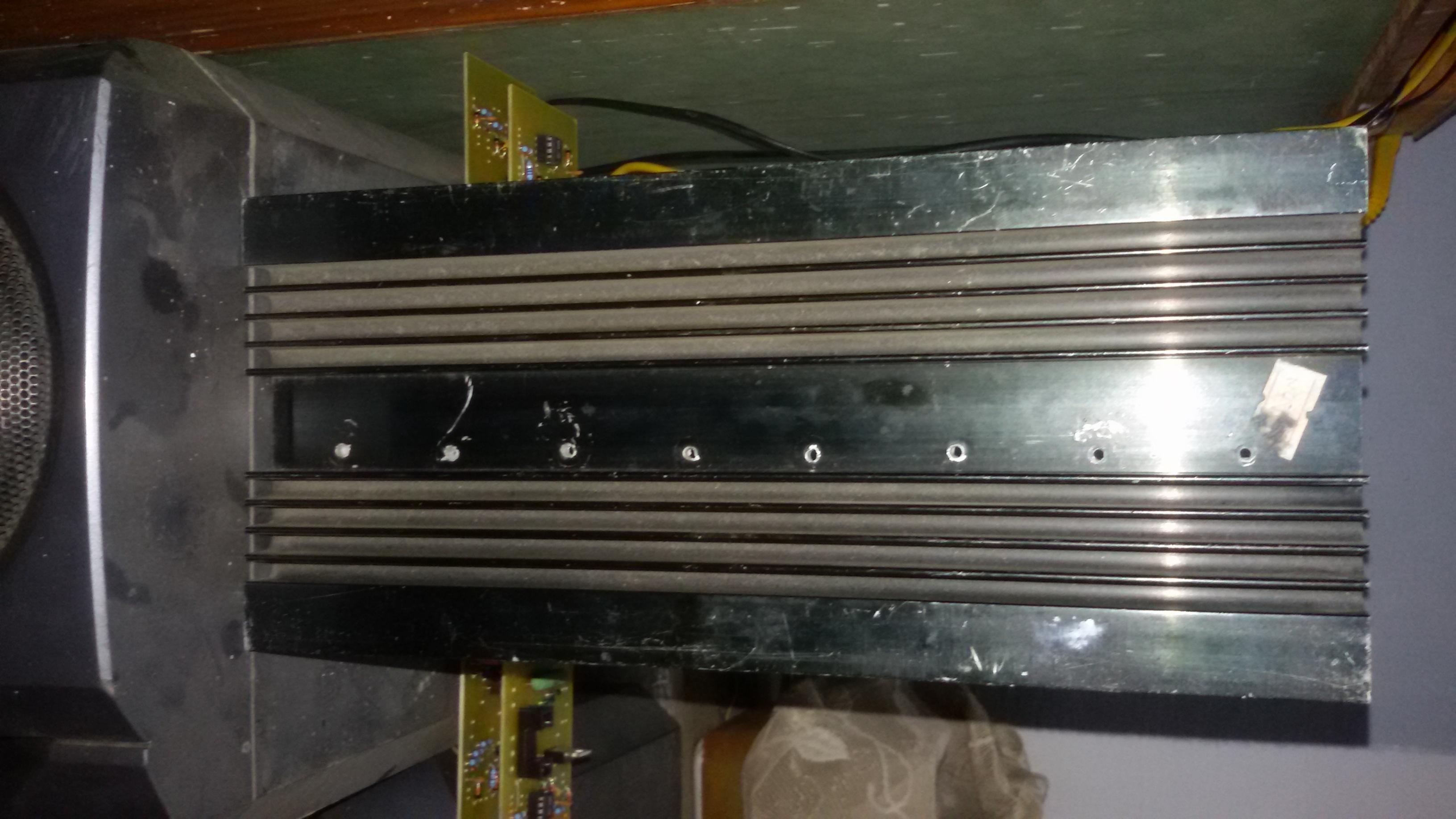

Hello sir mile.
Is this heatsink suitable for 2 H900 in bridge mode
Waight is about 1.3kg 12"x5.5"
And I'm using wire wound .33r is it okay or need to change?
How much heat will you be putting into the heatsink?
What is the Rth s-a of the heatsink?
What is the orientation of the heatsink?
Now use that information to find out the temperature of the heatsink and from there the De-rating Factor to apply to your output devices.
