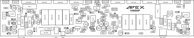

900W H-class PA Amp with Limiter

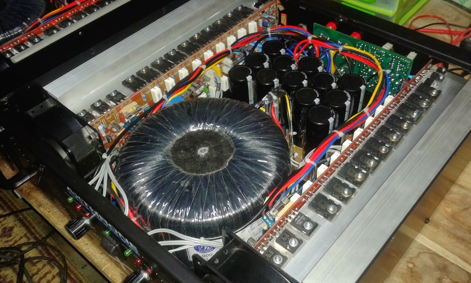

This amp class H from Indonesia...$750.

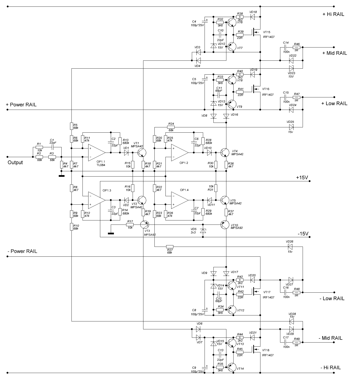

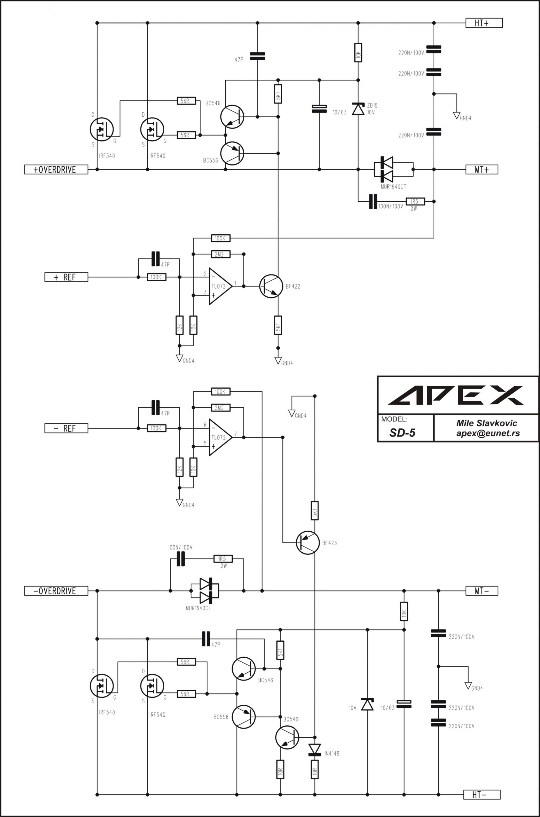

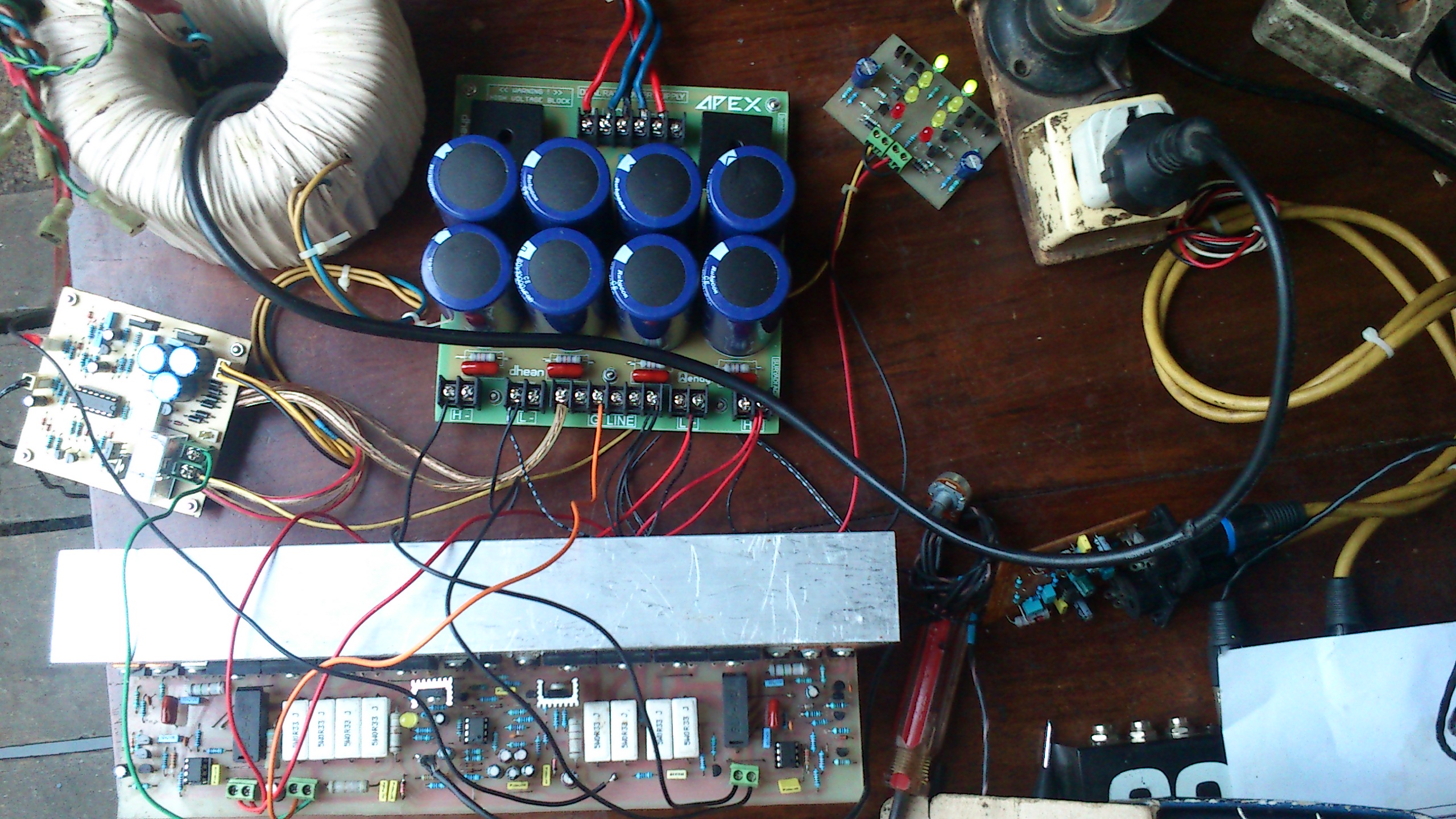

hi all , why is tl072 version amp not stable . and can someone please share a stable version not using ir2117
