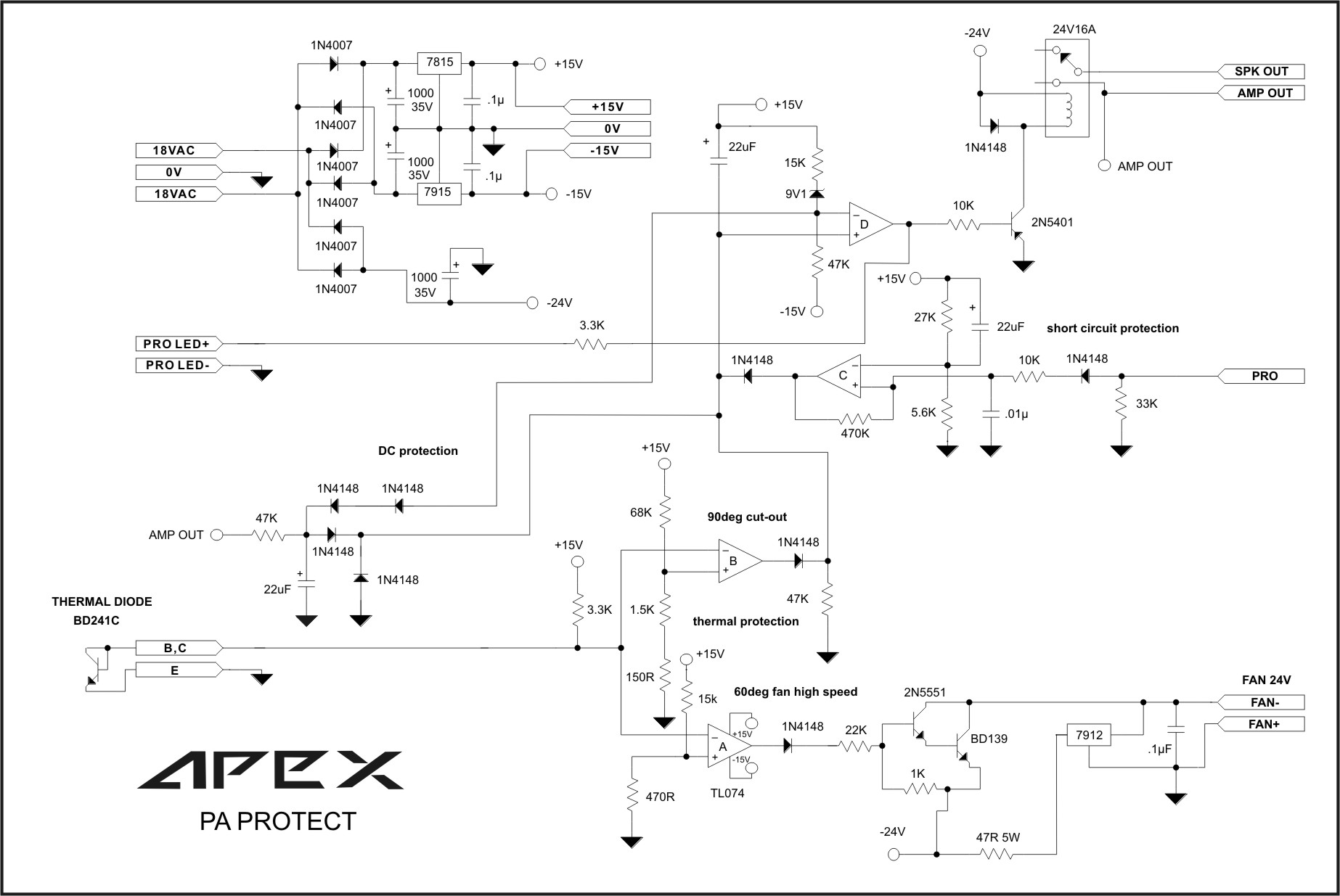

Modified protect
It's ok, 1N4148 add to the circuit.
Hello Sir Mile... may I ask if this modified circuit works better than its previous version? I have use 50-0-50 vac 2060VA toroid for my amp and uses 1amp 15vac to power up my protect circuit. I have a plant to modify my existing protect based on your modification and tested by Mr. Thimios..
thanks and regards

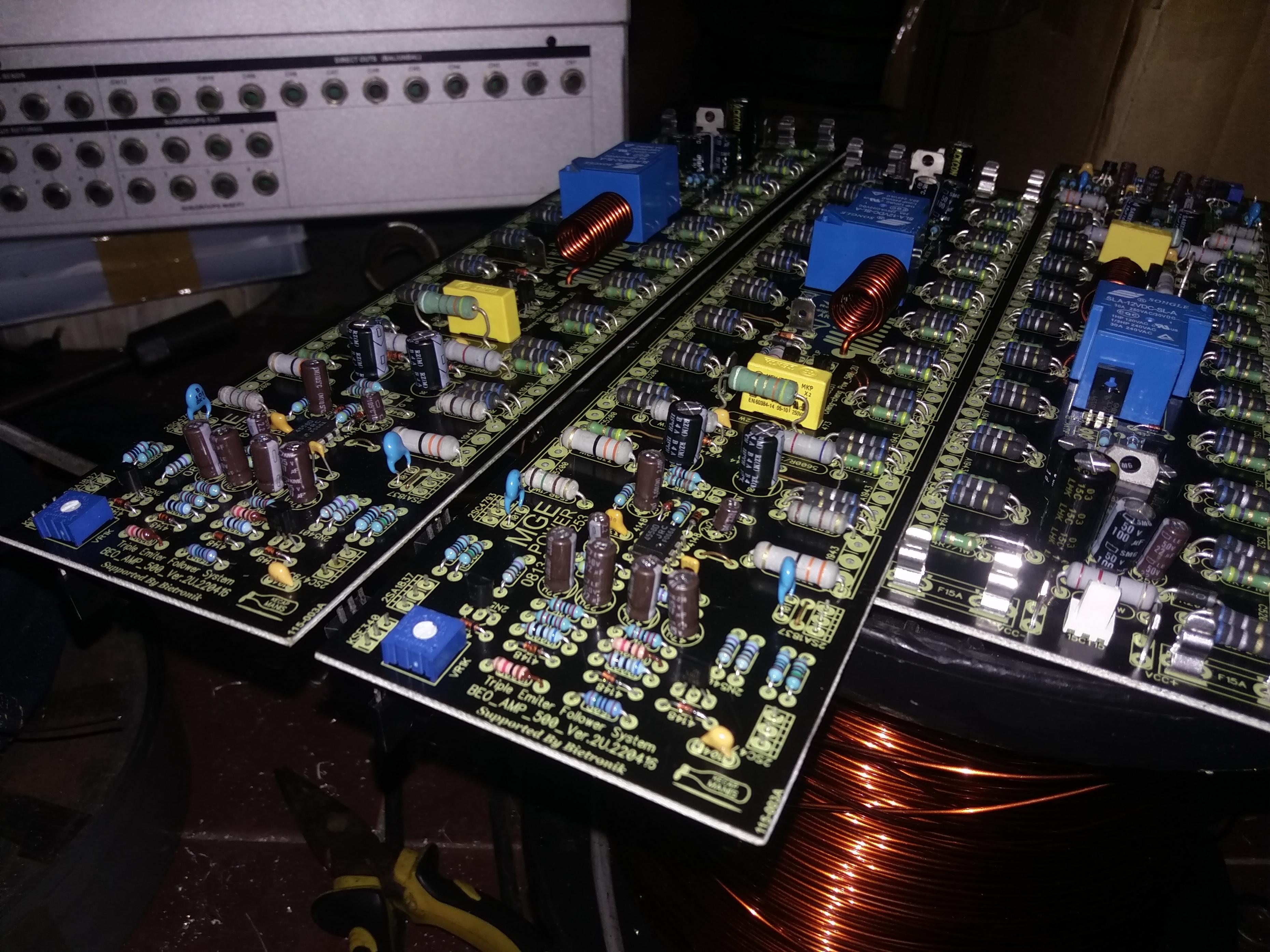

Good day to all DIYers.
Nice build BOSS2009 !!!!!!! Just a suggestion to you if you want to keep the temperature done on heatsink you should turn the module on its side. Because heat rises . If you leave the module like that shown in the photo uploaded your transistors temp will stay high.
please note its only a suggestion !!!!!!!!!!!
Regards.
