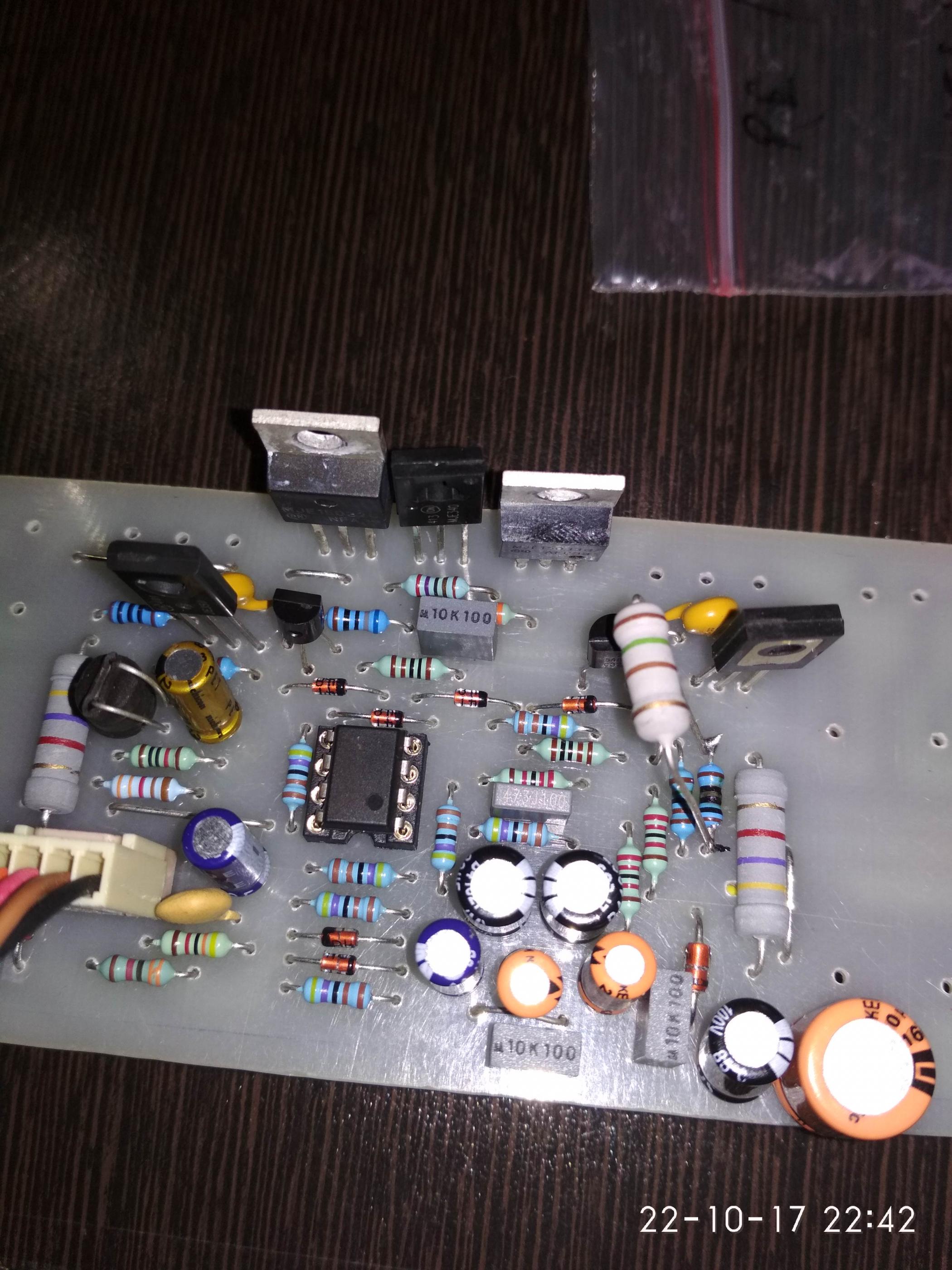

the diodes bav21 I did not find them change them for diodos1n4148 and I want to ask a question
the diodes zf and z and all are zener of 15v or I am wrong

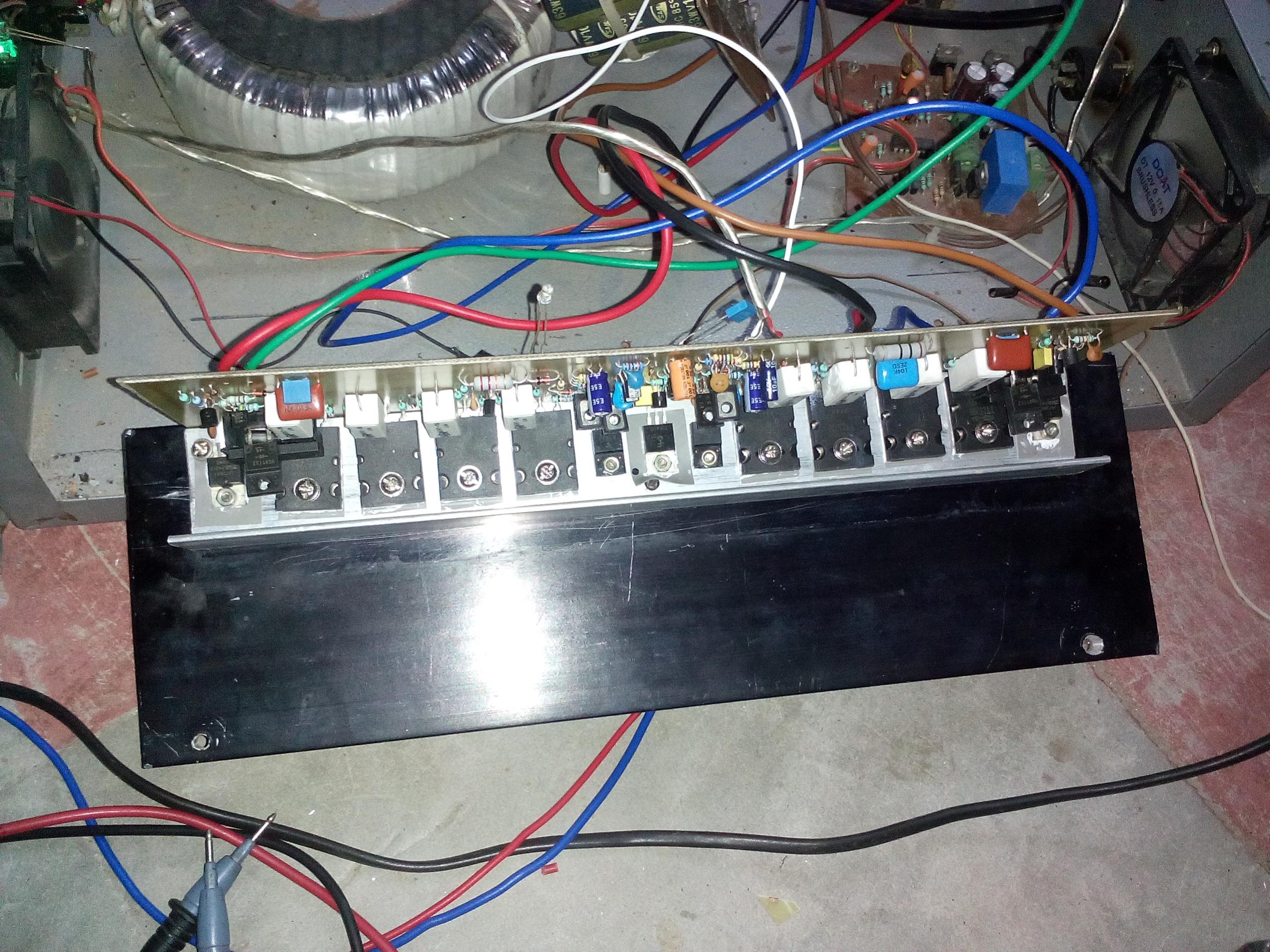

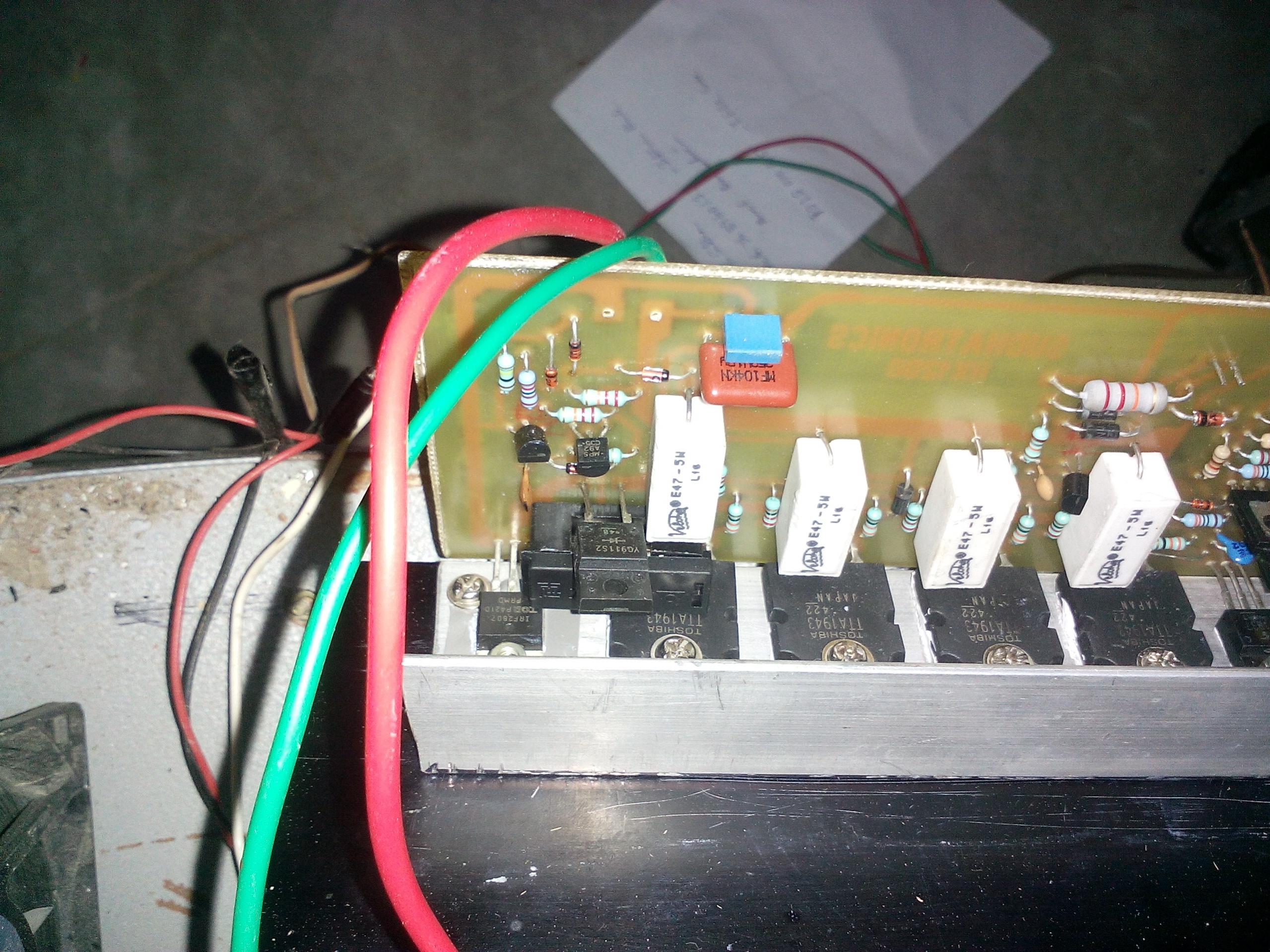

Hi friends I have build a h900 but facing some problem if I have on the power supply 100 ohms resistance start the burning near mje340
hi sir please take note that when going to supply power on the amp see to it that all transistors output and driver are on heatsink...mje340(bias ) adjust according to drivers and outputs transistor temperature,,,dont forget to put series bulb in main input supply to minimize damage on parts when there still problem,,,Goodluck...🙂

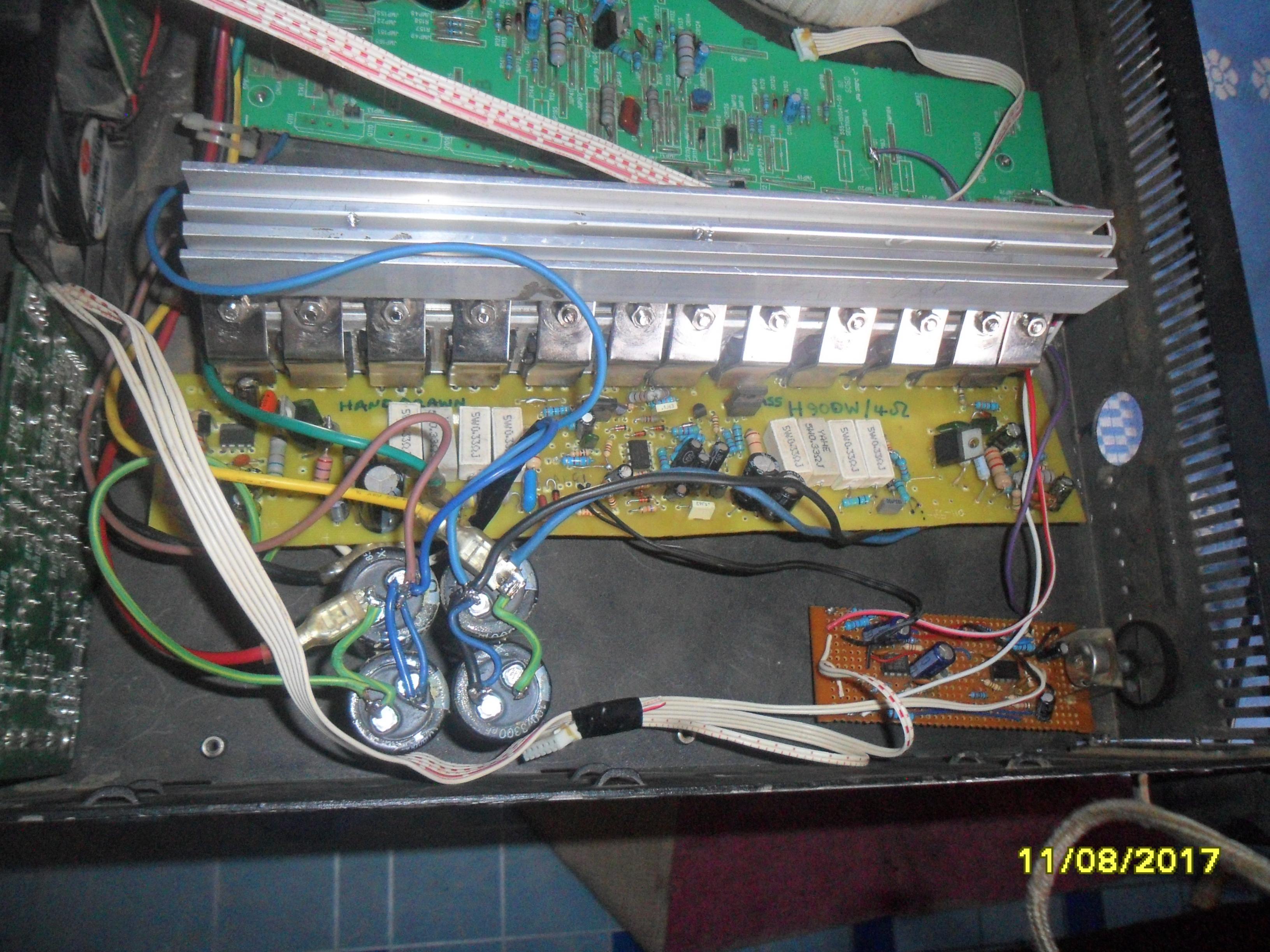

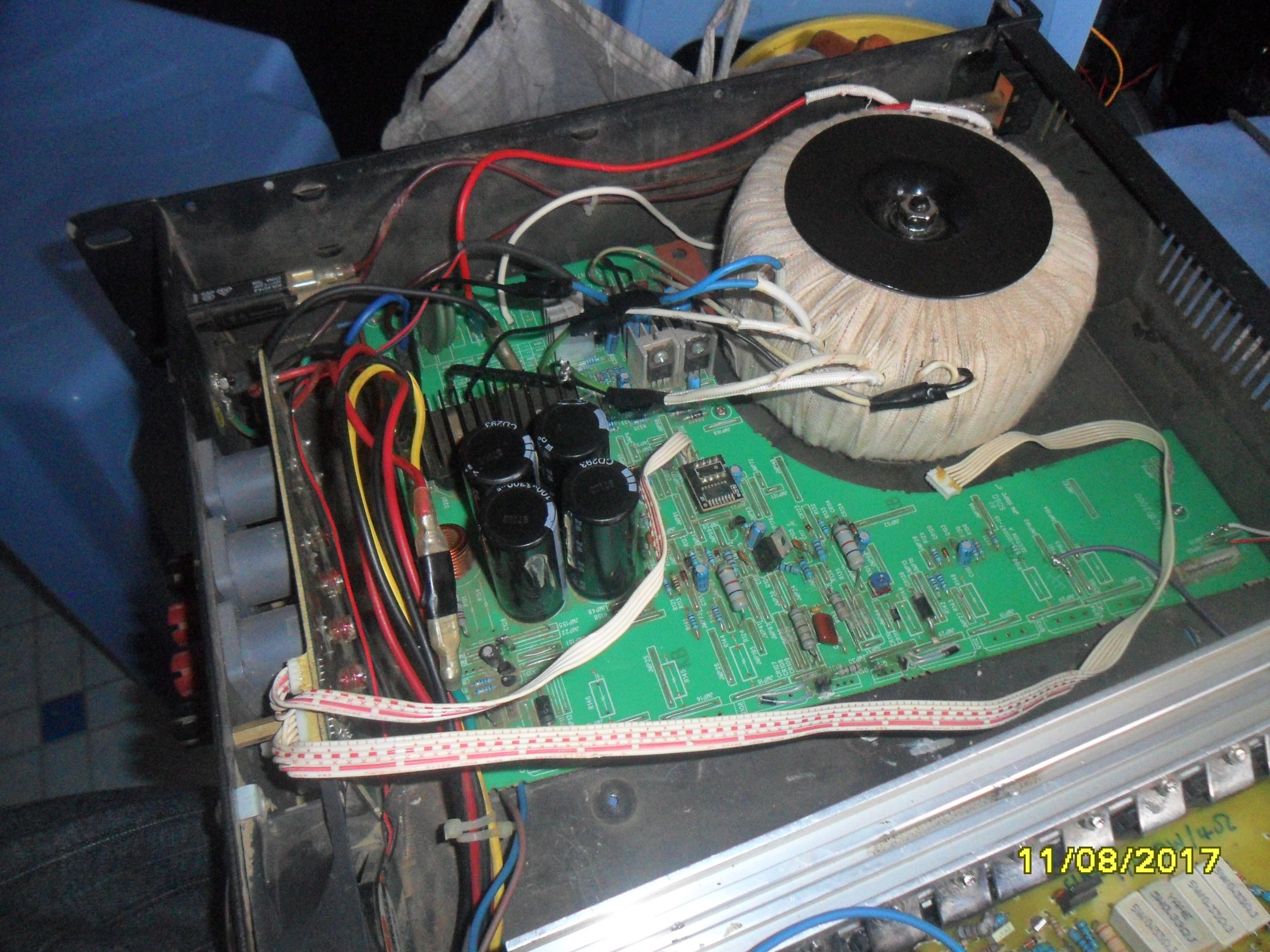

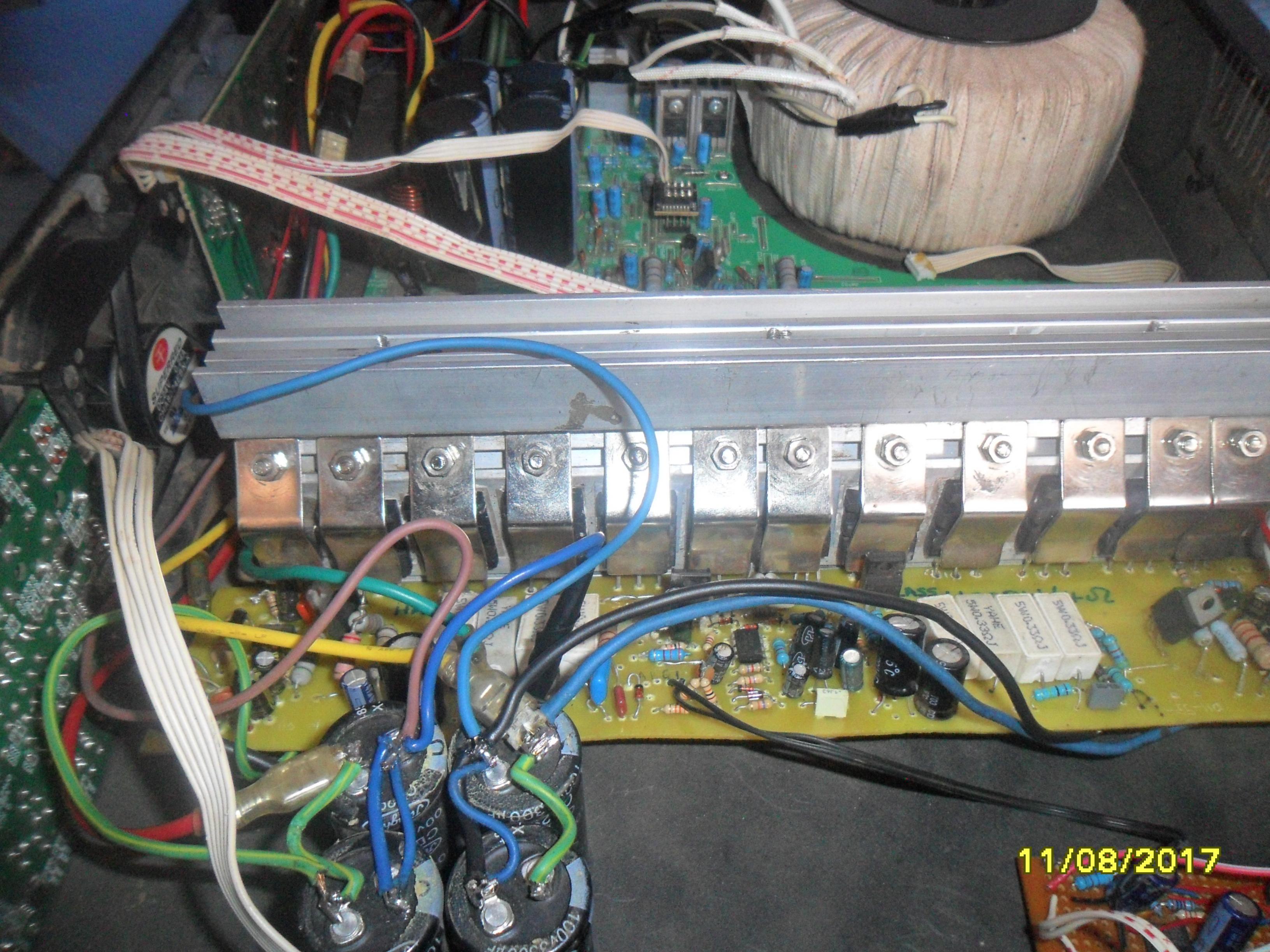

Thank you very many sir Apex. H900 is no joke. I just woke up a Peavey PV1500 power amp that uses +-90Vdc from a 65-0-65Vac toroid and 8 pair C5200nA1943 trannies both channel so 4C and 4A per channel. Was burnt beyond repair but i have a working channel H900 n modified the toroid for H Class. I am impressed by performance. Thanks Apex. Here are some pictures.
That was my very first H class. There has not been any IR2117 til' recently. H900 is indeed a performer. A million thanx to sir Apex. Long live sir Apex.

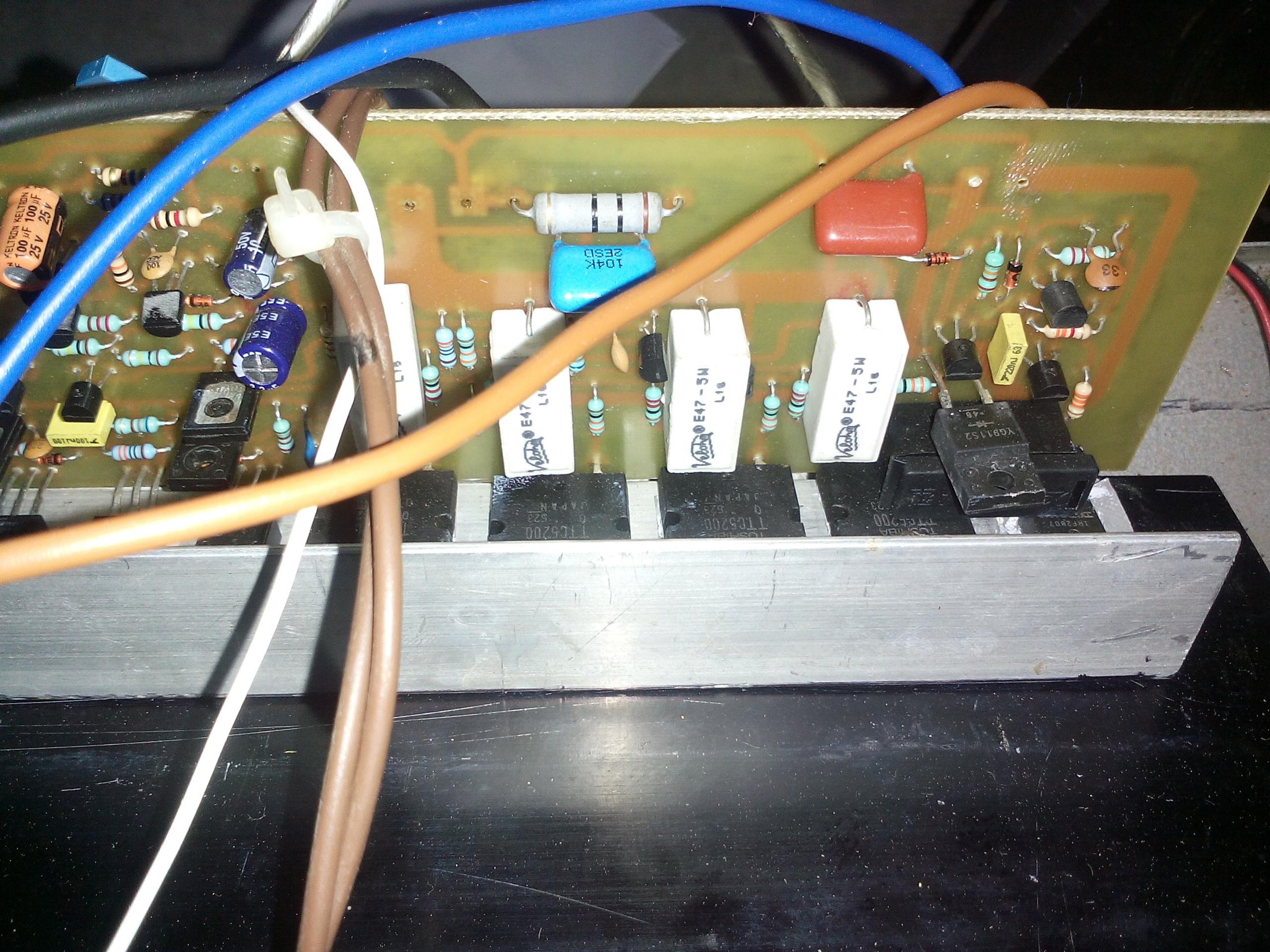

Thanx moore4889. I see you use two irf540s for switches. I just used a single irfz48 without any problems. But my 16A MUR1620 diodes are usually hot at high volumes. Is this normal?
what is your load impedance??
it is normal specially when driving low impedance speaker you better put some heatsink on those mur....
